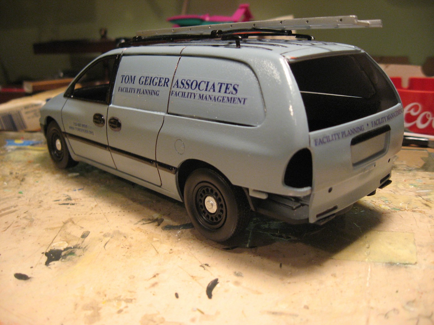

Tom Geiger Posted July 6, 2015 Posted July 6, 2015 I had a problem with the Testors Wet Look... see above. This is a Lindberg Dodge Caravan, molded in red plastic. Duplicolor automotive primer, Duplicolor blue. Sprayed it with the Testors, and somehow it pulled the red dye all the way through those many coats of Duplicolor. It didn't do it on the side glass areas, because that started as the clear parts. And it didn't mess up or go through the decals. You can see the lighter color under those. It also liquified anything I used a black Sharpie for outlining things and in the panel cracks. so into the drink it went!

Tom Geiger Posted July 6, 2015 Posted July 6, 2015 I'm sorry, Tom, but I simply don't believe that. I've never seen ANY chemical that's able to pull the "dye" out of the plastic. If that were possible, you could simply soak the whole body in that chemical before painting it and "bleach" red, orange, etc. dyes out of it. If there IS such a chemical, I'd like to hear about it. Hey, then you tell me what happened! This was Duplicolor gray primer with Duplicolor blue on top of it. I made the decals with the BMF brand decal paper, and coated those with Testors decal sealer. I then put the Testors Wet Look Clear on it and this is what I got. I asked for advise on this board and was told that the red plastic had leached through. It was fine before the Testors clear. To show that it indeed had something to do with the plastic, see the window area which is still the original blue tone. That's because it was clear plastic. In this photo you can see that the plastic that was protected with the decals (on the drivers door) also stayed the same color. If indeed, the entire van wound up the darker tone, I would've kept it, as it wasn't a bad color. It just wasn't working with the two tone thing, and the Sharpie leaching. After advise from the board to seal in the plastic with a coat of silver, I started over with the Duplicolor primer, then Duplicolor metallic silver. Between not knowing if I had enough of the blue left to paint the van again, and actually liking the silver, I decided to keep it. I don't have a current photo, but the van had new decals now. The original decals came from my old printer that developed that line in the color output. The new decals are much better from my new Canon printer. So you can believe what you want.... until you come up with a better explanation!
Tom Geiger Posted July 6, 2015 Posted July 6, 2015 (edited) Here's the van before putting the clear on it. The blue paint was uniform. The decals stunk, so I got that right, including the spacing, the second paint job. Edited July 6, 2015 by Tom Geiger
Snake45 Posted July 6, 2015 Posted July 6, 2015 I asked for advise on this board and was told that the red plastic had leached through. Lots of people still believe this old myth. I don't know exactly what "happened" in your particular case, but I can tell you that no dye leached out of the plastic.
Tom Geiger Posted July 6, 2015 Posted July 6, 2015 Lots of people still believe this old myth. I don't know exactly what "happened" in your particular case, but I can tell you that no dye leached out of the plastic. I always wondered when people said red or yellow had come out in their paint job. Never had it happen to me. I have a junker Monogram Cord downstairs that is pink... who ever was building it sprayed it with an antique white color.
