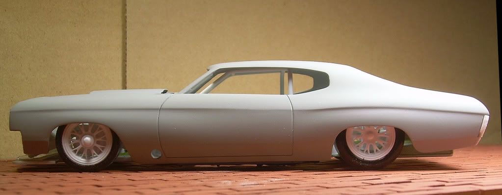

Ace-Garageguy Posted July 12, 2015 Posted July 12, 2015 (edited) On 7/12/2015 at 8:13 AM, superbike-shaun said: Hi Crowe,you can use any type of automotive lacquer under the Testors MM paints,just be sure to do a test on the same scrap spruce from the kit you're painting. Shaun To elaborate on this a little...many of us get outstanding results using Duplicolor or PlastiKote primers made for real-car use, available at auto-parts stores. These primers come in a range of colors, typically gray, red, black and white. They also come in two 'thicknesses'. There's "high-build" (also called "scratch filling") primer that's ideal over heavy bodywork, and there's "sandable" primer (from both companies) that goes on much thinner and doesn't obscure fine details like the "high-build" products can. These primers can be 'hotter" than those made for models, and sometimes may craze the surface of the plastic you're working with, so testing on a non-visible part (or sprue) of EACH model you're working on is a good idea BEFORE you commit to using anything on a particular kit. This is the Duplicolor "high-build" gray over lots of heavy bodywork. Edited July 12, 2015 by Ace-Garageguy
