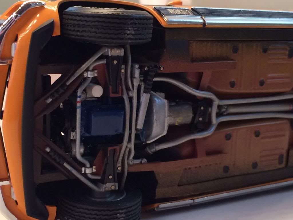

freakshow12 Posted October 11, 2015 Posted October 11, 2015 67 camaro Typical Ford muscle car chassis. Correct finishes
