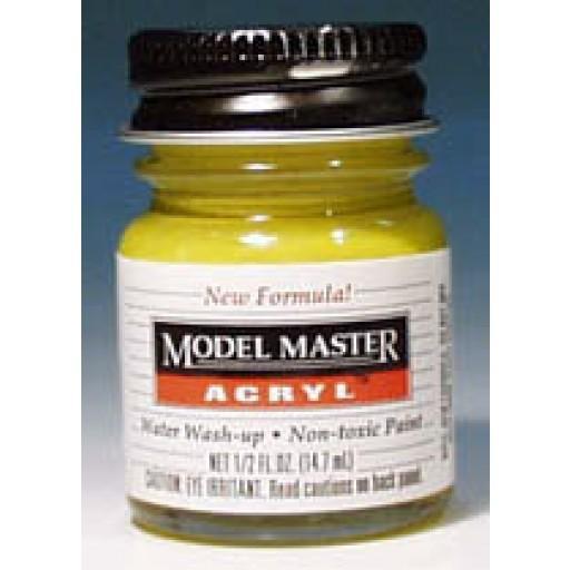

SfanGoch Posted October 13, 2015 Posted October 13, 2015 There's no need to get actual yellow zinc chromate primer. you can get Model Master Acryl 4851 - ANA 627 Yellow Zinc Chromate. You can also use Vallejo Model Color 70923 Japan Uniform WWII and Humbrol 81 Matt Pale Yellow are good too.
aurfalien Posted October 13, 2015 Author Posted October 13, 2015 There's no need to get actual yellow zinc chromate primer. you can get Model Master Acryl 4851 - ANA 627 Yellow Zinc Chromate. You can also use Vallejo Model Color 70923 Japan Uniform WWII and Humbrol 81 Matt Pale Yellow are good too. An advantage of air brushing over rattle cans. I don't have an air brush yet...

StevenGuthmiller Posted October 13, 2015 Posted October 13, 2015 There's no need to get actual yellow zinc chromate primer. you can get Model Master Acryl 4851 - ANA 627 Yellow Zinc Chromate. You can also use Vallejo Model Color 70923 Japan Uniform WWII and Humbrol 81 Matt Pale Yellow are good too. Question is, are you going to spray Automotive lacquer over acrylic paint? Steve
