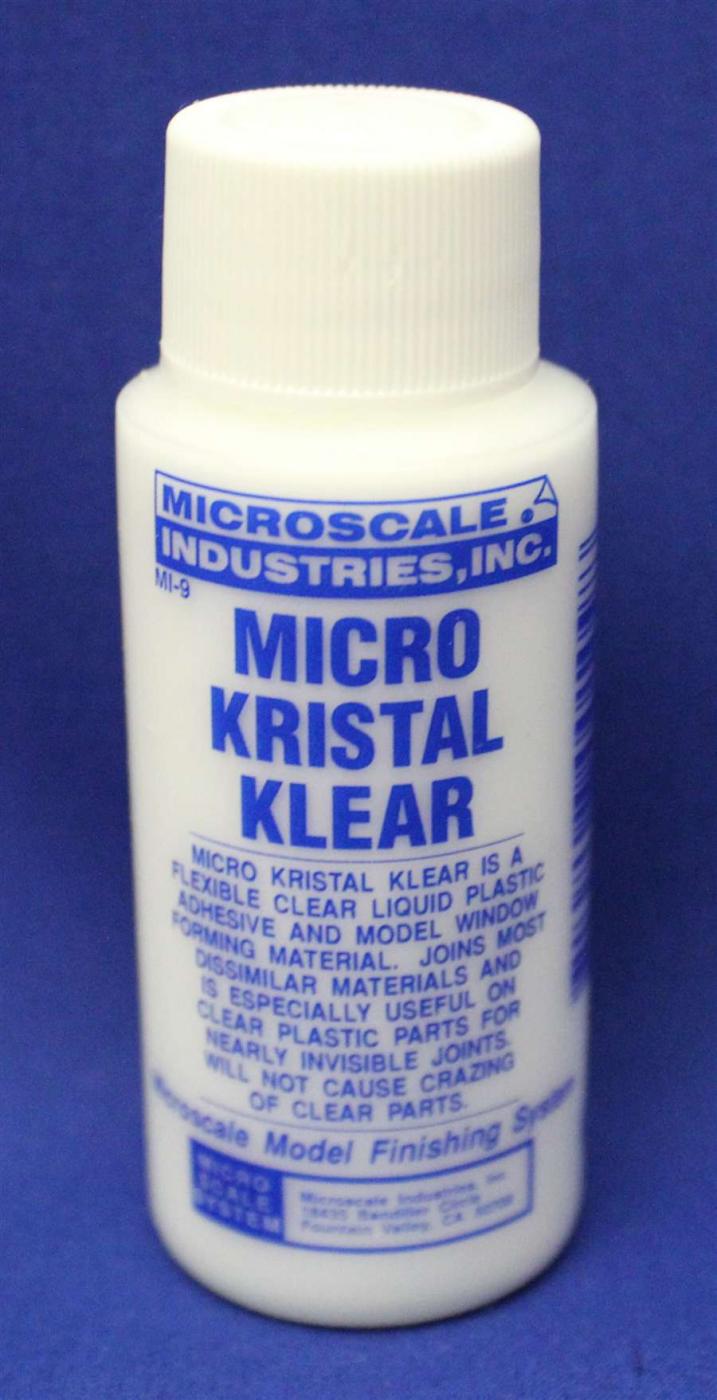

Earl Marischal Posted October 20, 2015 Posted October 20, 2015 You might want to try this stuff. steve

Harry Joy Posted October 21, 2015 Posted October 21, 2015 (edited) The 1969 Riviera that I posted below on Sunday did not come with headlight or taillight lens. It was not kitted with them. I was not happy with the bare chrome look, so I built up lens covers with the very same Micro Krystal Clear posted above by Earl Marischal, which I then gave a light coat of Future. I think they turned out pretty great. In my pictures posted, the lens covers were not 100% dry yet, so they appear just a tad cloudy, but they are very clear and glossy now. In my instrument panels, I put just a few drops of Future and that's enough to give the appearance of lens', but I am too impatient to build up big parts that way. The combination of Micro Krystal Clear and Future works perfectly. Edited October 21, 2015 by Harry Joy
