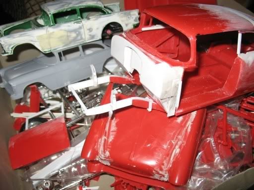

dodgefever Posted December 18, 2015 Posted December 18, 2015 Yes, the AMT '55 sedan body is the best starting point. The old Monogram is a hardtop, so wrong roof to being with, and the proportions are way off in any case. I have two stalled TLB replicas, one 1/25 using the AMT sedan and one 1/16 using the hardtop with a lot of mods. I'll get back to those one day.
