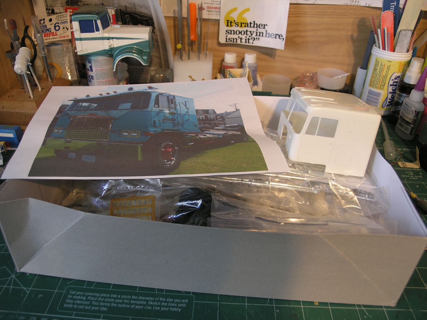

Old Buckaroo Posted January 1, 2016 Share Posted January 1, 2016 (edited) This will be my rendition of a Diamond Reo Royale. There will be a lot of artistic license used as I have only seen a few in real life. My original idea was to convert a GMC Astro but discussing this with a good friend who is also a outstanding truck modeler he suggested the KW K-123 kit, so that will be my base kit. There will be lots of parts box items used along with a DR truck kit (on order) for the grill and emblems to get this model as close to the pictures I have collected. Edited April 4, 2016 by Old Buckaroo Quote Link to comment Share on other sites More sharing options...

Old Buckaroo Posted January 1, 2016 Author Share Posted January 1, 2016 Brian, yes I have seen that thread. Truth be known that was my inspiration due to all the great reference pictures. Terry - I have already sawed the roof of the KW cab as its "shape and lines were not working for me. Thanks to everyone else for commenting - it should be an adventure ! Quote Link to comment Share on other sites More sharing options...

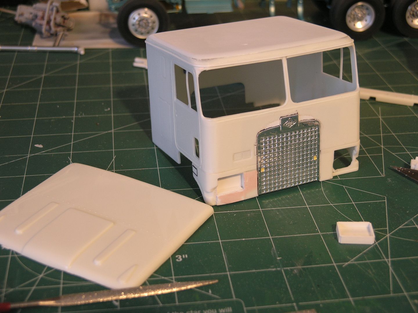

Old Buckaroo Posted January 1, 2016 Author Share Posted January 1, 2016 Cab update, sawed off the top replaced with a chunk of .060 styrene for height and shaping. Stole the grill from my "Reo 98" . Made the square headlight buckets with aid of a "chopper tool" , filed the top windshield post square. Pretty rough but it makes me think this will be a doable project. I will be using a AMT Diamond Reo kit for the frame so the cross members kinda resemble the real truck. Quote Link to comment Share on other sites More sharing options...

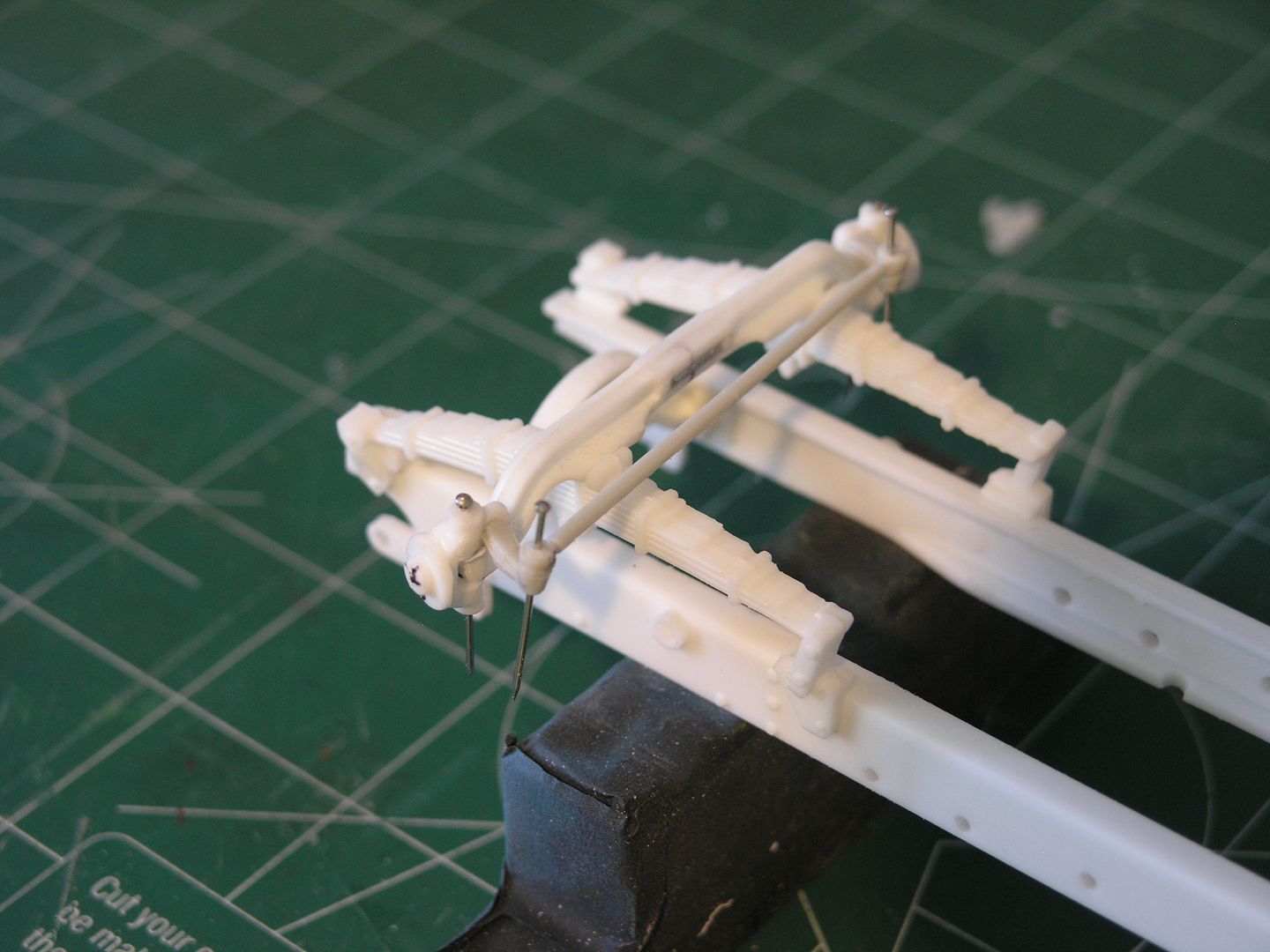

Old Buckaroo Posted January 3, 2016 Author Share Posted January 3, 2016 It has taken me more time to make a poseable front axle then I spent roughing out the cab. I did narrow the DR axle and to strengthen the seam I cut a paperclip up and CA'ed it in the axle channel . Quote Link to comment Share on other sites More sharing options...
