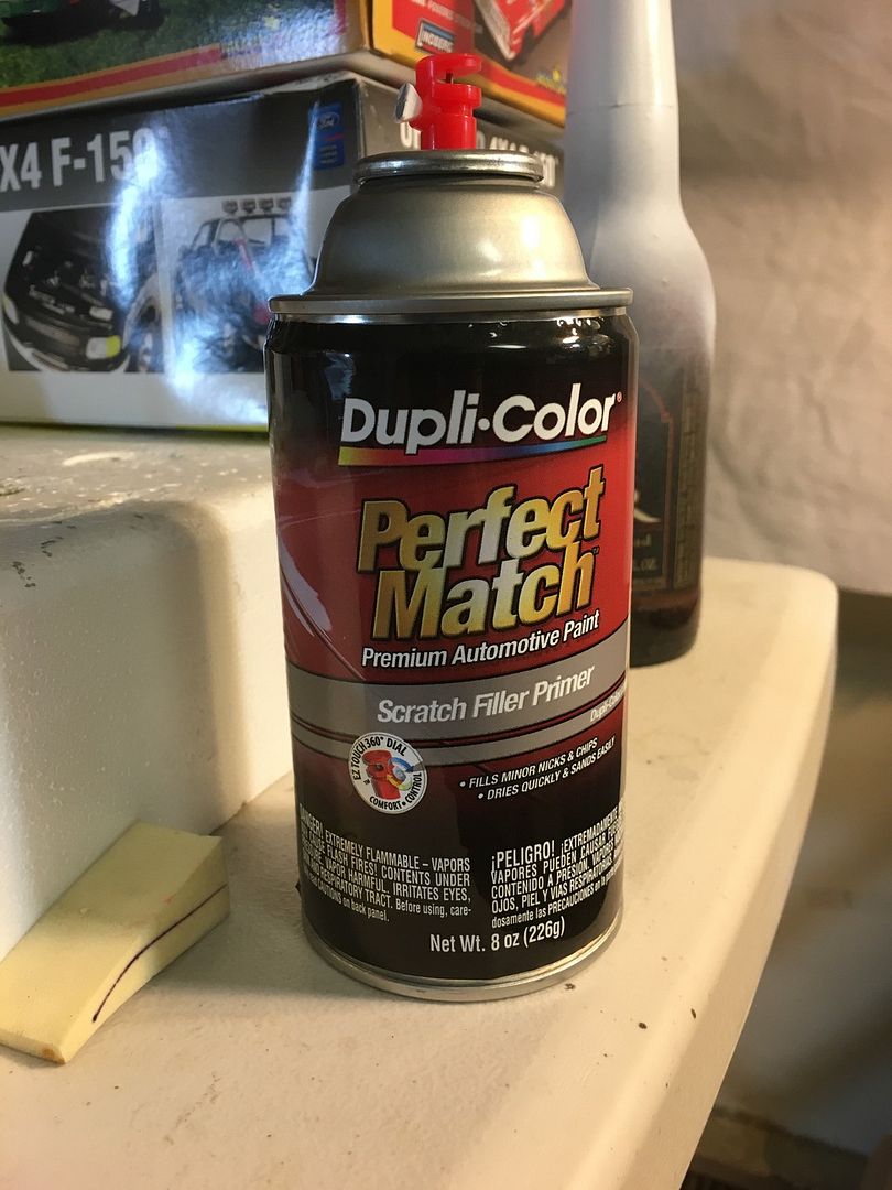

Ace-Garageguy Posted January 17, 2016 Posted January 17, 2016 The product posted above is a high-build primer, and will obliterate surface details if you're not careful.It says "scratch filler primer" right on the label.The "sandable" primers that don't say "scratch filler" are better suited to general model car priming.The "scratch filler" product is excellent over bodywork when you WANT high-build and filling characteristics.I use all of these products and many others, for various applications on models.

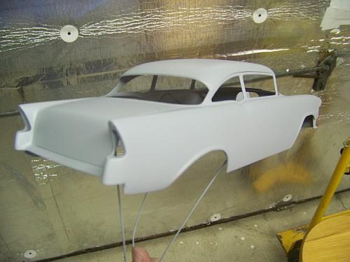

astroracer Posted January 17, 2016 Posted January 17, 2016 PlastiKote Grey rattlecan was about the best I ever used. Don't know if it is still around. I use Duplicolor alot also. The '56 conversion was primed many times with it during the build process. Light coats work well to preserve details. Mark

astroracer Posted January 17, 2016 Posted January 17, 2016 Thanks Bill, good to know it's still out there. The cans I always picked up were the smaller ones. I still have quite few, They are so old most of them have lost their propellant. I usually save them and just decant to spray with an airbrush. The DupliColor seems to work just fine though so I use that for quick and dirty jobs like the '56 where I know 99% of it will get block sanded off.Mark
