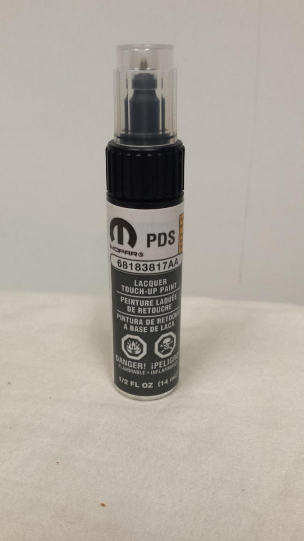

Eric Macleod Posted February 27, 2016 Posted February 27, 2016 I really appreciate this thread. I really like the gray with a touch of blue that I have been seeing on some late model Jeeps. I decided it would be perfect for an upcoming Duesenberg Town Car project I am going to start soon. I ordered the paint which comes as a base coat clear coat kit. Because I placed an order for it I felt like I had to take it but it was $19.50 gasp! So for the question, I am thinking I can shoot it over standard automotive primer using lacquer thinner to cut it. What do you think?
Foxer Posted February 27, 2016 Posted February 27, 2016 I really appreciate this thread. I really like the gray with a touch of blue that I have been seeing on some late model Jeeps. I decided it would be perfect for an upcoming Duesenberg Town Car project I am going to start soon. I ordered the paint which comes as a base coat clear coat kit. Because I placed an order for it I felt like I had to take it but it was $19.50 gasp! So for the question, I am thinking I can shoot it over standard automotive primer using lacquer thinner to cut it. What do you think? I've used those touch up bottles from dealers for a couple Subaru's. a VW and a couple of my Porsche's. It takes about a 1:1 mix with lacquer thinned to prepare for the air brush. They all worked well.
