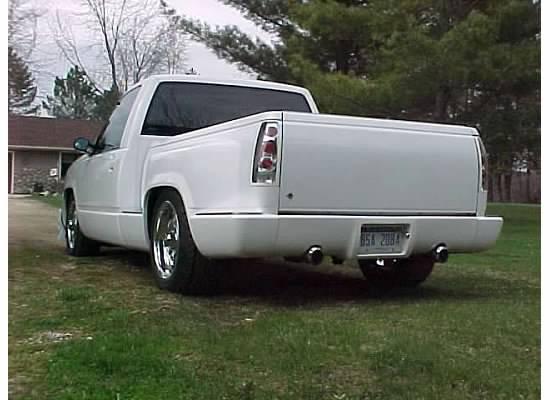

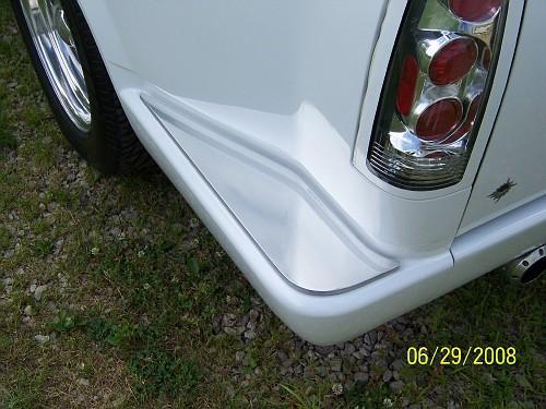

astroracer Posted April 1, 2016 Posted April 1, 2016 (edited) This is my Pickup. I wet sanded all of the numbers and lettering off the tails, painted the "blacked out" edge white and then clear coated. They are crystal clear. Actually better then before because I sanded out all of the "warbles" in the molded plastic. This WILL work great, believe me. Done it many times just to smooth out the plastic window to make it look more like glass... Mark I found a better pic. These were painted in '01. Haven't been touched since other then to polish a bit. Edited April 1, 2016 by astroracer
