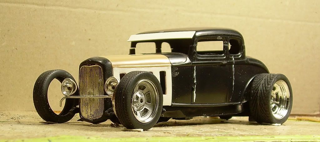

Ace-Garageguy Posted April 8, 2016 Posted April 8, 2016 (edited) As an experiment, on the front wheel here I taped the rim very carefully with fine-line tape, then scrubbed the center with Comet, hot water and a toothbrush. It scuffed the surface enough to get decent adhesion from the Testors metalizer I shot dry to get an as-cast finish. It's been several years and it hasn't peeled yet. It helps to RE-MASK after you do the scrubbing, and make sure the tape is well-stuck both times. Edited April 8, 2016 by Ace-Garageguy
