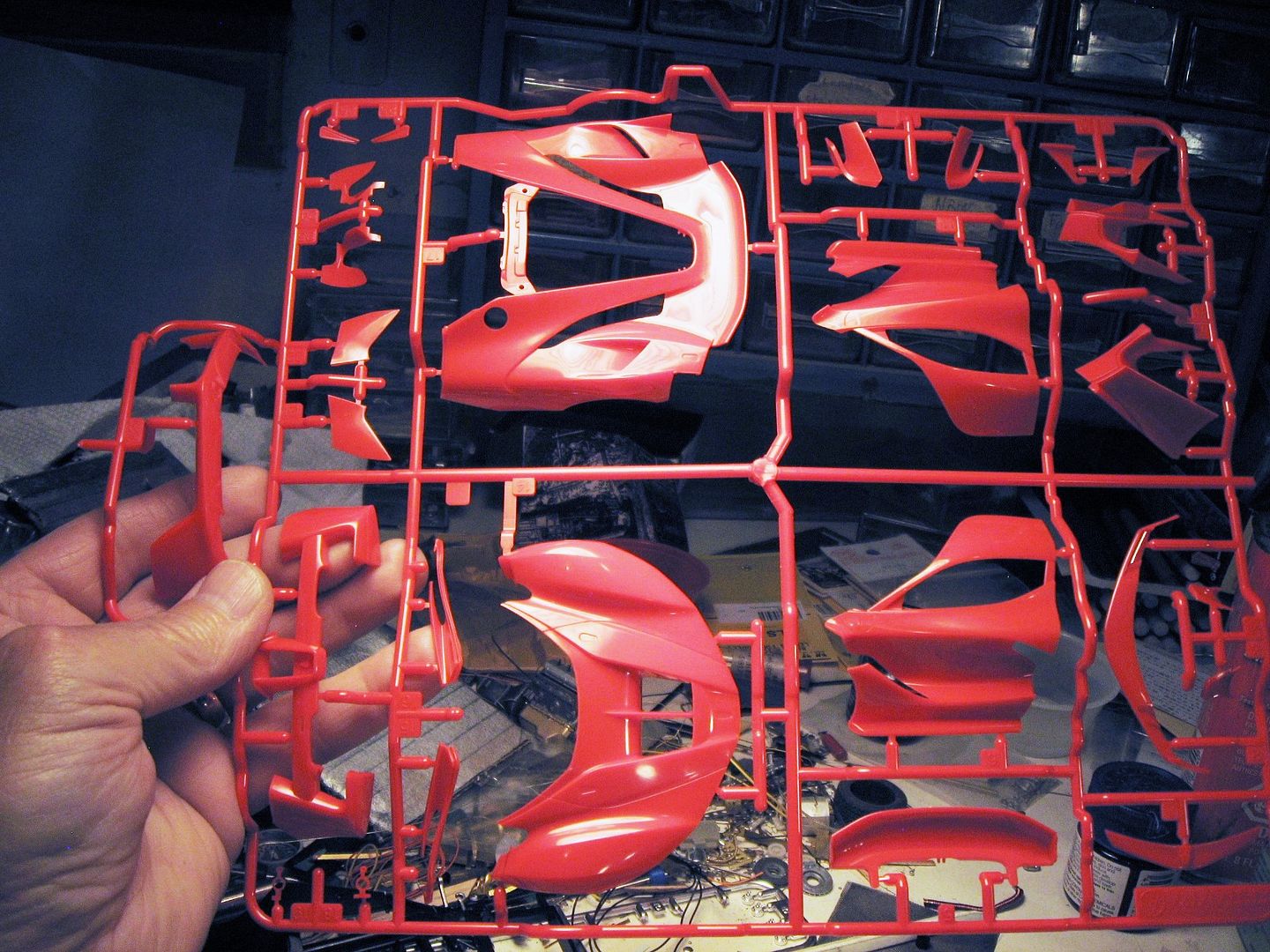

I am counting on Tamiya's engineering reputation to make all these body parts....
come out looking like this and be functioning....
In other words ....I hope I don't screw this up:)

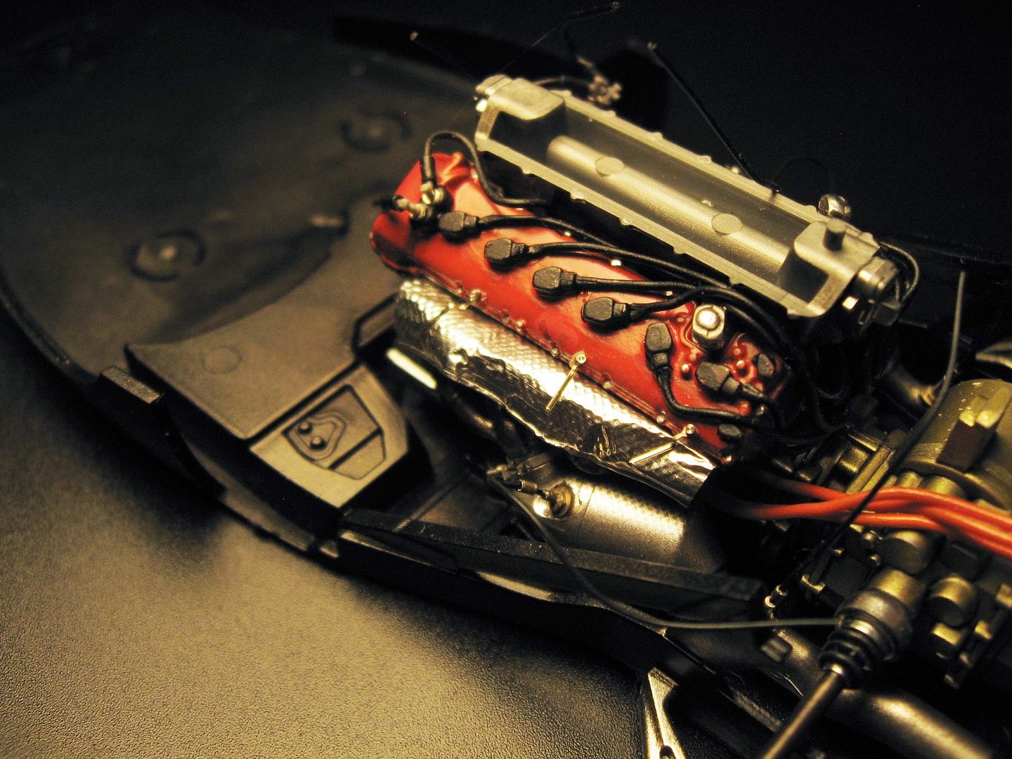

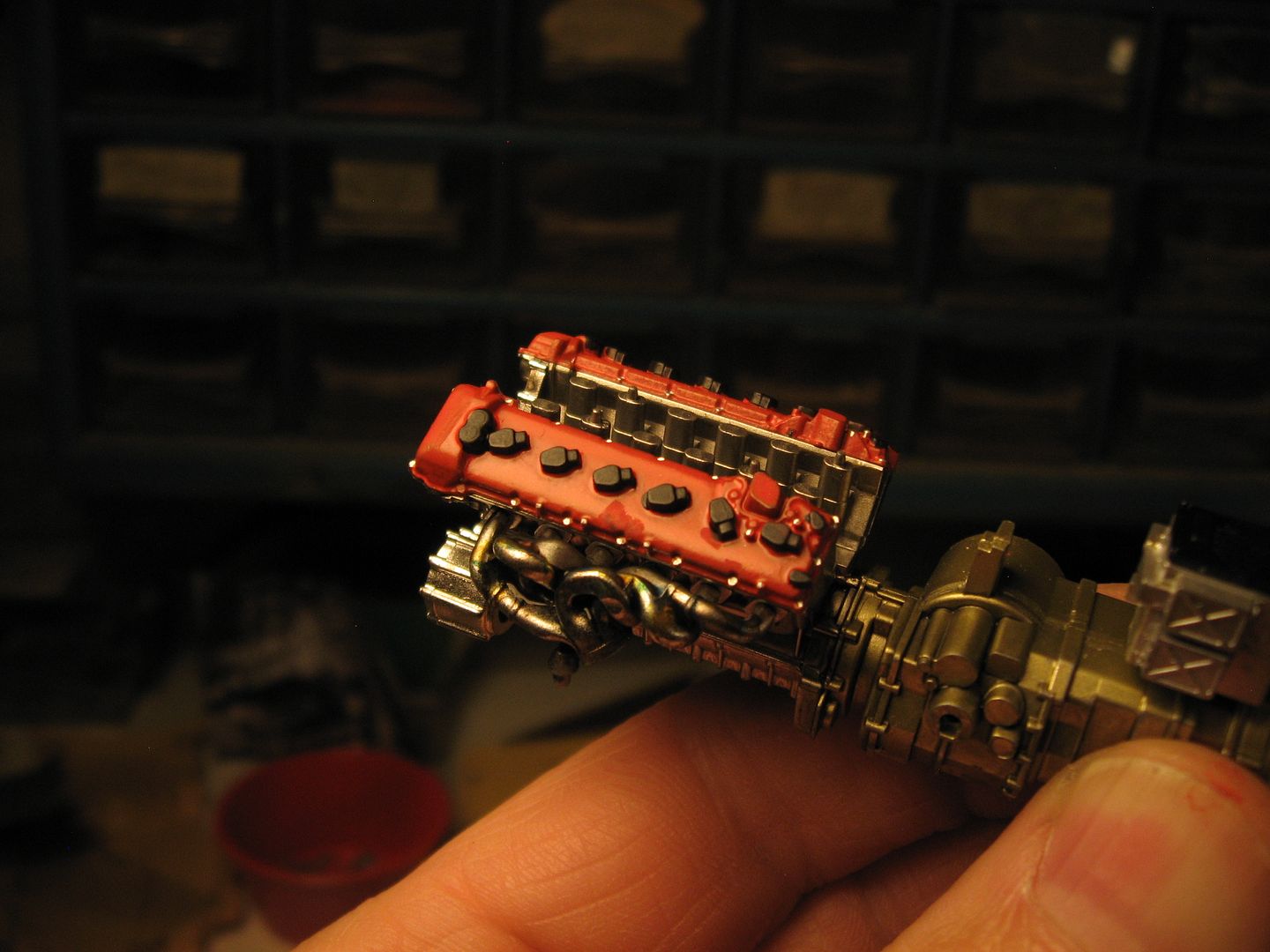

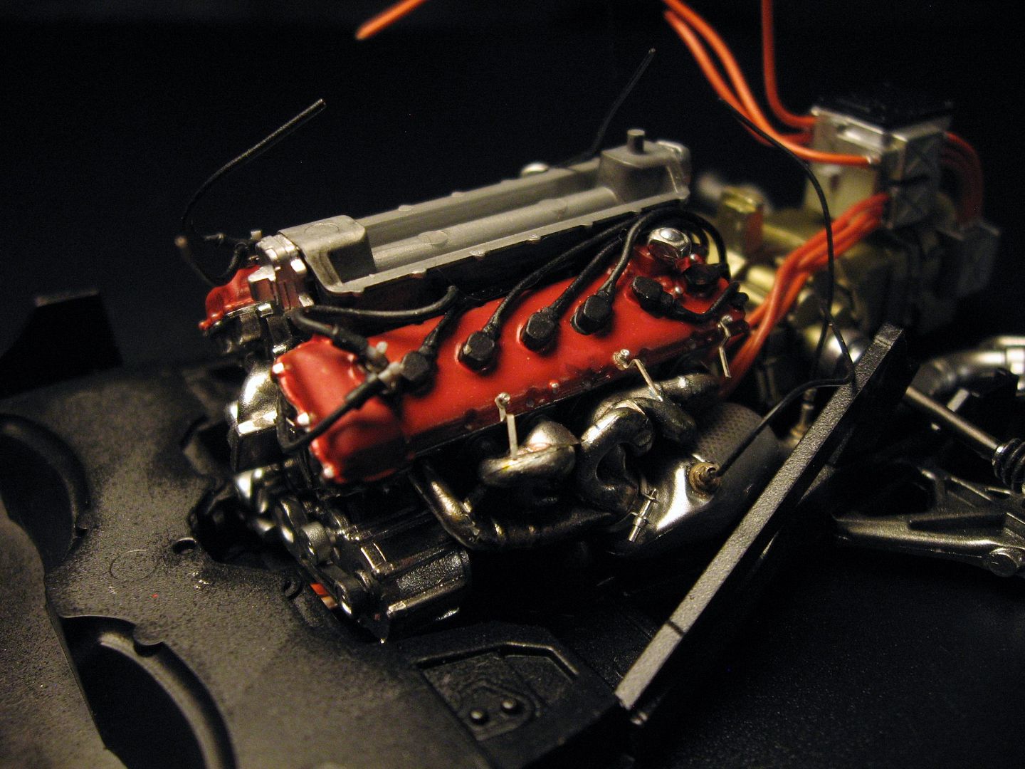

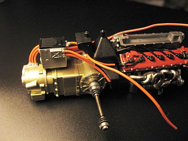

Some work on the motor...
Adding some plug wiring and plumbing for the Kers system...

Randy.... WOW... I am sure looking forward to seeing you put your skills to work my friend. Excited to see you back at the bench. The detail you have done on the engine is amazing so far. I will be following along and looking forward to more on this build.
Nice work on the engine so far,do you plan on painting it something other than red?,I've seen them in yellow and white.

Thank you Curtis, l did like the yellow one but leaning towards the box art but maybe more of a candy red????

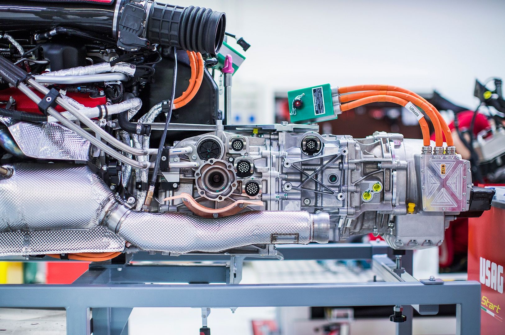

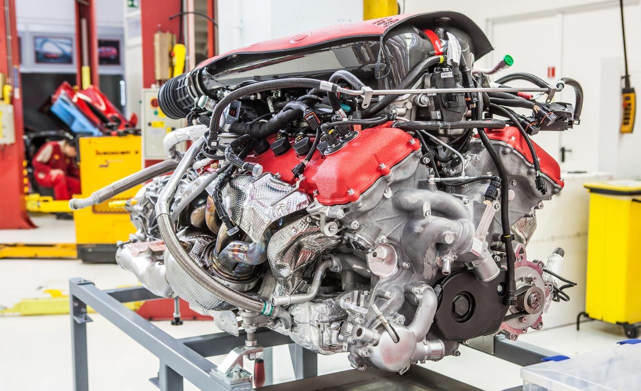

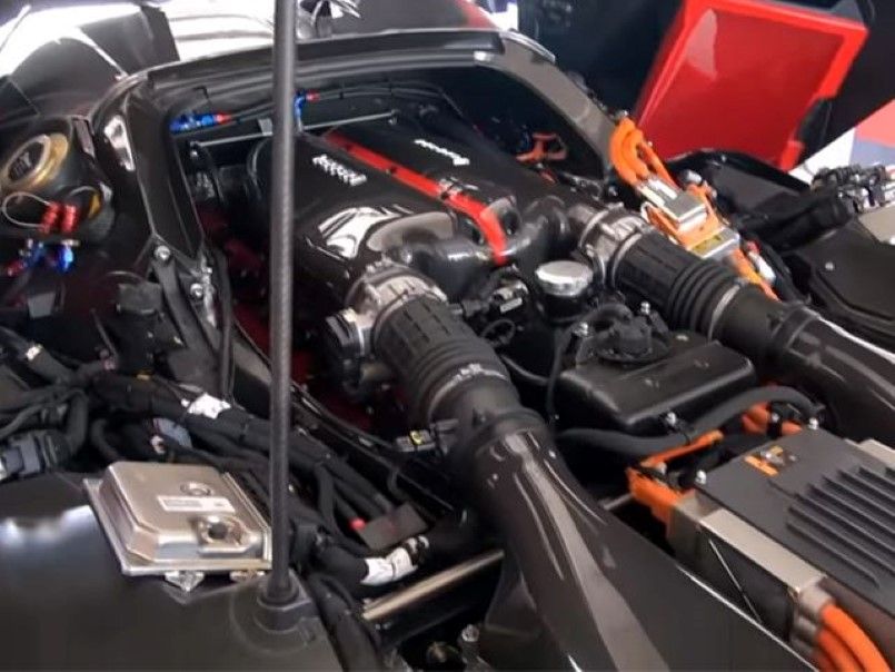

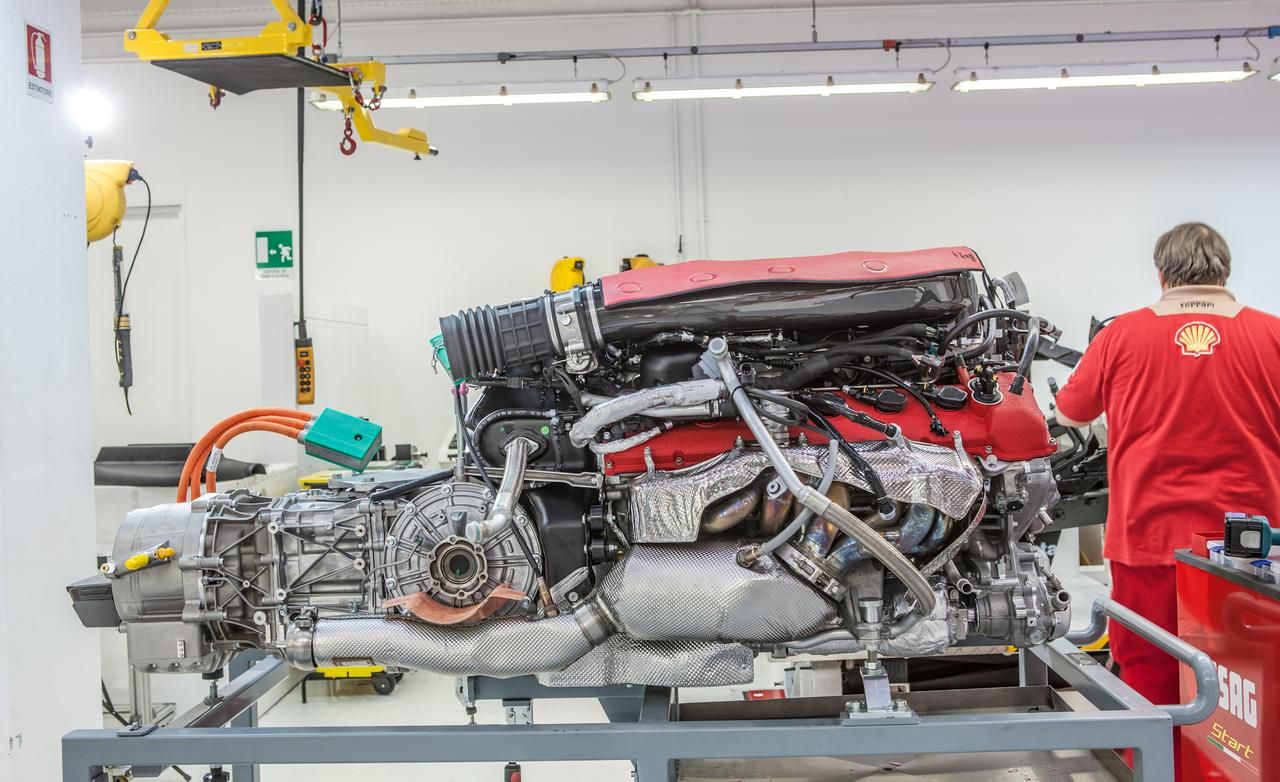

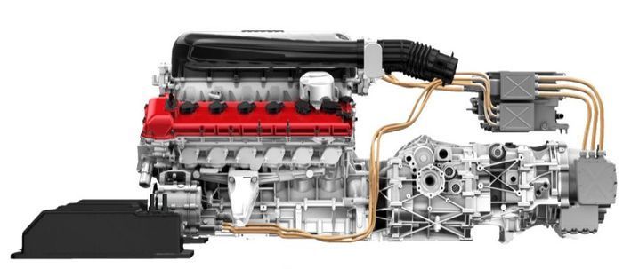

For Ben G,  Hard to find much  wiring and plumbing reference on these cars right now.  Best I have so far is using the street version, La Ferrari,  as a starting point.......

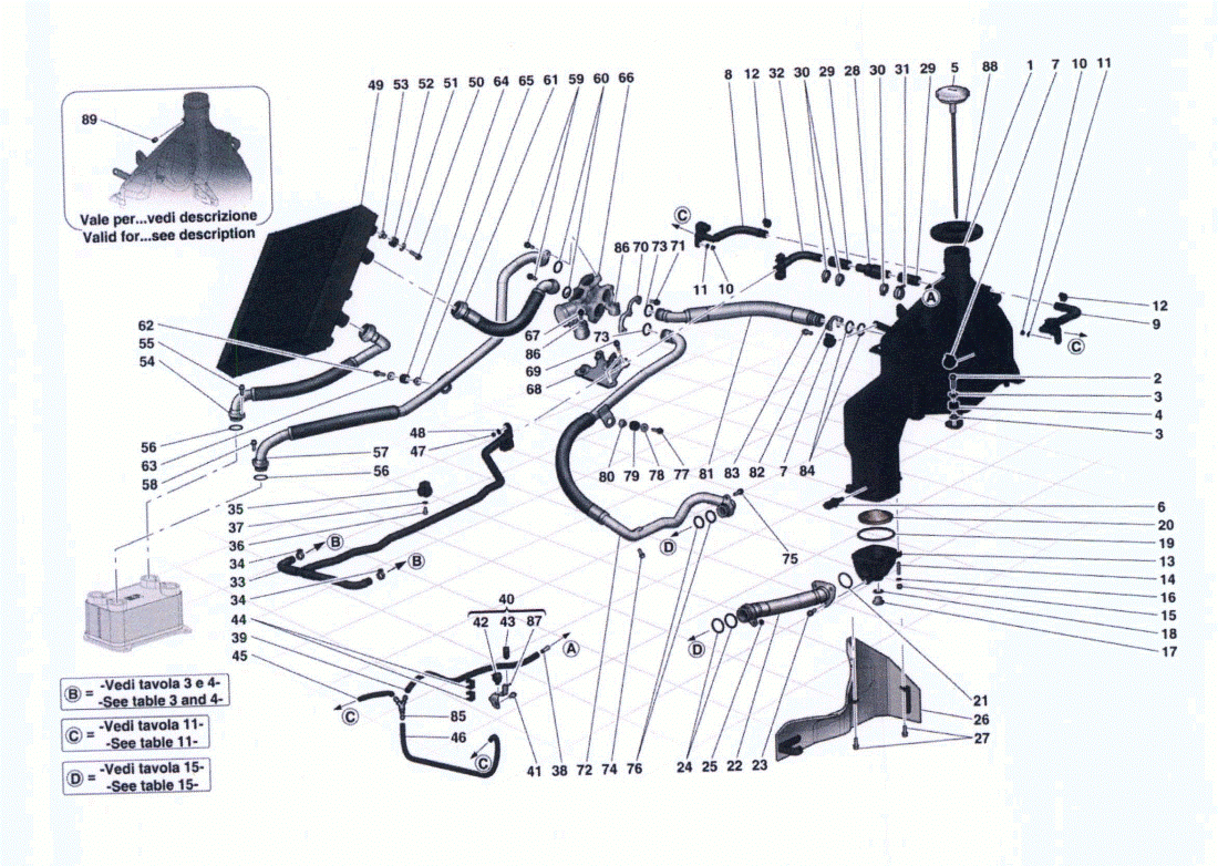

I'm combining these pics plus the parts catalog pics and a few shots of the car with the rear clip raised to give me a plan..
let me post this then I will add more...
The parts catalog is available online at.......http://www.eurospares.co.uk/
Elyashiv,  The engine so far has been painted using these......
They have quite a few colors in this line.  The trany was using the Gold and the block Dura aluminum.  You will see more of these as I go along.   They come ready to use thru an airbrush, go on really nice and dry in 20 minutes.   Best used over the gloss black primer they have. I got mine from Sprue Brothers..... Bottom of the page.
http://store.spruebrothers.com/category_s/2293.htm?searching=Y&sort=7&cat=2293&show=60&page=9

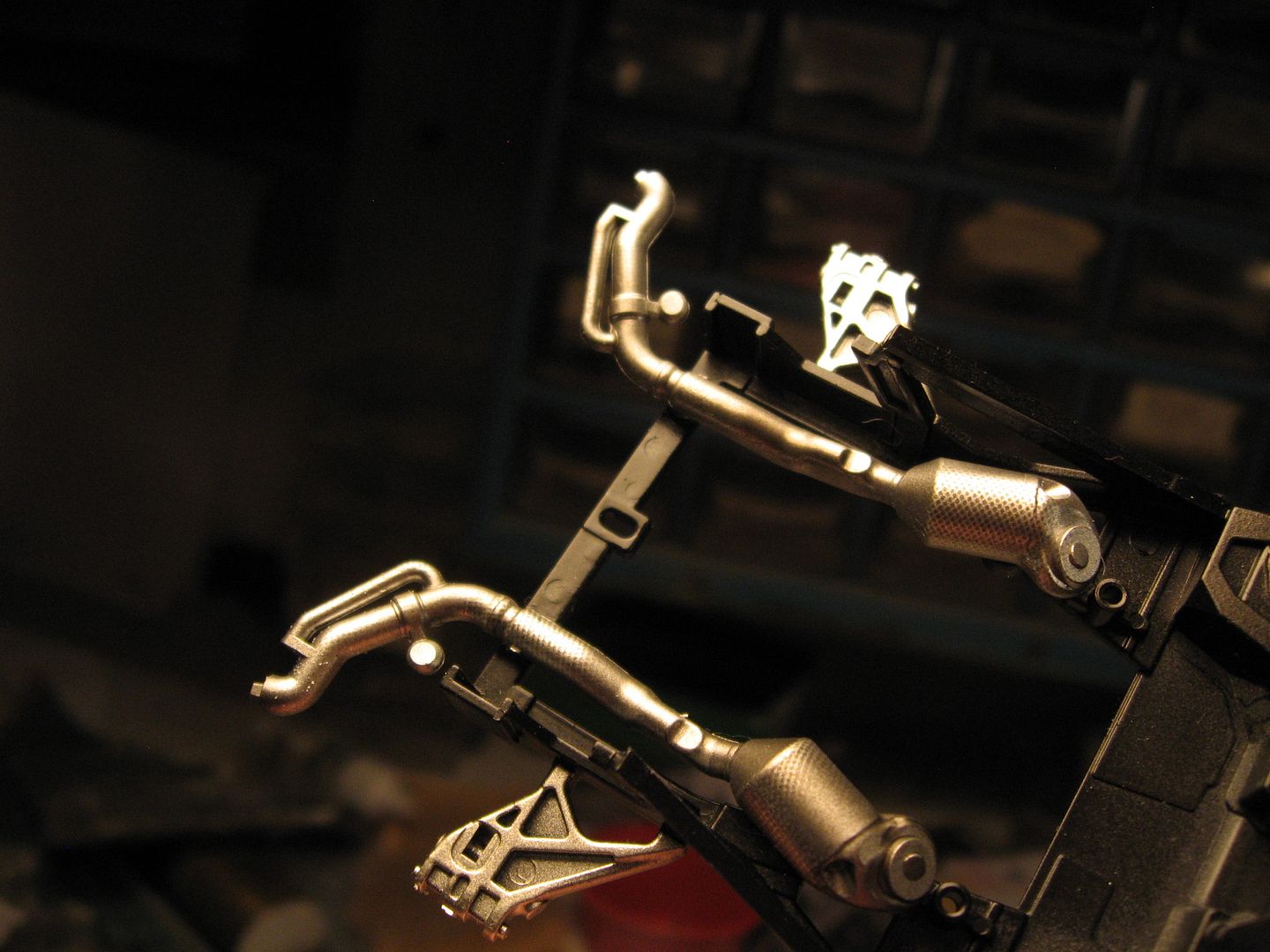

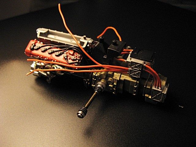

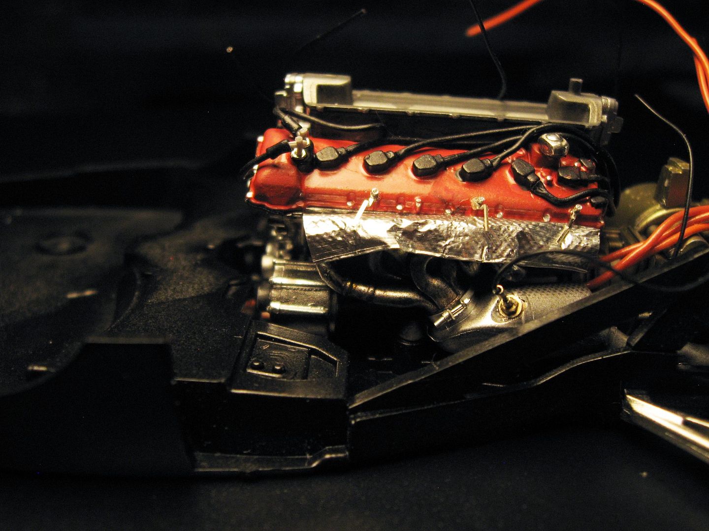

Small progress tonite....
 Since the exhaust  is only seen from above at a distance I used the screen material in the kit to create the texture with paint...
  The  shielding over the pipes coming off the block is a bit more visible and closer so I replicated those parts with tin foil  embossed over a pin vise
Thanks for looking in!

Randy.... Your are rocking this one and it looks good. I am loving the Heat shield that you made from tin foil. It looks so great!! Keep at it my friend. I can't wait to see more of those Vallejo metal colors.
