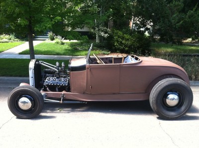

1928-'29 roadster     $_1.JPG?set_id=880000500F
1928-'29 coupe   1929-ford-model-a-five-window-coupe-1.JP

Having a 1:1 29 roadster in my shed and a dismantled 29 five window coupe put away for a retirement project, I can tell you a few of the differences.  I haven't yet worked out the best way to get an accurate 29 5W in 1/24 or 1/25 but hopefully this info may help.
The cowl and lower cowl panels are identical between 29 roadster and 29 coupe but are entirely different in every contour and dimension to a 30. Whilst a 30/31 body will easily fit a 28/29 frame, absolutely no body components are the same. They are as different as the first VW Beetle and the last Superbug - similar but different!
The front door pillars or A pillars on a 29 coupe are noticeably thicker and flatter than the detailed ones on a roadster. Not a hard fix but work none the less.
The doors of a coupe are about 4 inches longer than a roadster.  They are the same length as a Tudor, so if you have an original AMT 28 Tudor in your stash, I would build a coupe by using the Tudor cowl and doors joined to  shortened roadster rear quarters. If you choose to cut down a Tudor rear roof quarter to make a coupe, be aware that the window openings have a different shape quite apart from the obvious difference in length.
The rear half of the car is where things get tricky. Just sticking with the 29s for a start, the coupe quarter panel is shorter behind the door and the curvature drops off noticeably quicker than a roadster when viewed in profile. This is because the passenger opening on the coupe and roadster, where it wraps around the seat, is identical.  As the Coupe quarter panel is shorter, due to the longer door, the side curve has to start later and drop off quicker.
To use an AMT or Revell rear quarter, you would first have to carefully cut horizontally away the interior opening from the top edges of the body, shorten the quarter panels at the door jam and then reposition the unmodified roadster cockpit opening to suit. You would then have to sand off the roadster swage marks and fabricate new lower ones from Evergreen.
Also, for some strange reason roadsters have a swage mark along the lower edge of the quarter panel while coupes do not!
The tulip panel behind the passenger opening is narrower than the roadster for the reasons mentioned above.  The truck lid/rumble seat lid is identical but on the coupe it is located lower down the rear curvature, resulting in a narrower beaver panel underneath it as well.  Haven't worked out whether it would be easier to rescribe the trunk lines or simply cut it free and relocate it.
The roadster and coupe bodies are identical lengths from the bottom of the firewall to the rear extremity of the quarter panel. Also, the rear fenders are identical from coupe to roadster.
Whilst a 30 coupe would offer up proportions similar to a 29, they are different and look noticeably bigger than a 29.  Oddly, a 30/31 roof is higher than a 28/29 roof by about 1-1/2 to 2 inches. Usually cars got lower with each new model.  I have seen it done by Chris Dansie in Australia using the Monogram 29 pickup and 30 coupe and it is by far the best conversion I have seen .  You have to remember to change all the body pressings and swage marks because they are much simpler on a 29.
Hope that helps those of you considering such a conversion.  Remember, Google Images is your friend!
