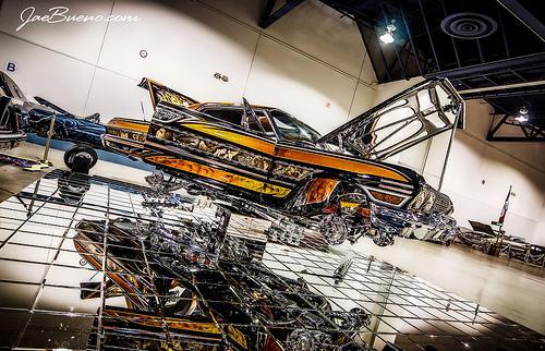

JollySipper Posted August 22, 2016 Author Posted August 22, 2016 Thank you guys for all the discussion on this. I see there are several options through various methods to get a plated chrome finish...... I really have the desire to build myself an all show lowrider (for my own display ) with way too much chrome to be practical for anything other than show Something like this.........
