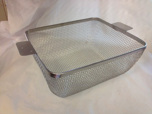

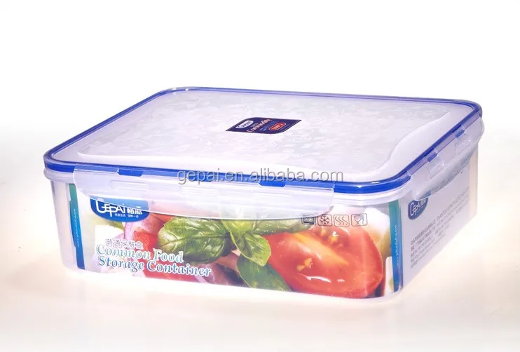

I have two of these containers; one for Super Clean and the other for alcohol. Since the top has a rubber seal and locking cover, I keep them filled at all times and always ready for a stripping job. The container is large enough to fit a body. I also have a stainless steel wire basket used in ultra-sonic cleaners that I can put small parts into and drop into the stripping container without having to fish them out. Got mine at Walmart and found the wire basket on eBay under Jeweler supplies.

I have two buckets of the type used for swimming pool clorine. A 5 gal. and 2.5 gallon. They have very safe and tight locking lids. The I'd be wary of some plastic containers as some are meant to decompose. The one shown with the locking flaps are great.
