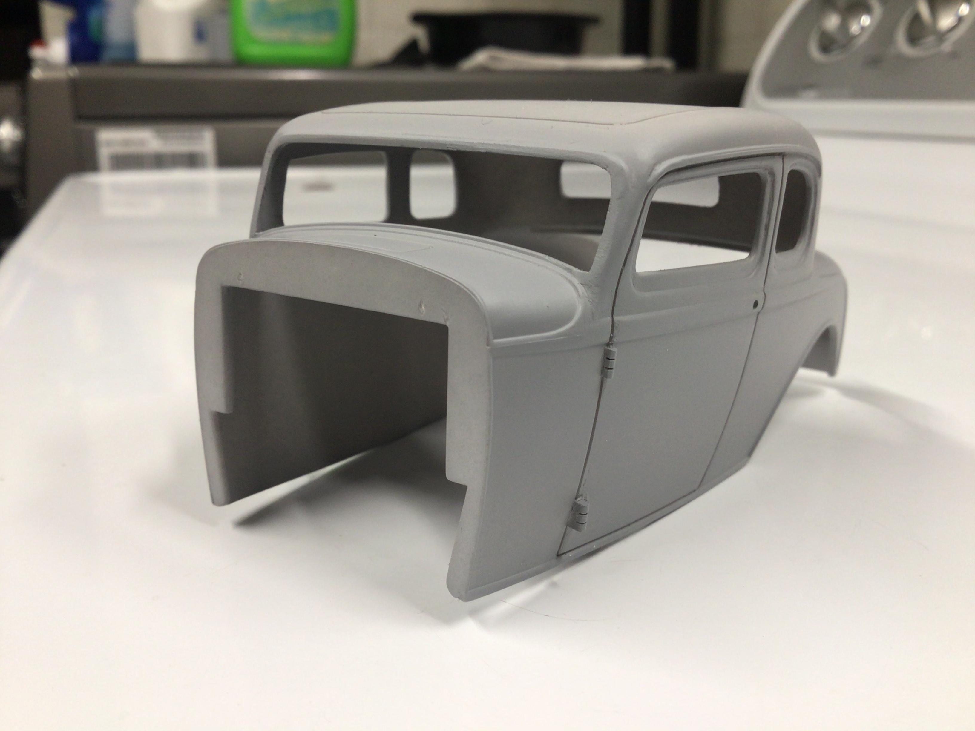

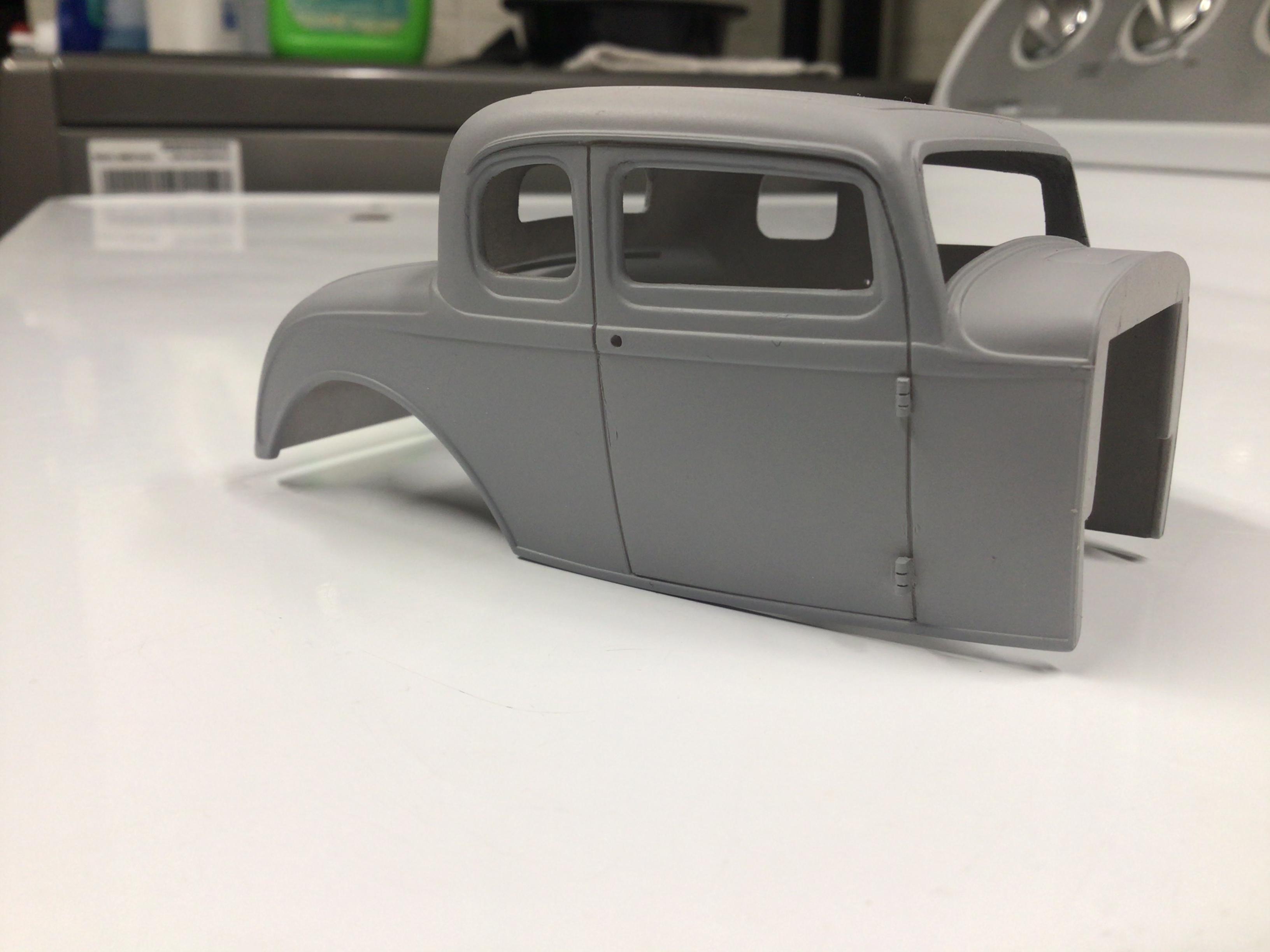

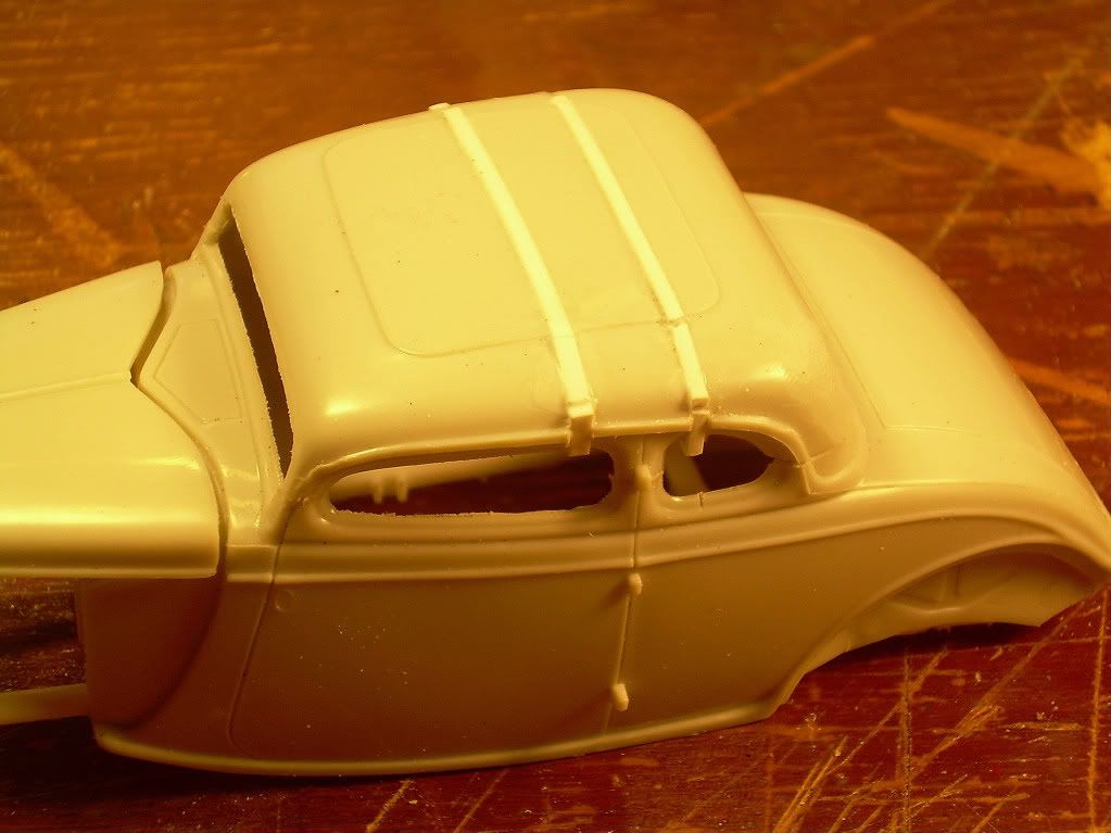

Ace-Garageguy Posted September 7, 2016 Posted September 7, 2016 (edited) I've got a '32 5 window coming my way that will need a chop. I've heard there is a way to chop this without stretching the roof, by cutting the pillars this way and that. Anyone have a link to it? I have searched the forums unsuccessfully for this info. It's pretty straightforward on a model, and a LOT easier than doing it on a real car...but as Art says, the principle is the same. This one is AMT, but the Revell body works exactly the same way. It's been cut approximately 3 scale inches. Come STRAIGHT DOWN on the B-pillar and let the A and C pillars fall where they may. There's enough meat on the C pillars to sculpt them into submission and finish with filler. The A pillars are what take some additional massaging. To get them to line up, just lean the upper portion forward a tad, and lean the lower portion back to get them to align again, in a straight line. I'm often able to bend them cold, but it's a little nerve-wracking waiting for the "snap". A saw-cut in the inside upper and outside lower corners makes it easier. Some minor trimming and fitting will be required, naturally. I ALWAYS f'glass the insides of the joints to give them sufficient strength to sand and polish later on, and fill any remaining gaps from less-than-perfect cuts with a slurry of Cabosil and epoxy. Then you just re-scribe your door cut-lines and finish as usual for any decent quality bodywork. Some people tend to get carried away doing this and make it MUCH harder than it really is, usually with disastrous results. Apply the KISS theory rigorously, and it's a piece of cake. Edited September 8, 2016 by Ace-Garageguy

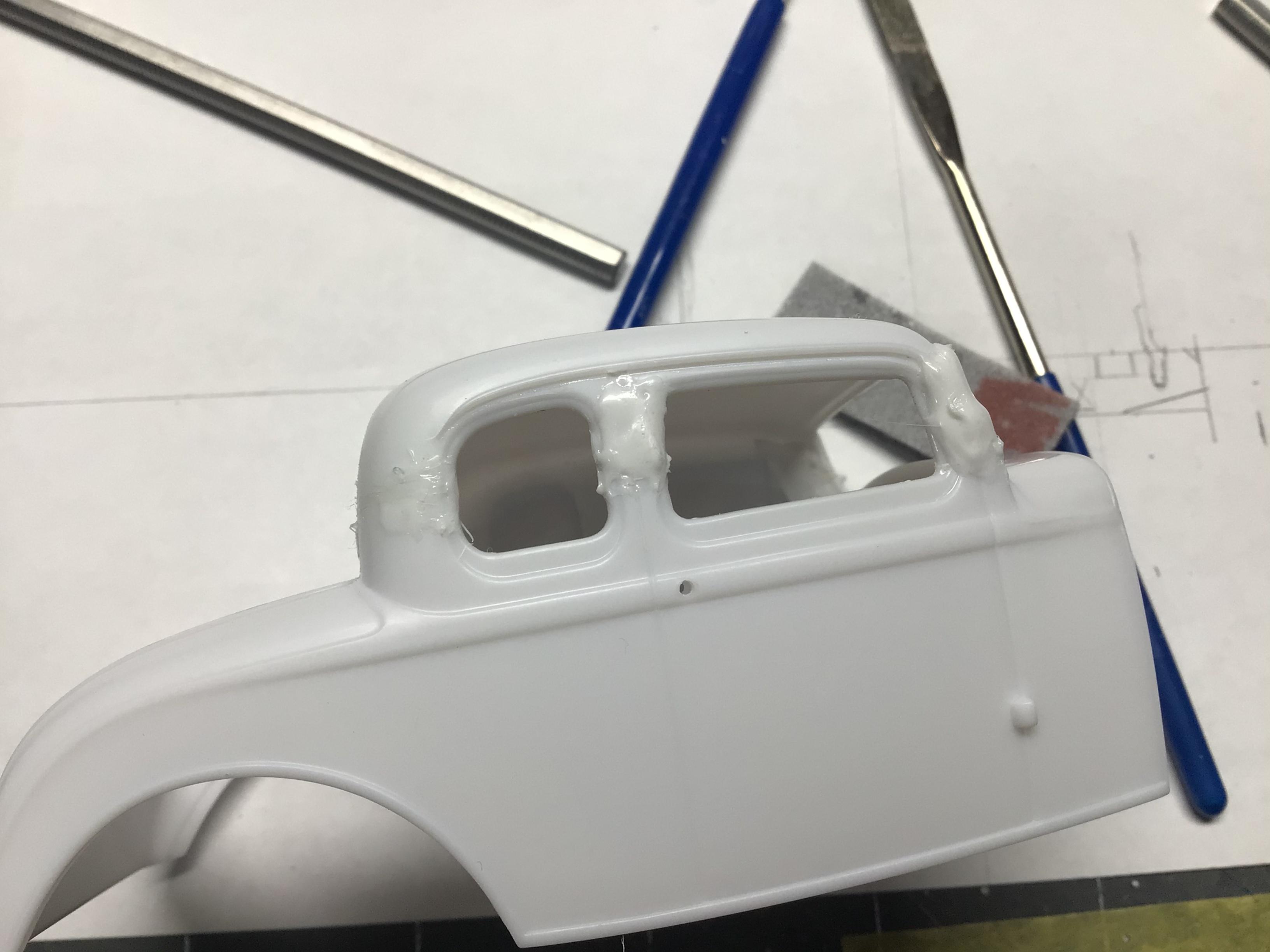

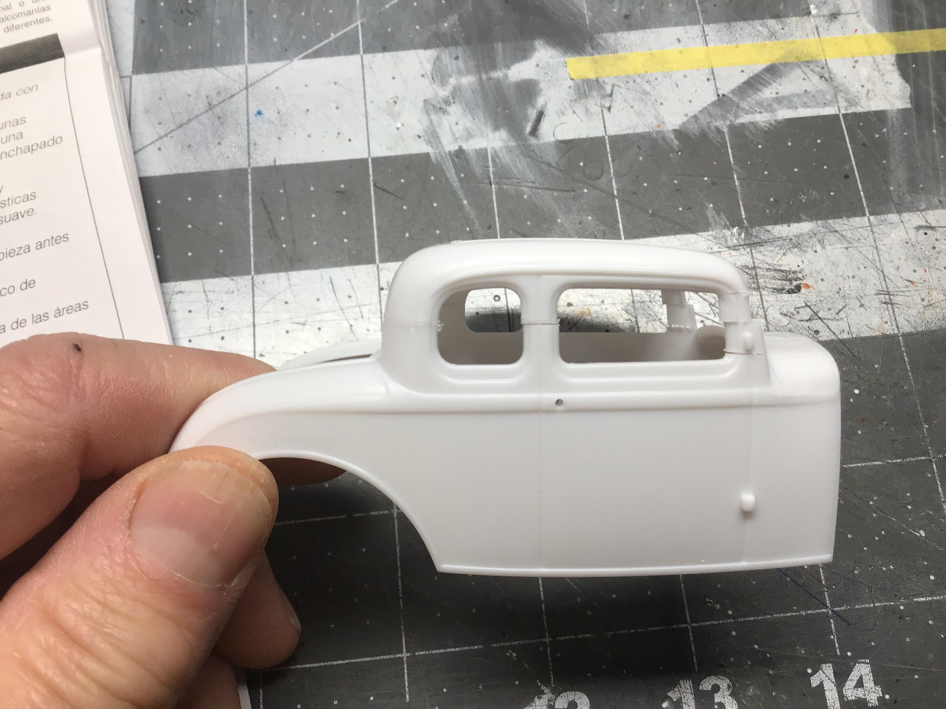

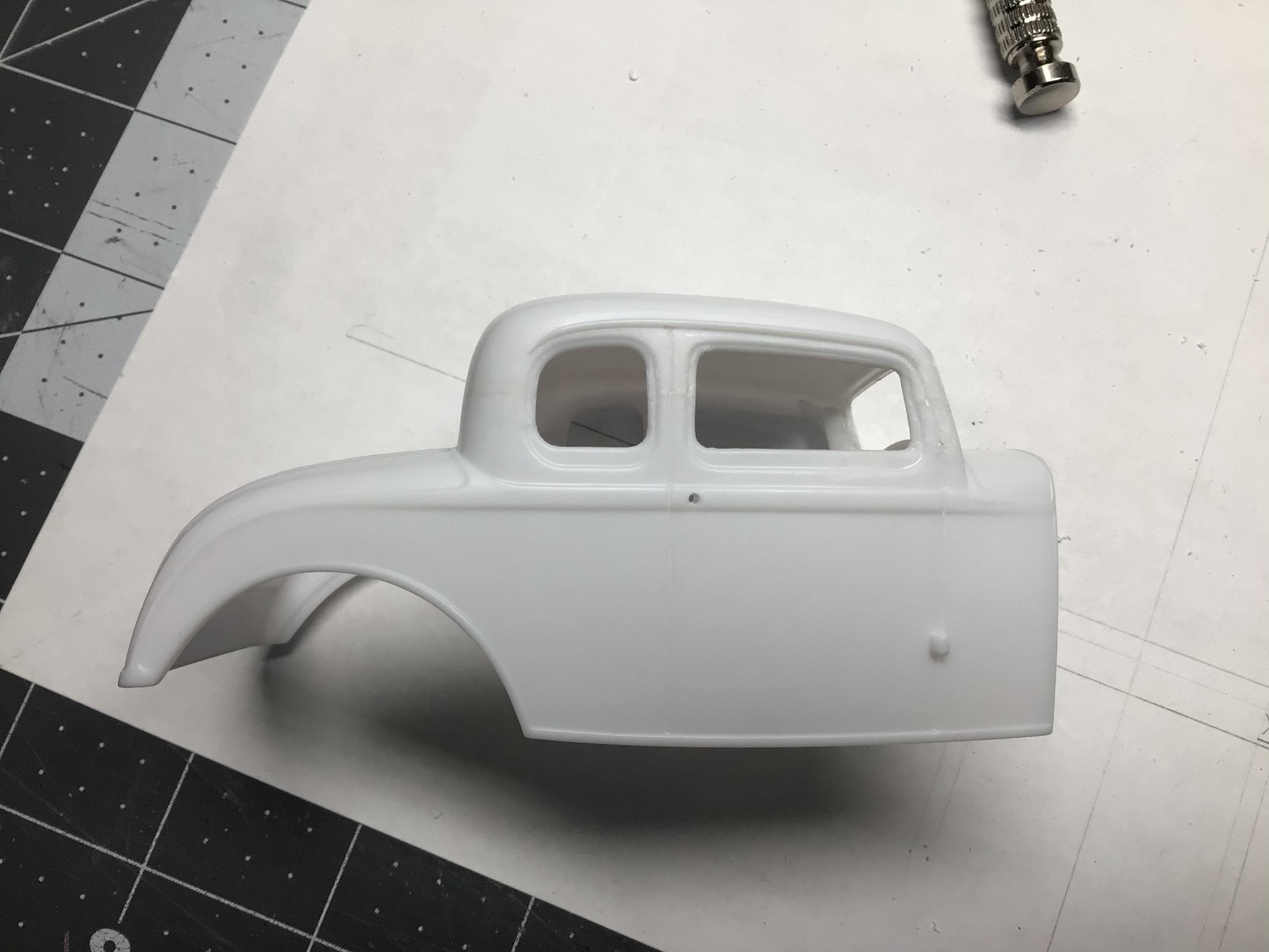

NOBLNG Posted November 10, 2020 Posted November 10, 2020 (edited) No point in starting another thread on this I guess. This is my first attempt at a 3” chop on the Revell ‘32. I found this thread after the fact, so I dropped the C pillar straight down. Accordingly, I had to add a little to the B pillar. I made a slit at the top and bottom of the A pillar and leaned them forward and back till they lined up. The sprue glue I used for filler works great...but it takes a long time to dry into solid styrene again. If I was to do it again (I mean WHEN I do it again?) I may cut the entire A pillar out and then file the length down at the proper angles to fit? All in all, I am happy with the results. Edit: I see some pics of these cars where the upper hinge is on the A pillar, and some where it is just below the belt line. Is that a stock difference, or a modification? Obviously I need to move it down so they will be aligned. Thanks. Edited October 13, 2022 by NOBLNG Change pics 1

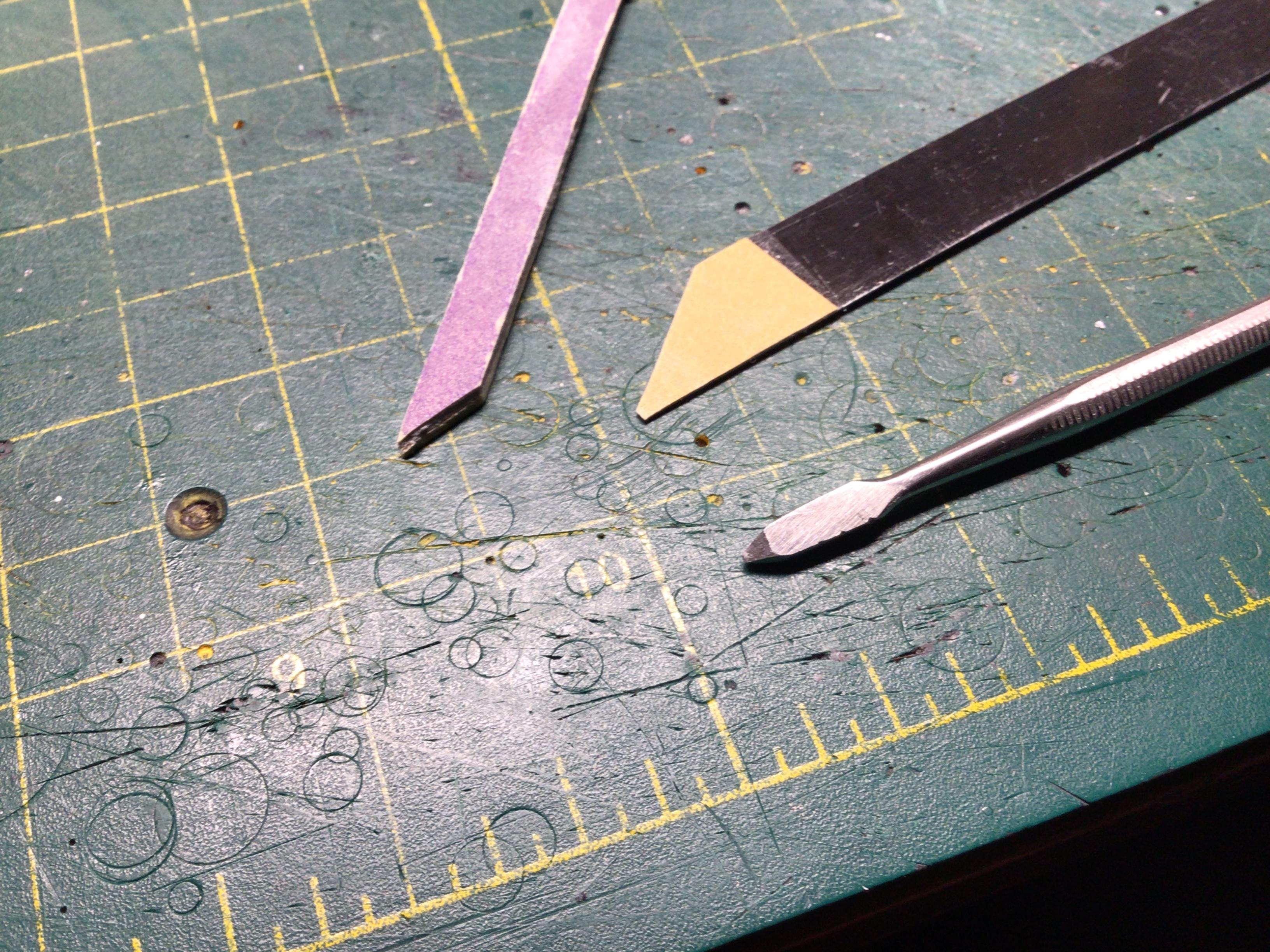

gary jackson Posted November 1, 2023 Posted November 1, 2023 On 11/10/2020 at 1:11 PM, NOBLNG said: No point in starting another thread on this I guess. This is my first attempt at a 3” chop on the Revell ‘32. I found this thread after the fact, so I dropped the C pillar straight down. Accordingly, I had to add a little to the B pillar. I made a slit at the top and bottom of the A pillar and leaned them forward and back till they lined up. The sprue glue I used for filler works great...but it takes a long time to dry into solid styrene again. If I was to do it again (I mean WHEN I do it again?) I may cut the entire A pillar out and then file the length down at the proper angles to fit? All in all, I am happy with the results. Edit: I see some pics of these cars where the upper hinge is on the A pillar, and some where it is just below the belt line. Is that a stock difference, or a modification? Obviously I need to move it down so they will be aligned. Thanks. what did you use to make the flat recesses in the windows im having a little trouble getting those perfect ive tried cut down sandpaper nail files and folded sand paper but i havent found a perfect tool

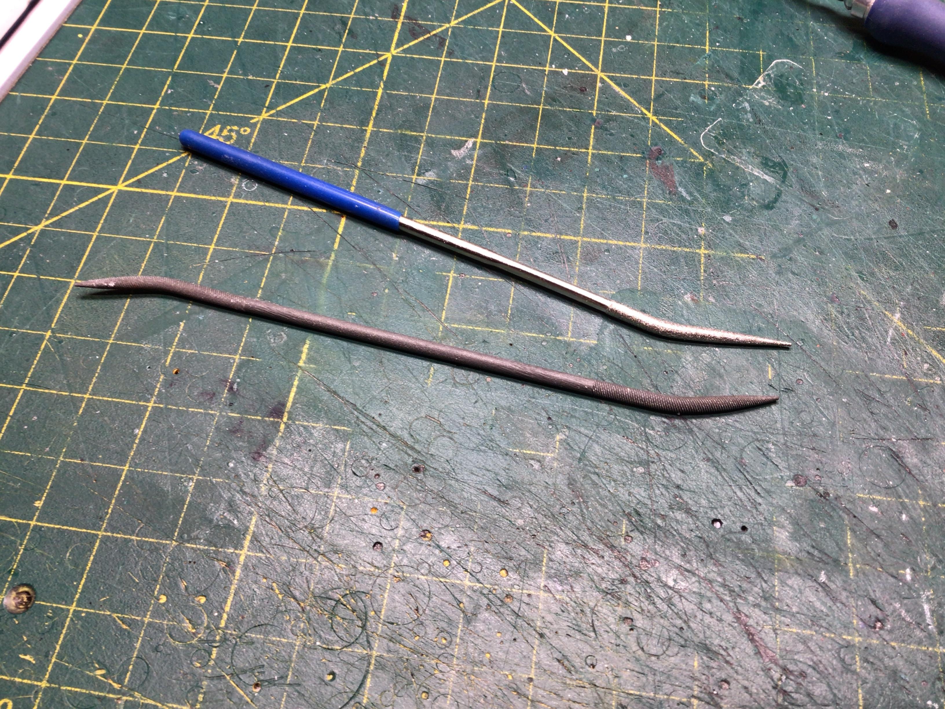

NOBLNG Posted November 2, 2023 Posted November 2, 2023 (edited) On 11/1/2023 at 6:33 PM, gary jackson said: what did you use to make the flat recesses in the windows im having a little trouble getting those perfect ive tried cut down sandpaper nail files and folded sand paper but i havent found a perfect tool Mostly very careful scraping with small tool that I’ve filed to a tiny rounded tip. Then careful sanding, a little putty to fix any gouges and…more sanding. It is a tedious process. Good luck with it.? I also have these curved round files that come in handy for that sort of operation. Edited November 3, 2023 by NOBLNG
