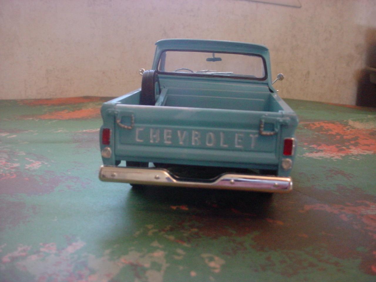

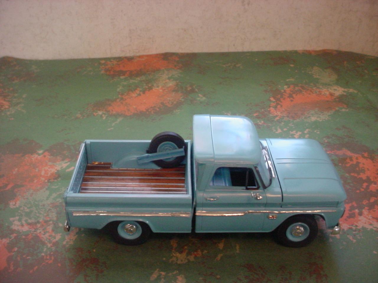

ranma Posted November 5, 2016 Author Posted November 5, 2016 Not quite finished yet, But it is based on one that the farmer that Farmed the land around our house back in the 1970's He bought a new chevy pickup in 74. I added the side trim to the body. The spare tire is where he had his mounted on his 66 C-10.
