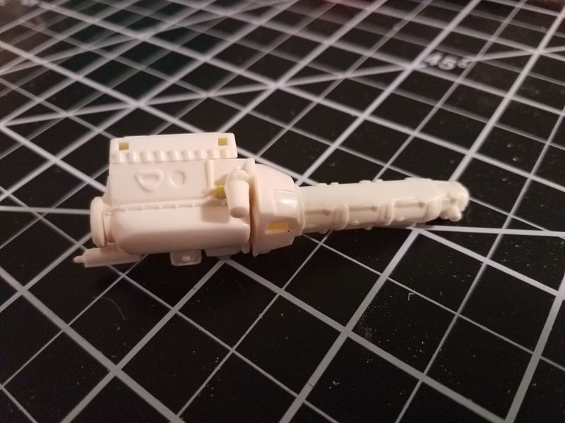

Jantrix Posted January 16, 2017 Posted January 16, 2017 Another question based on this engine. I'm using it in another project. I do NOT have the rest of the Beretta kit for reference. The instructions provide no help in this case. So. Note the bottom of the bell housing in the photo. It's flat with an opening for it to mate with something else, likely a cross member. Without having that cross member in hand how should I finish this piece? Is it supposed to be flat like that? Or shall I add material to round it out? Also, it's obviously a Lenco transmission intended for drag racing. Is it applicable for street use or should I just replace the tranny altogether? Any help is appreciated.
Casey Posted January 17, 2017 Posted January 17, 2017 (edited) There is a matching mounting stud on the floorpan/chassis which you can see in step three of the instructions. There would normally be an inspection cover at the bottom of a bellhousing (if not one on the front face), so in this case I would add one and call it a day. Something as seen on this Chrysler Slant Six: Very few people ran a Lenco trans on the street, so unless it's an ex-race car or a fastest street car type car, a different trans might be a better option. Edited January 17, 2017 by Casey
Ace-Garageguy Posted January 17, 2017 Posted January 17, 2017 (edited) Also, it's obviously a Lenco transmission intended for drag racing. Is it applicable for street use or should I just replace the tranny altogether? Any help is appreciated. You can indeed street-drive a Lenco, but it's not the ideal gearbox for a nice quiet drive in the country on Sunday morning... Edited January 17, 2017 by Ace-Garageguy
Jantrix Posted January 17, 2017 Posted January 17, 2017 Very few people ran a Lenco trans on the street, so unless it's an ex-race car or a fastest street car type car, a different trans might be a better option.You can indeed street-drive a Lenco, but it's not the ideal gearbox for a nice quiet drive in the country on Sunday morning.Thanks both of you. I have changed out the tranny for something more street worthy. Much appreciated.
