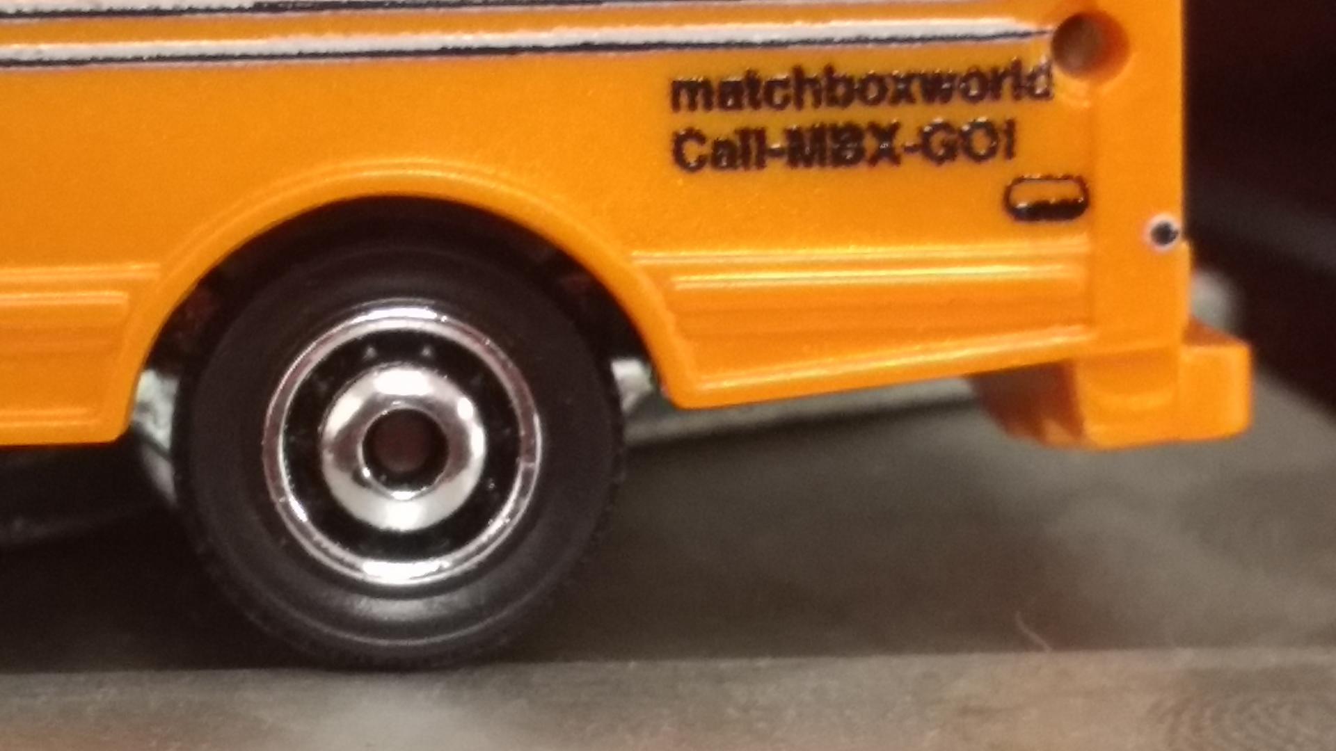

The new cameras in phones are getting better and better.  I use my phone for any model pictures.  Moto G4.  It will "zoom" in almost as close as my work buddy's Samsung Galaxy 7 or 8.  We did a direct comparison photographing some print on a Matchbox that we couldn't really make out with normal vision.   These are not actually zoomed, but taken at actual distance.
Just have to let it focus first, then tap to capture.  The zoom is not as good as letting the camera in phone do it's thing.  The zoom on mine fuzzes or pixelaters weirdly.  (Cheaper phone)  Yes the depth of field is limited, but so far, I can live with it and it is capturing the details I want to show you guys pretty much as good as I could do with a lot of setting work.  I am definitely a "casual user".   I have tried the macro setrting and it doesn't seem much better.  I may try it and compare the DOF.

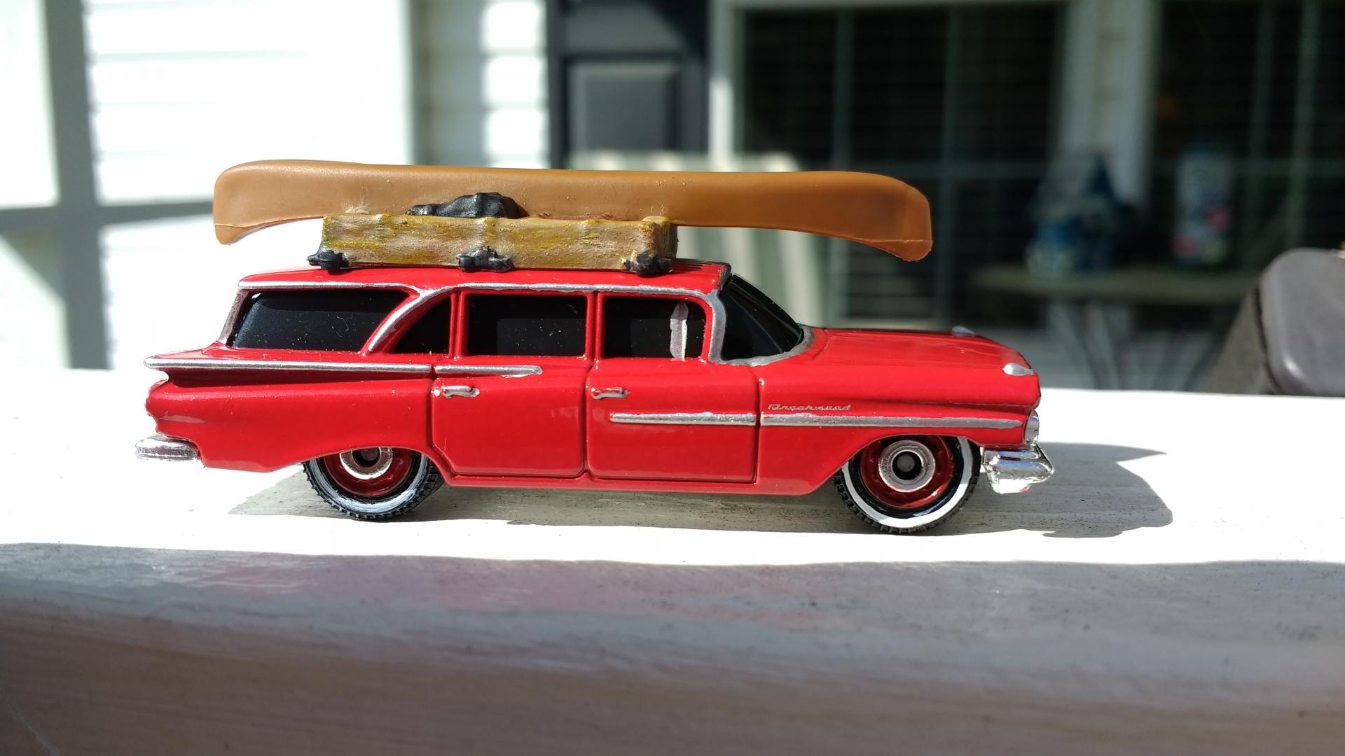

Also, when taking a picture of a model, try to get to an angle that you would normally view the car if you were standing there.  looks less like a model and more realistic, in my opinion.  Yes do some overall shots, but try a few close ups like you were looking in the window, or standing in front or whatever.  Photos below are taken with no messing with the settings.  Just letting the camera do it's thing.  No zoom, nothing.   Yes, it took a couple shots to get it focused exactly, but just in giving lens time to focus correctly.
