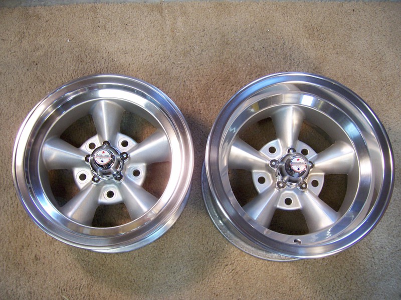

Monty Posted February 14, 2017 Posted February 14, 2017 I'd like to replicate the finish on these spokes and center hub on some model wheels but don't know what paint etc to use. I'd like your recommendations, but if possible, I'd also like to see your wheels to see how close you got to what I'm after. TIA to any who can help on this.

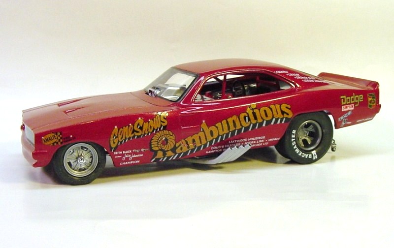

Ace-Garageguy Posted February 14, 2017 Posted February 14, 2017 (edited) The rims are obviously polished aluminum, and you're going to need either a "buffing-metalizer" (Testors shown below on the REAR RIMS) or as mentioned (for a brighter finish) Spaz Stix, also available in rattlecans. Look for a YouTube video about using the stuff. You'll be sold. Alclad is airbrush only, but done right, it's really nice too. Videos using the stuff and the results you can expect are also available on YouTube. The centers in your photo are not as-cast grainy aluminum, but are rather a gloss fine-grained aluminum paint with a clear top-coat. I believe one of the Tamiya silvers is about the finest grained color like this you'll find. It's going to be tricky to get exactly the finish you want, as the Tamiya silver may be top-coated with clear to get that effect, but Spaz Stix or Testors buffing-metalizer can NOT be cleared without ruining the effect of polished metal...no matter what you may hear elsewhere. That means you'll have to do some VERY careful masking, and do things in a particular order. Edited February 14, 2017 by Ace-Garageguy

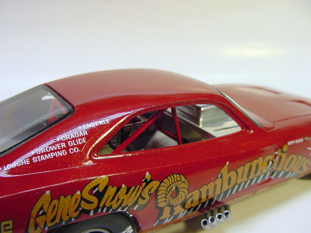

Ace-Garageguy Posted February 14, 2017 Posted February 14, 2017 The COWL on this model is about the best you can get as far as "polished metal" from Testors buffing metalizer. Spaz Stix, done right, gives a clearer reflection.
