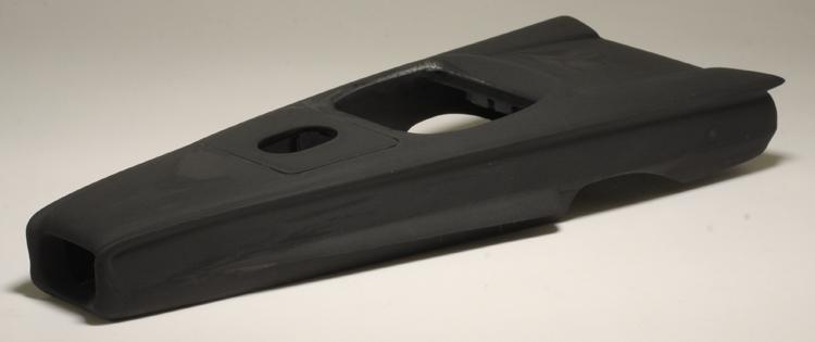

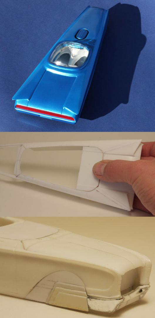

Here's a photo of my first build of it as a curbside in 2011 along with some in-process shots of some of the bodywork. I'm making some styling improvements to the sides but I don't have a mock-up photo to show. Except for color, the photo of the blue car is about how the new yellow version should look from this angle. The interior and bubble top are from Roth's Beatnik Bandit.

Now, that's wild right there. My restrictions were always to the GSL-chosen model kits for the "Group" category, but there's really no limit to what can be done with other vehicles. Let the creativity fly!

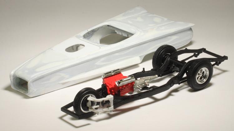

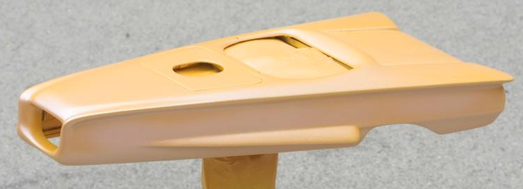

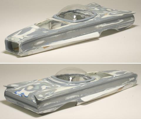

Here's the rough body. It will have a hinged hood (not made yet). Feel free to leave comments (positive, negative, recommendations, etc.).
IMG_3189-3191sm.thumb.jpg.aa1931d666315d
IMG_3278-3279sm.thumb.jpg.e5e1bdc4e4767d

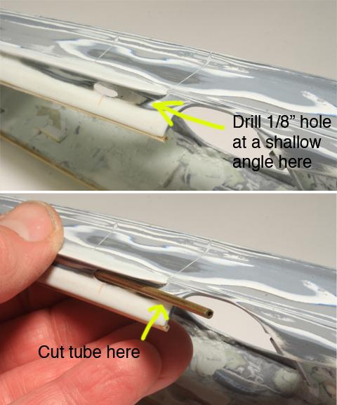

The side wing-fins will have an exhaust pipe exiting from the rear. I've filled in door lines scribed when I thought that I wanted them. Now, the driver and passenger will have to hop in "sports car style" as on the original blue model.

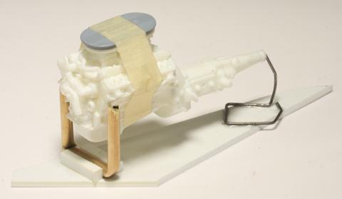

Here's an engine stand built from sheet plastic, brass tubing (with notches at the top to fit the engine mount "ears") and some steel wire extending into the rear of the trans. The taped-together engine was needed to locate the frame to the body. Still to be done will be to use the mock-up to locate a hole in the yet-to-be-made hood.

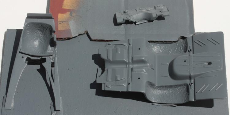

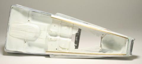

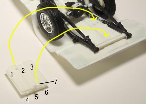

I'm making lots of progress but very little of it shows. Here are the floor pans (front and rear are needed for assembly reasons) test-fitted into the body.
IMG_3283sm.thumb.jpg.42f1d50bdb782b48335
Each pan is made of dozens of pieces plus more as reinforcements on the unseen top side. It's really a job to fill and smooth the joints. There is still more to do.

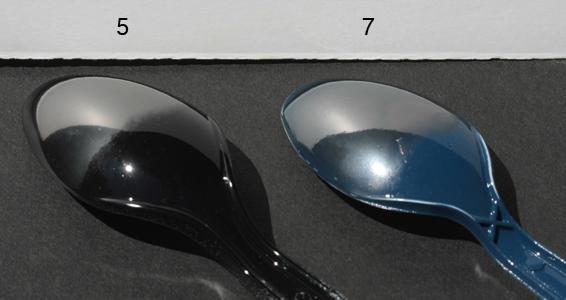

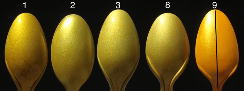

Spoon tests. Scroll down to see the colors that were used.
IMG_3291sm.thumb.jpg.72144a988316a8029cd
Some close-ups of two:
IMG_3291sm3cu.thumb.jpg.36f6261946f135fe IMG_3291sm9cu.thumb.jpg.7eeaef90d5262b37
1. Clear spoon
Tamiya Fine Surface Primer (L) White 87044
Model Master German Silver 2914
Tamiya X-24 Clear Yellow, diluted, 30 psi Badger 150
Testors One-Coat Clear Lacquer 1834
2. Clear spoon
Createx Pearl White 5310, from bottle, 40 psi Badger 150
3. Clear spoon
Silver flake in clear gloss, 40 psi Badger 150
8. White spoon
Testors 1214 Gloss Yellow 1214
9. Clear spoon
Left 1/2 of spoon: Createx Pearl White 5310, from bottle, 40 psi Badger 150
Right 1/2 of spoon: Silver flake in clear gloss, 40 psi Badger 150

5. Clear spoon
Model Master Gloss Black 1947
Upper 2/3 of spoon: C1 Metalizer
7. White spoon
Model Master Blue Angel Blue 1972
Edited by chepp

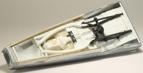

Here's the latest. I let myself get distracted by a "quick" Corvair build for the Group 17 class that took a week and a day.
IMG_3359sm.thumb.jpg.a5c3fc0b68209aeaa27
IMG_3360sm.thumb.jpg.ae60b8cb6b4a65c56f3
Once the floorboards are in place and the body is on, the chassis will only be visible from below.
Yes, I know the exhaust manifolds are on the wrong heads and upside down — they will feed into the side exhausts. The model will not have an opening hood.

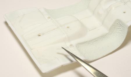

To add some visual interest in featureless floor areas I made some 10mm long .040" half-round pieces to simulate pressed-in stiffeners. They're hard to see here but show up in the photo below. To avoid having to smoothly fill the pieced-together wheel houses I spread filler on with my finger. As it set up I played around with it to make a rough finish that simulates a sprayed-on sound deadener.

Time is getting short. I'm finished with fitting, filling, sanding and primering the floor pans despite their shortcomings.

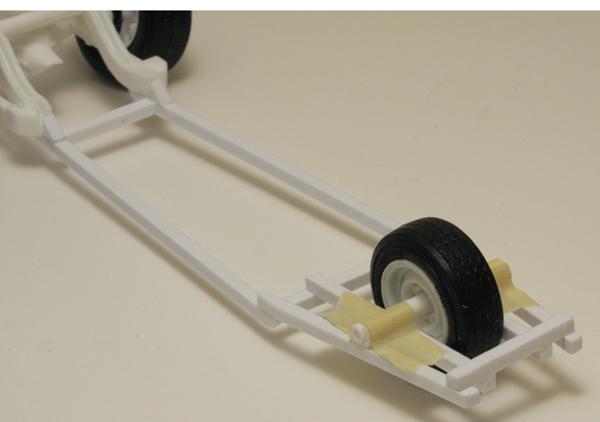

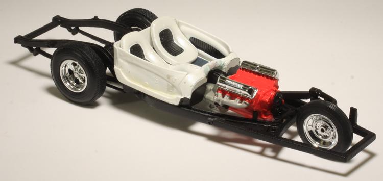

...While I had a usable chassis at the back, the front had minimal prong-looking suspension for the wheel and otherwise very unrealistic plastic scrap holding the structure together...
Maybe great minds think alike. Here's what my early-version frame looked like.
IMG_4858sm.thumb.jpg.e94976198f8af9dafaf
