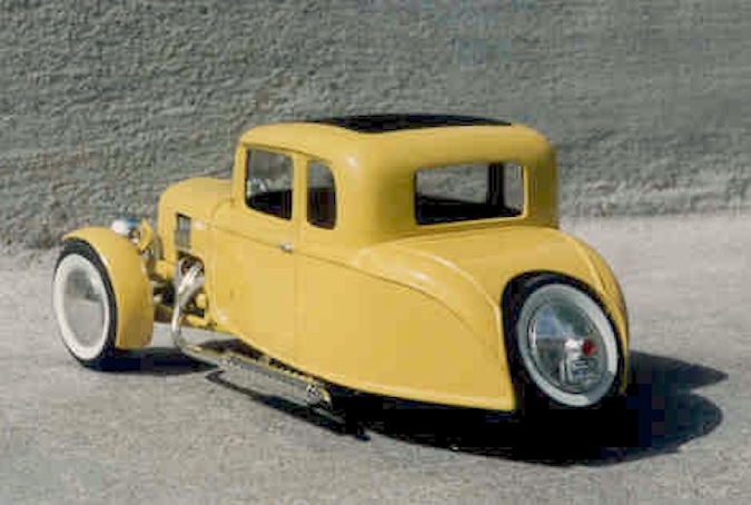

Russell C Posted April 27, 2017 Posted April 27, 2017 Well, these aren't lakes pipes on this one I built way back in the early 1990s, and it probably wouldn't fit the bill for at least one other reason ..... 1
