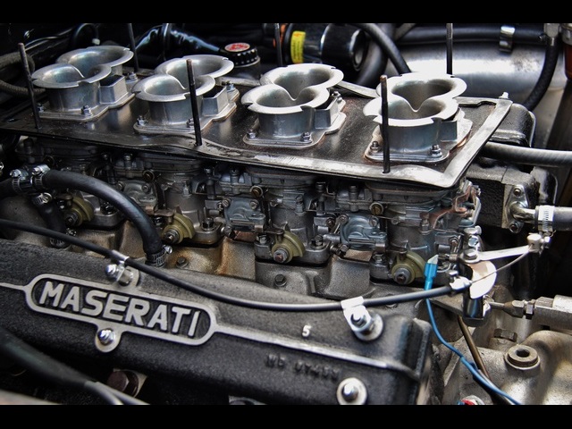

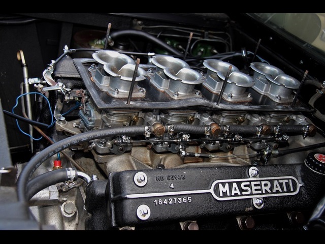

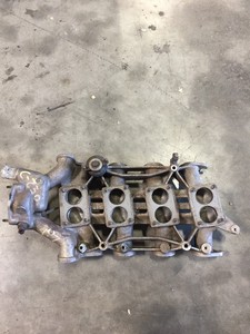

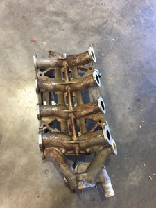

For anyone wishing to upgrade the engine, here's a couple of shots of the intake manifold for the Bora (probably the same as the old Quattroporte too, as the engines are basically the same). The intake port-runners are evenly spaced like some Ford and Chrysler and the Chevy LS engines, as opposed to having paired runners like the old smallblock Chebby.
                                MASERATI BORA INDY GHIBLI QUATTROPORTE SERIES ONE INTAKE MANIFOLD DCNF STYLE          MASERATI BORA INDY GHIBLI QUATTROPORTE SERIES ONE INTAKE MANIFOLD DCNF STYLE
And Mr. Bacon, the crackle-finish you came up with for the cam covers is very believable. Nice trick.
