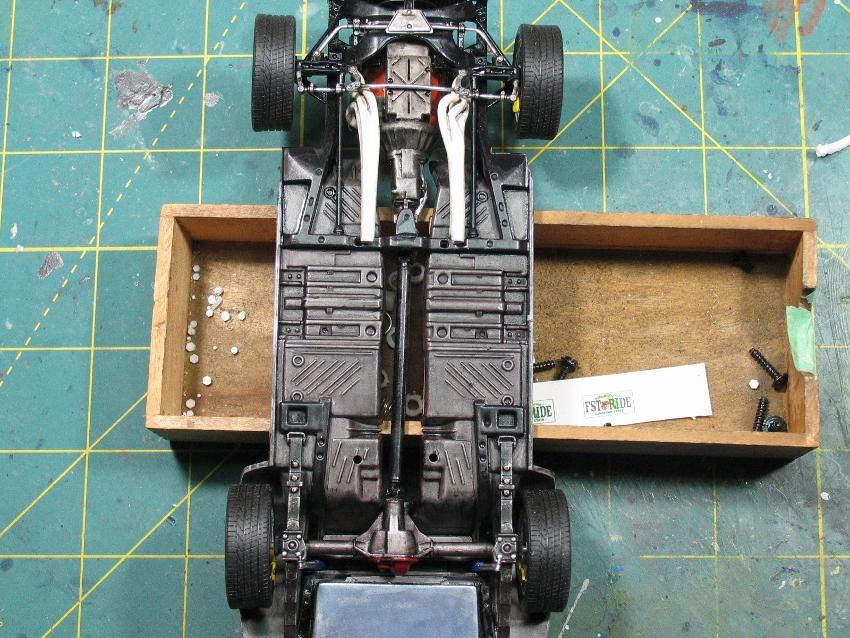

That's what I do, spray the whole thing a grey primer, then mask the pans and spray the frame black, then a bit of grime wash,..
Not exact, but I like it

I have a couple Revell 55-57 Chevys in progress. On each I primered the entire chassis, then airbrush the frame rails semi gloss black. Masked the entire frame with different widths Tamiya tape and Jammy Dog tape. Paint the floor pan in red oxide primer. Mask off the center floor pans between the frame rails. Over spray the outside edge of the floor pan in body color. Unmask and done.

Ok, I've given the chassis pan a squirt of flat black. Now how do I mask off the frame, keeping it black, to paint the rest of it ?
You might be surprised at how many of us just shoot the whole chassis in flat or semigloss black, call it "undercoating," and are done with it. (At least on less-than-"special" builds.)

That was pretty much standard procedure "back in the day" and for many, many years. It was only in the late '90s or early 2000s that people started discovering the real cars often/usually had primered floor pans and black frame rails. And then modelers started trying to replicate this.
My standard procedure is to shoot the whole chassis in flat or semigloss black and then do the gas tank in flat steel and the exhausts (if molded in) in flat steel or flat aluminum. But then I only build for my own enjoyment.
