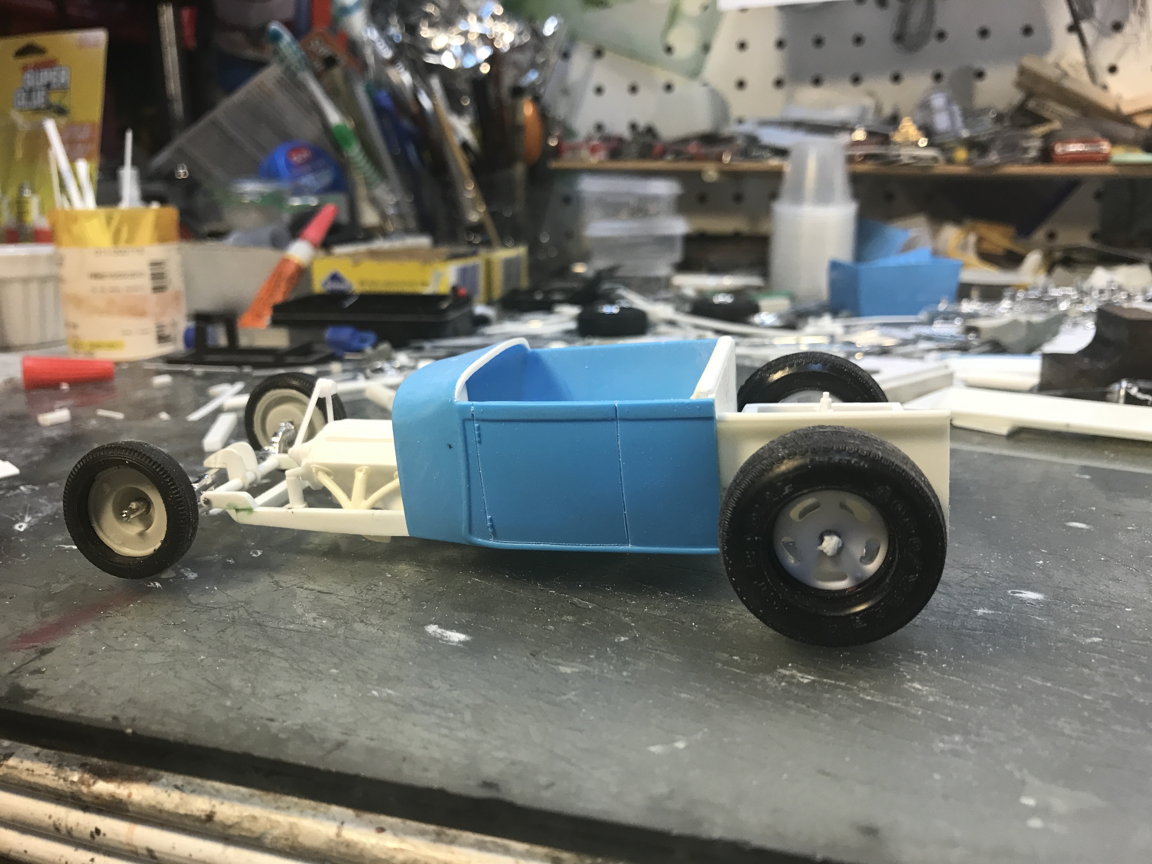

Rocking Rodney Rat Posted November 18, 2017 Author Posted November 18, 2017 Thanks, yeah, I think narrowing the cab in the back makes it a bit more svelte. I never liked that trapezoidal shape... -RRR

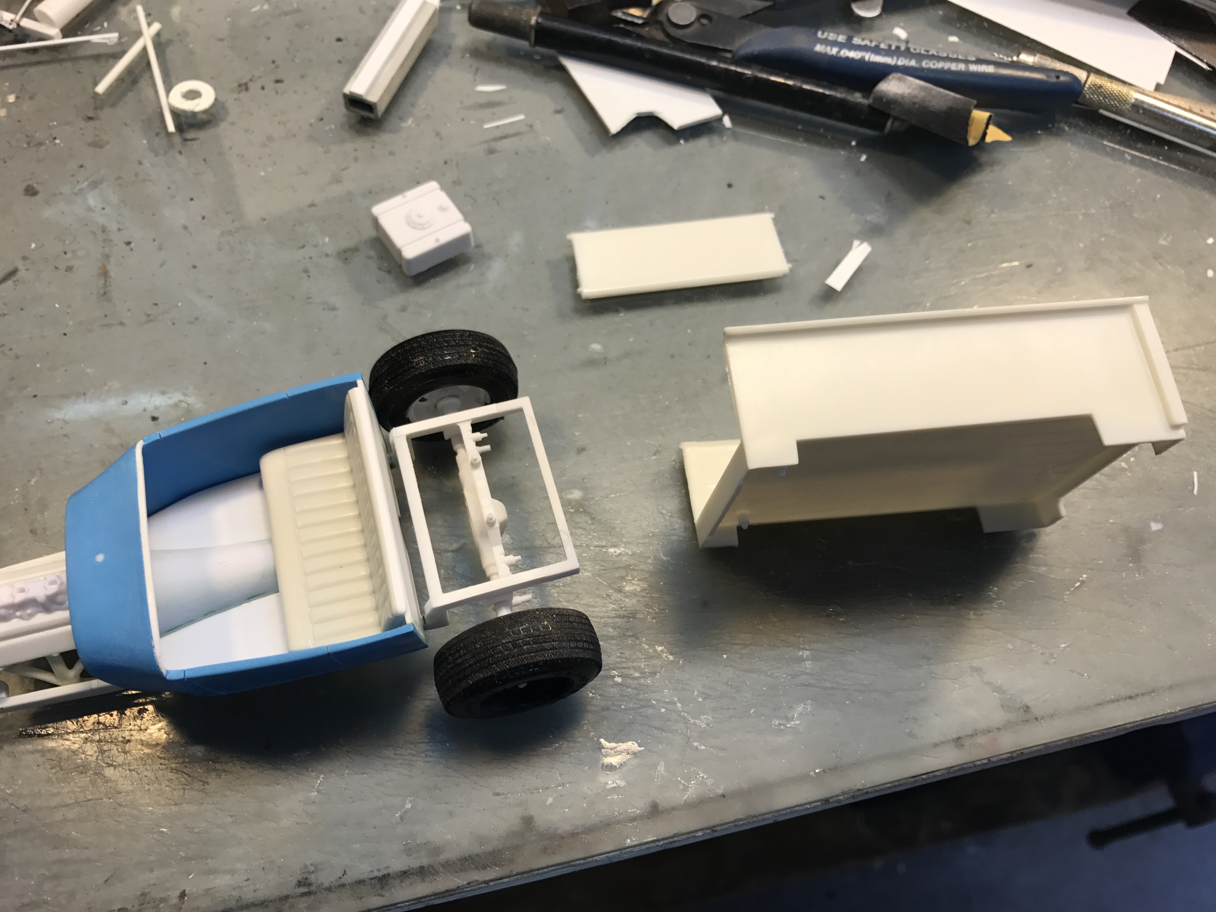

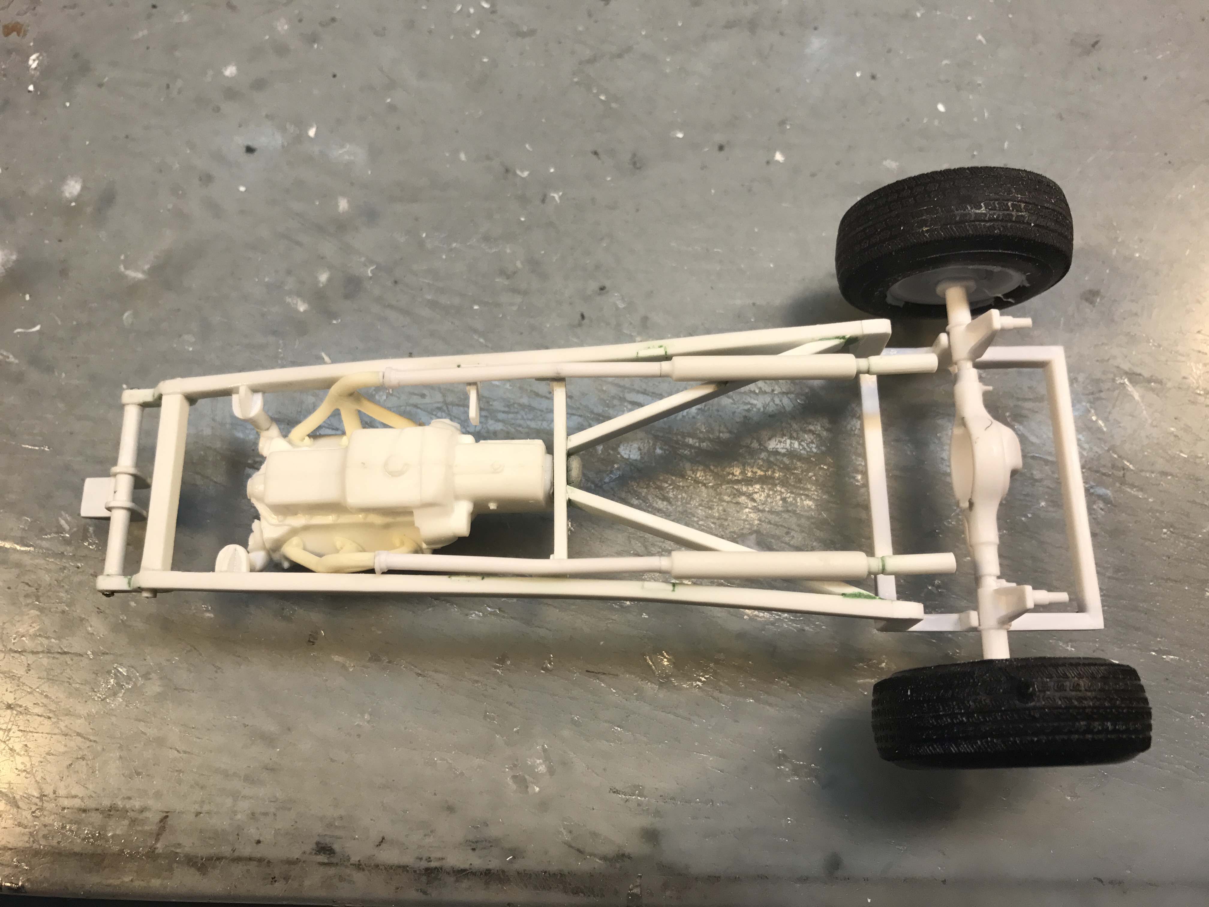

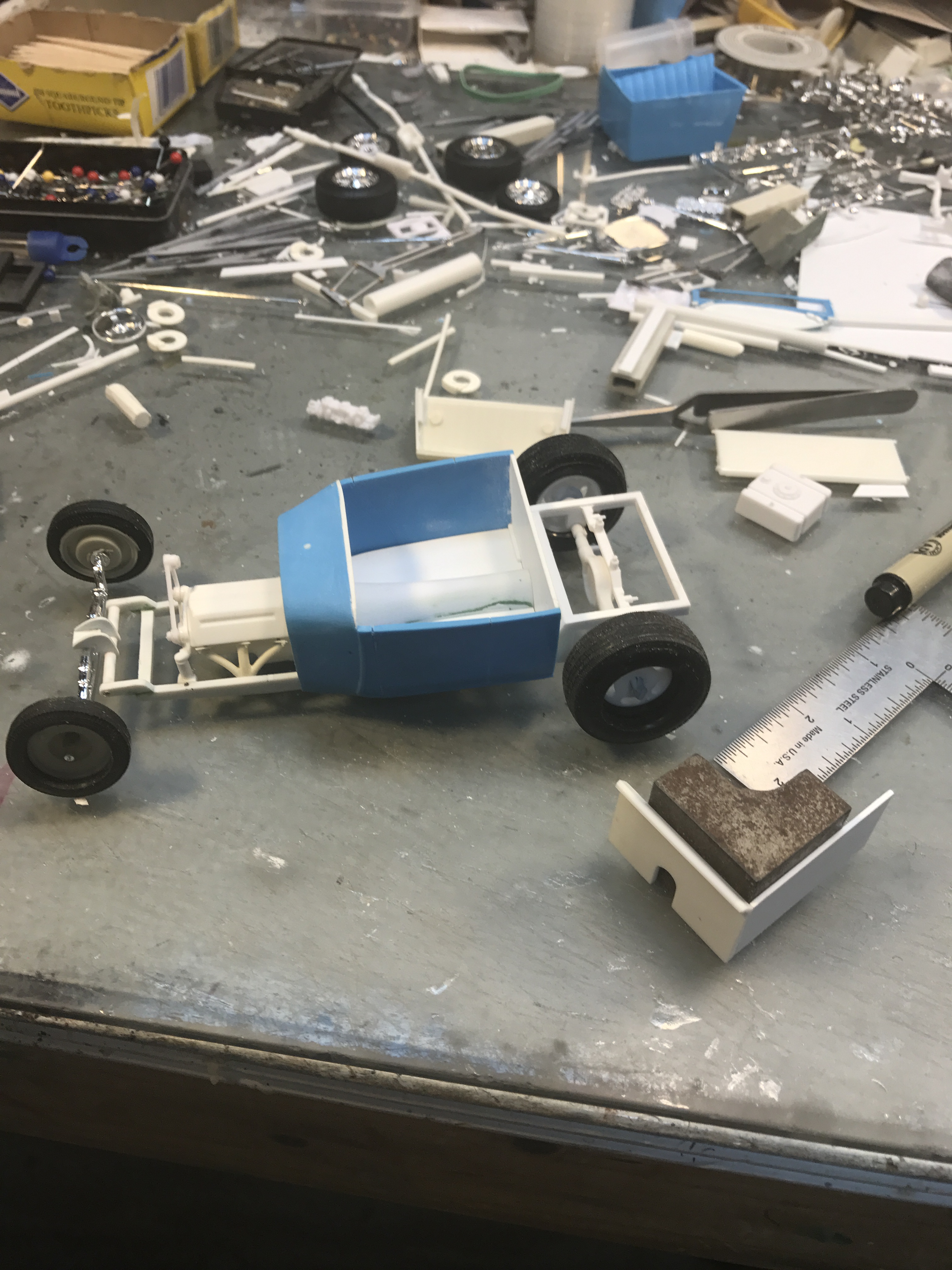

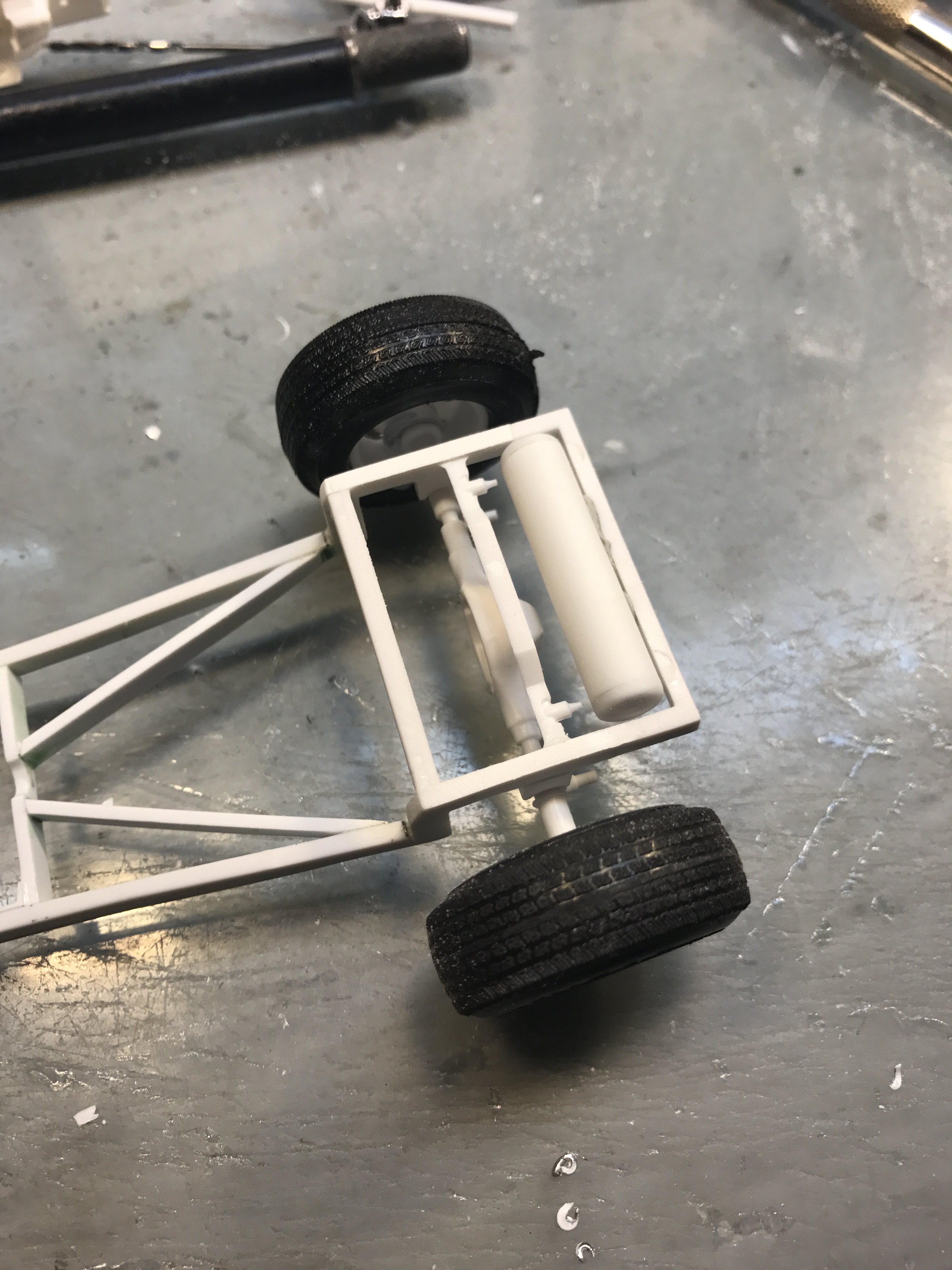

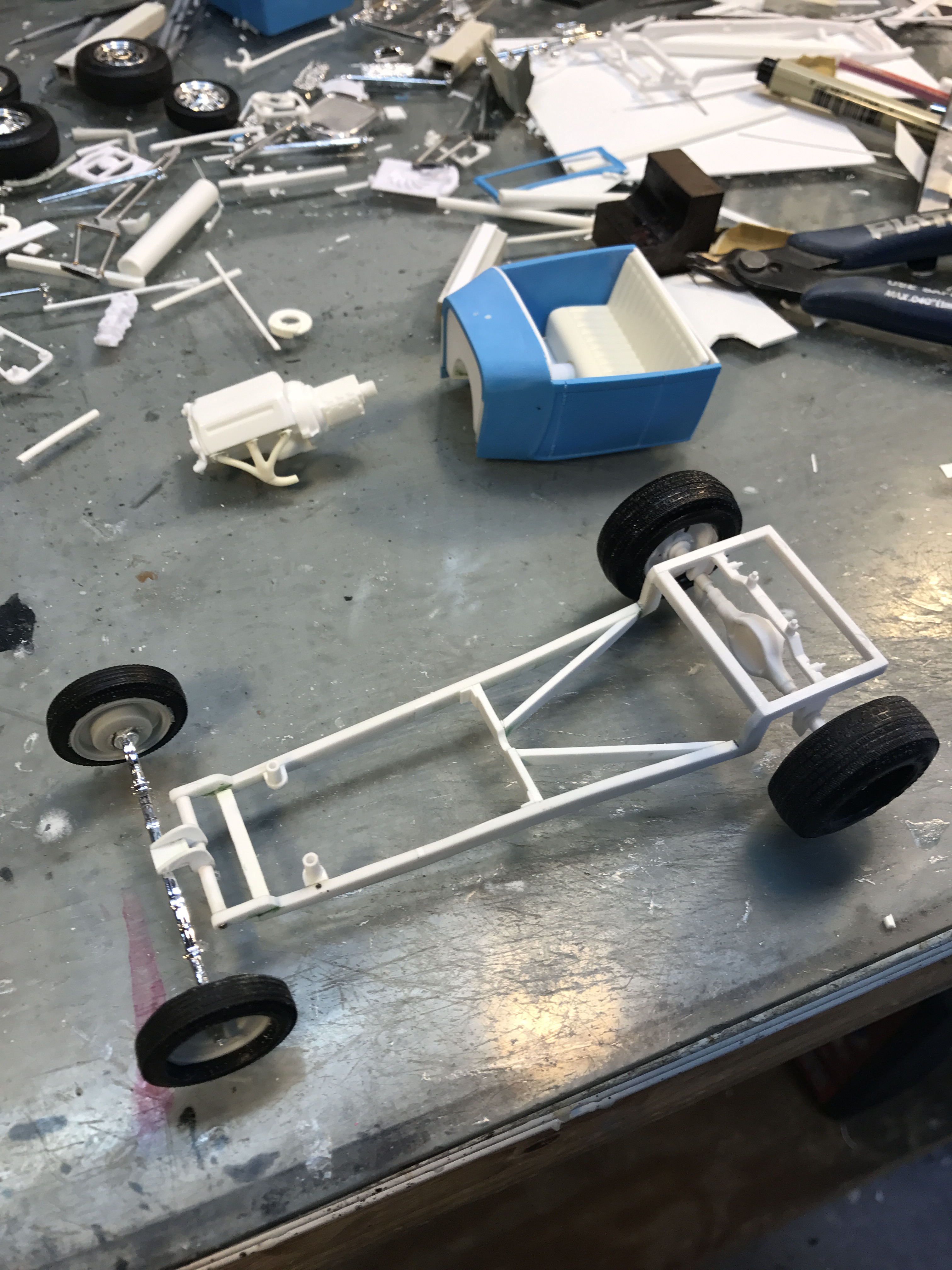

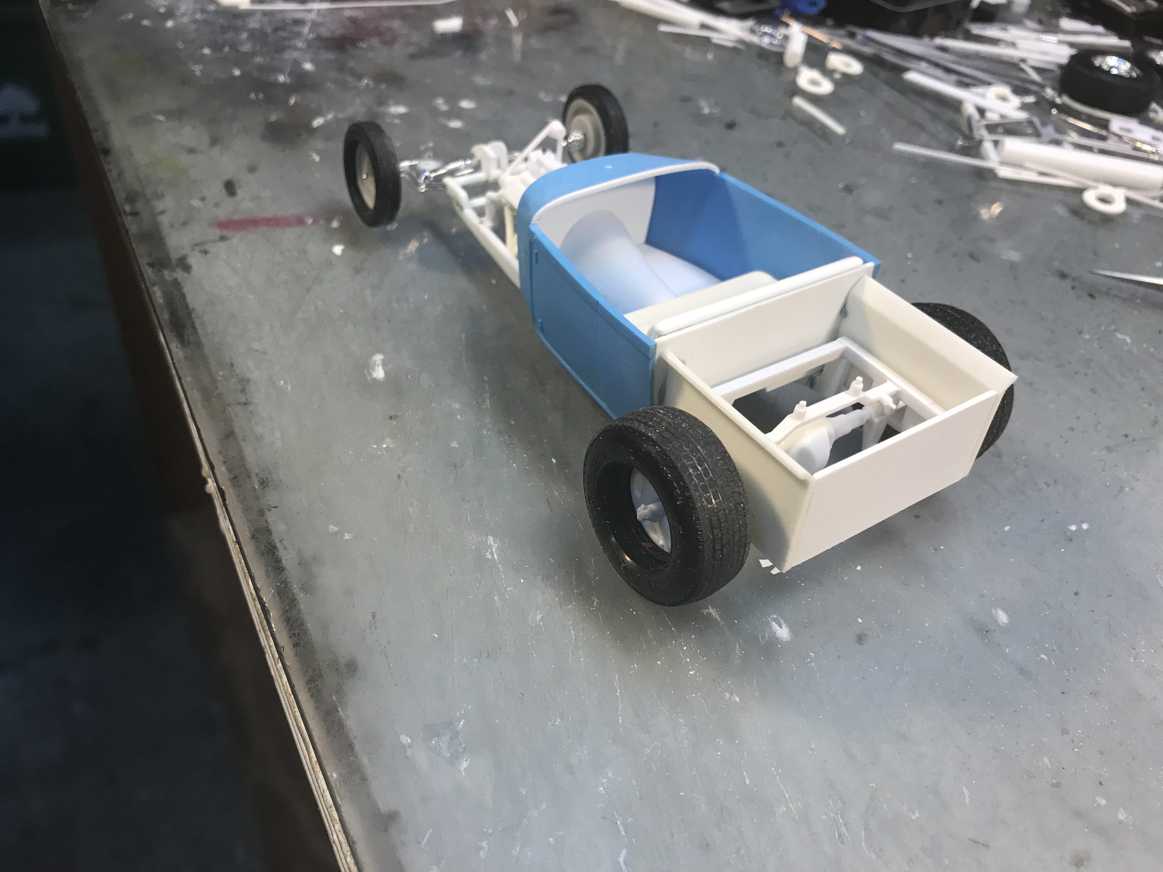

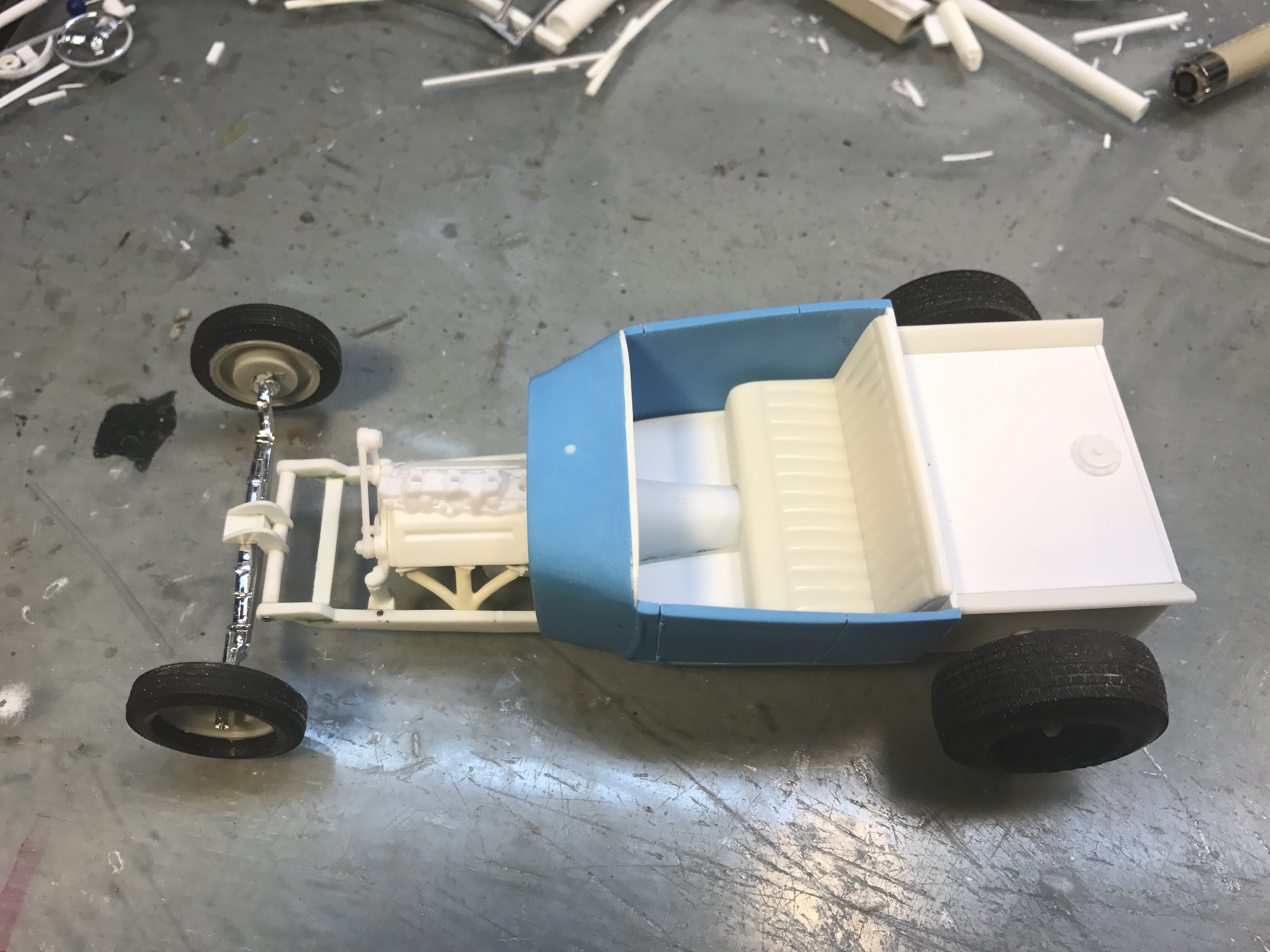

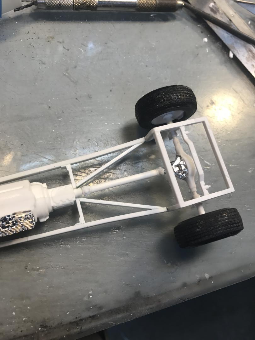

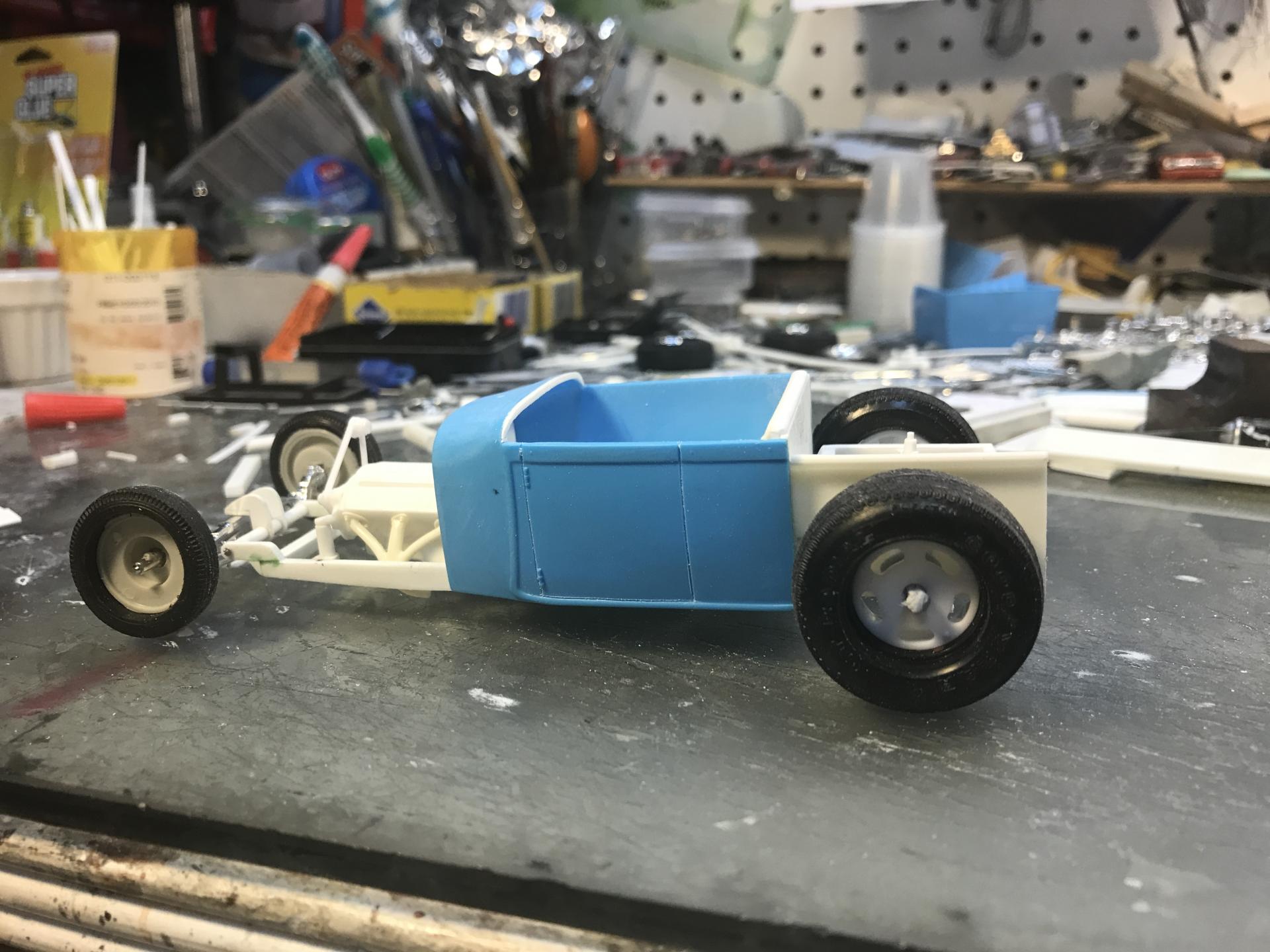

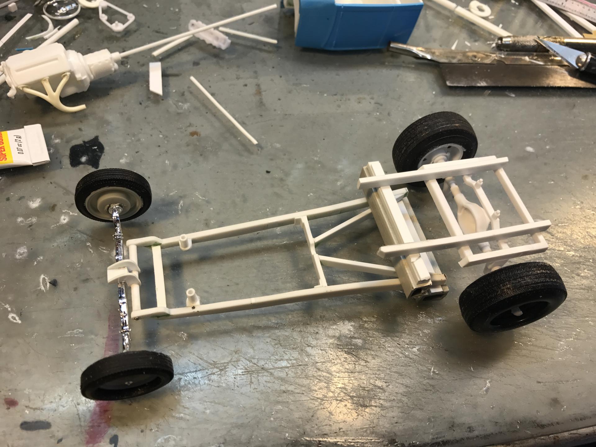

Rocking Rodney Rat Posted November 20, 2017 Author Posted November 20, 2017 A busy weekend at the Hollywood shop of K&R Kustoms+Rods....I started by finishing up the frame. I cut the rear portion off, shortened it up a tad, set the frame at ride height, fabbed up a crude but effective jig and re-attached the frame with the new rear 'z' (then pried off the super-glued on jig)...up on all fours at last!!! Next up, the bed. I started with the bed out of the AMT '53 Ford pickup, cut the side panels to length (short), hogged out an axle poke thru, made a bed cover and hacked the gas cap off of the tank from the Revell Model A series...thanks for looking... -RRR

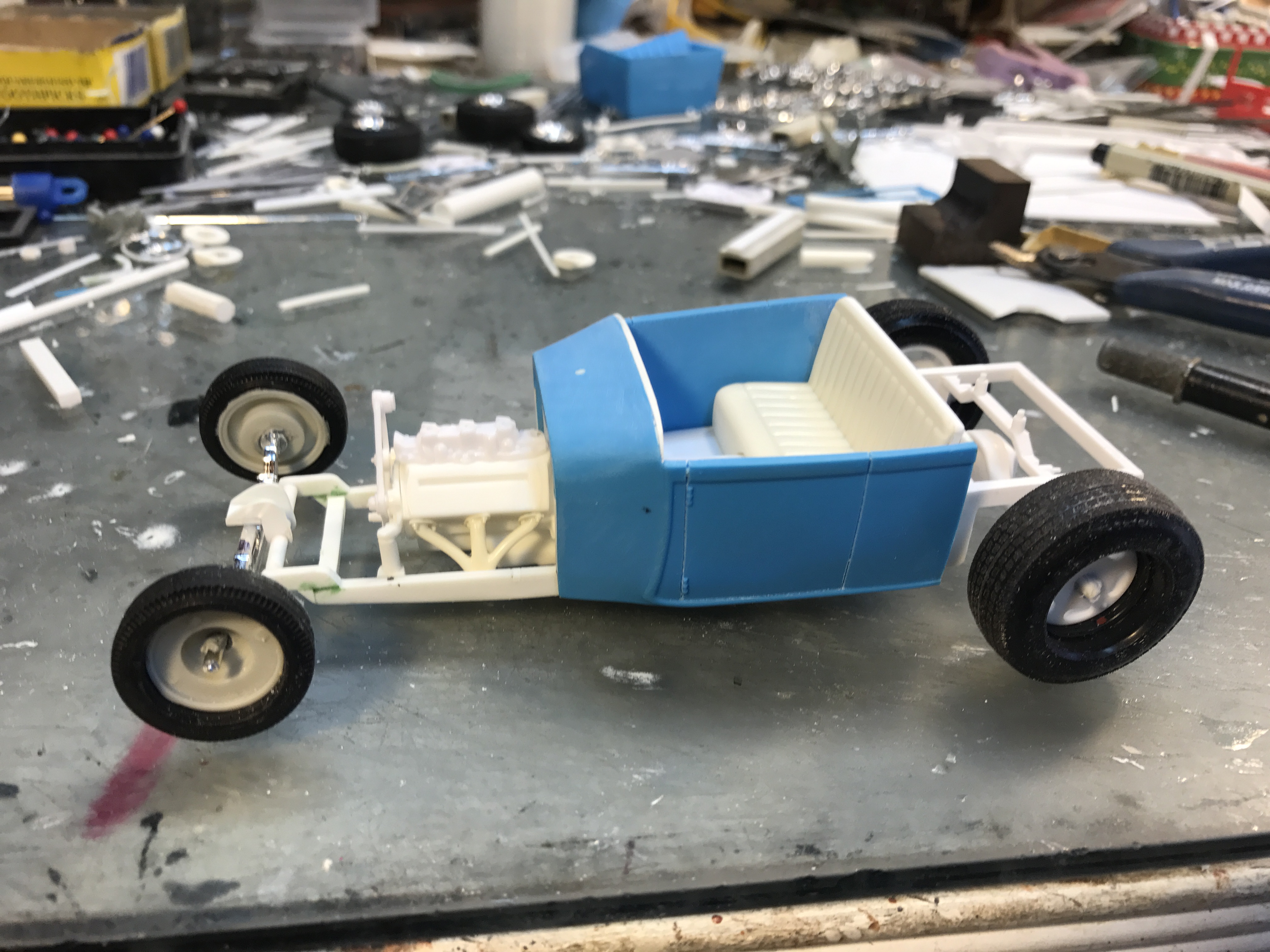

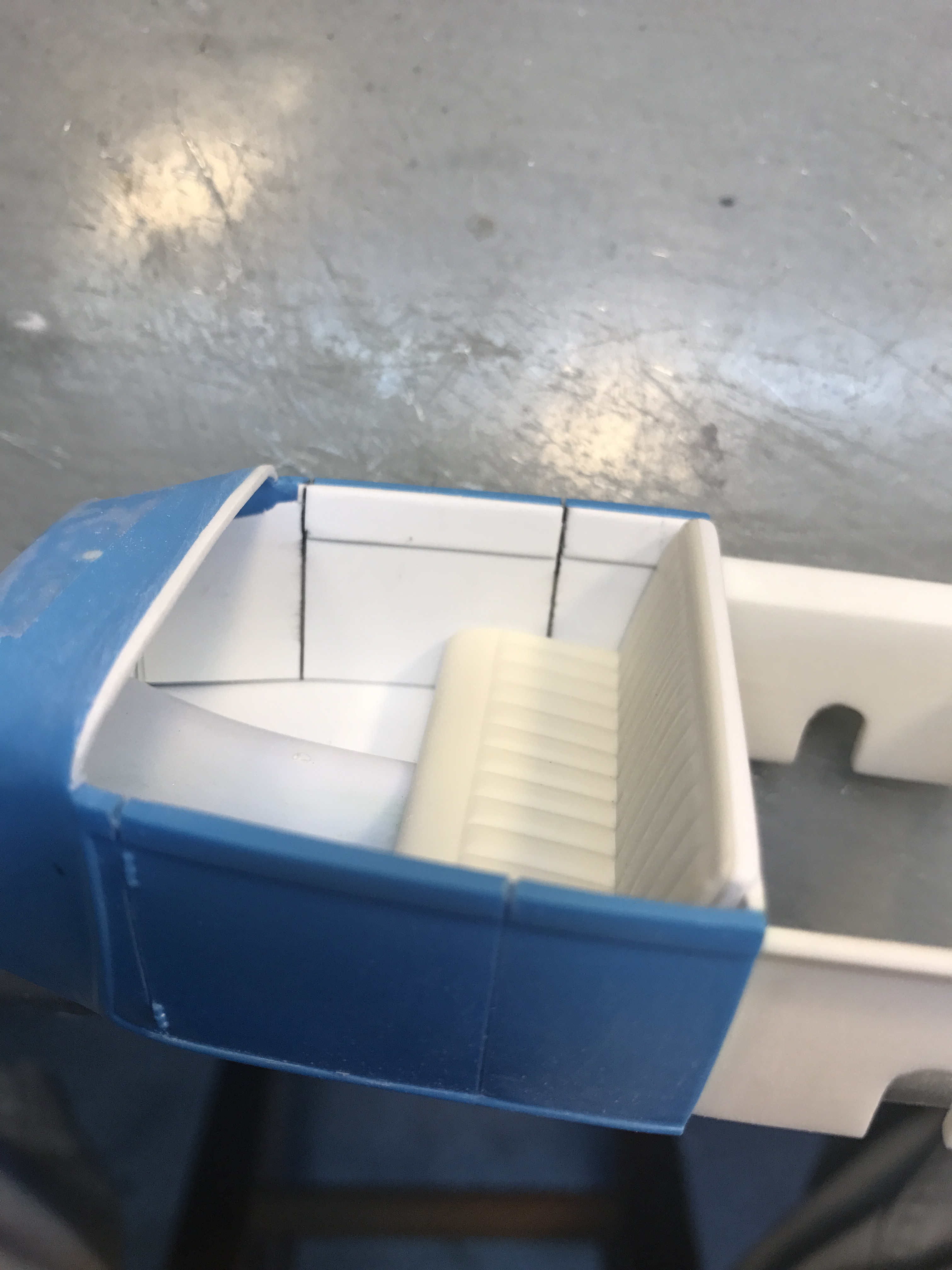

Rocking Rodney Rat Posted November 23, 2017 Author Posted November 23, 2017 Another update, campers. I'm now doing all the "fiddly bits" as our friend Bryce from Oz would say.... Radiator: from the Revell 'Rat Roaster' 1932 roadster. I cut it down to fit the Model A shell and added top and bottom water hose inlets/outlets for the flat motor. Driveshaft.... Gas tank, made from a length of Evergreen tube styrene with Ford dog dish hubcaps glued on each and and sanded down... Belt and pulley assembly. Sorry this pic is a bit unclear...the problem with using a side mounted generator (necessary with three two barrel carbs as center mounted generator will interfere with the front carb) with a small car and a raised engine is that the generator on the side interferes with the passenger side upper radiator hose. I snipped that section off and made the pulley/belt assembly a triangle. I then added an additional belt/pulley assembly to mount the generator low on the side of the engine... Interior door/side panels. Made from Evergreen sheets, simple but effective... Exhaust.... I'm in the home stretch.... Next up is to chop and attach the windshield/dash to the body. I saved this for last so as not to have it "in the way" and possibly get damaged while other work was going on...gobble, gobble, y'all... -RRR

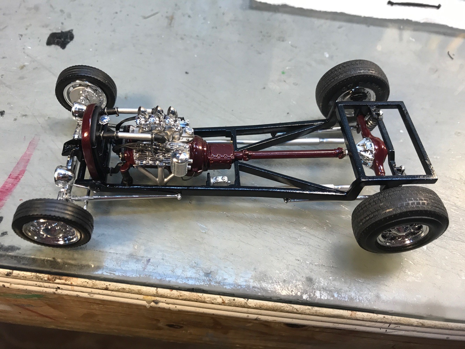

Kit Karson Posted December 8, 2017 Posted December 8, 2017 Here's a sneak peek at RRR's '29 Are Pee You Chassis & Engine in Paint -KK&-RRR More to follow...
