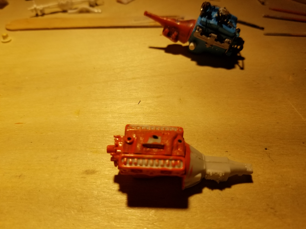

afx Posted November 20, 2017 Author Posted November 20, 2017 (edited) I used the 426 block from the new tool Revell Cuda ( I like the detail of the front cover, trans etc.) and installed the Monogram 340 heads for my AAR Cuda Trans-Am build. Might go that way again. Edited November 21, 2017 by afx
Steamboat Posted November 21, 2017 Posted November 21, 2017 On 11/20/2017 at 11:56 PM, afx said: I used the 426 block from the new tool Revell Cuda and installed the Monogram 340 heads for my AAR Cuda Trans-Am build. Might go that way again. Your work looks great, but you can tell it's a big block by the external oil pump forward of the drivers side motor mount. Small blocks have an internal oil pump.
iBorg Posted November 21, 2017 Posted November 21, 2017 (edited) Quote A wee bit of a derailment, but what would make the 426 unsuitable for short round track, other than weight issues? Would the smaller track not give the engine room to really wind out, thus keeping it down in the low RPM ranges, necessitating shorter gearing?426 Hemis were hard to keep in tune for the street as a daily driver and didn't have a really wide power band. The guts I knew who ran them were really good at adjusting timing and the carb(s). Those same difficulties would really show up on a short track. That narrow power band would hurt it on the dirt. The gearing needed to take advantage of the Hemi would hurt drivability on the track. If its a short track car, handling through the curves is more important than accelerating through the straights. Ever notice how many passes are set up coming off the turn? Hemi cars were nose heavy. Furthermore when Chrysler started their kit car program, the Hemi wasn't an option. The last point is by 1974-75, these engines were not really available in the junkyard. A 340 (which was having round track parts made for local racing and Nascar) could be bought at almost any junkyard for $75-150 while if you could find a Hemi, it was at least $500. Edited November 21, 2017 by iBorg
