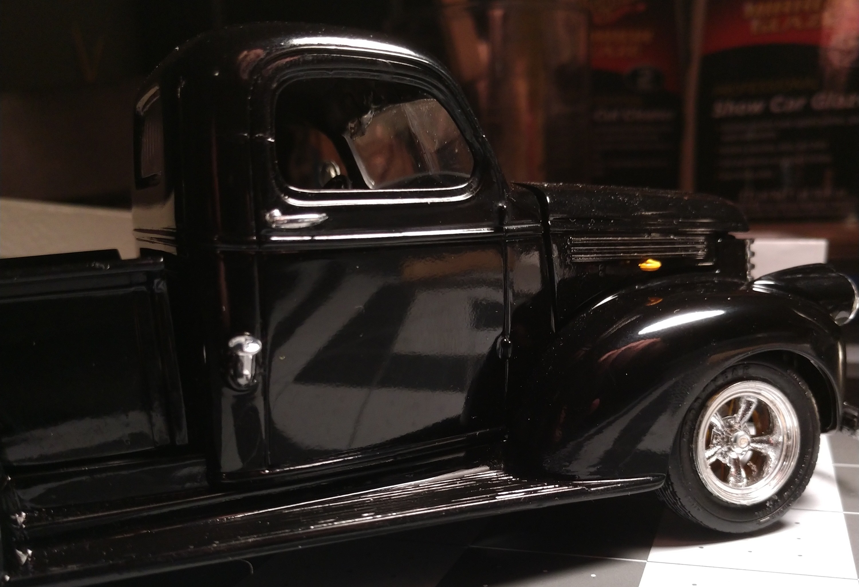

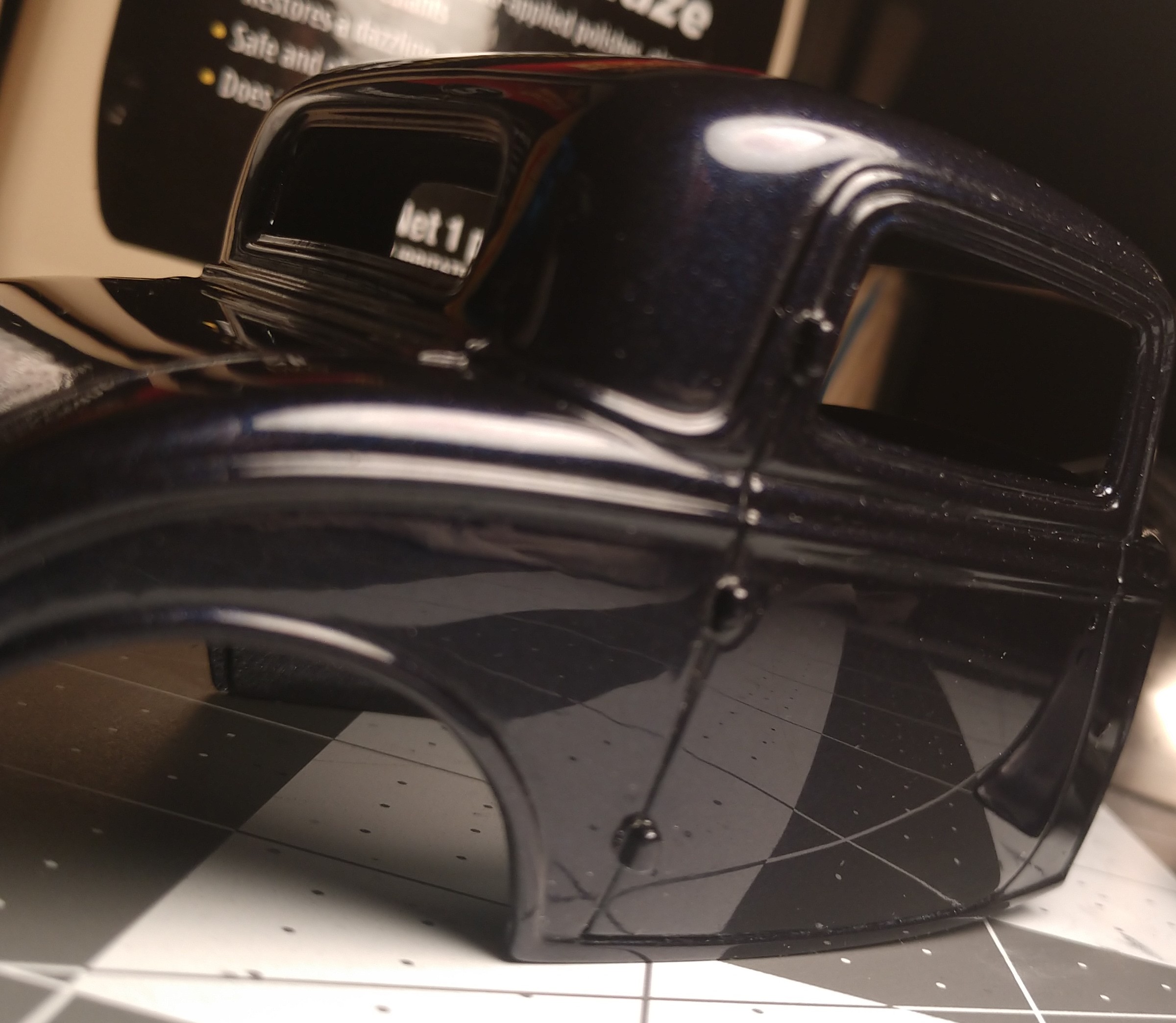

HDDan Posted February 18, 2018 Posted February 18, 2018 I use 2000 grit for just about everything. I will use 800 to get the bulk of the flash off and 400 for shaping big things. As far as paint goes I go for automotive paints. They give you better control over your mix ratios so you can compensate for temperature and humidity. I will normally do 2 coats of primer sanded with 2000. 3 coats of color sanded with 2000. 2 coats of clear sanded with 2000 then polished with McGuire's then rubbed with show glaze (32 ford) I have also used Model Master custom lacquer system with great results. I used the same process but I used the color as the primer (wasted money). Lacquer clear doesn't like to be sanded. Just use a very soft "NON SYNTHETIC" cloth and gently rub it for a couple of hours with light applications of a good carnuaba wax. (41 Chevy pickup)
