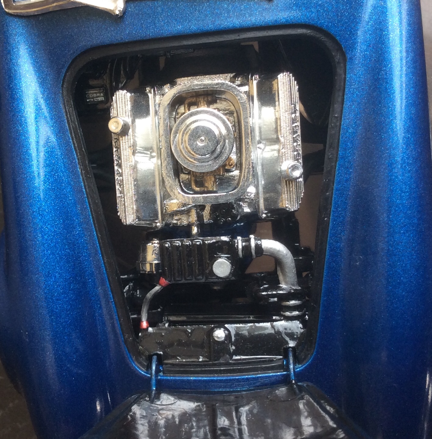

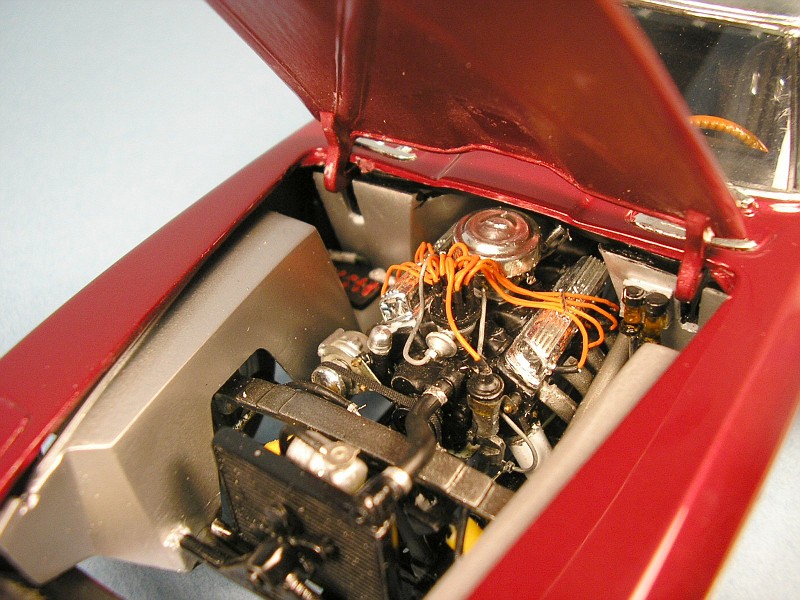

peteski Posted January 25, 2018 Posted January 25, 2018 I had to scratchbuild the fluid reservoirs and master cylinders in the Monogram 1:43 289 Cobra. I used styrene rod. This view shows the reservoirs (I don't have any photos of the master cylinders). While unrelated, this brings another question for the Cobra experts: What is that cylinder mounted on top of the the right foot-well? On my model it is metallic blue. In Bill's photo (few posts earlier) it is black with a gray screw-on cap. Sort of looks like bicycle air pump.
afx Posted January 25, 2018 Posted January 25, 2018 (edited) Its a grease gun. Edited January 25, 2018 by afx
MrObsessive Posted January 25, 2018 Posted January 25, 2018 Years ago, when I was building my Cougar II kit, I wondered the same thing. I had to pretty much "fudge it", as I didn't have pics at the time of the master cylinder, but relied a bit on logic as I knew it had to be floor mounted. Seems as though I was close!
peteski Posted January 31, 2018 Posted January 31, 2018 On 1/25/2018 at 6:15 AM, afx said: Its a grease gun. LOL! For those on-the-road lube jobs! I knew that some older cars (from the '20s and '30s) had manual oilers stored in the engine compartment, but I didn't realize that more modern car would carry a grease gun. I'm glad that I modeled it, even without knowing what it was.
