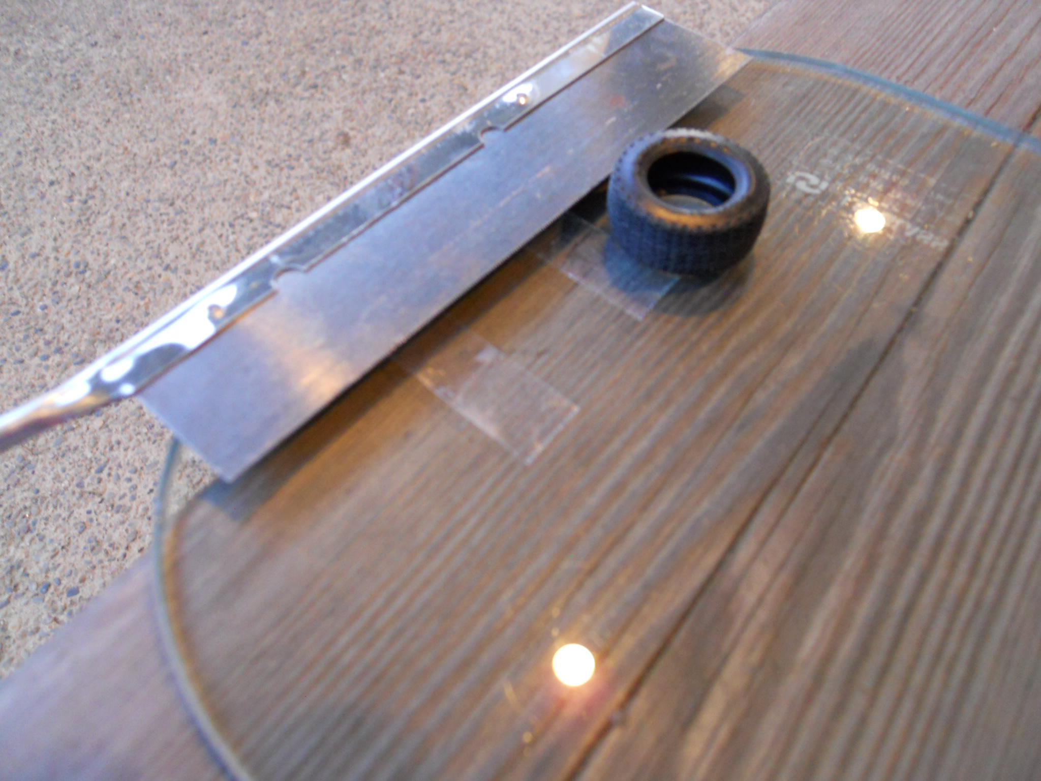

Muncie Posted February 7, 2018 Posted February 7, 2018 another method - this has worked for me - makes good parallel, smooth cuts tools: flat surface, wide blade fine tooth hobby saw blade, spacer to fit and align the saw parallel to flat surface, double stick tape 1. determine spacer thickness and identify an available material 2. Layout some strips of tape on the flat surface to attach the spacer 3. place saw blade on the spacer and tire on flat surface - it may be easier to cut the tire by drawing the saw toward you instead of pushing it. 4. cut one groove part way thru, turn the tire over to make the second cut. After two grooves are cut, finish separating the parts of the tire. 5. on hollow tires, the center tread section can be trimmed and glued inside the tire to reinforce the glued joint in the tread. hope this helps -
