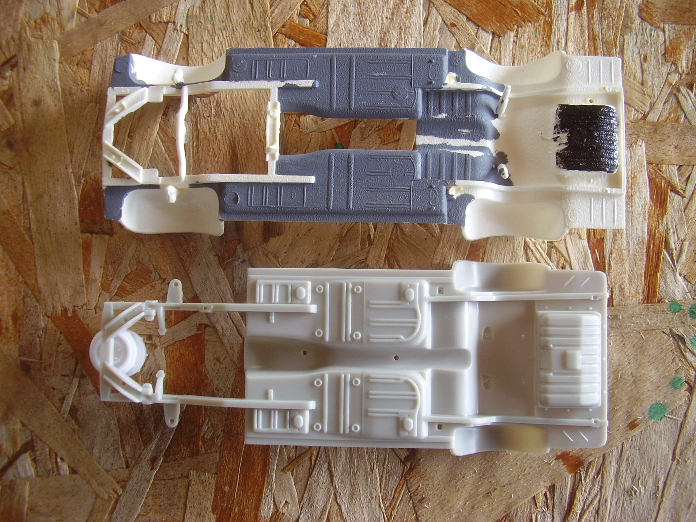

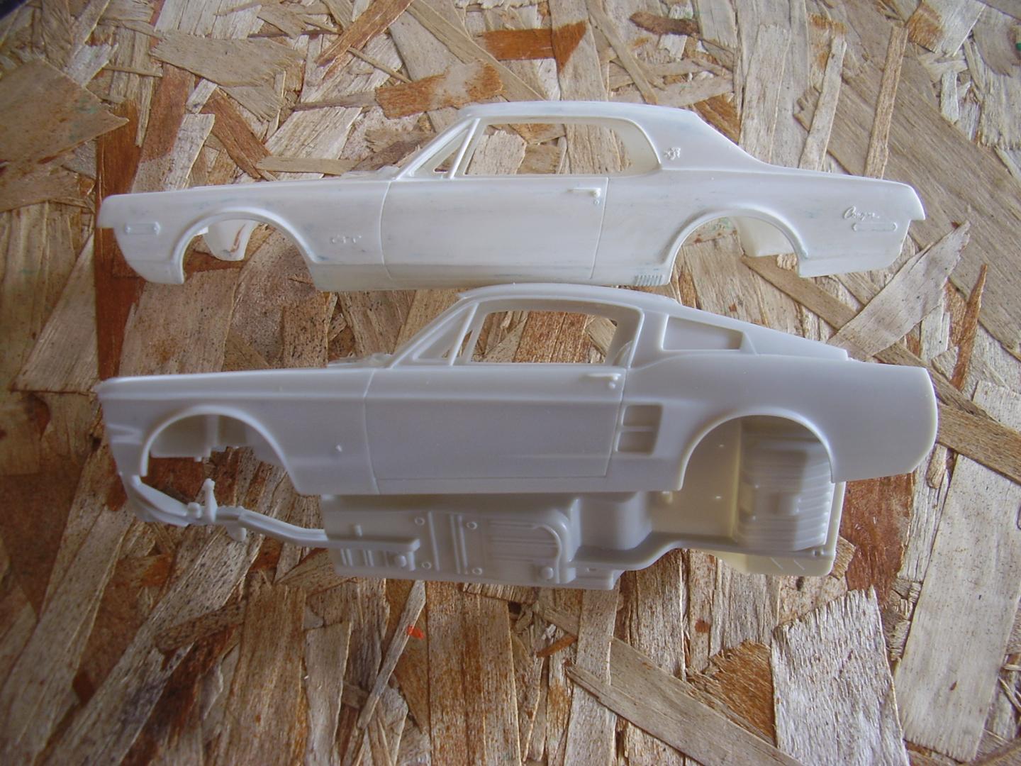

mk11 Posted March 28, 2018 Posted March 28, 2018 (edited) That makes for a plausible theory but not true. The lower cougar/mustang control arms are identical so they can be used on either side. The 1:1 physical evidence (body) and specs (like 3" longer intermediate pipes and driveshaft) point to the front of the rear quarter area behind the door. Here's a couple of pics contrasting the amt mustang and cougar bodies and chassis. The engine bay from the mustang and a slightly lengthened mustang chassis should work well. mike Edited March 29, 2018 by mk11

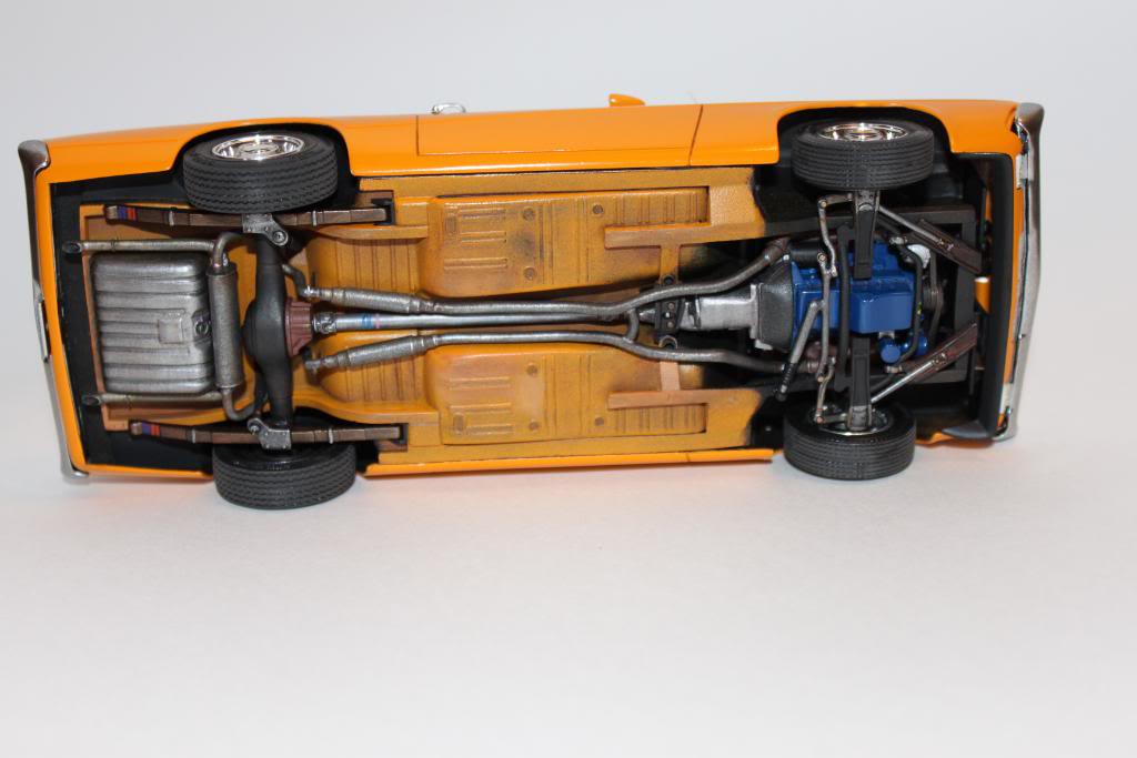

Can-Con Posted March 30, 2018 Posted March 30, 2018 On 3/28/2018 at 3:08 AM, Oldcarfan27 said: 3 scale inches isn't much, probably the thickness of .040 or .060 plastic. Or you could possibly fake it by moving the rear axle back that much. Hardest part might be finding a correct interior for the stock version. Expand Actually, it's quite a stretch , more than a sheet of plastic. This is the AMT '67 Mustang chassis BTW. I really should get back on this Modelhaus resin one sometime soon. It has the AMT Mustang engine bay installed too.

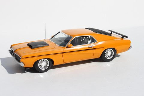

Ron Hamilton Posted March 30, 2018 Posted March 30, 2018 On 3/30/2018 at 7:26 PM, Can-Con said: Actually, it's quite a stretch , more than a sheet of plastic. This is the AMT '67 Mustang chassis BTW. I really should get back on this Modelhaus resin one sometime soon. It has the AMT Mustang engine bay installed too. Expand I did that with a 68 XR7GT. I cut that 67 Mustang 7 ways from Sunday to make everything fit. I also installed a 390/C/6 from a 66 Fairlane GT. It's in primer now. I have to decide on a color combination. I am considering Dark Green, Maroon, or Yellow, with a Saddle interior.

Pat Minarick Posted March 31, 2018 Posted March 31, 2018 On 3/30/2018 at 11:11 PM, mk11 said: You might end up with something that looks like a cross between a '69 grande and a '67, like one of the resin casters had a few years ago Maybe the '71-'73 were closer... Expand I used the 69 Shelby chassis on my Cougar . I did nothing to the kits frame, I cut the stock front suspension off the frame and used the Revell 68 Mustang suspension. I just mounted it slightly farward and pushed the rear end back a little. That way I didn't have to mess with the interior bucket. The Shelby's interior bucket and glass mounted right to original locating pins on the inside of the Shelby's roof and cowl.
Dave Darby Posted March 31, 2018 Posted March 31, 2018 On 3/30/2018 at 7:26 PM, Can-Con said: Actually, it's quite a stretch , more than a sheet of plastic. This is the AMT '67 Mustang chassis BTW. I really should get back on this Modelhaus resin one sometime soon. It has the AMT Mustang engine bay installed too. Expand I think the stretch is actually behind the foot well for the back seat, but you got the job done.
