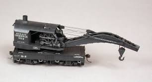

The HO railroad kits from Tichy / Gould are a case in point. They're little jewels. Some of the grab irons are only .010" thick.  Image result for Tichy / Gould
But ham-handed kiddies tend to need clunky, thick parts so they don't destroy them during handling, and they're not as discerning about scale accuracy and technical correctness either.
PS. Speaking of Gould, this is the guy himself. Started a model company on a shoestring, did all his own tooling. Not the kind of guy to say "it can't be done here anymore" and hand off all the real work to the Chinese.
