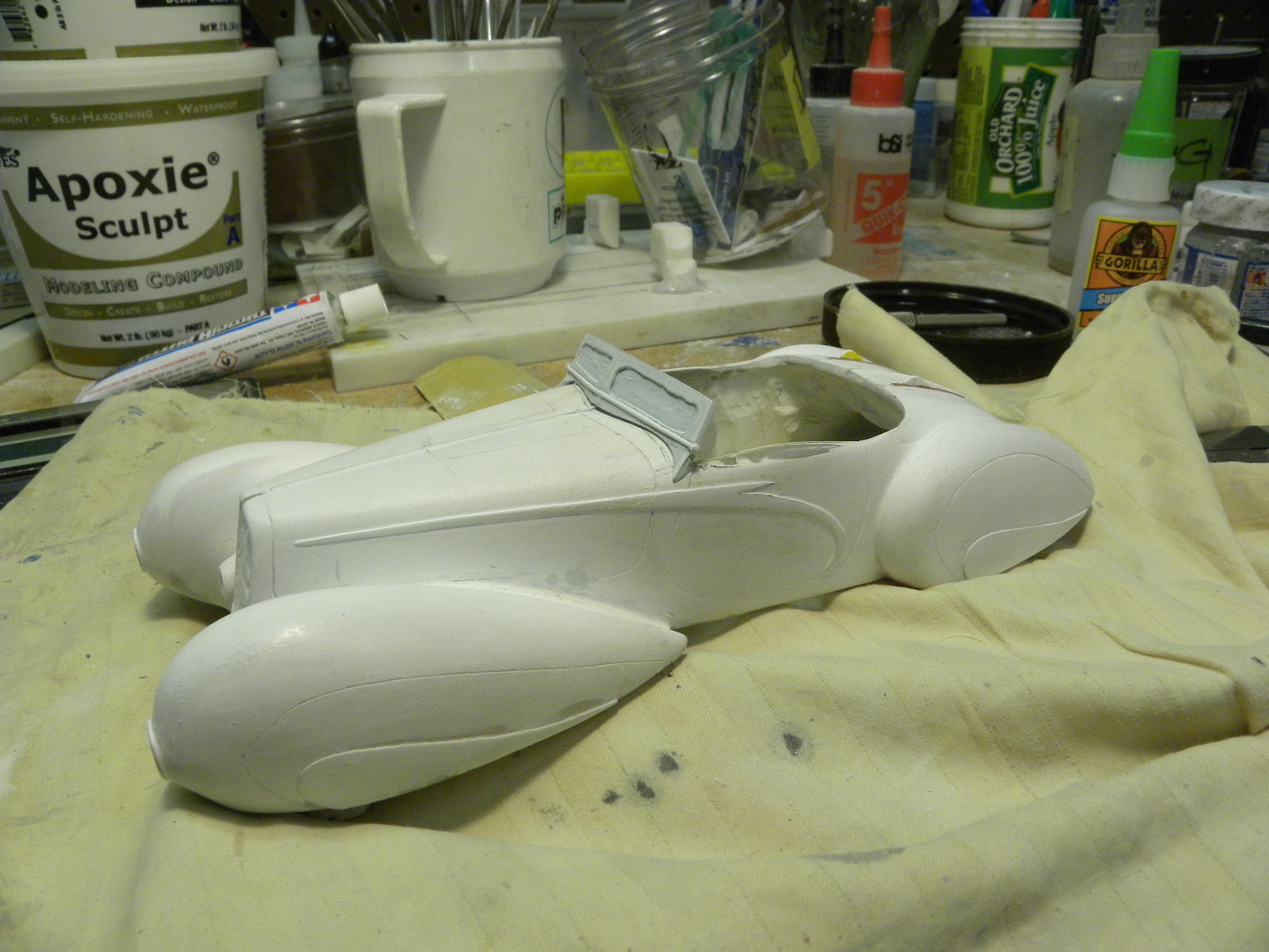

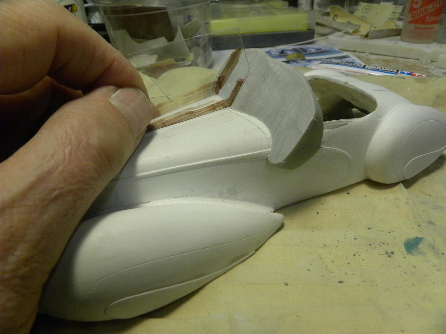

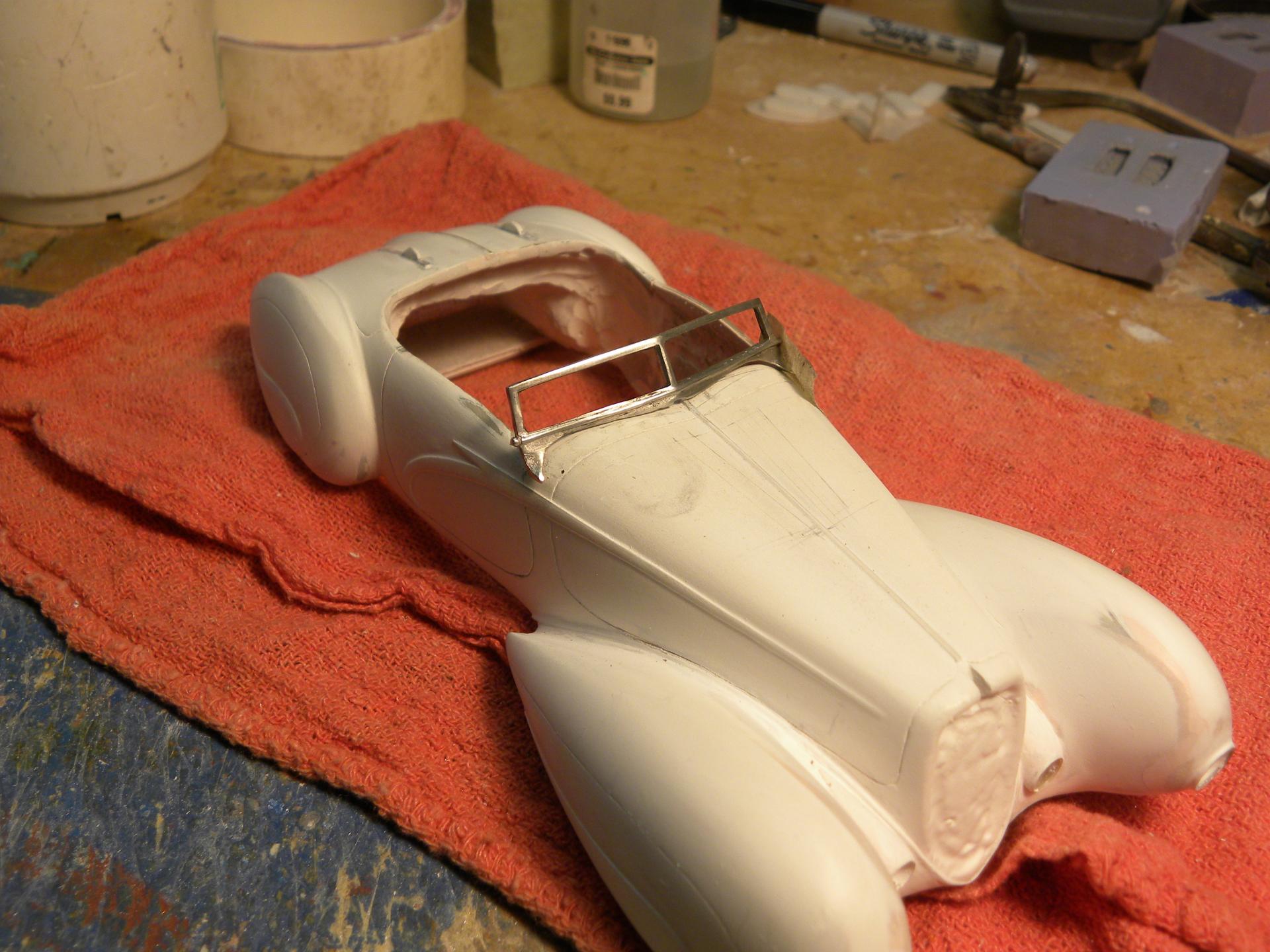

Pico Posted July 16, 2018 Author Posted July 16, 2018 Because the windshield frame is so thin, I've decided to cast it in white metal. Mastering proved to be difficult, plastic was too floppy, brass did not work well, so I decided to use Ave's Apoxy Sclupt, an epxoy putty. Covered the cowl area with thin plastic so the material wouldn't stick and put a glob on. It's very slow setting at room temperature, about 6 hours, so I put it in a dehydrator. Usually takes 45 minutes there. Sanded it to shape and detailed with half rounds and small turned knobs. I did not cut all the way through, to retain strength. That will be done in the metal.

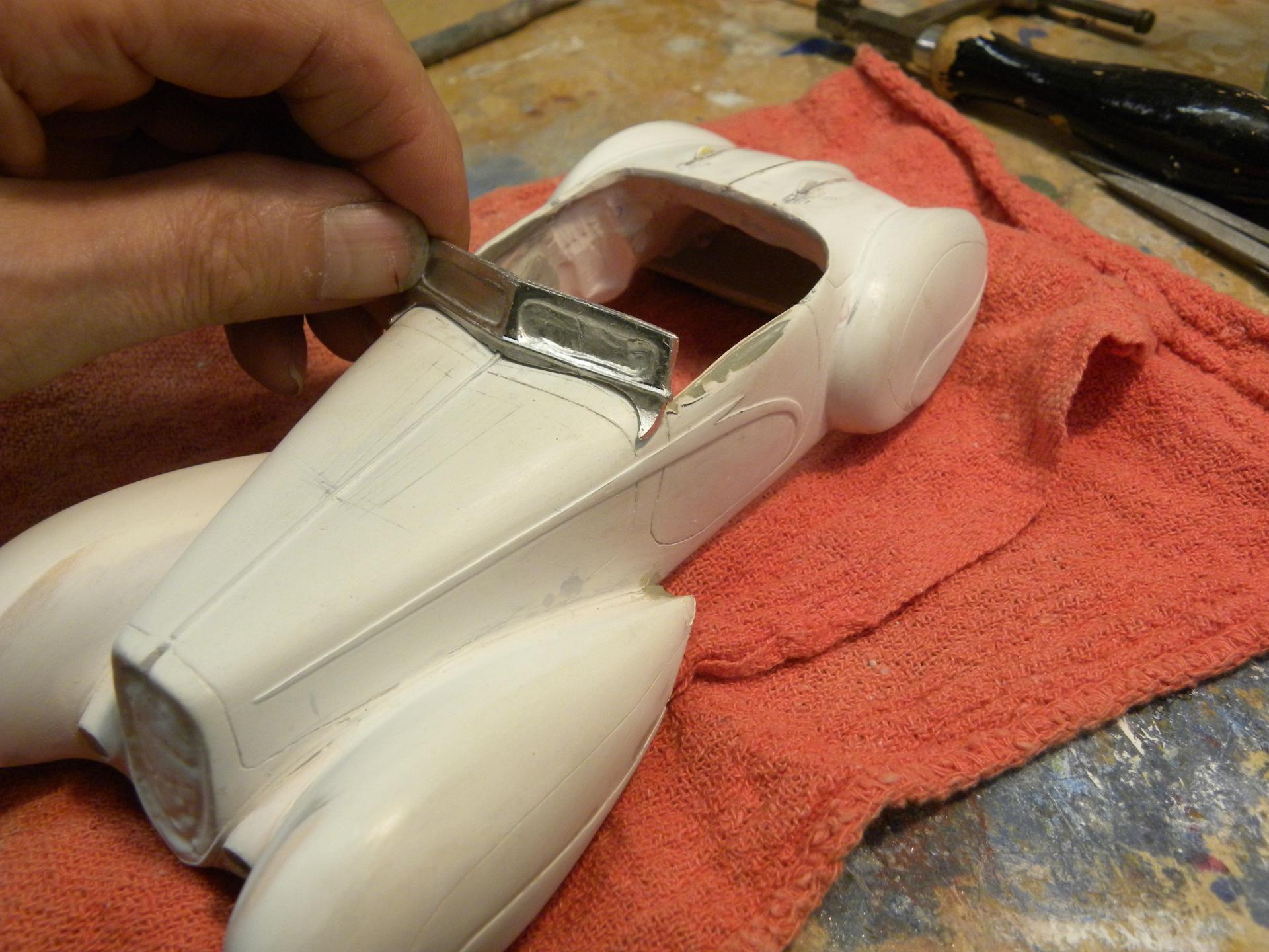

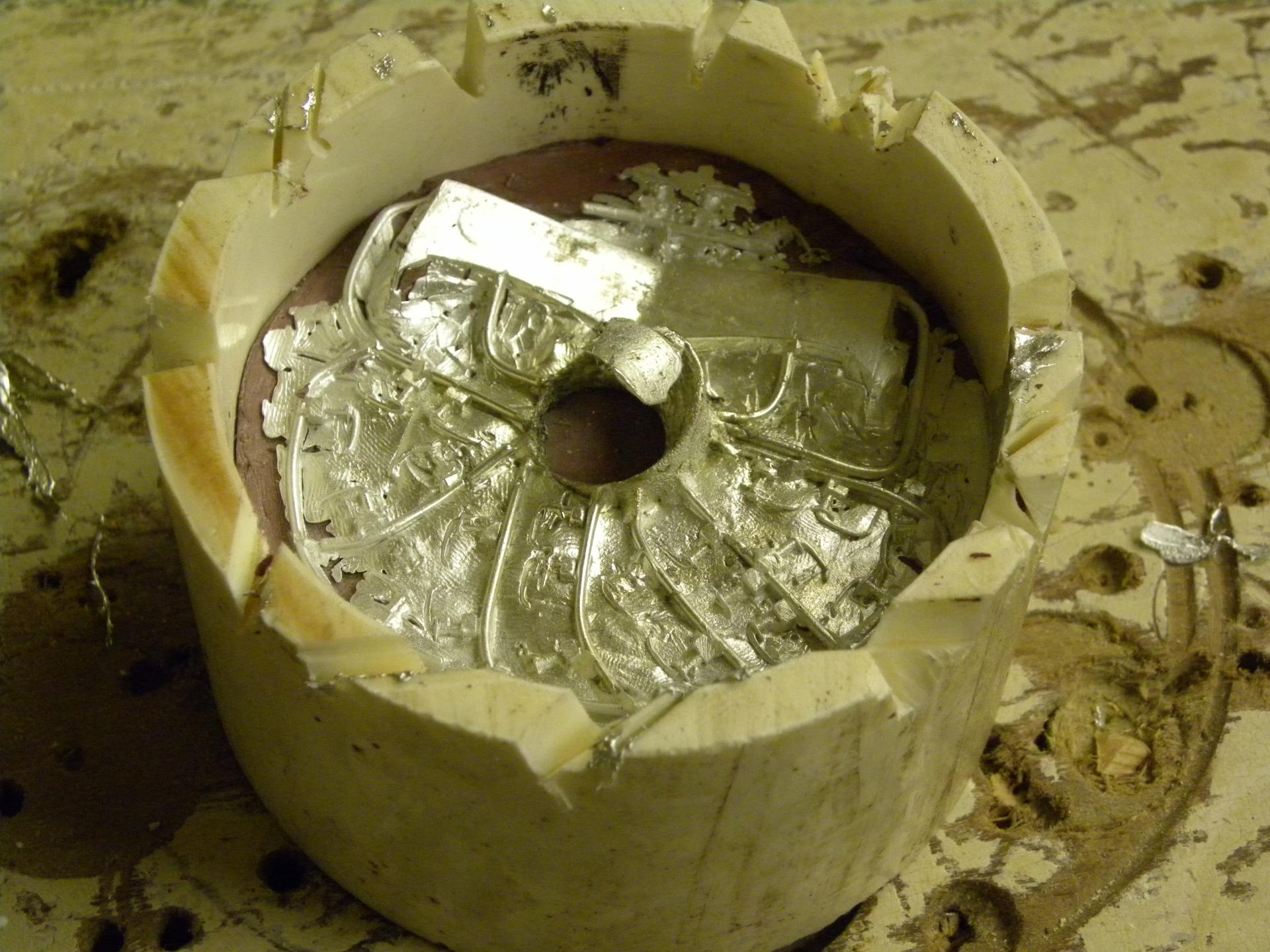

Pico Posted August 11, 2018 Author Posted August 11, 2018 It has taken several weeks to make the centrifugal caster and molds but it has worked well. This is britannia metal, a lead free white metal that I cast in a silicon mold material called Mold Max 60; that will withstand temperatures up to 560 degrees. I pour the metal about 400 degrees.
Pico Posted August 11, 2018 Author Posted August 11, 2018 A decent result. I'll solder brass rods to the windshield frame to glue into the body.
Spex84 Posted August 12, 2018 Posted August 12, 2018 Fantastic stuff! I'm impressed by the windshield frame, it really sets off the curves of the car. Watching this project progress has been very inspirational.
ismaelg Posted August 12, 2018 Posted August 12, 2018 Gorgeous! I see the benefit of doing it in metal. That piece in resin would be too fragile. And besides, it looks beautiful!

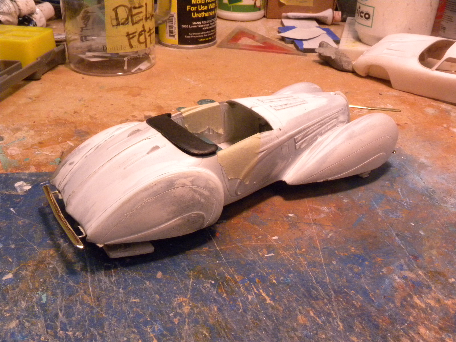

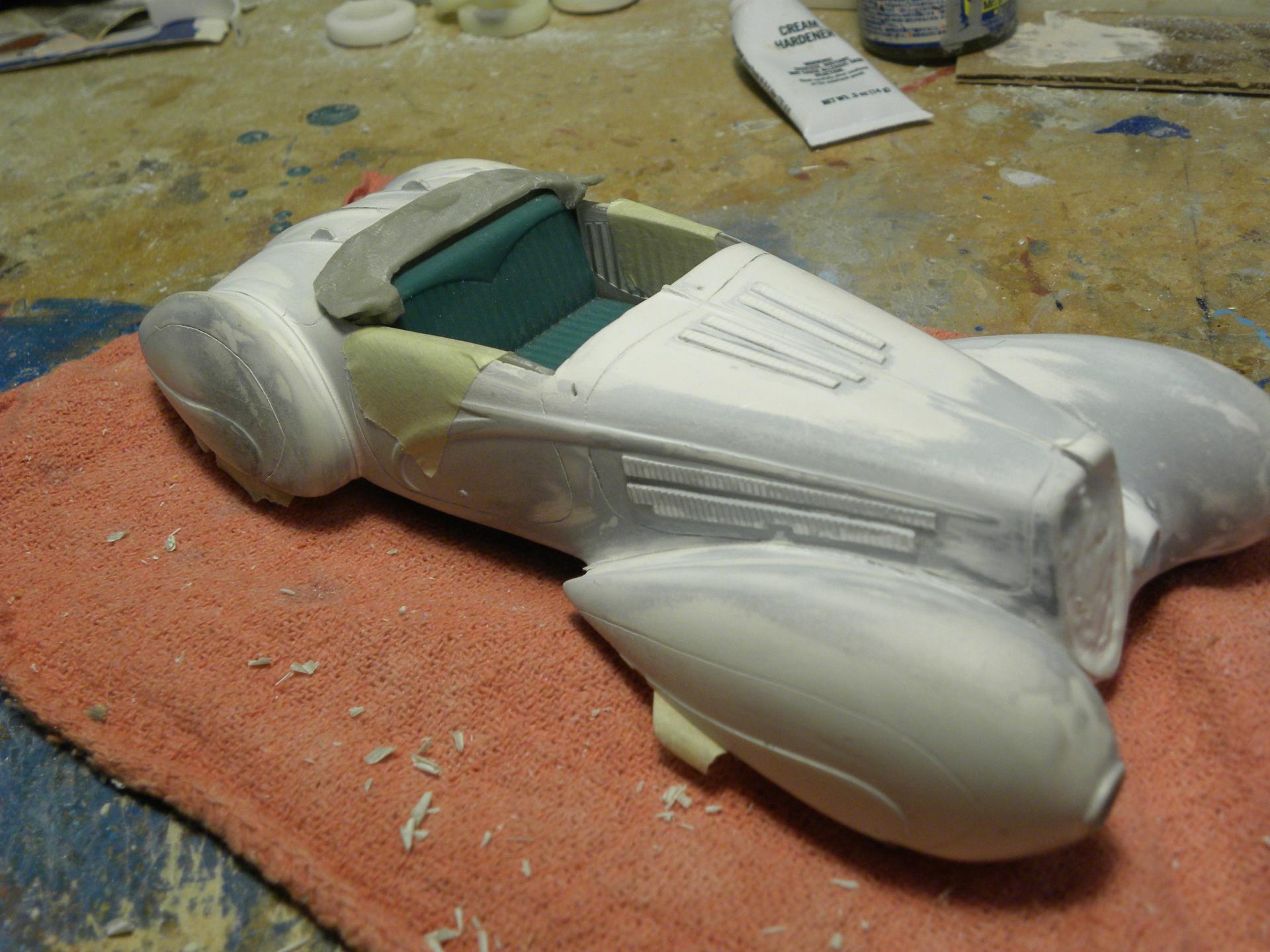

Pico Posted August 26, 2018 Author Posted August 26, 2018 Work continues. I have put a wad of Ave's Apoxy on the model, let it set and am carving it to be a top cover. 3d printed seat and interior door panels are in place.

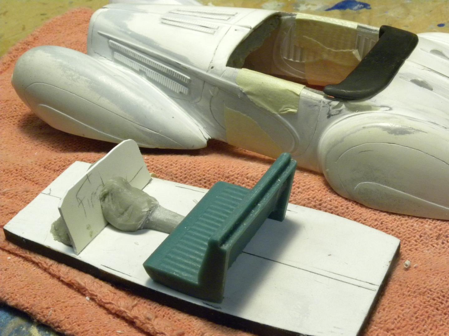

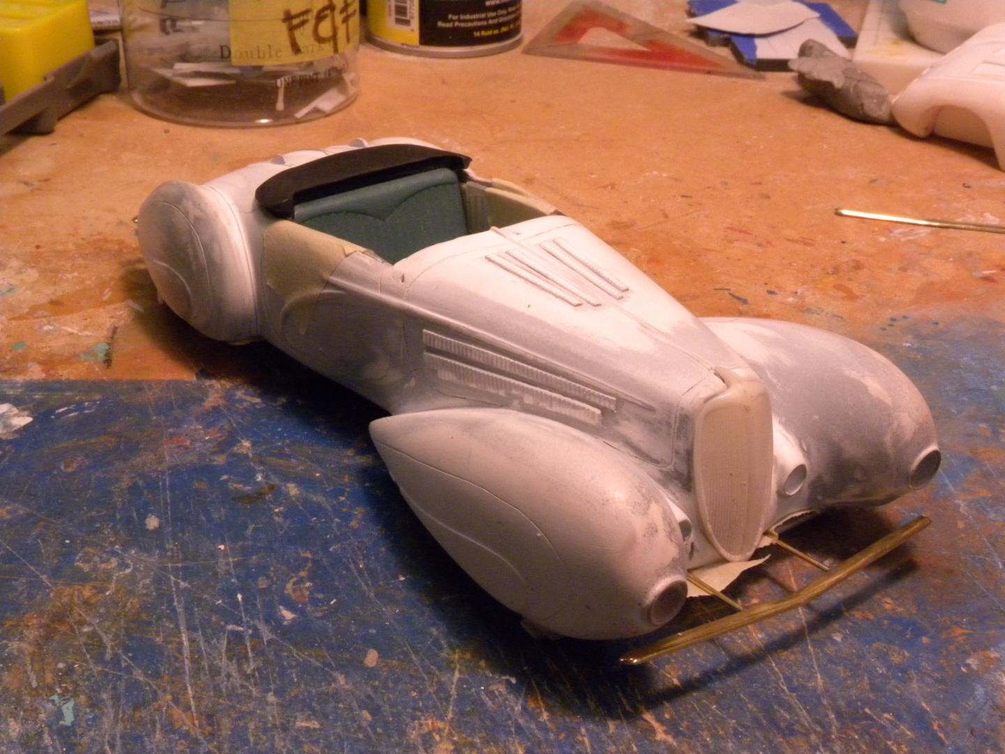

Pico Posted September 25, 2018 Author Posted September 25, 2018 After a several week break and massive workbench top cleaning, I'm at it again. Here carving the transmission hump from epoxy putty.

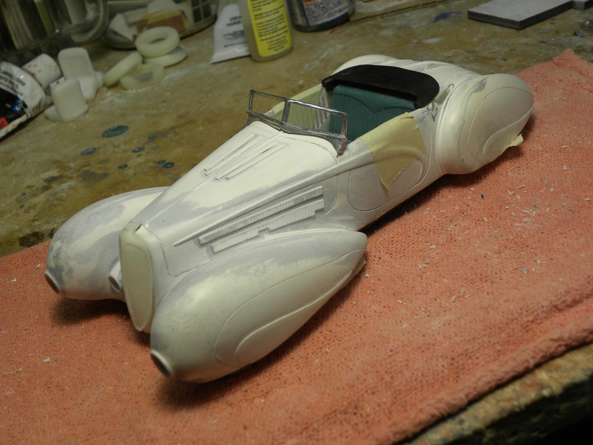

Italianhorses Posted September 25, 2018 Posted September 25, 2018 Brilliant work. Might be wrong, but looking at the pictures, bottom front of the rear wheel flares/arches, is not quite correct shape. Real car has them slanted going down almost at 45-50 degree angle, yours seem more square-ish.
Pico Posted September 25, 2018 Author Posted September 25, 2018 Each of these cars are a bit different. The car I am modelling is a long wheel base car, because it "flows" better. The shorter wheelbase are tighter and fender shapes are different.
Ace-Garageguy Posted September 25, 2018 Posted September 25, 2018 Stunning craftsmanship in a variety of materials, and impressive tenacity...as always. Beautiful work, sir. I had never noticed the swirly-doodles (that's a highly technical styling term) in the centers of the fenders do not in fact line up with the axle centerlines until I saw the reference photo directly above. Most interesting.
