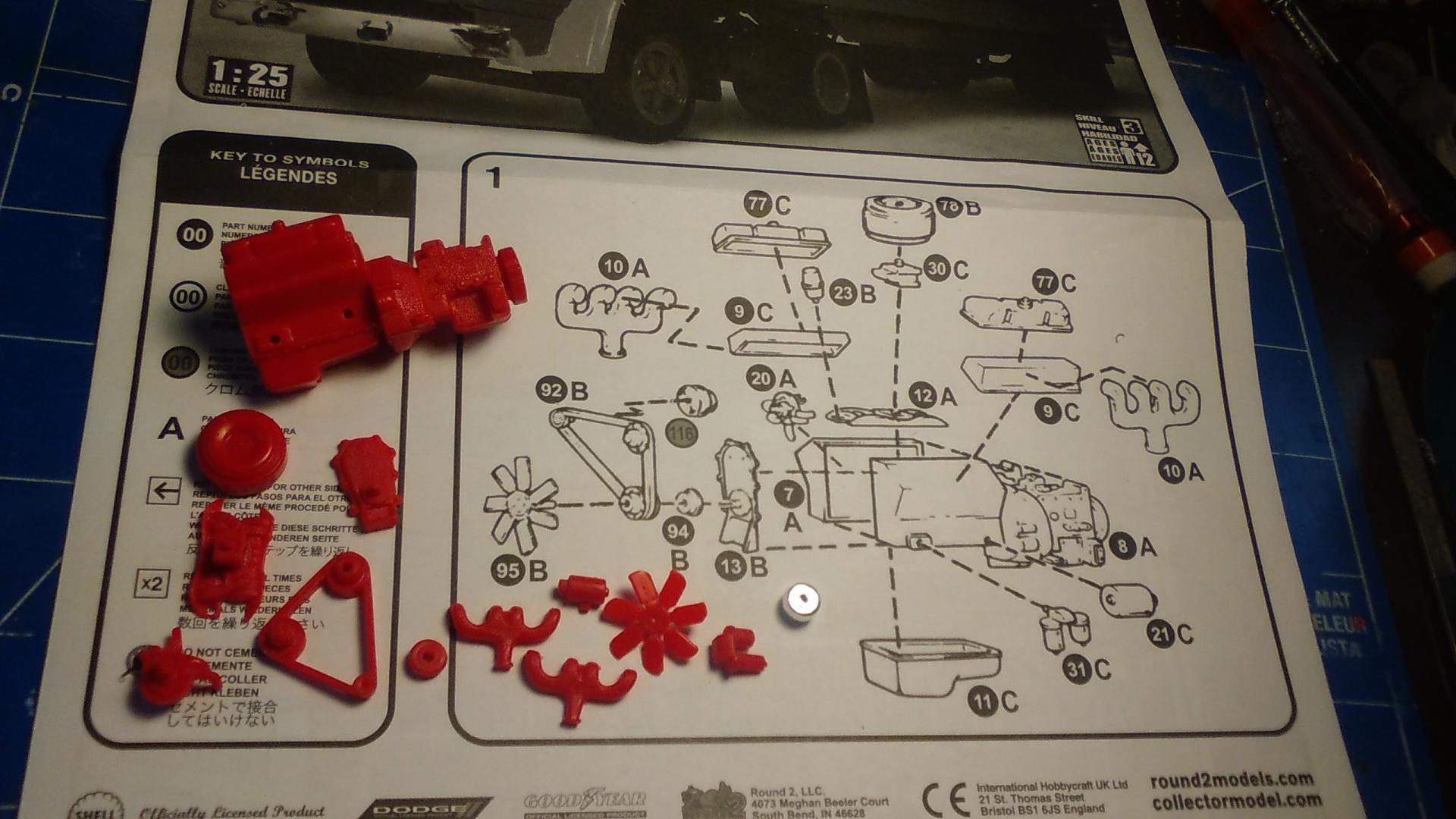

Starting with step one,the engine,the fit of these parts is poor but with sanding and trimming all went together well

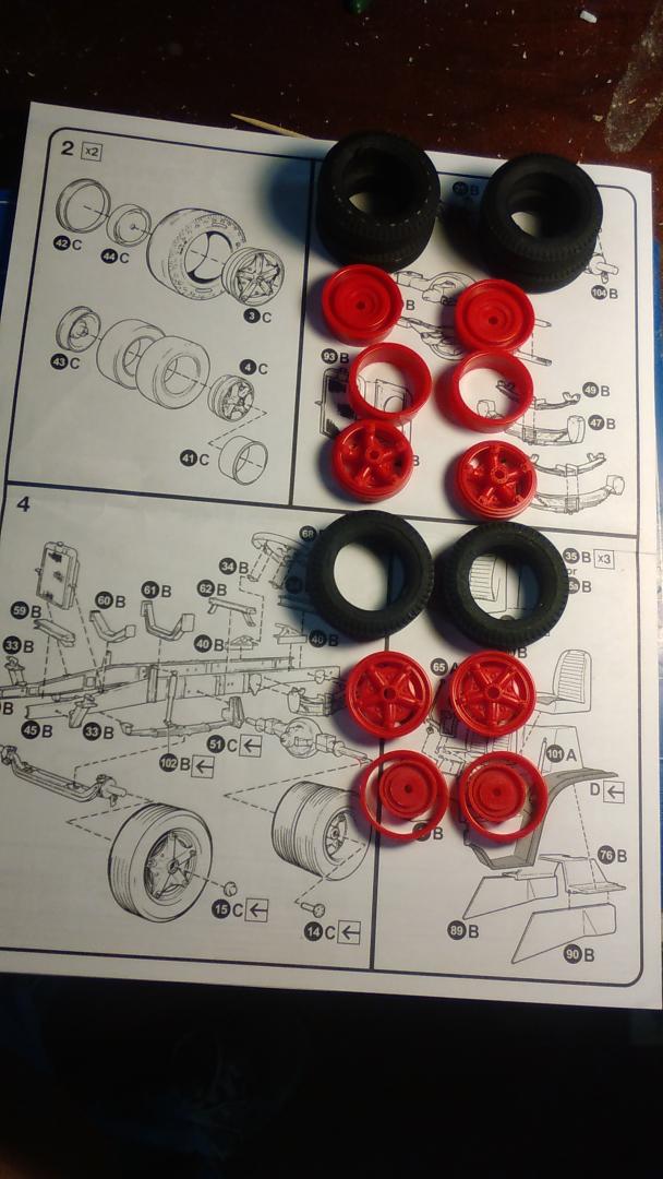

Next was the wheels and tires.I have only been at modeling a little over a year but i have never come across instructions as unclear is the one included in this kit
Parts # not on tree which i have encountered before but the illustrations are just as bad:o
Ok,enough rant and on to step two,the wheels and tires
This is the one that had me tied up
So off i go to do the flash clean up then to a Dawn soap bath before painting.

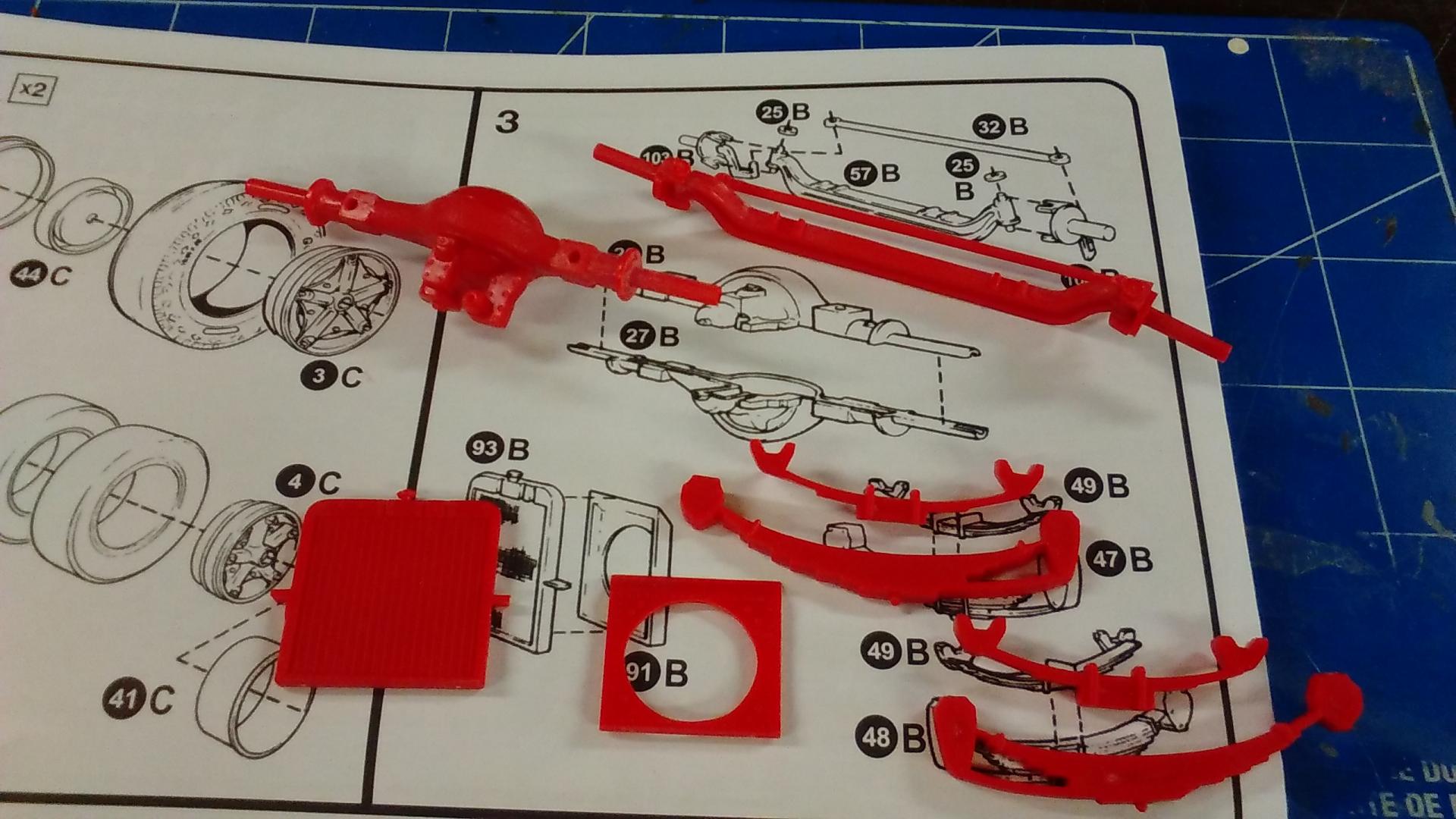

Jacobus,how right you are.On to step three demonstrates exactly what you mean

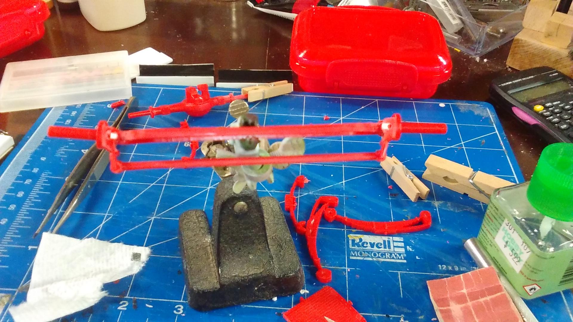

The method of attaching the spindles to the front axle is borderline hilarious.
I did a workaround that i hope will still allow to have the front wheels turn.In the pic you can see the added part to try and fix that.
Then to figure out how to get the wheels on the spindles to be square and parallel on the truck
And the step three shot waiting for deflashing and a bath

Here's the motor minus the exhaust manifolds.
No distributor :angry: and in another thread about the scale of things,whats up with the belts and pulleys,
they look way to big to me.
I have lost the part that goes behind the pump at the top pulley so ill scratch one out after i find a distributor.
Cool little kit,one of my favorites.The motor is a 361 dodge,it is part of the big block family,same as the 440 383 bunch every one loves,the distributor on that will go at the front f the motor,sticks out at a 45 degree angle on the right front corner.I always thought it would be cool to stuff a hemi in one of them. Harvey
It also has the only 5 speed medium duty truck trans ever made!  AMT went with automatics on their C and L series Fords. I used the 5 speed behind a 292 on my F 350 dump build.
Edited by leafsprings
I now think the part i lost,# 23 in the engine assembly, is the distributor?
In any case  im gonna find one to put there :wacko:

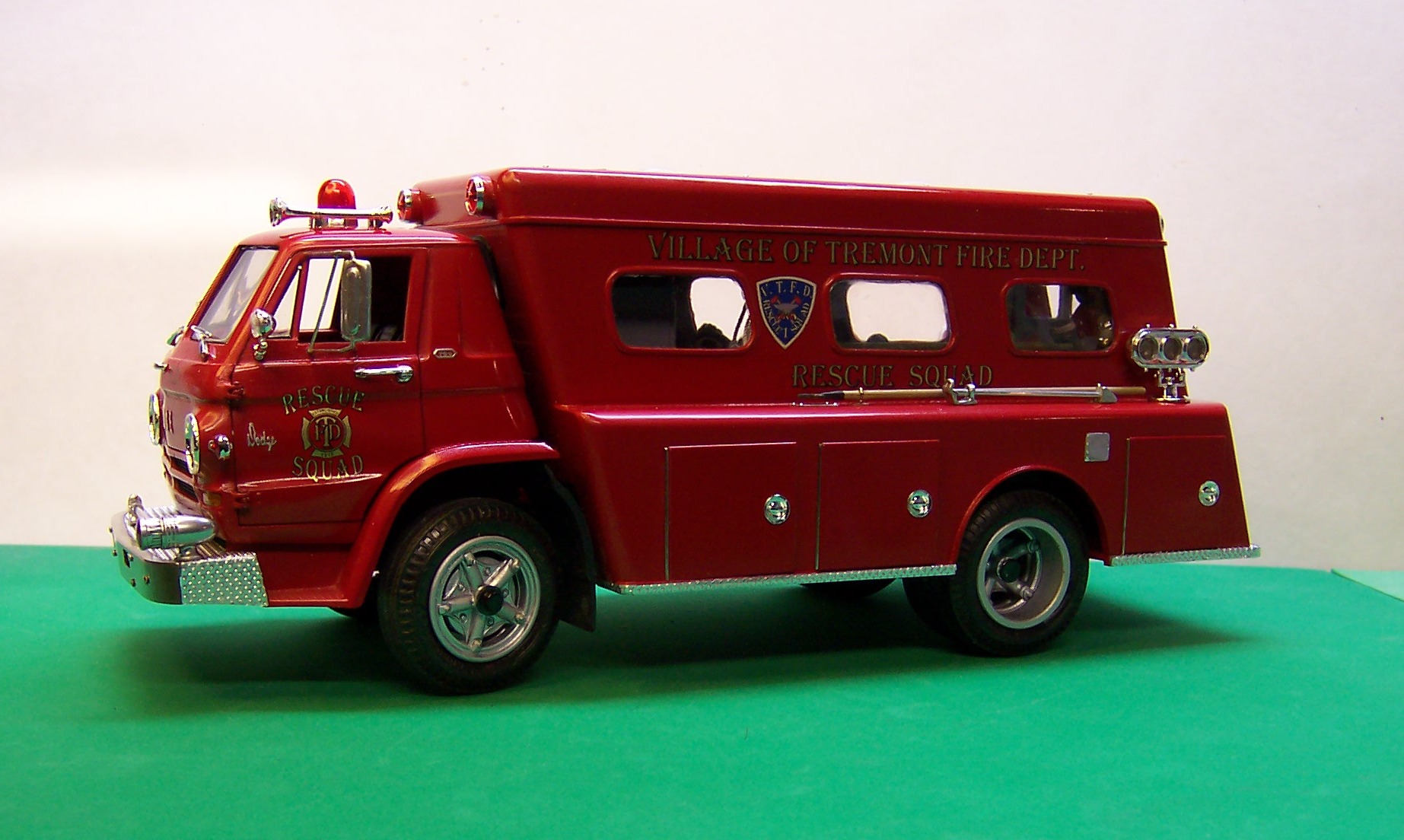

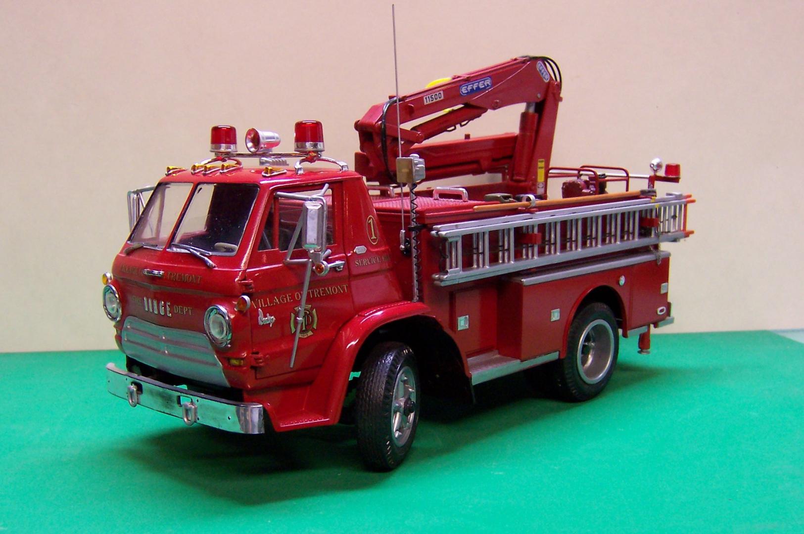

The cab mounts are difficult to say the least.  If one is off the slightest amount the cab will not sit straight.  And that is the most egregious thing about this rig.  Try putting a section of tubing through the mounting pins so that they line up squarely to the frame.  Do the same for the mounting attachments on the cab.  Maybe use the same tubing to run through all 4 pieces so that everything matches.  Take your time and it will work out.  Here are a couple of rigs I have done.  the first one was a glue bomb that I rebuilt and added the body to.  The second one was done using a second generation kit and extending the frame.
002.thumb.JPG.451ff96ab4fb016dc97655ae32dbd04d.JPG039.thumb.JPG.a76d7957a2c7d2a4d5b97f9755f9e9b5.JPG You are doing a good job on the chassis and engine.
Edited by Chariots of Fire

I have been kicking the tubing idea around so its good to hear that is a work around.
