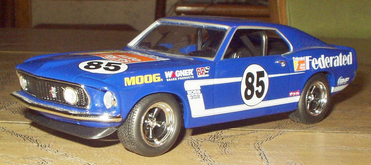

Snake45 Posted January 28, 2019 Posted January 28, 2019 I'm now thinking seriously of stealing the decals, wing, backlight slats, and interior from this kit and using them to Snake-Fu this very nice diecast (after I remove all the tampo graphic junk, of course). The kit will then donate its improved (but still not perfect) nose pieces to a Revell Mach I kit. Hmmmmmm....

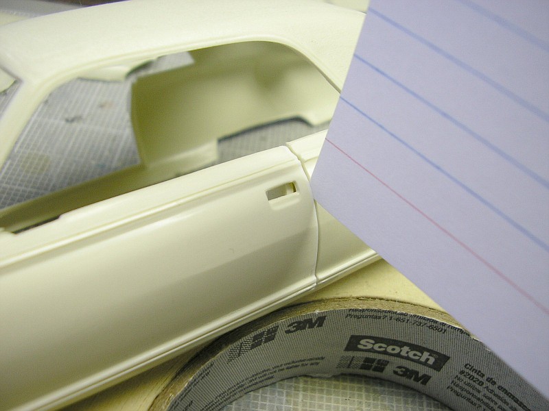

MrObsessive Posted February 16, 2019 Posted February 16, 2019 Eric, I want to add that when I did the review of this kit in my thread, the hood in relation to the fenders has very tight shut lines. When you painted it that made the tolerance all the more tighter. I like to use what I call the 3x5 card method when it comes to opening panels. If a 3x5 card will slip in and out of the shut line without binding, that should be enough clearance when it comes time for paint. Here's a pic below where this was much needed on the Turbine Car I built years ago.................
Snake45 Posted February 16, 2019 Posted February 16, 2019 Fabulous idea! I am TOTALLY stealing it! If one doesn't have index cards handy, I imagine those annoying subscription cards that fall out of every magazine you buy would serve the same function.
MrObsessive Posted February 16, 2019 Posted February 16, 2019 1 hour ago, Snake45 said: Fabulous idea! I am TOTALLY stealing it! If one doesn't have index cards handy, I imagine those annoying subscription cards that fall out of every magazine you buy would serve the same function. And yes, those should work just fine as well!

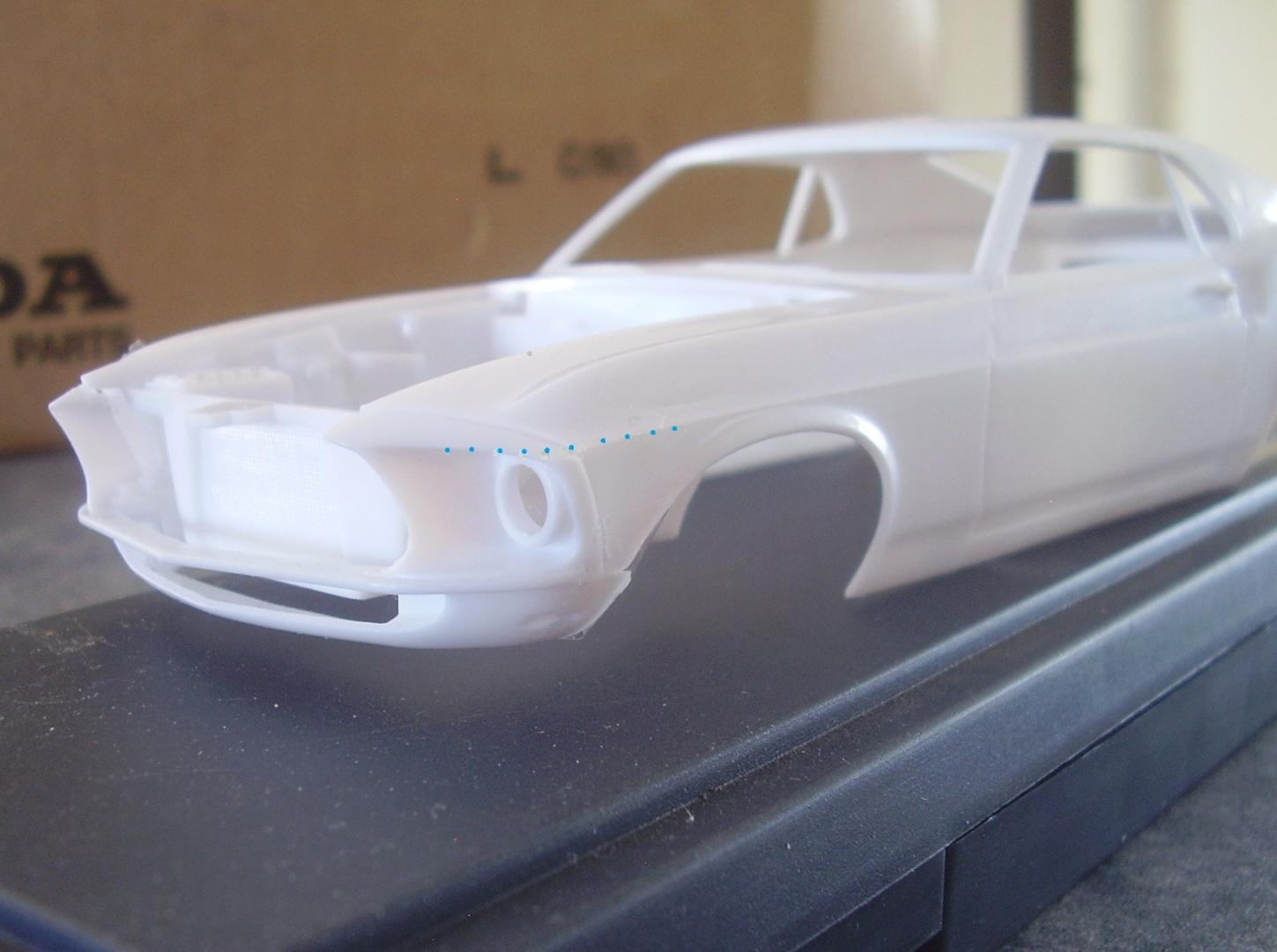

gui_tarzan Posted February 17, 2019 Posted February 17, 2019 (edited) Thanks for the tip on the hood. The front end also widens out at the body line on the front fenders, so I sanded them straight. They could use a little more sanding (pic is after sanding) but I don't want to lose the body line altogether. I appreciate the fact that they raised the angle of the eyebrow, but it's still not quite right. The grille opening is a lot better though. I also didn't realize until I got the kit that it didn't have the Mach I scoops on the rear quarters so I stole them from an old built-up and fit them in since I'm building a replica of the '69 Mach I we had when I was a kid. Edited February 17, 2019 by gui_tarzan

mk11 Posted February 18, 2019 Posted February 18, 2019 (edited) On 2019-02-16 at 6:43 PM, gui_tarzan said: The front end also widens out at the body line on the front fenders, so I sanded them straight. They could use a little more sanding (pic is after sanding) but I don't want to lose the body line altogether. I appreciate the fact that they raised the angle of the eyebrow, but it's still not quite right. That looks a lot better It helps diminish that goofish 'keystone' look... as seen from the front and as the front fender line seems to actually dip at the front corner, a little finessing and build-up would improve the optics as well. Edited February 18, 2019 by mk11
