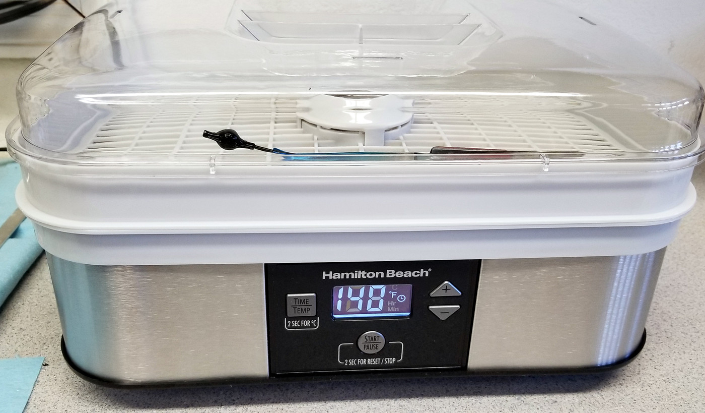

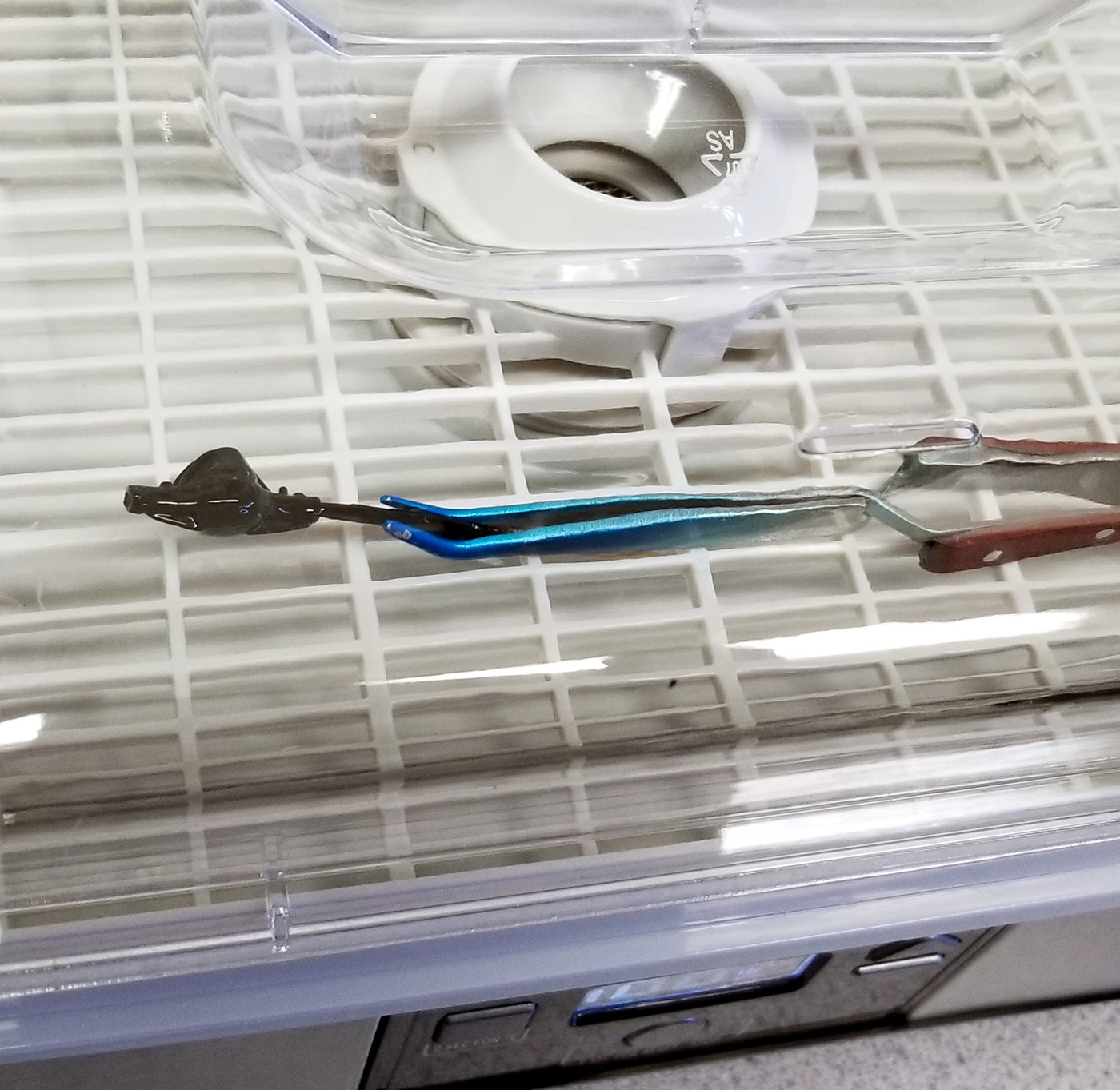

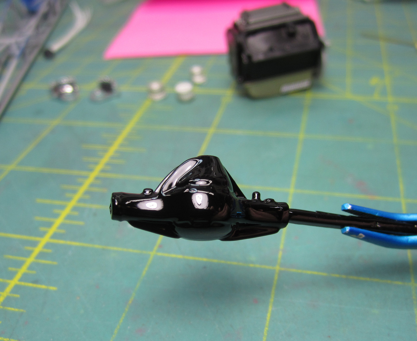

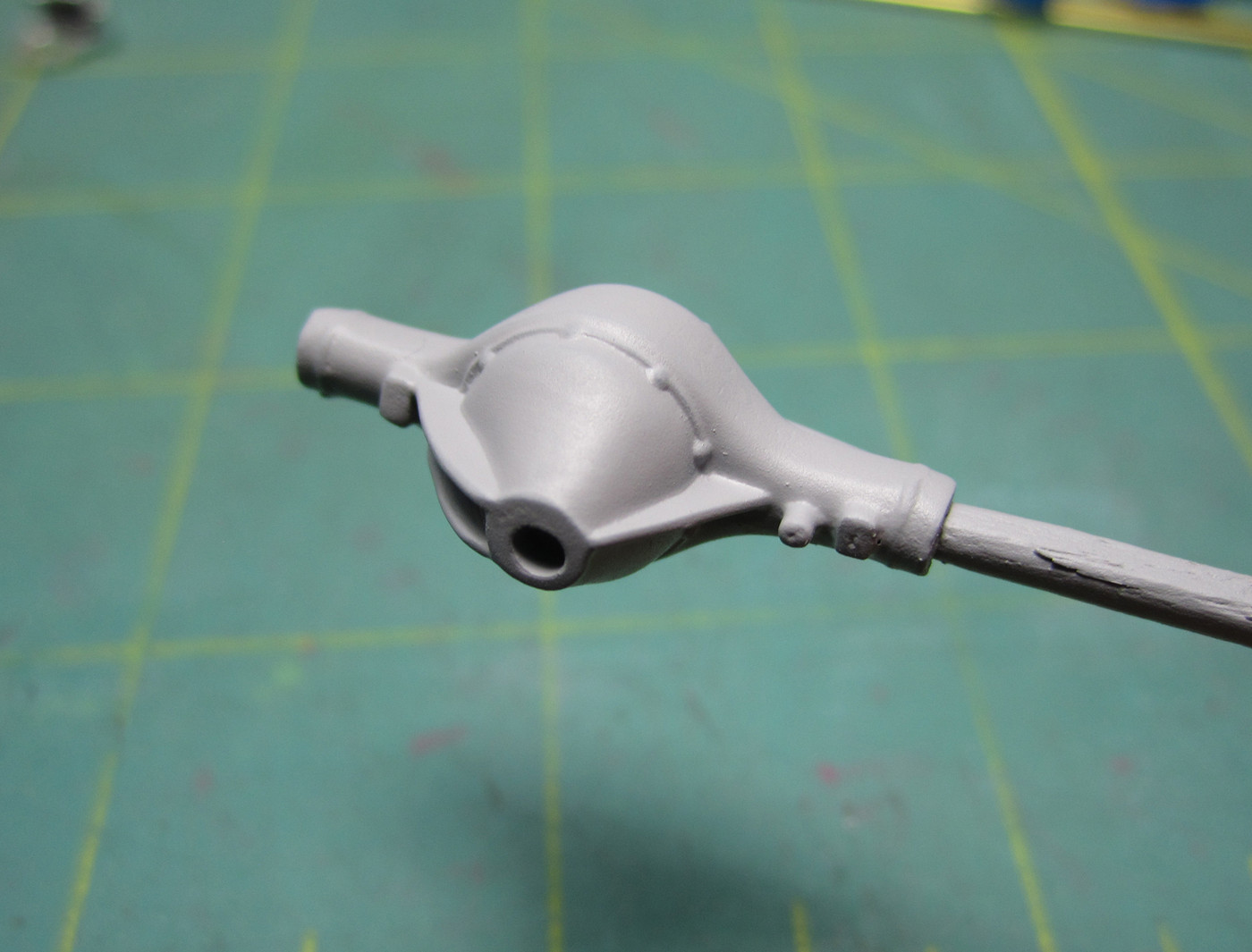

Mooneyzs Posted June 9, 2018 Posted June 9, 2018 Alright fellas... I got another small update to share with you all. I finally was able to get the rear end all prepped, sanded and Primered last night. Then earlier this evening after I got home from work I decided to get black base and clear sprayed on the rear end. Then I finally got to try out something I have been wanting to do for a while now..... you will see in the pics... Here is the Rear end in Primer after I had cleaned up the glue joints between the halve's of the parts: So a while back.... Probably over a year ago I purchased a Food Dehydrator and I have been wanting to try it out to force dry my paint jobs sorta like they do on full size cars to see if it will help with the finish but would also speed up the waiting time between being able to color sand and polish or even lay decals down before more clear. Here is the Machine the I picked up, Its got a digital read out for the temperature and it has a temp range of 100 to 160 degrees. I just wish the timer would allow you to go less than an hour (would of been nice if you could do 30 mins) but its ok: I had thought that I took some pics after I laid the House of Kolor Black base down, but apparently I forgot to take pics...lol So here it is my first part that I am force Drying at 140 Degree's for 30 mins: Upclose shot of the part Baking:
Mooneyzs Posted June 9, 2018 Posted June 9, 2018 Here is the finished results after I left it in the Dehydrator for about 35 Mins, Nice and shinny and ready for some Alclad:

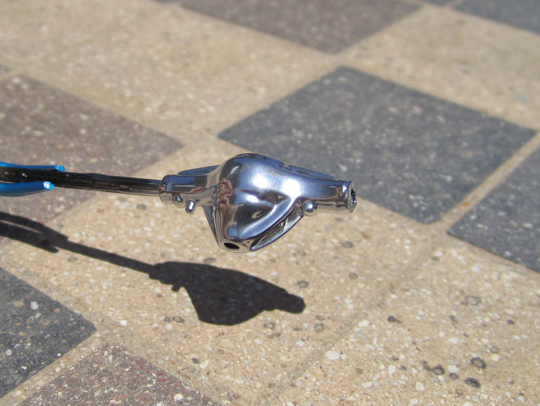

Mooneyzs Posted June 9, 2018 Posted June 9, 2018 So early this morning I decided to break out the Alclad and paint the rear end up with some Chrome. I also thought what the heck and let me stick it in the dehydrator for a bit... decided to leave it in a 140 for an hour to help cure it faster then let it sit for a while afterwards and then did the light polish to it to get rid of the over spray dust. Here is how it looks out in the sun:
