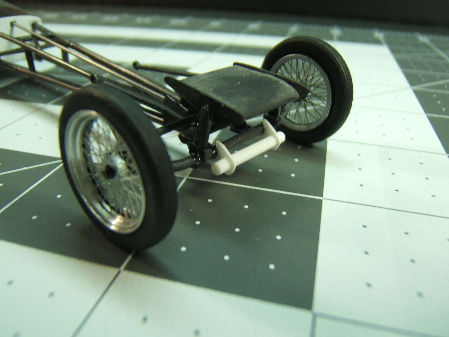

John Teresi Posted May 20, 2018 Posted May 20, 2018 19 minutes ago, Jimmy Wilson said: Really excited about this build by three of the best. I have a question for John. Are you just using half of the Herb Deeks wire wheels to make the dragster front wheels? Thanks ! Yes , I used 4 pieces to make 2 wheels

Jimmy Wilson Posted May 22, 2018 Posted May 22, 2018 On 5/20/2018 at 6:16 PM, John Teresi said: Yes , I used 4 pieces to make 2 wheels Thanks for the answer John. If you don't mind, could you tell me about the rims for the fronts? Did they come with the Deeks wheel kit? Thanks again, Jimmy
John Teresi Posted May 22, 2018 Posted May 22, 2018 1 hour ago, Jimmy Wilson said: Thanks for the answer John. If you don't mind, could you tell me about the rims for the fronts? Did they come with the Deeks wheel kit? Thanks again, Jimmy No......they are from MAS......Machined Aluminum Specialties......I believe you can get them from Ted`s

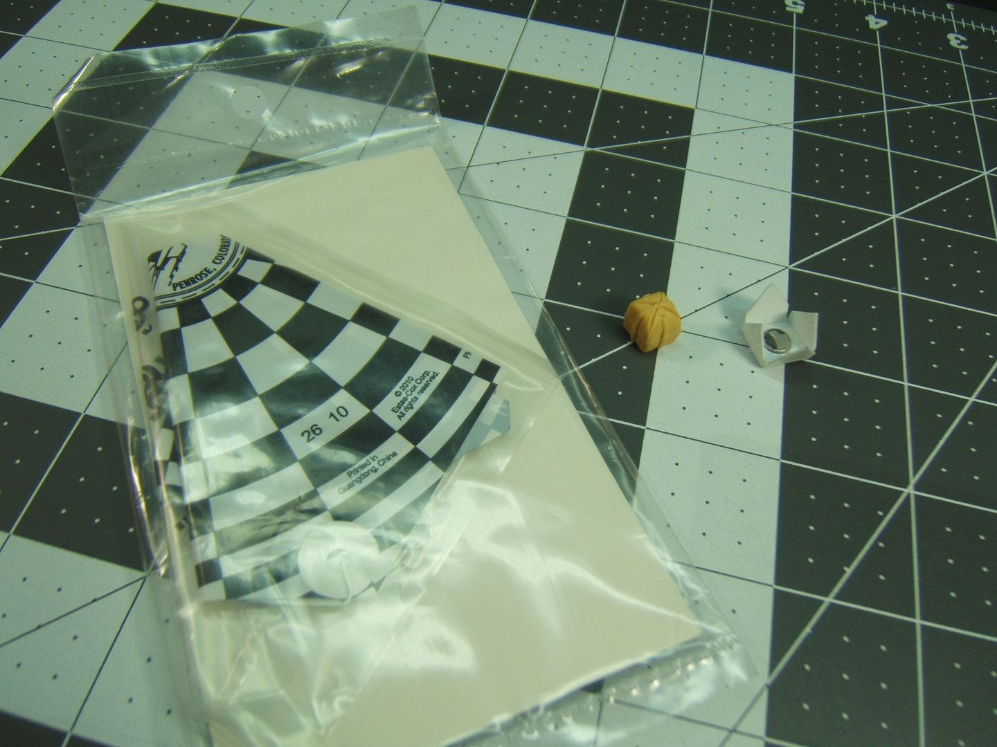

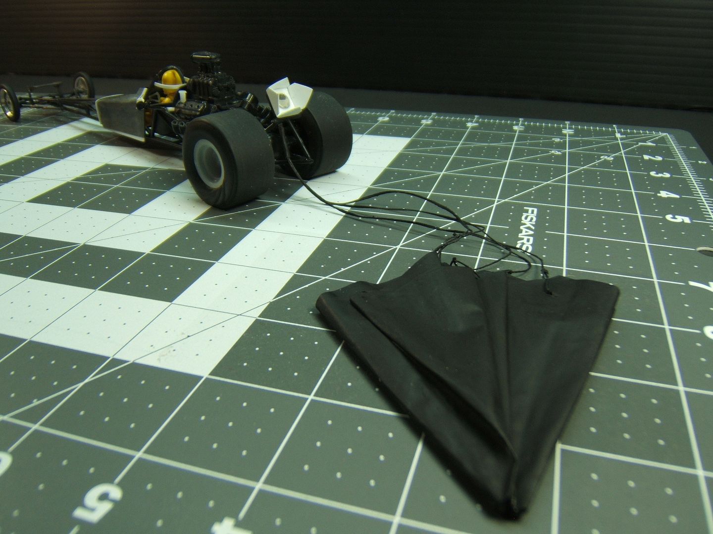

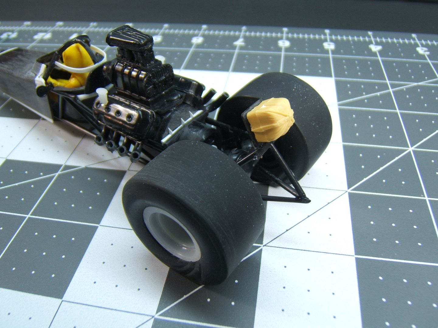

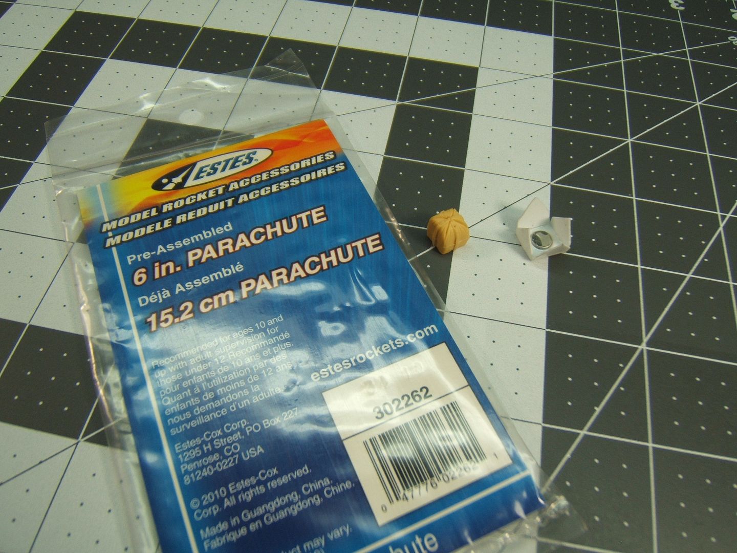

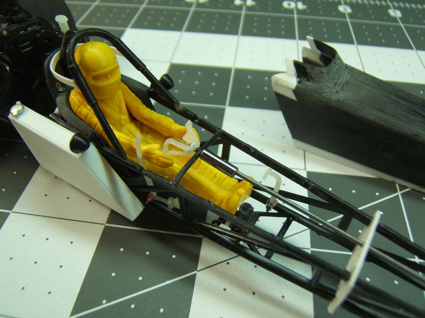

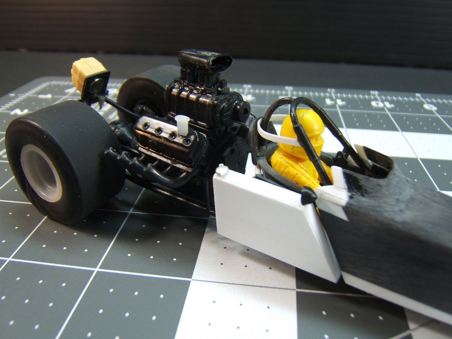

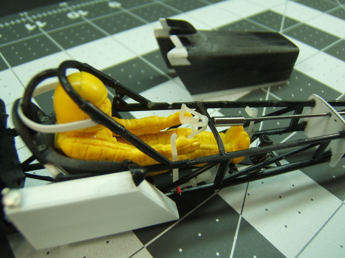

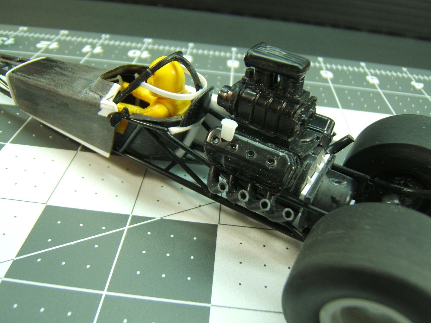

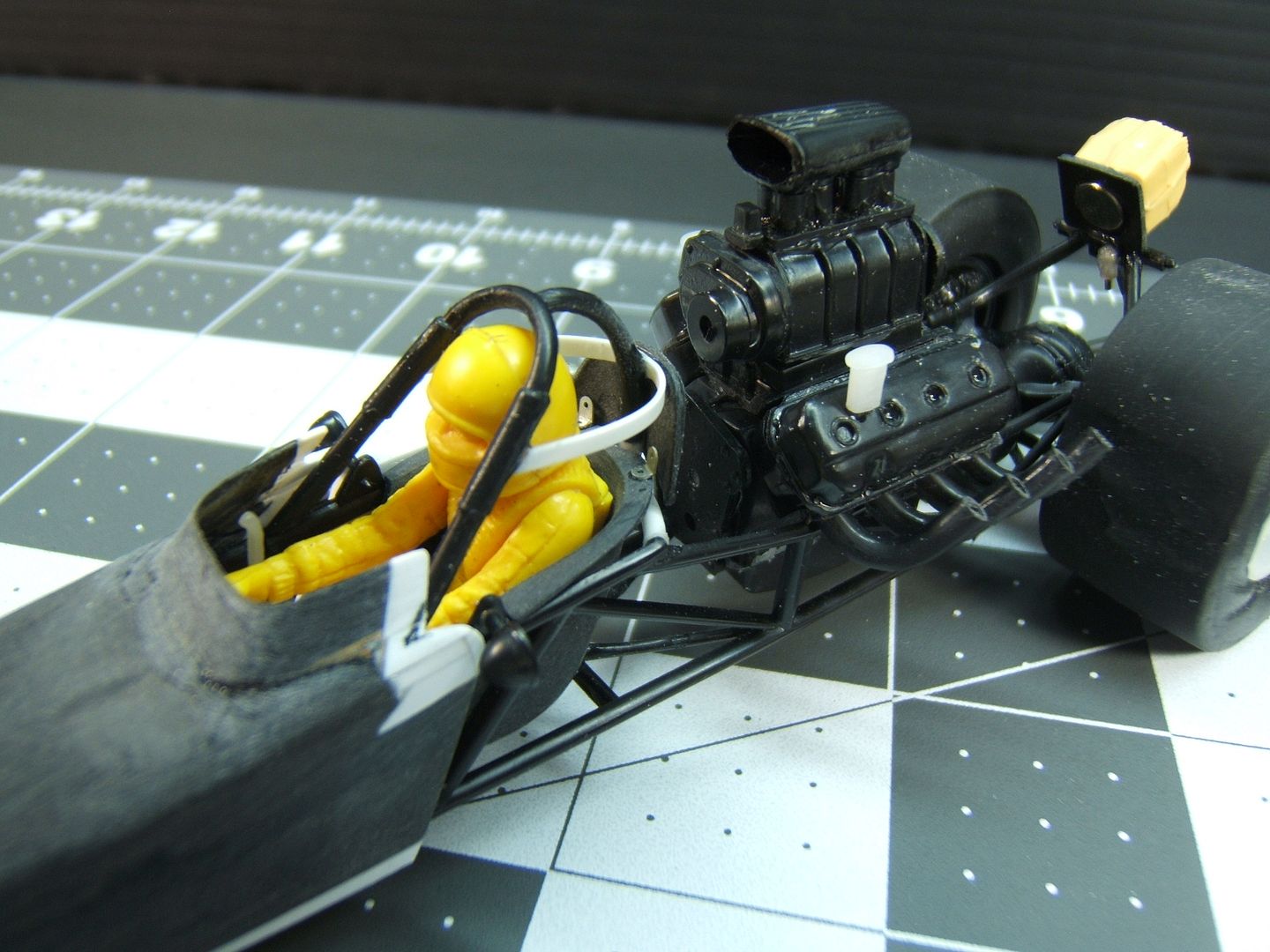

John Teresi Posted May 22, 2018 Posted May 22, 2018 Hello All.......I got a little more work done on this build ........I modified the the roll cage......I made a front axle weight ........I mocked up the gas pedal, brake handle, clutch pedal and steering wheel........I also mocked-up the mirrors ..........I mocked-up the rear axle and wheels and started to mock-up the engine.......this kit came with formed open parachute that many kits had .......I wanted to incorporate a deployed parachute or a closed parachute.......I added magnets for an easy switch out to use deployed or a closed parachute.......my good friend sent me vinyl parachute that I modified to look deployed and I`m using a "Pro Tech" closed parachute ........I will drill out all the holes for plumbing next......thanks for looking 1
Mooneyzs Posted May 22, 2018 Posted May 22, 2018 John...What an outstanding update. You are trucking along and making great progress. It looks great. Love the idea with the parachute and it looks so cool with a driver too.

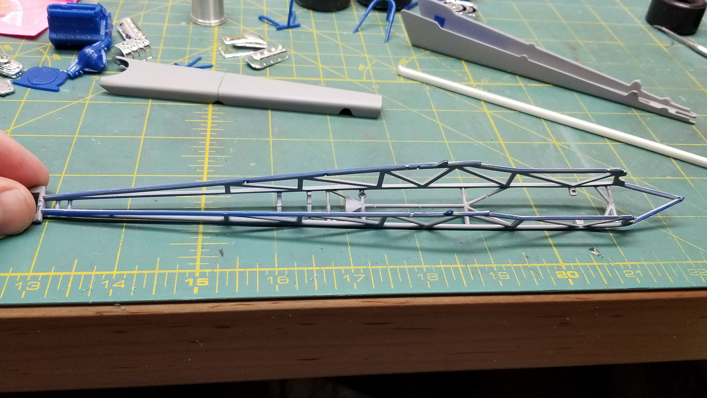

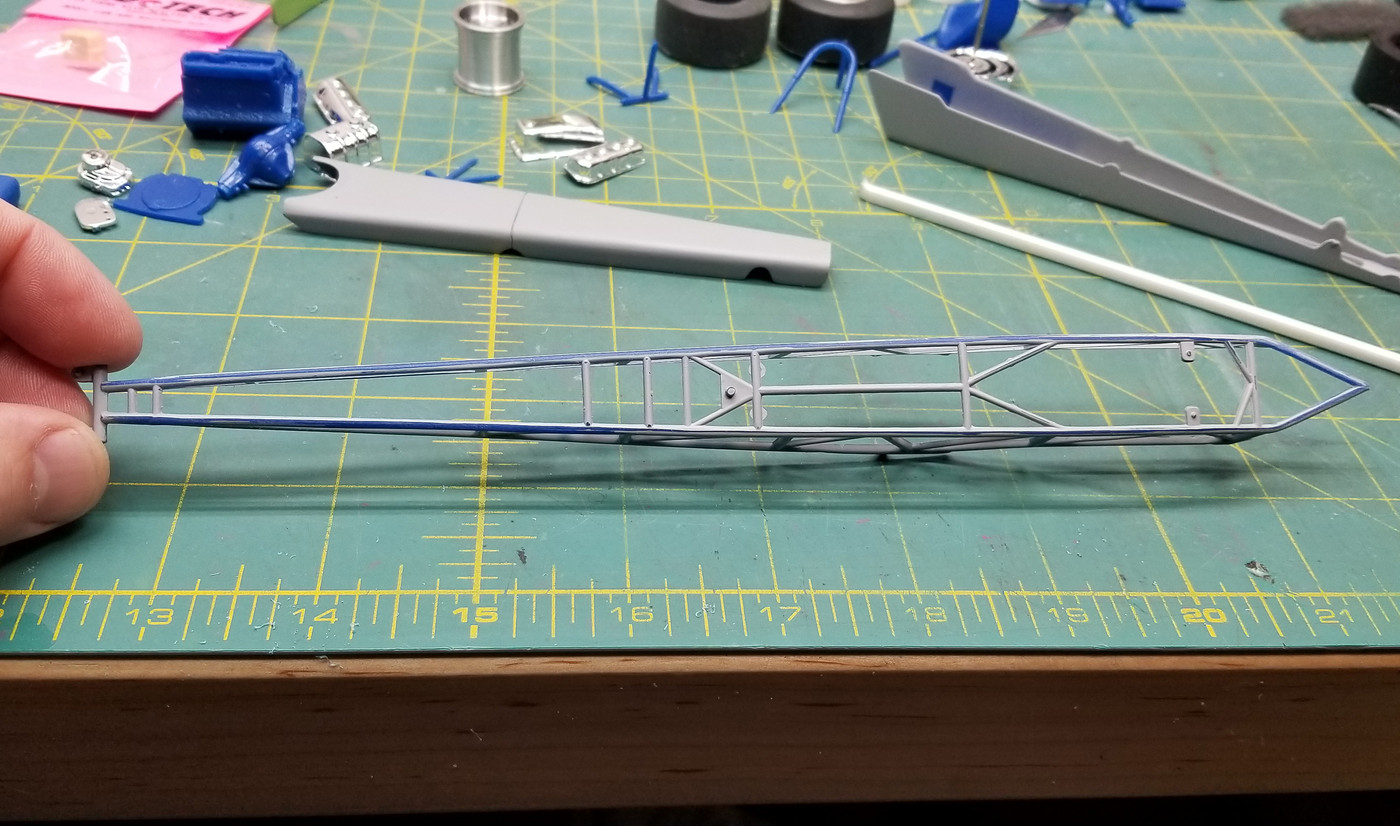

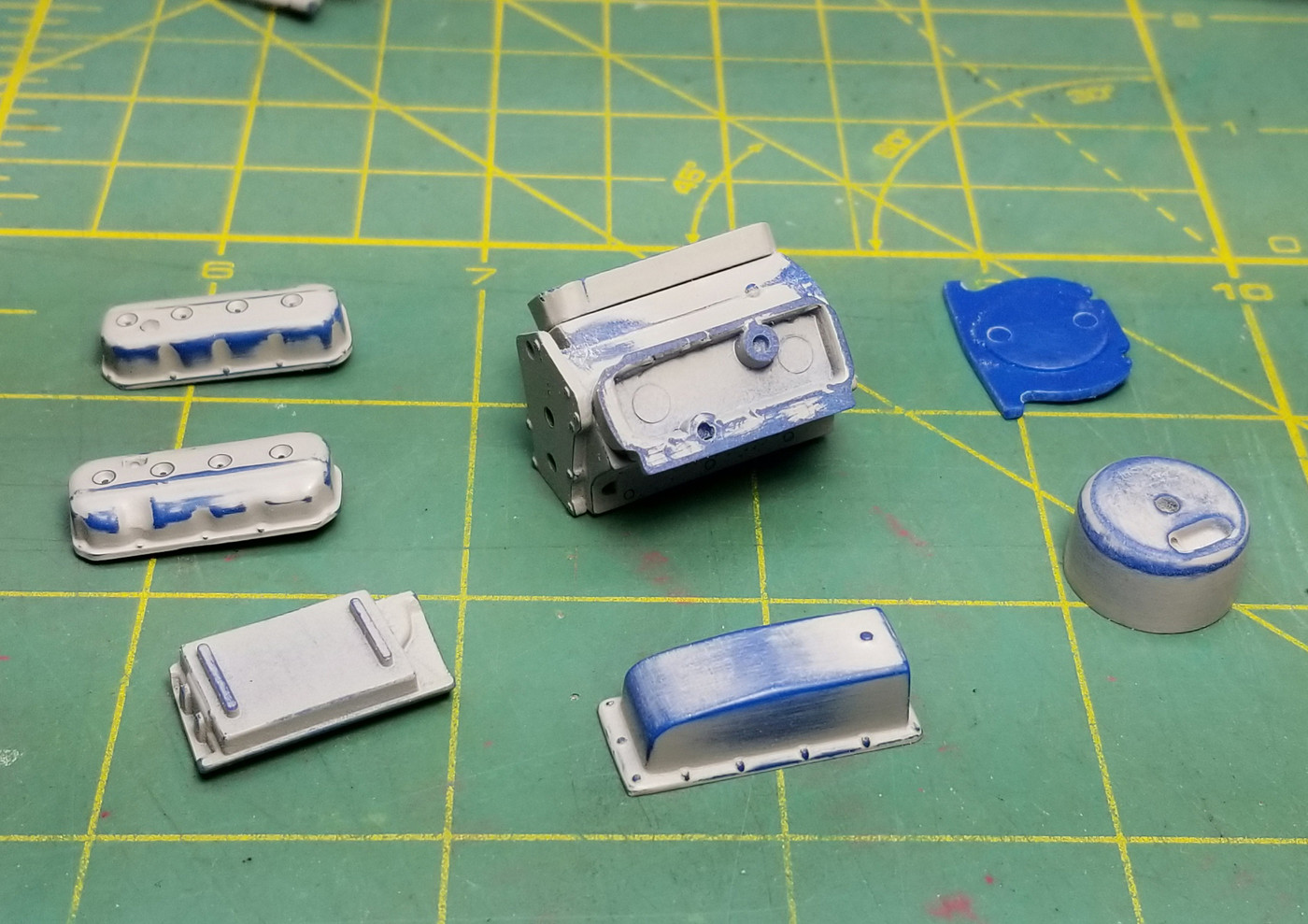

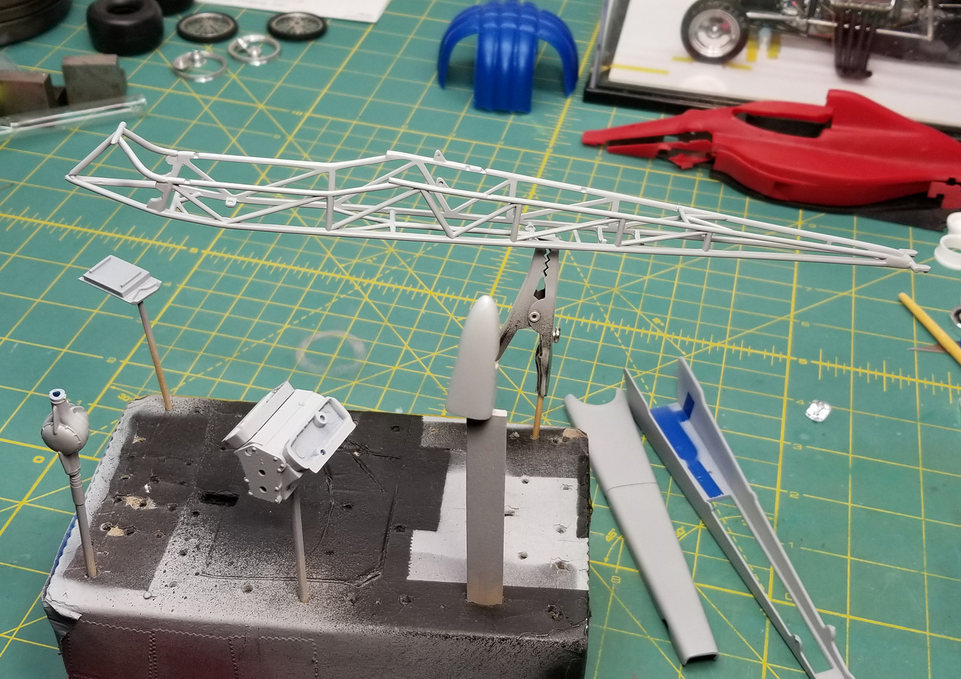

Mooneyzs Posted May 26, 2018 Posted May 26, 2018 Alright Fellas... got a little update to share with everyone as I have gotten a little more work done on my build. When I first stared sanding the mold lines on the chassis to clean them up for some reason they were sorta hard to see due to the color of the plastic I believe and I sprayed the chassis with primer so that I could see the mold lines and I started sanding the chassis away. Then it was time to get some of the engine parts in primer and re shoot the chassis with some primer:

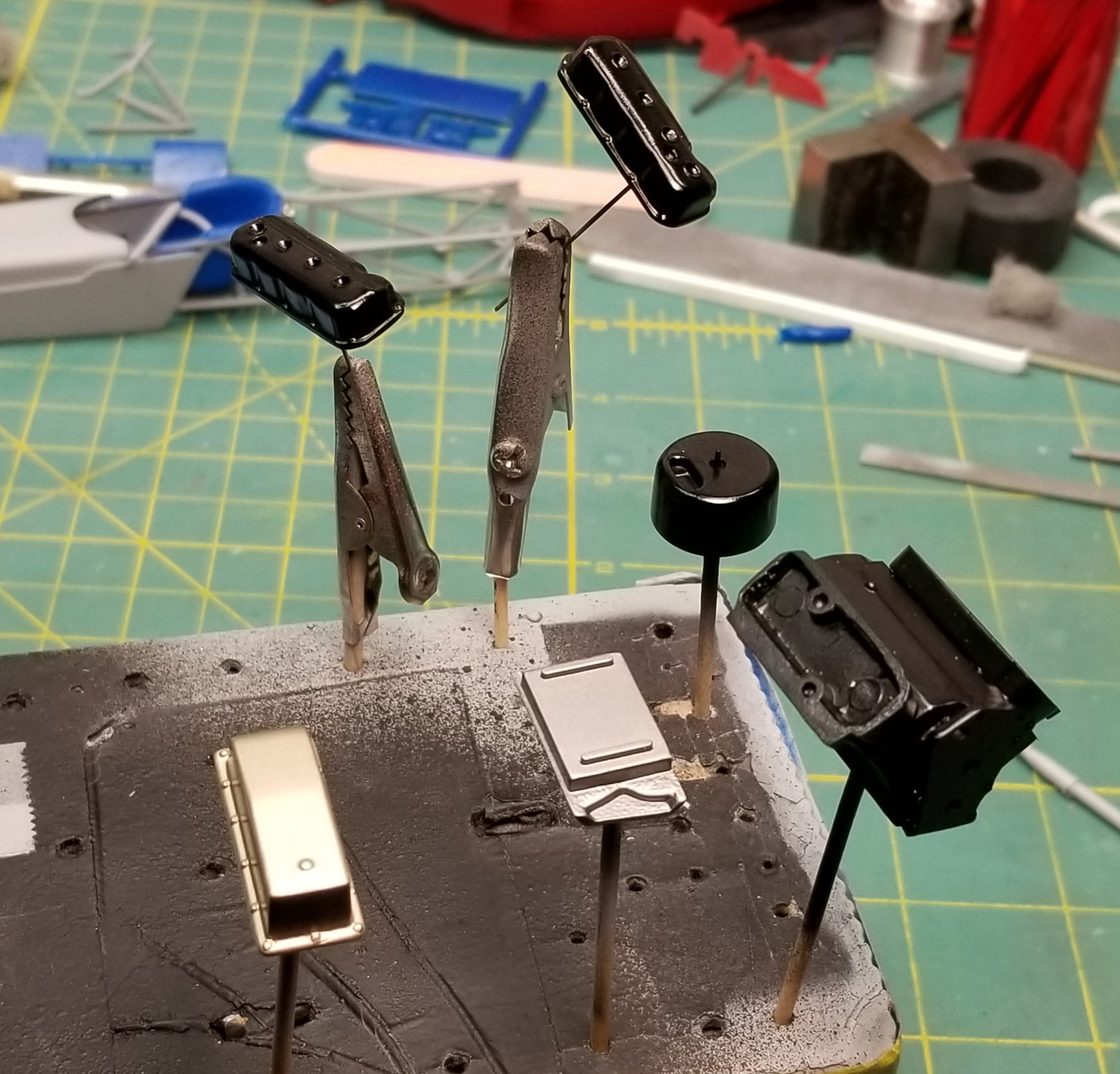

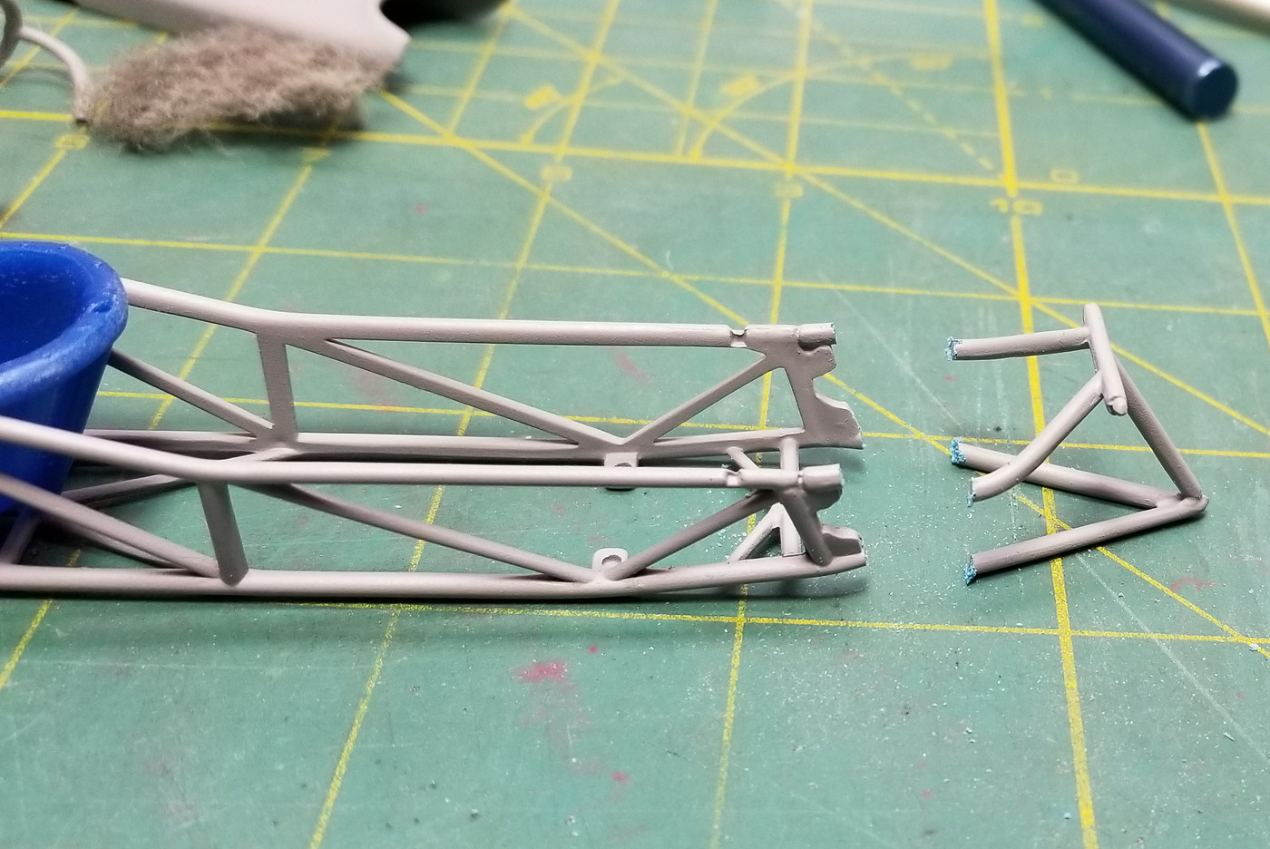

Mooneyzs Posted May 26, 2018 Posted May 26, 2018 Then in the mean time, I ran across a couple pics of MeEwen's dragster and it showed a push bar on the back and I thought it looked cool so I though what the heck that should be pretty easy to make and decided to chop off the rear of the chassis: Next it was time to prep some of the engine parts for paint, I scuffed them all up with some fine scotch-brite: Then yesterday after I got home from work, I broke the air bush out and painted the parts. I used House of Kolor Black base on the parts and then on the Manifold I used Alclad's Magnesium and the oil pan I was going to originally go with Alclad's Gold but I had issues with mine where it was sorta thick and gel like. I was bummed because I really wanted to use that color for it and it was a brand new bottle, so I had to settle for a Pale Burnt Metal. the block with stay with just the HOK black base and then the Valve covers and bell housing need to be cleared so that I can spray Alclad Chrome on them:
