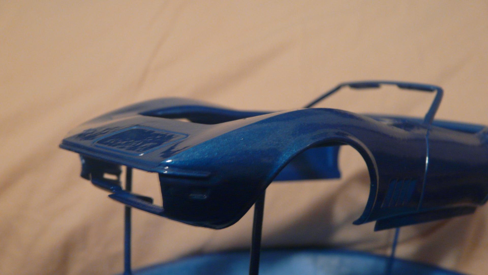

Hello all! This is one of my first model car builds in a while, mainly because school is out and summer is here. So now I have more time to grow my skills in this wonderful hobby.
Here it is so far, I'm still working on the chassis and little things here and there. I decided to make this a sleek and custom Corvette. I want to use the taillight pieces below, which may look like they are from a Corvette, but no. They are from a '58 Ford Thunderbird. A custom spice!  :)P1090637.thumb.JPG.51af836bba0446549c4842dd752ca2e3.JPG

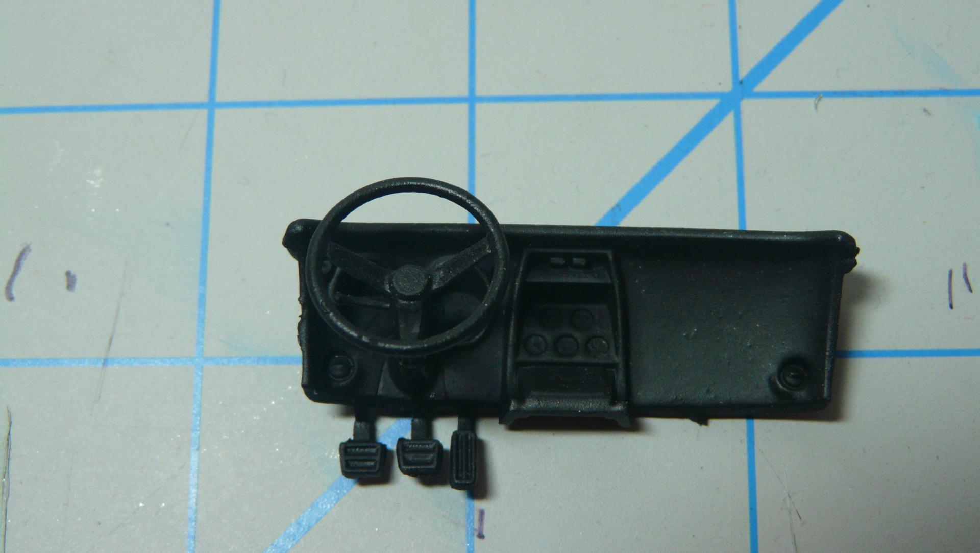

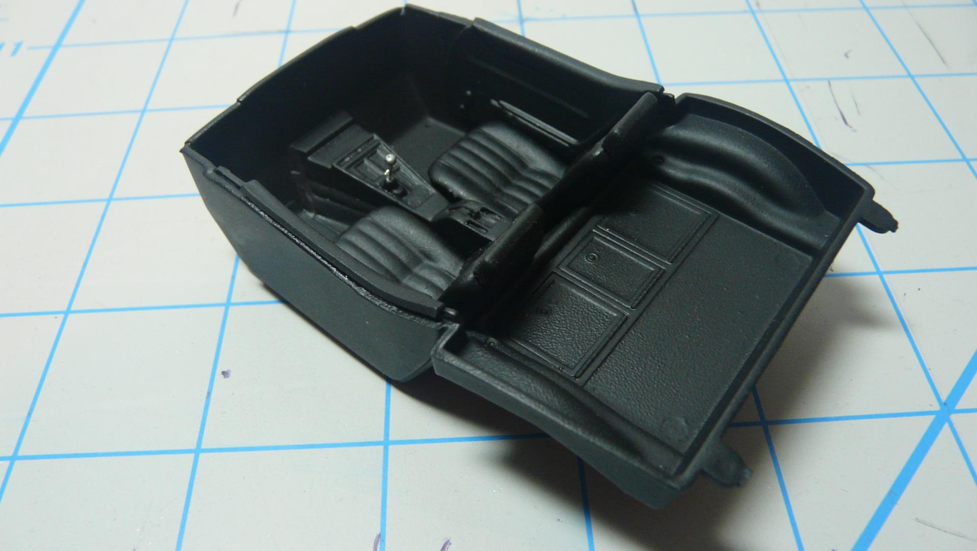

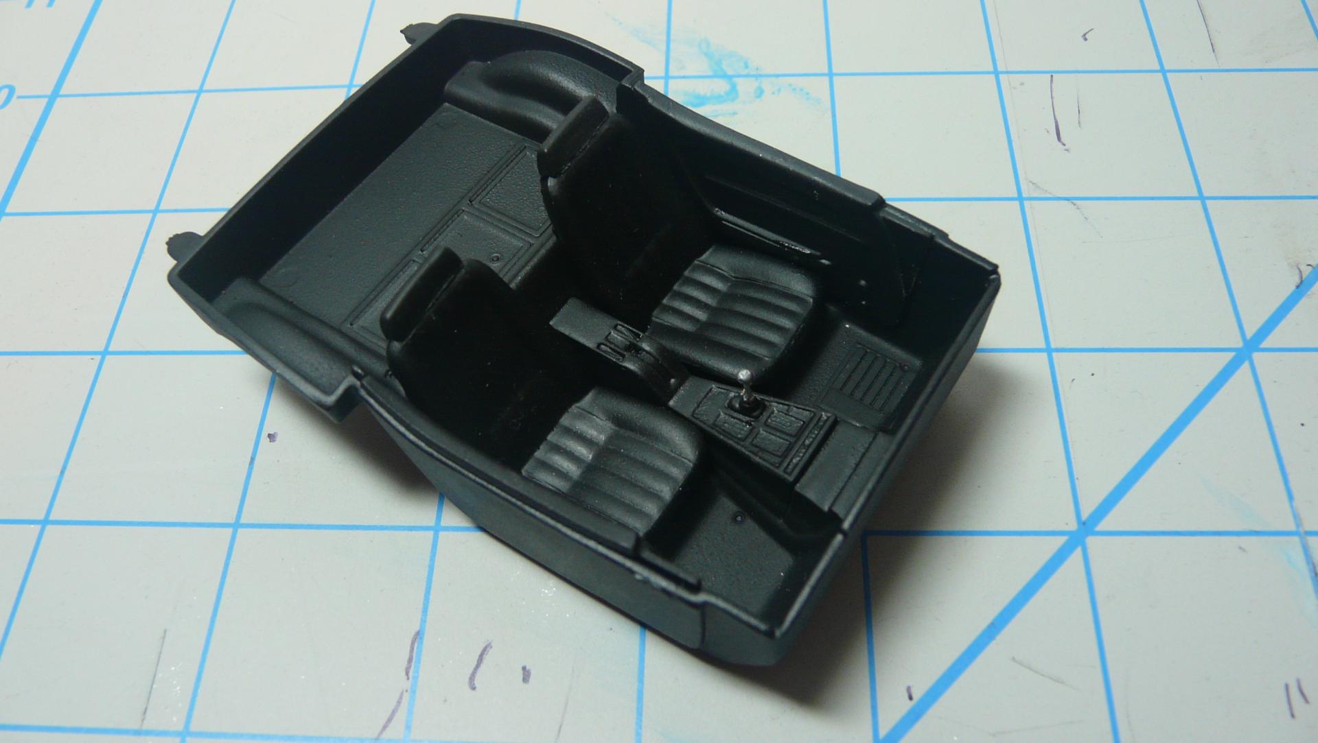

This is the first model car I've done with a flat-color interior. All of my previous builds have gloss black interiors, which I will admit is not very realistic. P1090633.thumb.JPG.1192478c3574895c9027d1d76e570aea.JPGP1090635.thumb.JPG.f74442e51f896f472ba4eaddb7d1feb9.JPGP1090636.thumb.JPG.e5252e7ccdb8f04e9da6f9edff7f06be.JPG

Yeah I will definitely be using flat colors for interiors from now on.

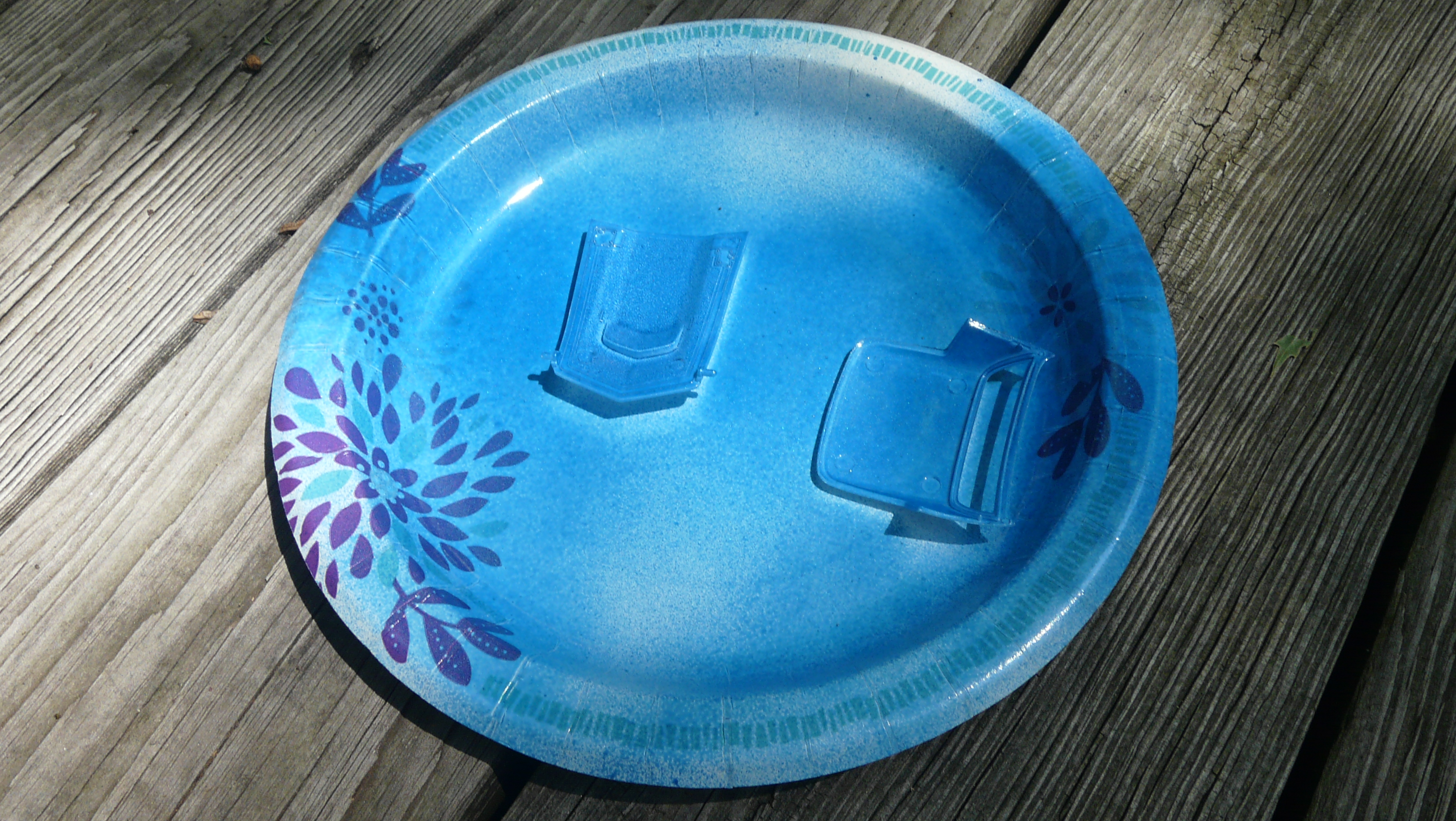

Here's some more progress. I acquired some spray paint for the body.P1090639.thumb.JPG.fb2b965a0113547ab1c632a8ef7ec4c4.JPGP1090638.thumb.JPG.84a71ab9cebe6f6ab4f30170d667ae3f.JPG

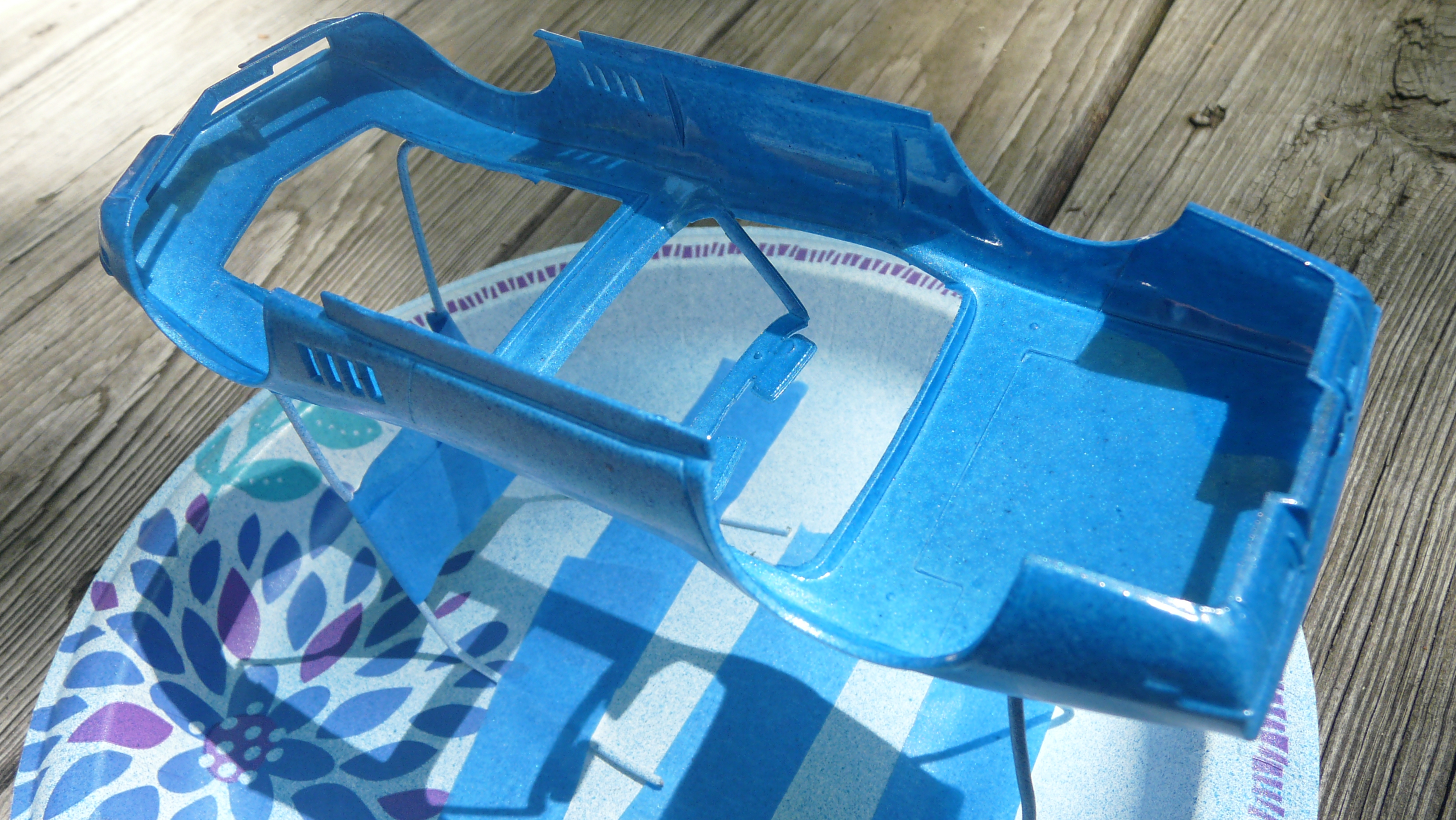

I always get the underside painted before I paint the side that viewers would see. Also, this is my first time using a wire coat hanger to hold the body for painting.
First coat is done on the underside of the body, hood and roof. I might do only one coat on the underside, or I might do more. I'm thinking on it.P1090646.thumb.JPG.18e7501068cbc1c07b8a2d36701ea7a4.JPGP1090647.thumb.JPG.4c0a0cf62f4aa617f03c952be99253e0.JPGP1090648.thumb.JPG.7c650e03261257b6485508cad9367d5a.JPGP1090649.thumb.JPG.2af63af3edc91a985248b5d5348c4c27.JPGP1090650.thumb.JPG.f3f08a037c5bec997718896eebfff5da.JPGP1090651.thumb.JPG.80130e5d29c7a9a22c833e1e6b2f1722.JPG

3 hours ago, Justin Dodson said:
First coat is done on the underside of the body, hood and roof. I might do only one coat on the underside, or I might do more. I'm thinking on it.P1090651.thumb.JPG.80130e5d29c7a9a22c833e1e6b2f1722.JPG
Well, that's some progress. I'm hoping tomorrow there will be more painting-appropriate weather outside. I guess time will tell :)

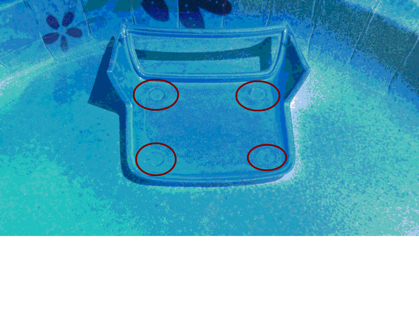

I'm surprised you don't clean up the ejector pin marks
Edited by BigTallDad
I wouldn't bother with those either, but I absolutely cannot stand parting lines or edge flash anywhere on the outside of the body. B)

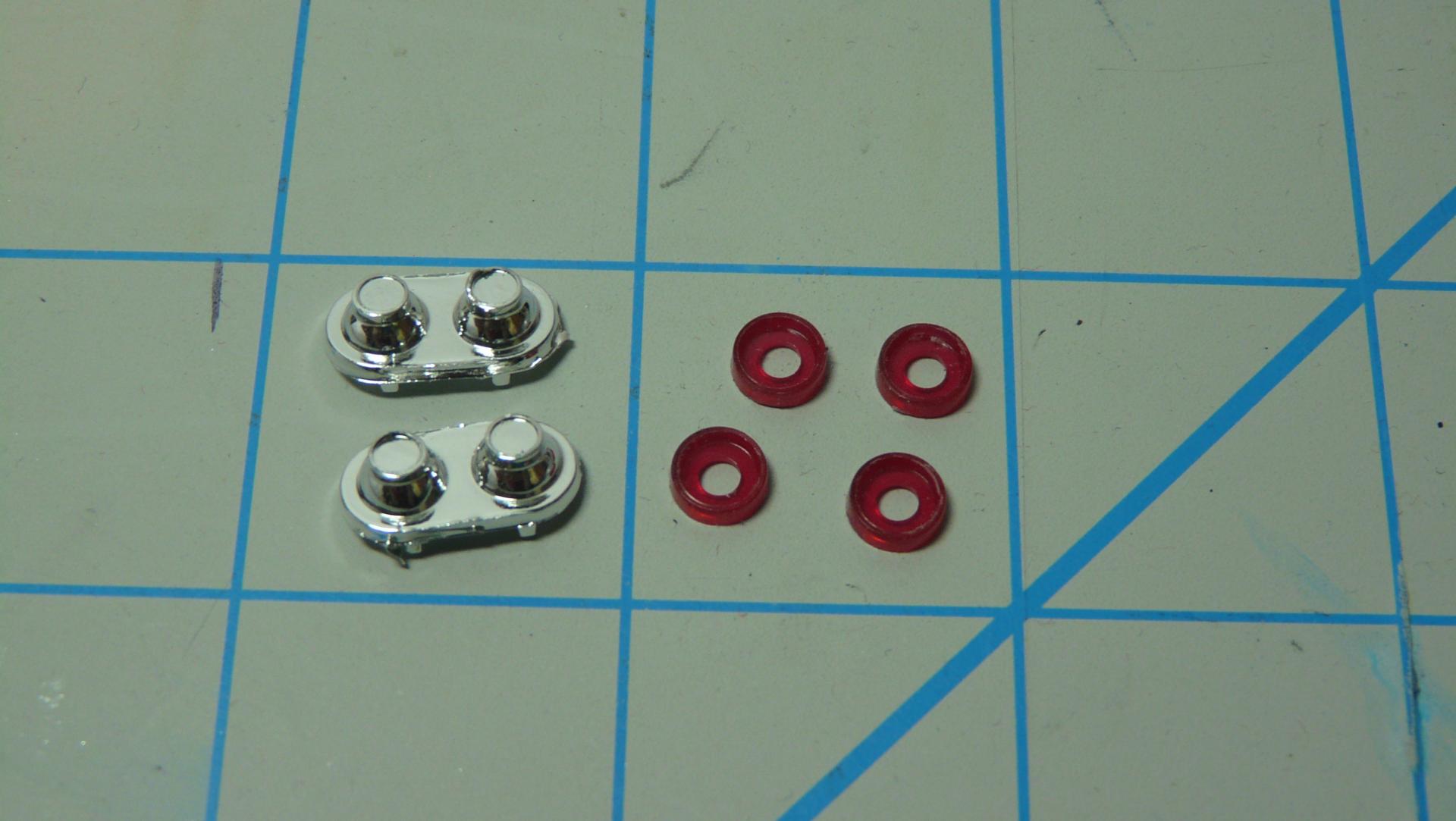

Corvette with T-Bird taillights, huh? That should be an interesting touch. Looking forward to see how it turns out. Nice color choice by the way.
Thank you! Yeah I can barely wait to see how those taillights turn out.

If you rub your finger on the outside of your nose and then rub the flat interior, it will magically appear to be leather.
I can't tell if you're joking or not. If I try that out then it will be on a piece of scrap plastic lol  :D
10 hours ago, crazyjim said:
No joke.  It really works.  Something about natural body oils.  Gives a GREAT effect on vinyl tops.
Wow, okay. I guess I'll have to give that a try some time.

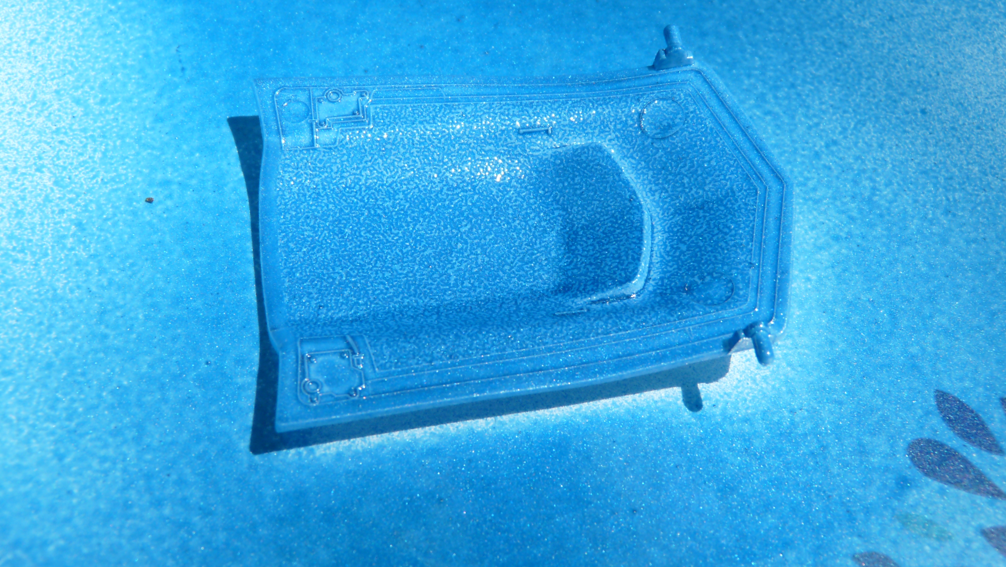

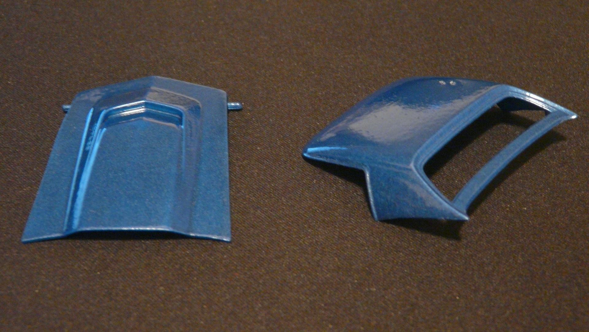

Also, I have heard that rubbing wet sandpaper with toothpaste works well for removing orange peel on body parts. Below are some pieces that have orange peel, and then some toothpaste I recently acquired... (sorry for the blurriness)P1090668.thumb.JPG.f4f5912494f8c50dd26cbe0ddef13e63.JPGP1090665.thumb.JPG.8e42d1cda1acb853ff75663d1d4c14e2.JPG
Can someone confirm if that method is alright for eliminating orange peel (also some "fish eyes")?

Fish eyes are from contaminants on the surface when you painted. You’d probably have to sand them down smooth and repaint them, depending how deep they are. Color looks great though.

Sandpaper has grit. Toothpaste has grit.  So using both is a double whammy.  Try one of the polishing systems out there which start at 2500 grit and in 6 steps goes up to 12000 grit.  Then use something like Novus #2 to remove any marks, following a coat on The Treatment Model Car Wax.  Don't forget a small squirt of Dawn in you water for  better sandpaper lubrication.

You certainly can use toothpaste to polish out a model. I used to do it all the time back in the '80s.  , , and I do mean "all the time" it used to take days to polish out a model with the stuff.
If you don't think your time is worth much you can go that way.
Now I use a set of micro mesh polishing cloths and Tamiya polishing compound. Takes a few hours to polish out a model with this.  I't gonna cost you about what you'd pay for a model to buy the stuff but you can do at least a 1/2 dozen cars with it.
Put it this way ,, would you rather cut a tree down with a steak knife or a power saw? ;)
I don't know if that type of toothpaste will polish paint or not--some will, some just make things even worse--but it looks to me like your orange peel is so severe that polishing isn't going to smooth it out, it's just going to make shiny orange peel. I can tell you this because I've recently trying polishing two or three OP projects that looked very similar to yours. Two of them couldn't be fixed and I had to strip the paint and start over.
I think at this point your best bet would be to lay on two or three coats of a good clear coat, let that dry, wet-sand the clear smooth, and THEN you can start polishing.
Polishing severe orange peel just gets you shiny orange peel.
Alrighty. I also just realized something, I think my main problem was I wasn't always spraying vertically. The top side of the body was being sprayed with the can horizontally. I guess I should just position each part so the current surface will be sprayed with the can upright?
I would. It isn't always possible, but if you can spray at an angle 45 degrees or less, it should be good enough. I usually spray a body on each side (front, back, and sides) and try to get the top of the model while doing those, kind of like halves. Obviously you won't always get the roof spraying from the front, but you usually can from the sides without tilting your airbrush/spray can too awful much. It should be enough to keep the paint even. For spray paint, I've also heard of people heating the can in warm water for a bit, and then the typical shaking afterwards. They claim it helps spray more evenly, though I haven't tried it myself so I can't confirm it.

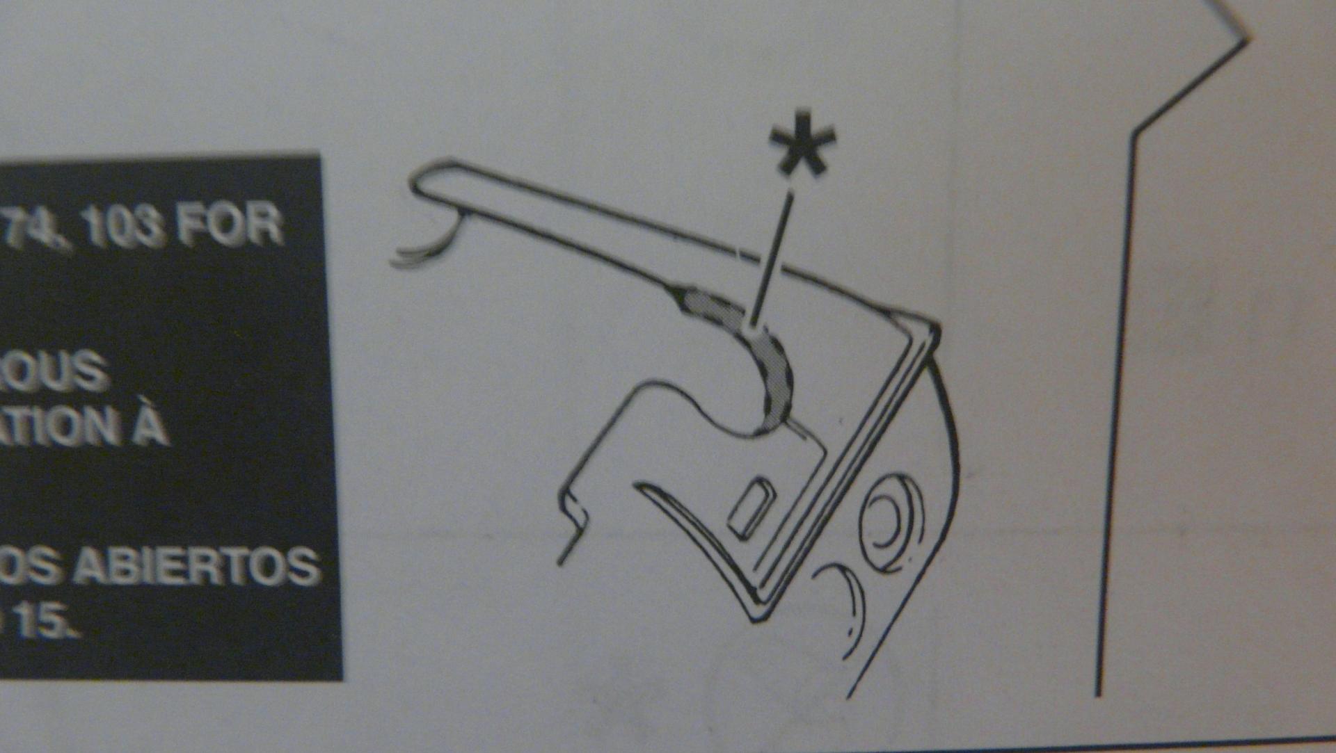

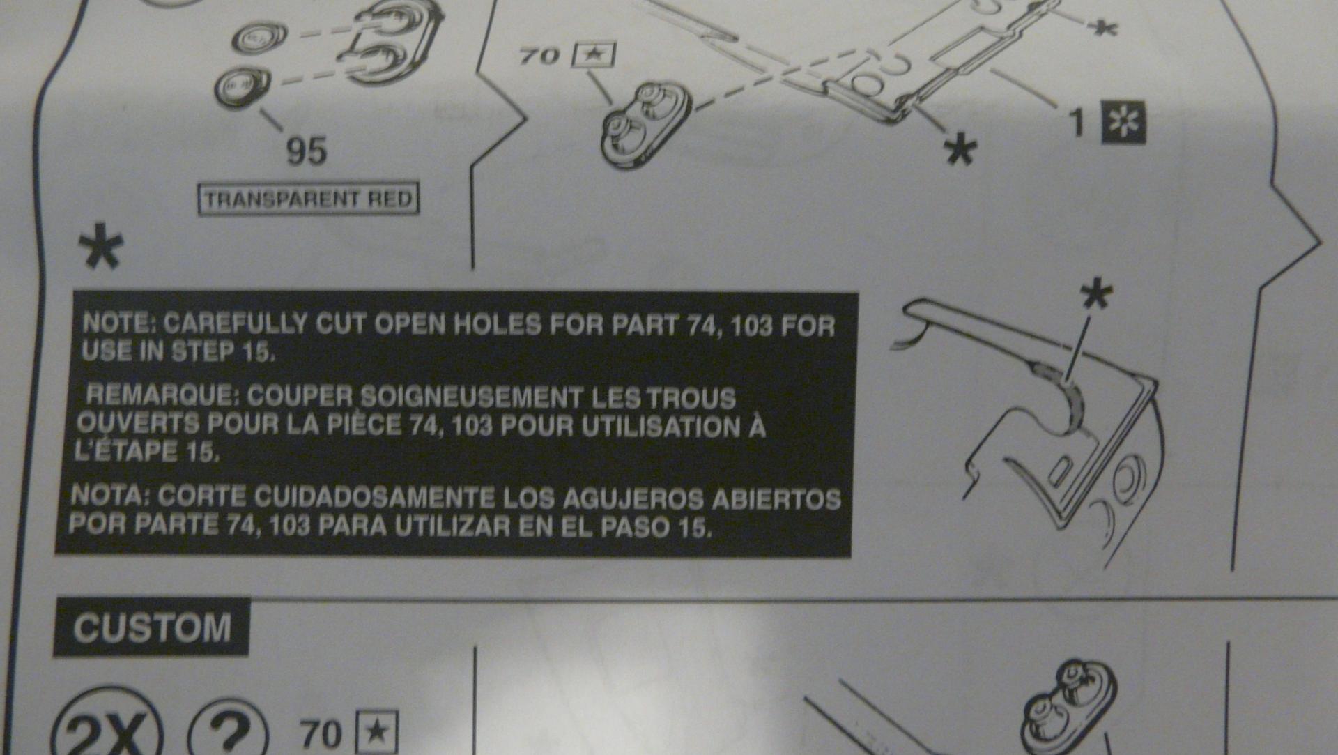

I must bring to your attention that in the instructions, there is a step that says to cut out 2 circles for the exhaust tips. The circles are there, the plastic of the circles are just more thin than the rest of that panel. I couldn't tell if you already knew about this, but I figured if you did it still might help someone else that was confused.
P1090678.thumb.JPG.32b6696da8cc75503076e43715aa945d.JPGP1090680.thumb.JPG.cab8a625c88e6139ad0cbc34d00de932.JPGP1090676.thumb.JPG.996654bc7e15af2b2d7b130da55c50ff.JPG
Well then, you looked at the instructions so you would know. You may want to consider buzzing that thinned area out before final paint in order to avoid chipping the paint while buzzing it out. Carry on!

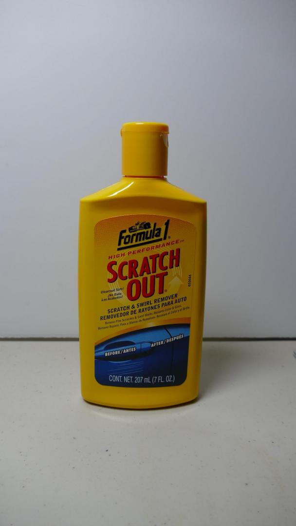

Hey guys. Sorry for the lack of progress these past couple days, I had some surgery. I'm currently recovering. I did acquire something though, it's called "Scratch Out". I found out about it in a YouTube video involving fixing orange peel. Anyway, I tried it and it does work, but I still think I will need to repaint the main body piece.
