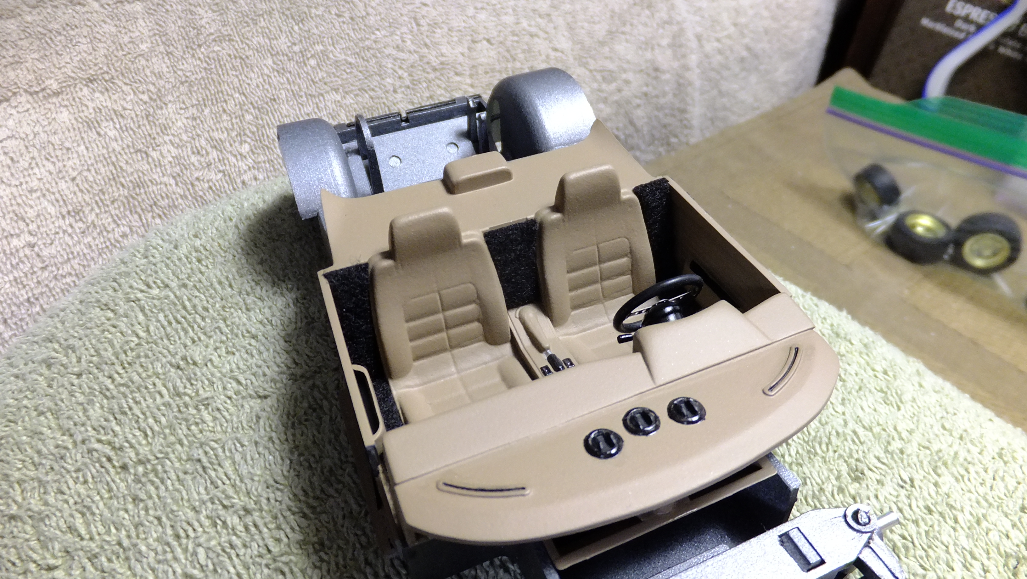

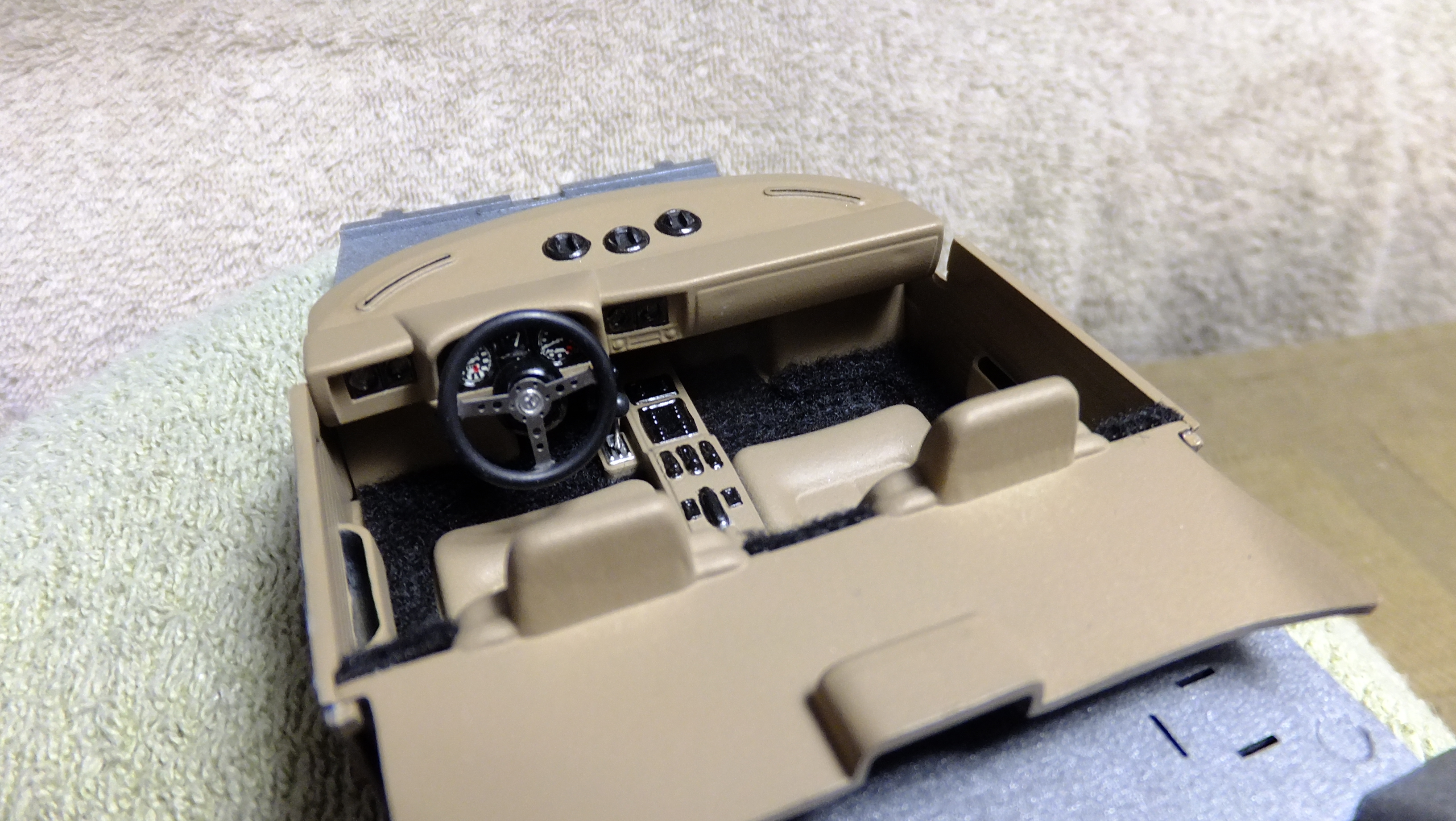

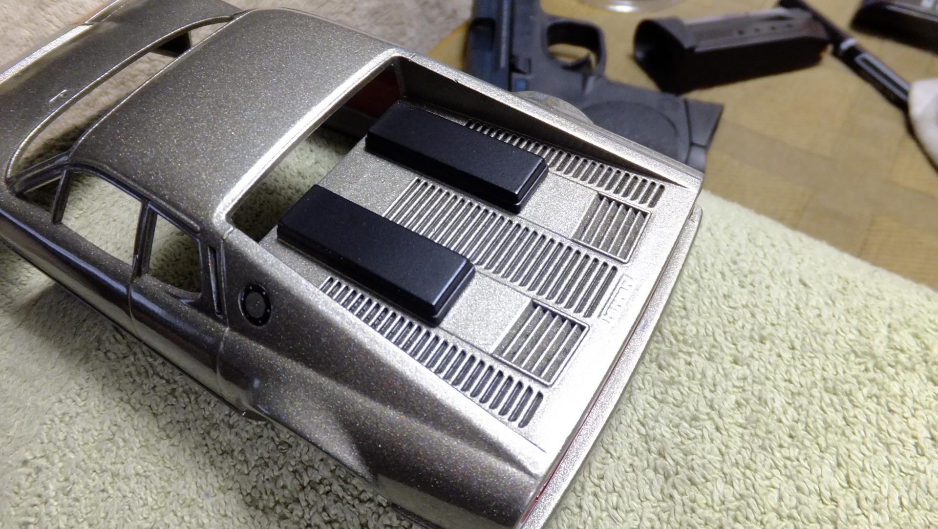

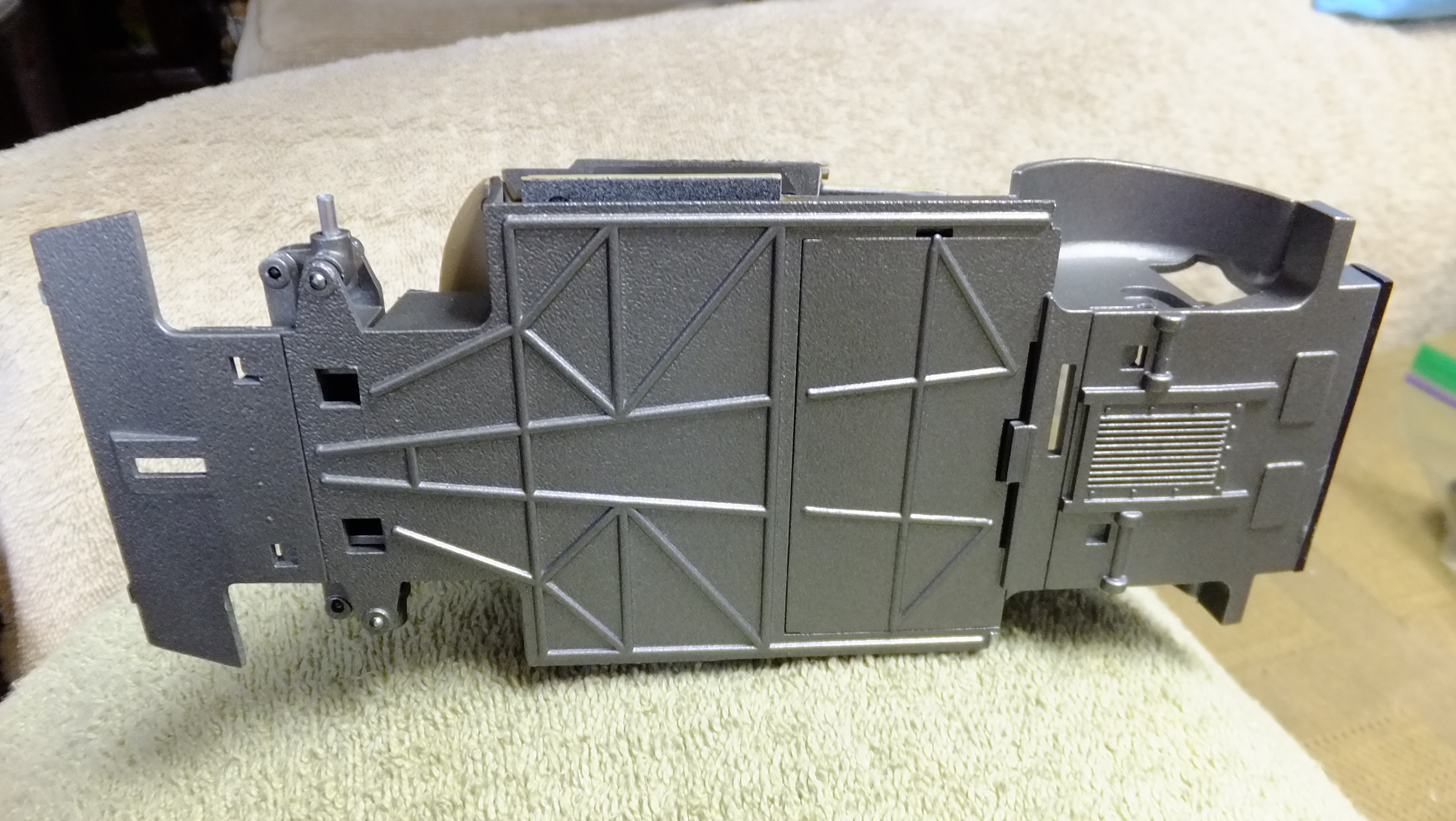

Dann Tier Posted August 7, 2018 Share Posted August 7, 2018 Hey, everyone!, while I was re-organizing, and adding more shelves to the modelroom, I came across this model that I had given to a friend to be his first build. Not wanting to get into it too much, but he's not around anymore, so I decided that i'm going to finish it for him. The only thing I've done so far, is add some Tamiya panel line paint, but the really hard thing for me is to NOT cut the very simplistic seats out, and make them more realistic.....I have to resist..lol here it is before I start.... Quote Link to comment Share on other sites More sharing options...

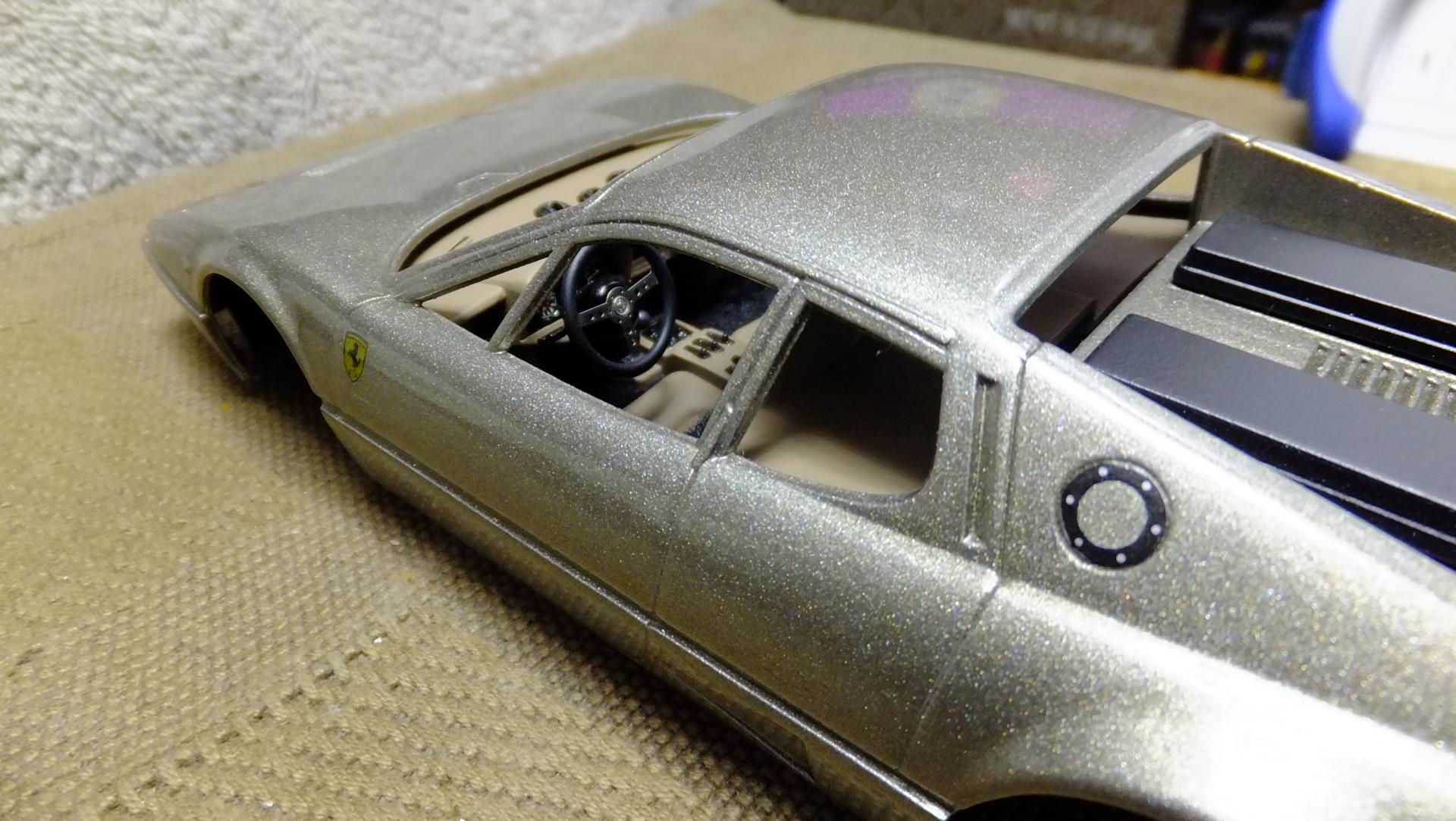

martinfan5 Posted August 8, 2018 Share Posted August 8, 2018 What paint/color did you use, it looks good on it. Quote Link to comment Share on other sites More sharing options...
Dann Tier Posted August 8, 2018 Author Share Posted August 8, 2018 4 hours ago, martinfan5 said: What paint/color did you use, it looks good on it. My friend used Duplicolor Pewter Metallic, Jonathan. Quote Link to comment Share on other sites More sharing options...

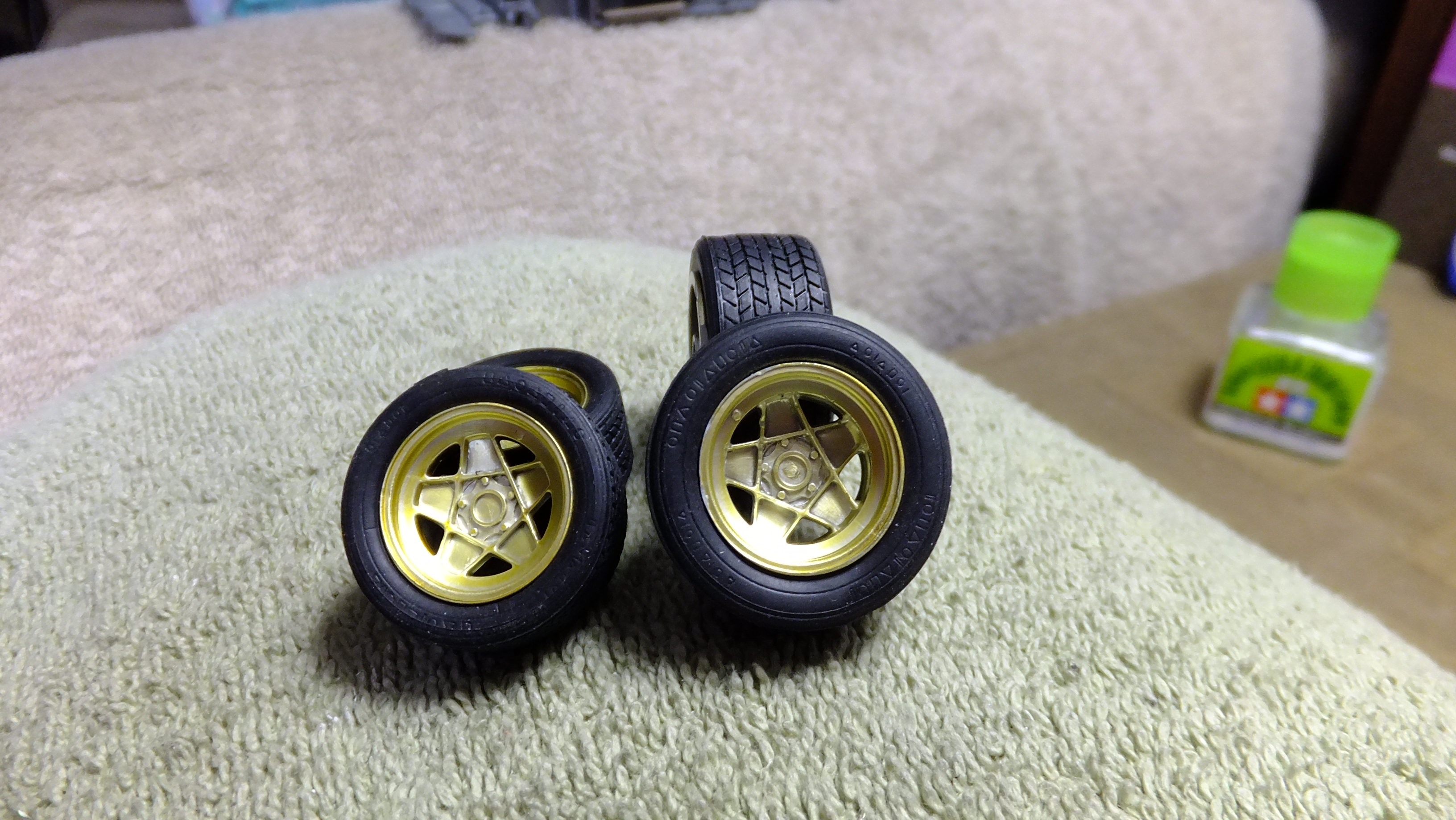

Dann Tier Posted August 8, 2018 Author Share Posted August 8, 2018 He didn't have any wheels or tyres in his box, so I took the wheels out of a Fujimi Ferrari P330 kit, and I think the tyres came from one of my De Tamaso Pantera kits. Quote Link to comment Share on other sites More sharing options...
martinfan5 Posted August 8, 2018 Share Posted August 8, 2018 9 hours ago, Dann Tier said: My friend used Duplicolor Pewter Metallic, Jonathan. That is really nice color, oddly , it really fits the 512. Quote Link to comment Share on other sites More sharing options...
djmcguire Posted August 8, 2018 Share Posted August 8, 2018 I'd forego the compelling need to detail and try to finish as he would have...seems a fitting tribute. Quote Link to comment Share on other sites More sharing options...

Dann Tier Posted August 8, 2018 Author Share Posted August 8, 2018 33 minutes ago, djmcguire said: I'd forego the compelling need to detail and try to finish as he would have...seems a fitting tribute. That's what i'm gonna do...but its tough for me...lol Quote Link to comment Share on other sites More sharing options...

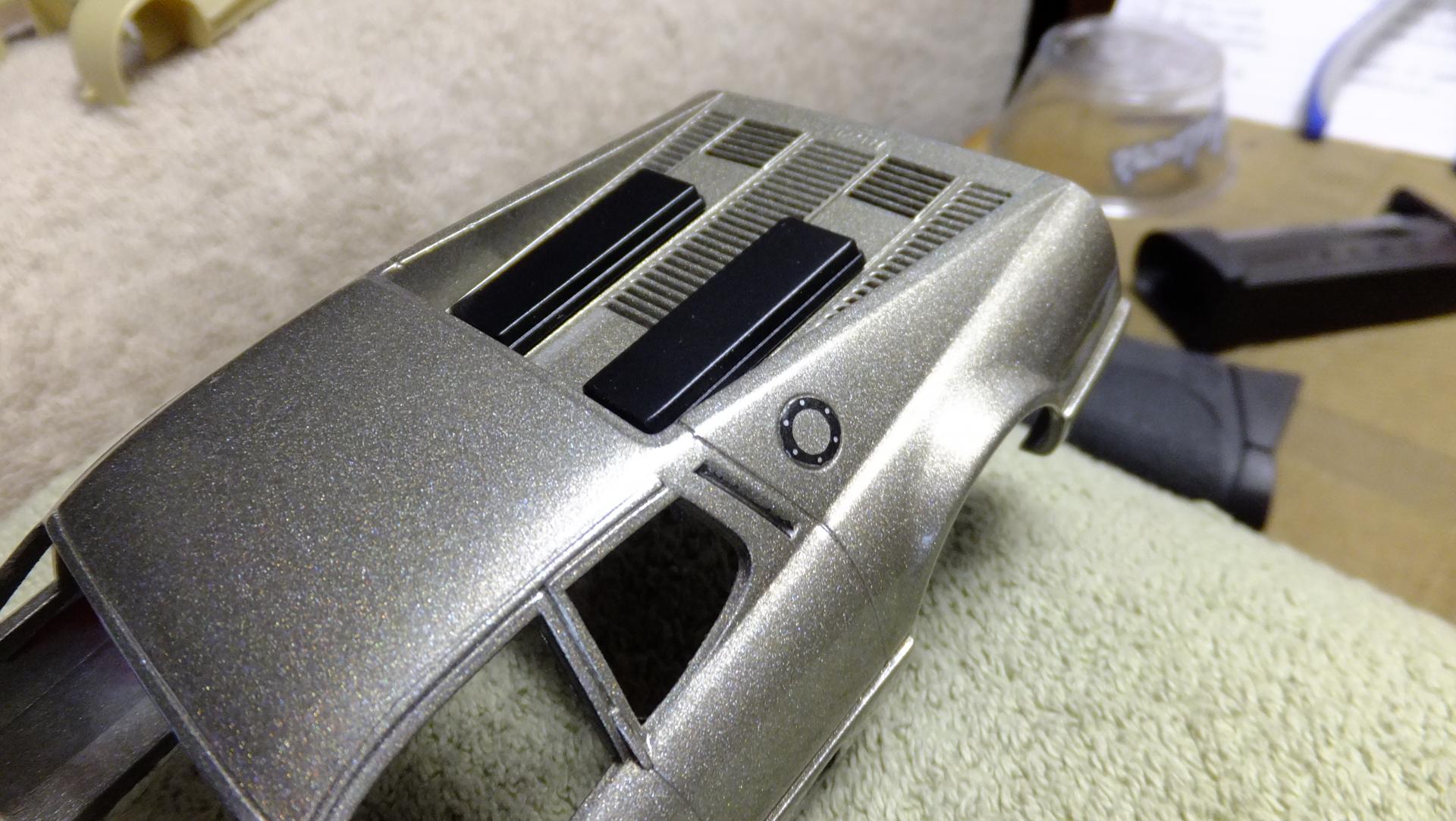

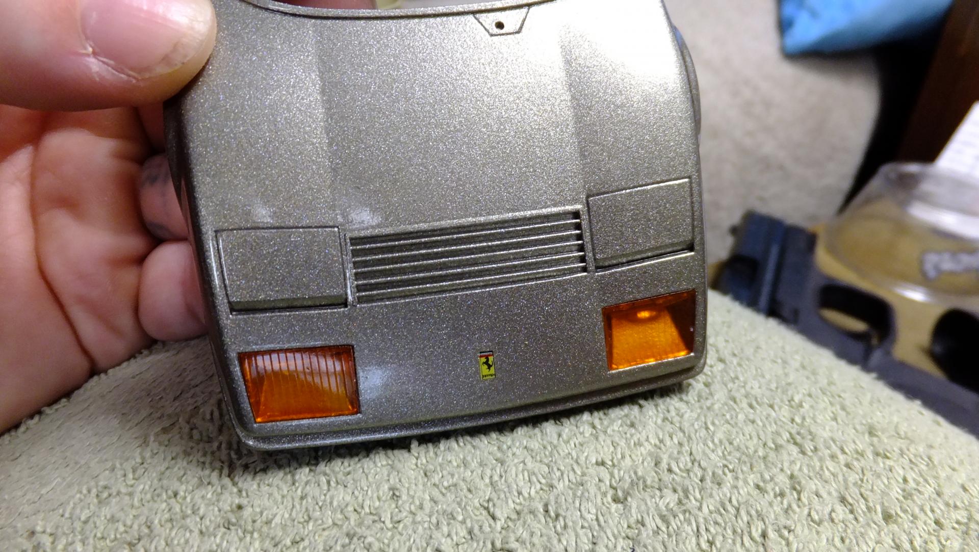

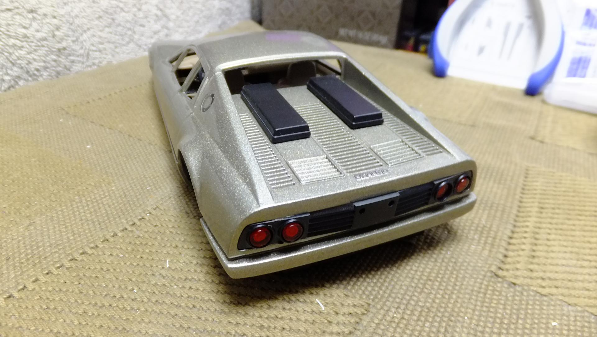

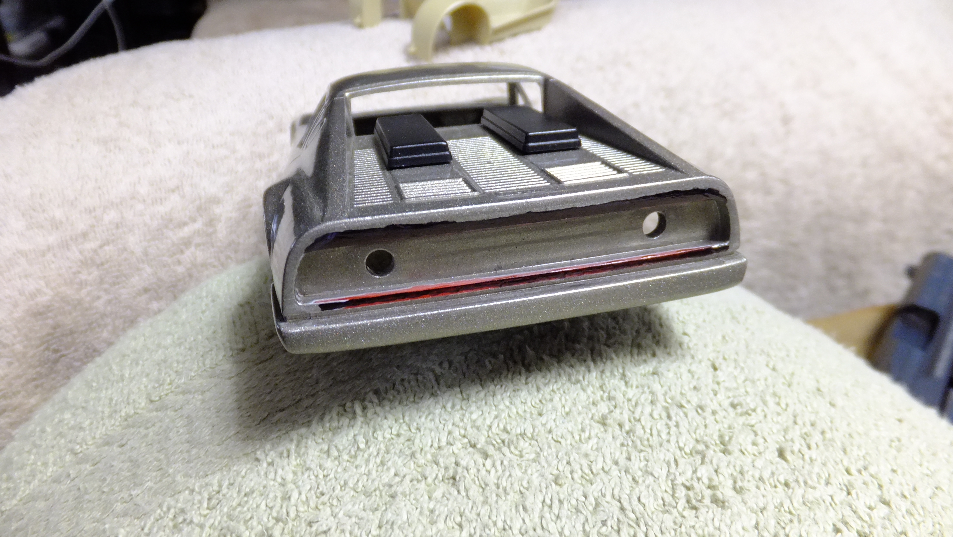

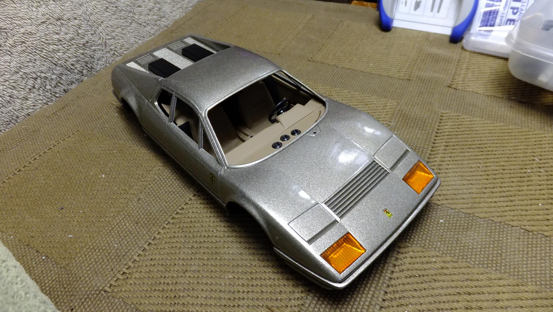

Dann Tier Posted September 5, 2018 Author Share Posted September 5, 2018 The rear taillight panel was jammed in there, my friend didn't sand it enough to fit in properly, so even though I carefully scored around it with my Olfa, it took chunks of paint off. I carefully sanded it smooth, then put a good amount of super glue over to act as a glazing putty. After that, I kolored the area to be sanded , with a sharpie so that I can make sure its repaired properly. I used Tamiya panel line accent on all the vents, and just a hint on the leading edge of the head lamps. Quote Link to comment Share on other sites More sharing options...

Dann Tier Posted September 6, 2018 Author Share Posted September 6, 2018 13 hours ago, jchrisf said: I love that paint color Thanks, Chris!!, me too!, if i'm not careful, I think i'd use it on everything....lmao!!! -its Duplicolors Pewter Metallic. Quote Link to comment Share on other sites More sharing options...
Italianhorses Posted September 6, 2018 Share Posted September 6, 2018 Great color, but IMO metallic grain is way out of scale, maybe just looks that way in the pictures. Terrific paintjob though! Quote Link to comment Share on other sites More sharing options...
Dann Tier Posted September 6, 2018 Author Share Posted September 6, 2018 2 hours ago, Italianhorses said: Great color, but IMO metallic grain is way out of scale, maybe just looks that way in the pictures. Terrific paintjob though! Thanks, Alex!, its a favorite of mine. I wish I could tell my friend that you like it, but he's not around anymore. Its not the photos, the flake IS out of scale for a "stock" version of this, or most cars. I will be using this kolor on my Pagani. As long as there is "real" automotive paint that has large flakes in it......and there IS, technically its NOT out of scale. I am not a purist by ANY means, and I VERY RARELY build anything replica stock. Modelling to me, is being given the chance to change the things that I don't like about a particular car. If we cant do that here, then whats the point? To me, you're the Ferrari Guy....LOVE your builds!! Me?, i'm the self-proclaimed Lamborghini Guy.....its pretty cool I think! You probably wont like my Ferrari builds very much, since I REFUSE to paint them red...lol, but each to their own. I have just as big a Ferrari stable as I do a Lamborghini stable. lol Quote Link to comment Share on other sites More sharing options...
