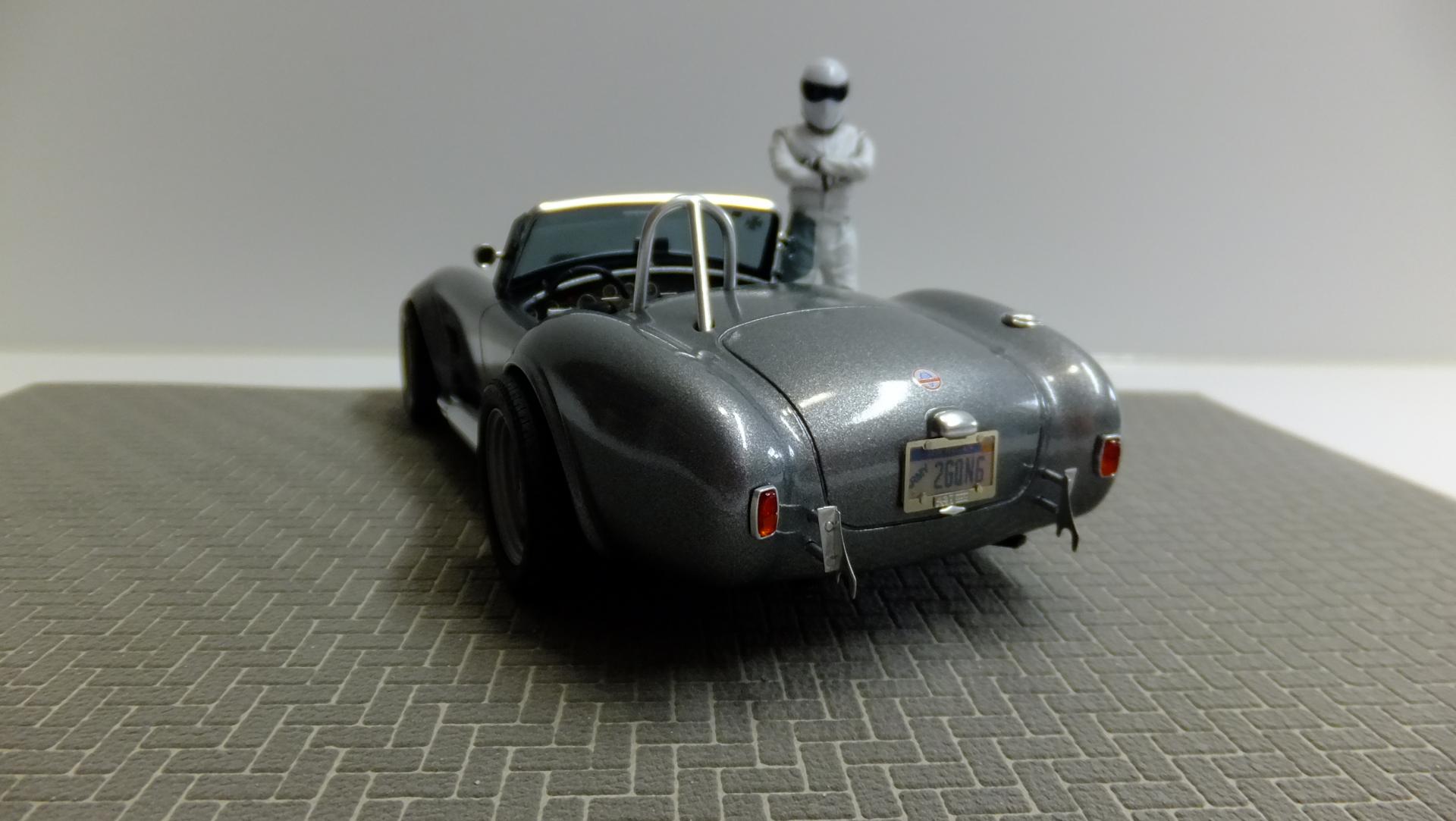

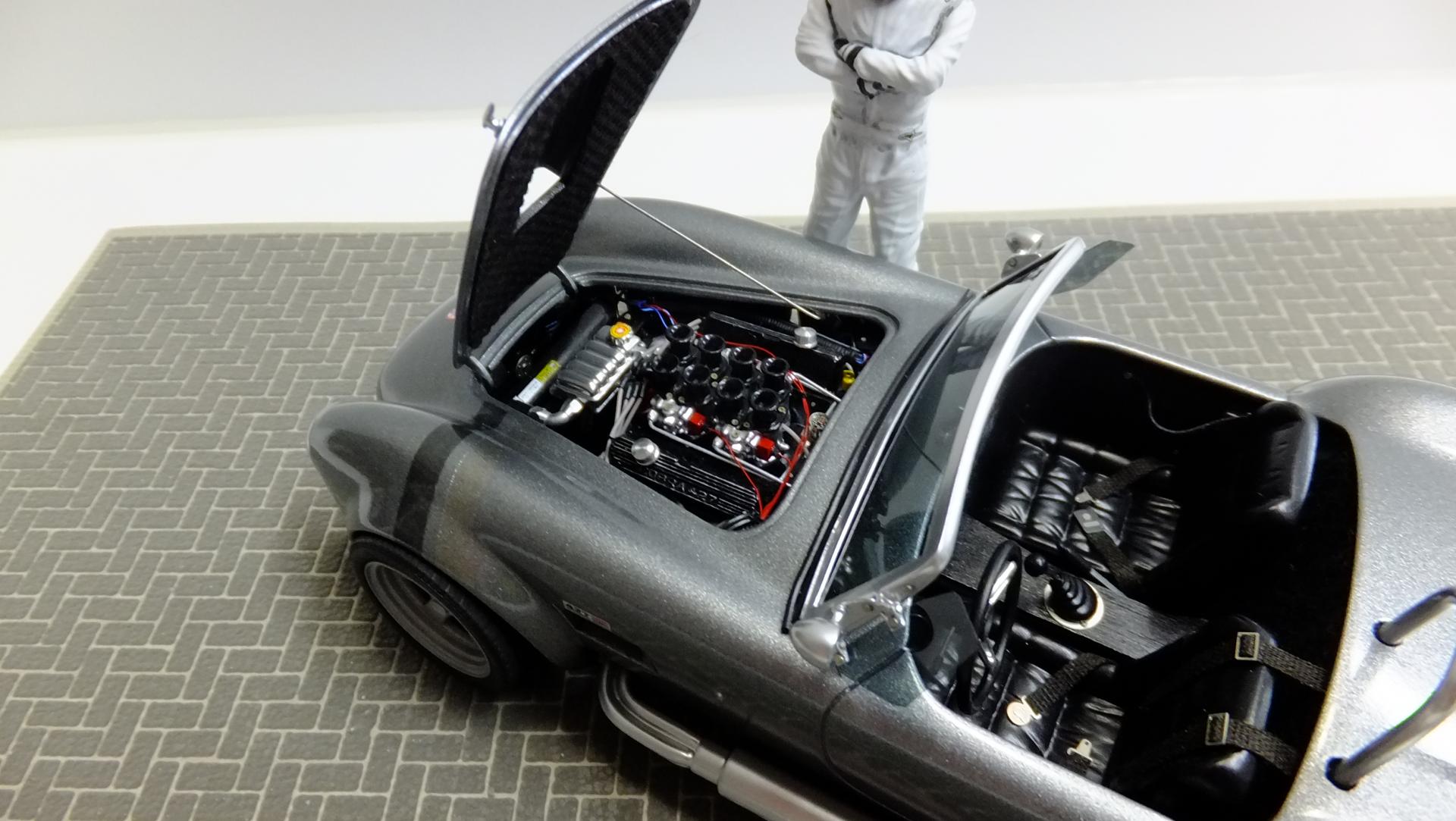

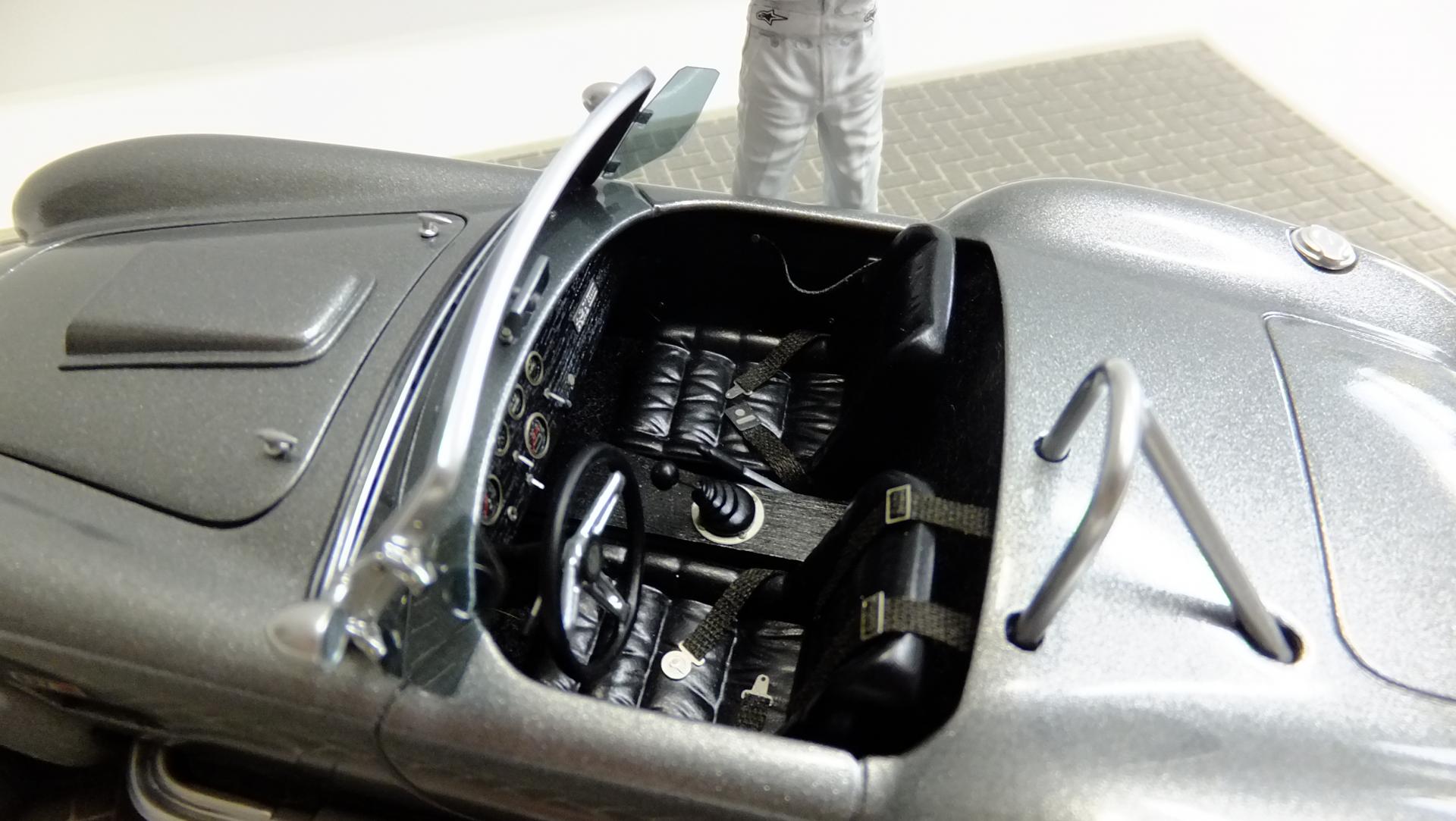

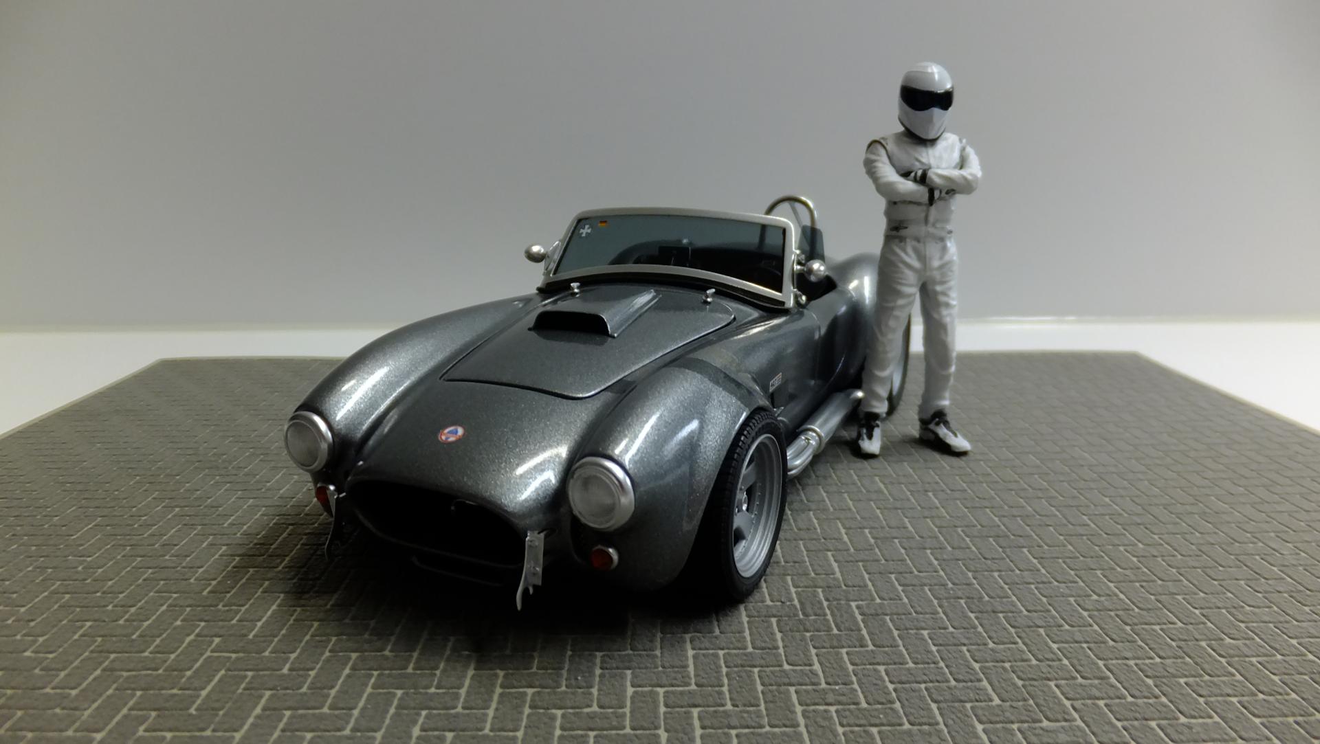

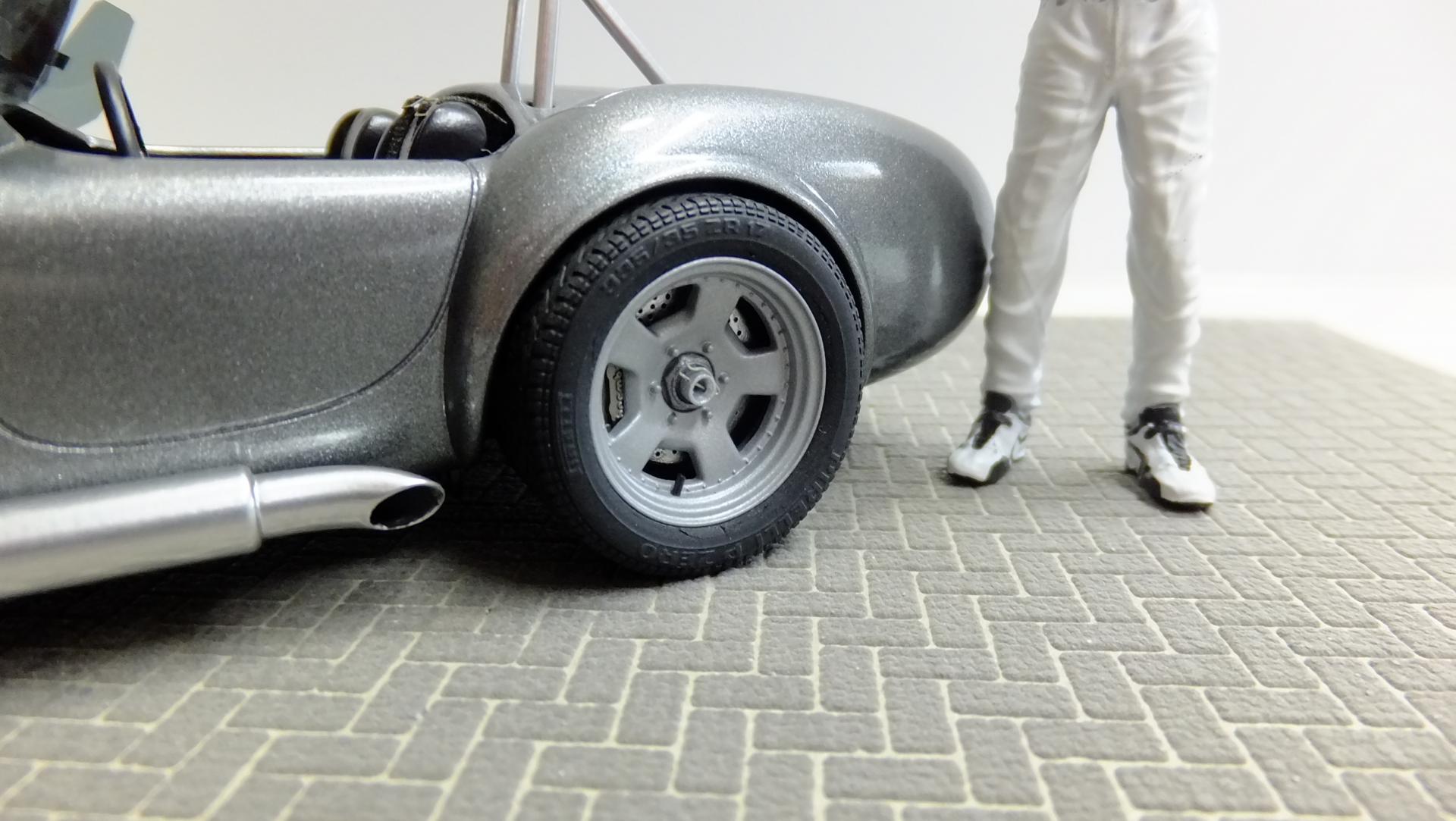

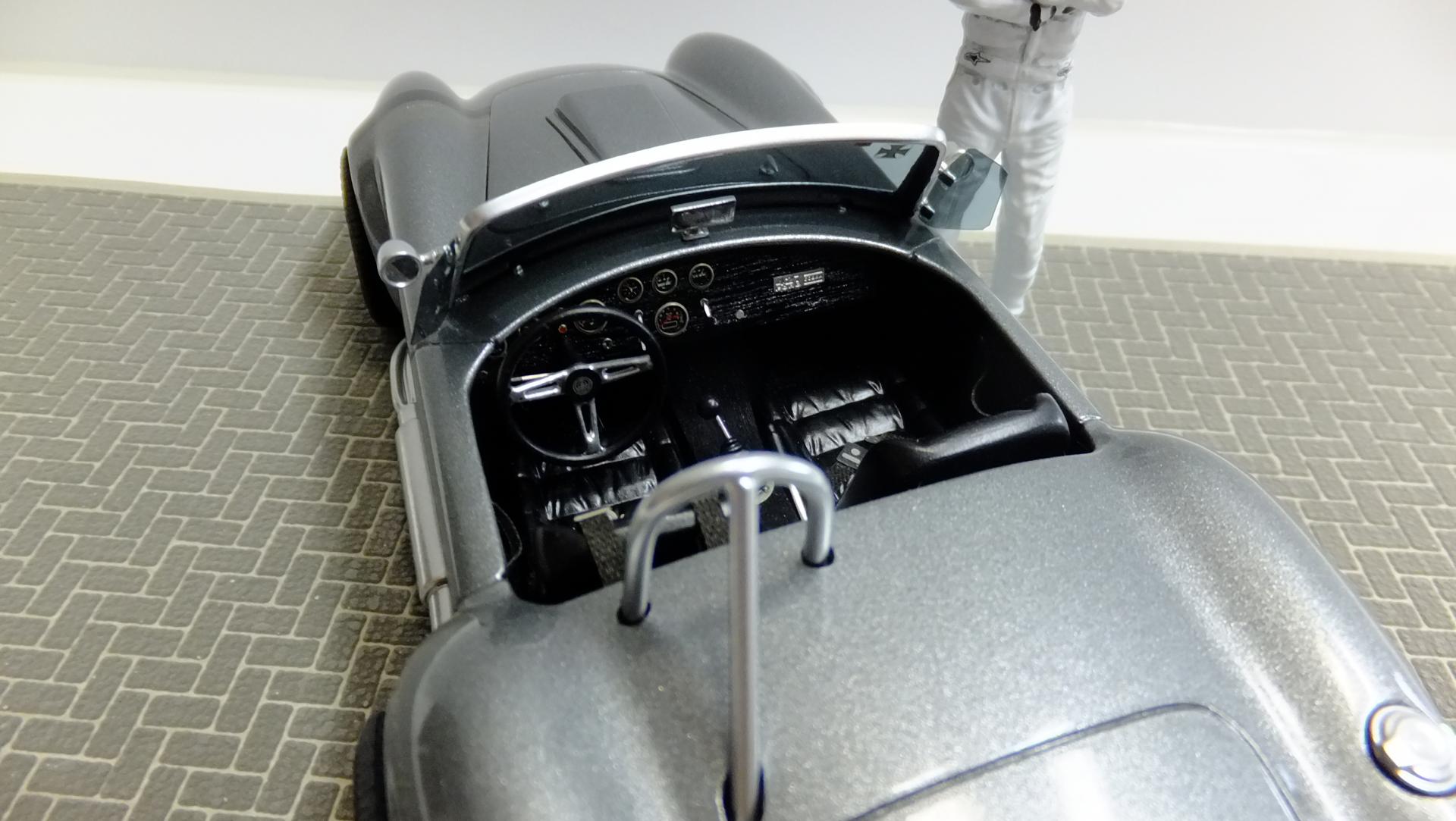

Dann Tier Posted August 15, 2018 Share Posted August 15, 2018 This is my fully detailed, customized Revell Cobra 427. There is so much that I did to this, so heres a few things; I replaced the hood scoop for a Fujimi one, I made the windscreen frame from aluminum, and SB the mirror Brackets. The side pipes are made from aluminum tubing, and the jack-points are photo-etch. The interior has real black lacquered wood, and the seats are modified Lotus Esprit seats. I put Pirrelli PZero tyres from a Tamiya Ferrari F40 kit, and the wheel centers have real cotter-pins in the spindles. Quote Link to comment Share on other sites More sharing options...
matthijsgrit Posted August 15, 2018 Share Posted August 15, 2018 Nice build! Amazing detail in those seats... Quote Link to comment Share on other sites More sharing options...
afx Posted August 15, 2018 Share Posted August 15, 2018 Another one with very nice engine detail as well as the dash. What wheels did you use Dann? Quote Link to comment Share on other sites More sharing options...
PARTSMARTY Posted August 15, 2018 Share Posted August 15, 2018 The car looks great and interior is awesome !!! Quote Link to comment Share on other sites More sharing options...
jchrisf Posted August 15, 2018 Share Posted August 15, 2018 Nice Dann! What is your secret to the seats again? I can't remember, do you spray Duplicolor from the can on the body? What clear coat? Just amazing work as always! Quote Link to comment Share on other sites More sharing options...
DeeCee Posted August 15, 2018 Share Posted August 15, 2018 SUPERB build Dann, great paint and detailing is top end mate. Quote Link to comment Share on other sites More sharing options...
Scalper Posted August 15, 2018 Share Posted August 15, 2018 man that is slick. smooth paint clean work . I like Quote Link to comment Share on other sites More sharing options...
ChrisR Posted August 15, 2018 Share Posted August 15, 2018 Awesome! Quote Link to comment Share on other sites More sharing options...
crazyjim Posted August 15, 2018 Share Posted August 15, 2018 Pretty slick build. Quote Link to comment Share on other sites More sharing options...
Gramps46 Posted August 15, 2018 Share Posted August 15, 2018 Another outstanding build. I am with you on the windshield frame, one of the biggest distractions on most of the Cobra kits, and diecasts too. Quote Link to comment Share on other sites More sharing options...

Dann Tier Posted August 15, 2018 Author Share Posted August 15, 2018 3 hours ago, jchrisf said: Nice Dann! What is your secret to the seats again? I can't remember, do you spray Duplicolor from the can on the body? What clear coat? Just amazing work as always! Thank you again, Chris!, the seats come from A Monogram Lotus Esprit kit with the headrests chopped off, and I spray Duplicolor right from the can!.....I used their clear on this Cobra, and I NEVER polish my bodies. Quote Link to comment Share on other sites More sharing options...

Dann Tier Posted August 15, 2018 Author Share Posted August 15, 2018 1 hour ago, Gramps46 said: Another outstanding build. I am with you on the windshield frame, one of the biggest distractions on most of the Cobra kits, and diecasts too. Thanks, Gary!....ya, and there is almost NOTHING to confidently glue your windscreen to... Quote Link to comment Share on other sites More sharing options...
Dann Tier Posted August 15, 2018 Author Share Posted August 15, 2018 4 hours ago, afx said: Another one with very nice engine detail as well as the dash. What wheels did you use Dann? Thanks, JC!, You, and everybody else might cringe, but this is where I got the wheels from...... Quote Link to comment Share on other sites More sharing options...

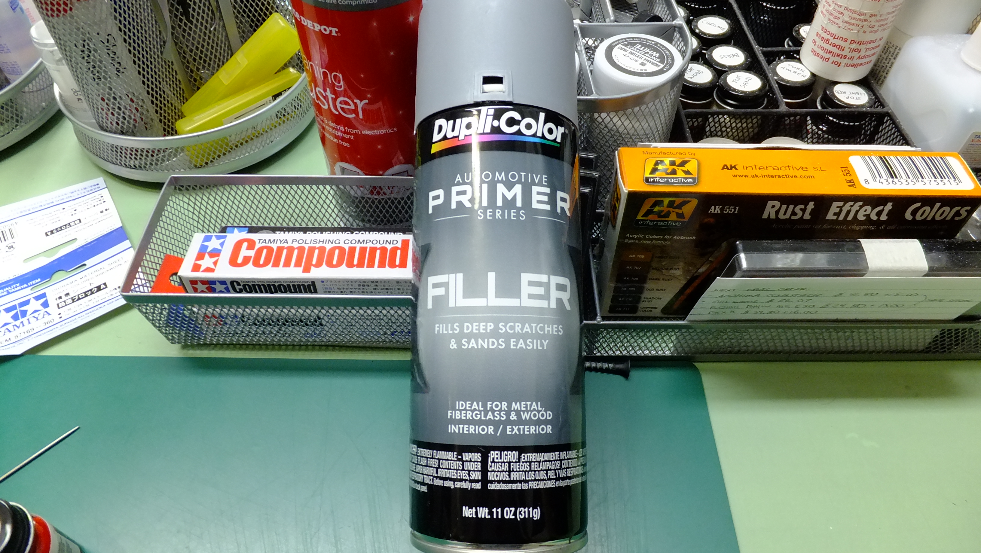

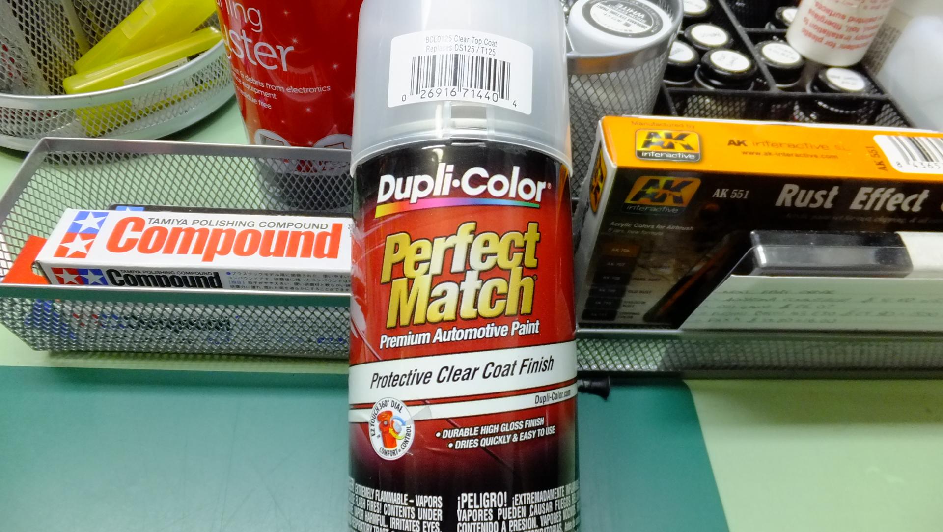

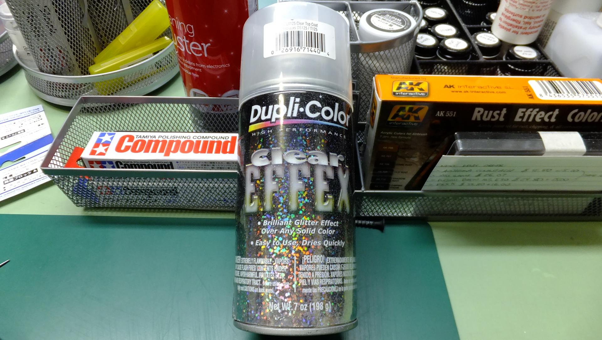

jchrisf Posted August 15, 2018 Share Posted August 15, 2018 42 minutes ago, Dann Tier said: Thank you again, Chris!, the seats come from A Monogram Lotus Esprit kit with the headrests chopped off, and I spray Duplicolor right from the can!.....I used their clear on this Cobra, and I NEVER polish my bodies. Ok.. so the same seats again.. cool. Which Duplicolor clear do you use? They carry three different Duplicolor clears at my parts store. I always manage to get crazing when I use Duplicolor's sandable primer and you don't even have to polish.. I'm doing something wrong. Quote Link to comment Share on other sites More sharing options...
Dann Tier Posted August 15, 2018 Author Share Posted August 15, 2018 2 hours ago, jchrisf said: Ok.. so the same seats again.. cool. Which Duplicolor clear do you use? They carry three different Duplicolor clears at my parts store. I always manage to get crazing when I use Duplicolor's sandable primer and you don't even have to polish.. I'm doing something wrong. Hey, Chris!, here is the clearcoat I use, another awesome clear that has Super fine Rainbow flakes in it, and the primer I start with. You cannot use any other Duplicolor paint, or primer until you put down an opaque coverage of the Filler primer first!....it will kraze every time!! Heres how I paint my bodies; I shoot 1 opaque coat( 2-3 light coats ), sand with 2000 grit, 1 more light coat of filler primer, and either shoot one of the other Duplicolor primers, or start laying-down your color. for me, its almost always; 4 filler coats, 4 kolor, and 4 clear coats......sanding with 2000 grit between every coat after the opaque coat. What you get with this system, is a properly scaled-down gloss. You probably wont win any paint finish awards, since judges like STUPIDLY out 0f scale finishes, but all of my builds have won awards. Quote Link to comment Share on other sites More sharing options...

jchrisf Posted August 15, 2018 Share Posted August 15, 2018 2 hours ago, Dann Tier said: Hey, Chris!, here is the clearcoat I use, another awesome clear that has Super fine Rainbow flakes in it, and the primer I start with. You cannot use any other Duplicolor paint, or primer until you put down an opaque coverage of the Filler primer first!....it will kraze every time!! Heres how I paint my bodies; I shoot 1 opaque coat( 2-3 light coats ), sand with 2000 grit, 1 more light coat of filler primer, and either shoot one of the other Duplicolor primers, or start laying-down your color. for me, its almost always; 4 filler coats, 4 kolor, and 4 clear coats......sanding with 2000 grit between every coat after the opaque coat. What you get with this system, is a properly scaled-down gloss. You probably wont win any paint finish awards, since judges like STUPIDLY out 0f scale finishes, but all of my builds have won awards. Thanks Dann.. I'd have never figured this out without you telling me.. I am going out tomorrow and get some of the clear and Filler Primer! Quote Link to comment Share on other sites More sharing options...
