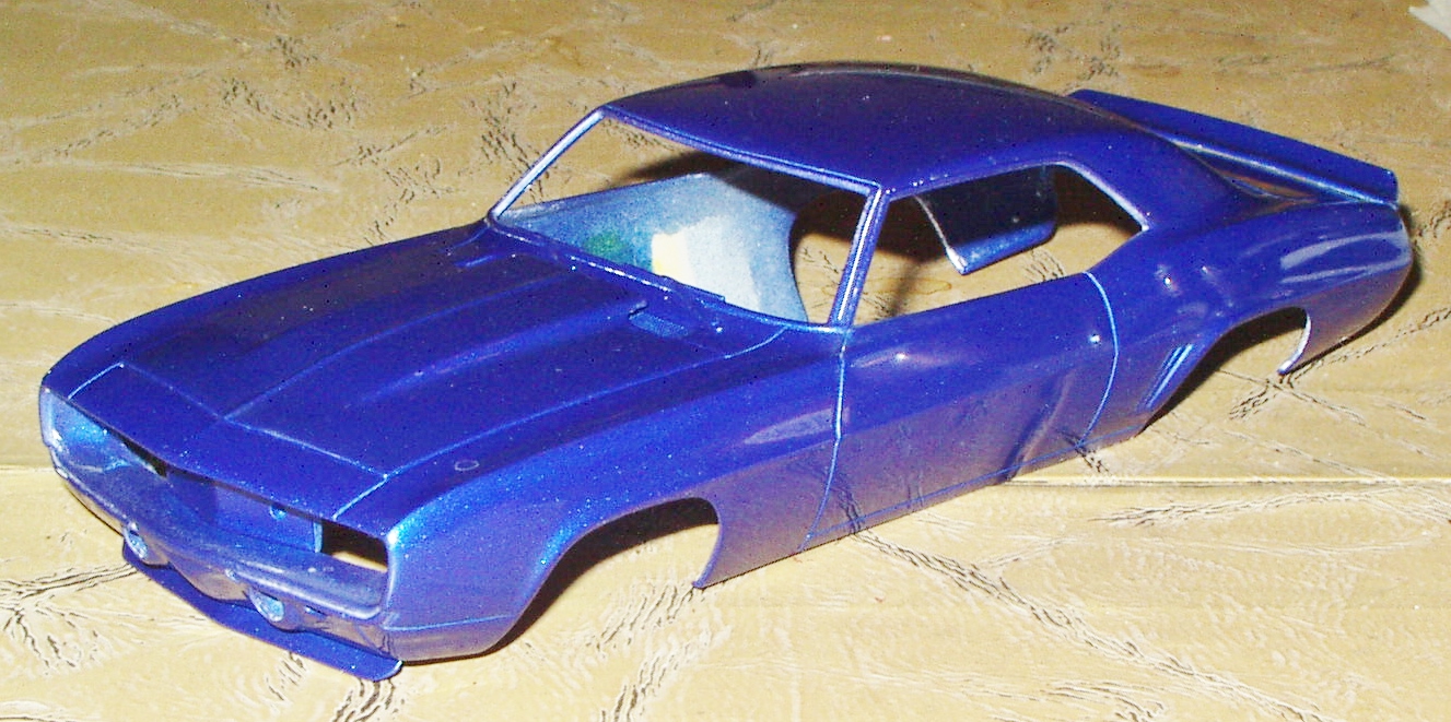

Snake45 Posted October 25, 2018 Posted October 25, 2018 Speaking of "blushing," may I present The Paint Job from Hell: This was supposed to be a quick, easy paint job on a Revell '69 Camaro snapper, so I chose Testor One Coat Star Spangled Blue lacquer. I've had pretty good luck with these paints, some of them required no polishing at all for an acceptable result. Not this time, though. The torture proceeded as follows: One coat Walmart Color Place gray primer. Some sanding and fixing in small areas. 2nd coat of Walmart gray primer; some sanding (#800 wet) in some areas. First coat of One Coat Star Spangled Blue, almost wet. Some orange peel. 24 hours later, 2nd coat of SS Blue, wet. Full coverage but dried with notable orange peel. In all fairness, this can was at least 6 years old and didn't seem to be putting out full pressure (hadn't been used before). First coat of Wet Look Clear, from a can at least 5 years old. Some blushing and orange peel. 2nd coat of WLC, from a second can, "only" about 4 years old. More blushing and orange peel. There might have been a 3rd coat, I don't remember, but things weren't getting any better. At this point I decided to procure a new can of WLC. Before shooting the new WLC, I gave the whole model a "rough" polish with Wright's Silver Cream, just enough to remove the present blushing. Didn't worry about smoothness. One coat of new WLC. Blushing and orange peel. 2nd, wet coat of WLC 24 hours later. After drying for 48 hours, there was still considerable blushing. Due to the wetness/thickness of the final WLC coat, orange peel was somewhat reduced. Wet sanded with #1000 grit to remove all orange peel and reduce the surface to smoothness.This removed most the blushing from all the previous WLC. Wet sanded again with #2000 grit to remove sanding scratches from the #1000 and give the surface a uniform, even, polishable sheen. Polished with Wright's Silver Cream. Final polish with Wright's Silver Cream on a damp cloth, which reduces its grit. So it doesn't look half bad. It's shiny and smooth, with no blushing, and looks thinner than the 8 coats of paint on it. It'll do. Pic taken after washing with warm water and soft toothbrush. Please ignore the water spots and Wright's still in the cracks; those will all come out in a second washing (or however many it takes).
Tom Geiger Posted October 25, 2018 Posted October 25, 2018 42 minutes ago, Snake45 said: First coat of One Coat Star Spangled Blue, almost wet. Some orange peel. 24 hours later, 2nd coat of SS Blue, wet. Full coverage but dried with notable orange peel. In all fairness, this can was at least 6 years old and didn't seem to be putting out full pressure (hadn't been used before). First coat of Wet Look Clear, from a can at least 5 years old. Some blushing and orange peel. Many years ago I trained myself to put the purchase date on each can. Comes in handy!
Snake45 Posted October 26, 2018 Posted October 26, 2018 4 hours ago, Tom Geiger said: Many years ago I trained myself to put the purchase date on each can. Comes in handy! I knew the cans were old and elected to try to use them anyway. Knowing the exact date wouldn't have helped me, nor changed the result.
