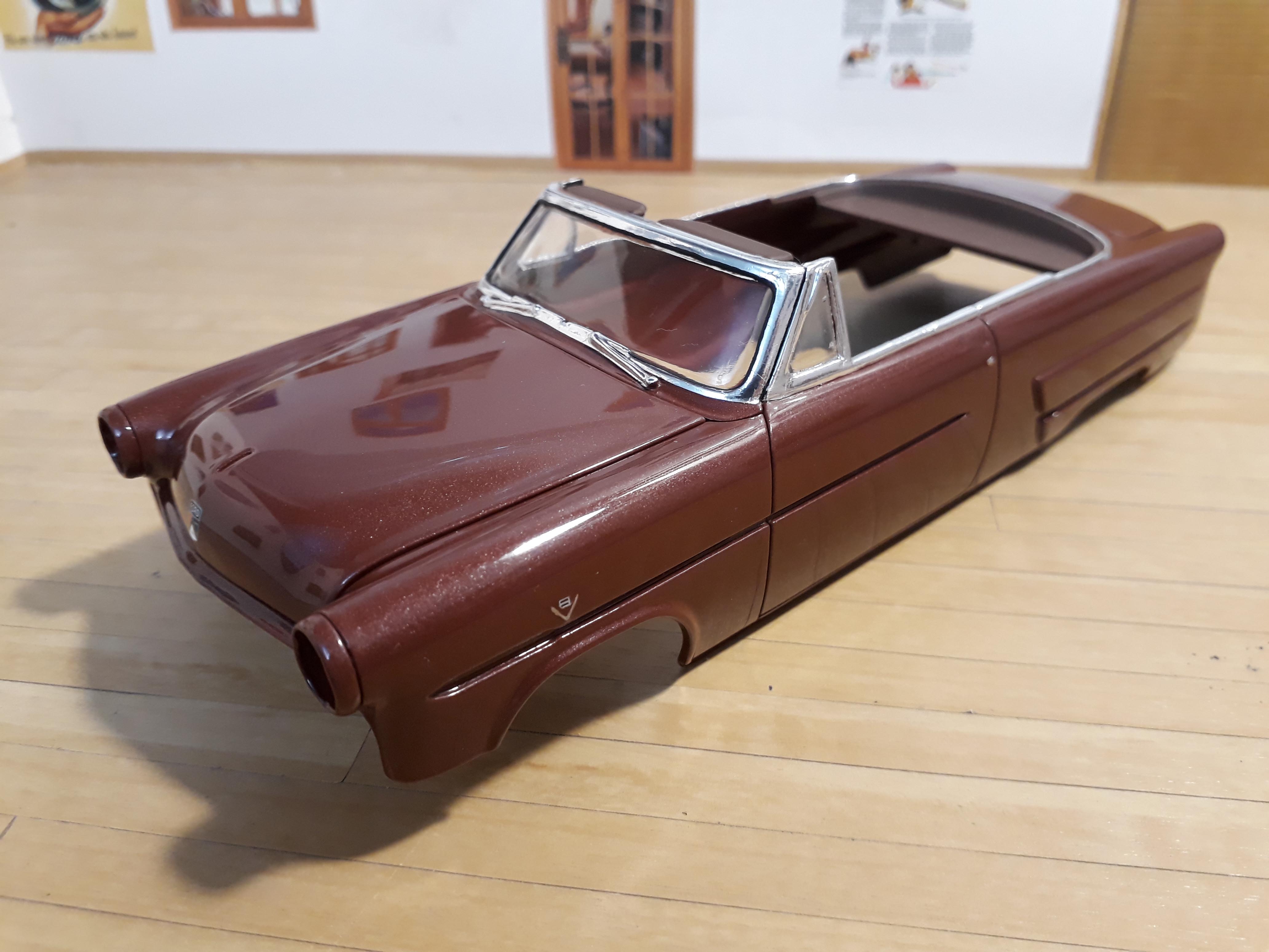

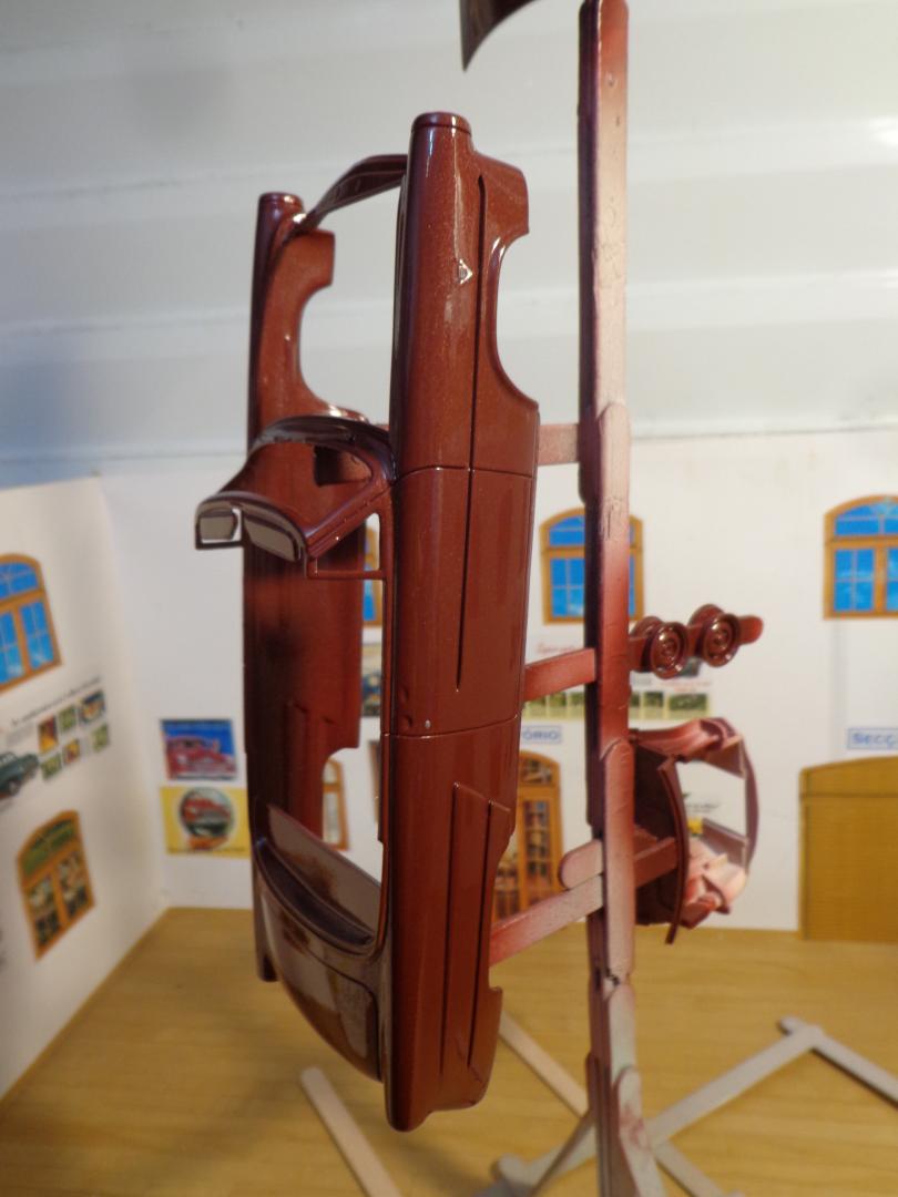

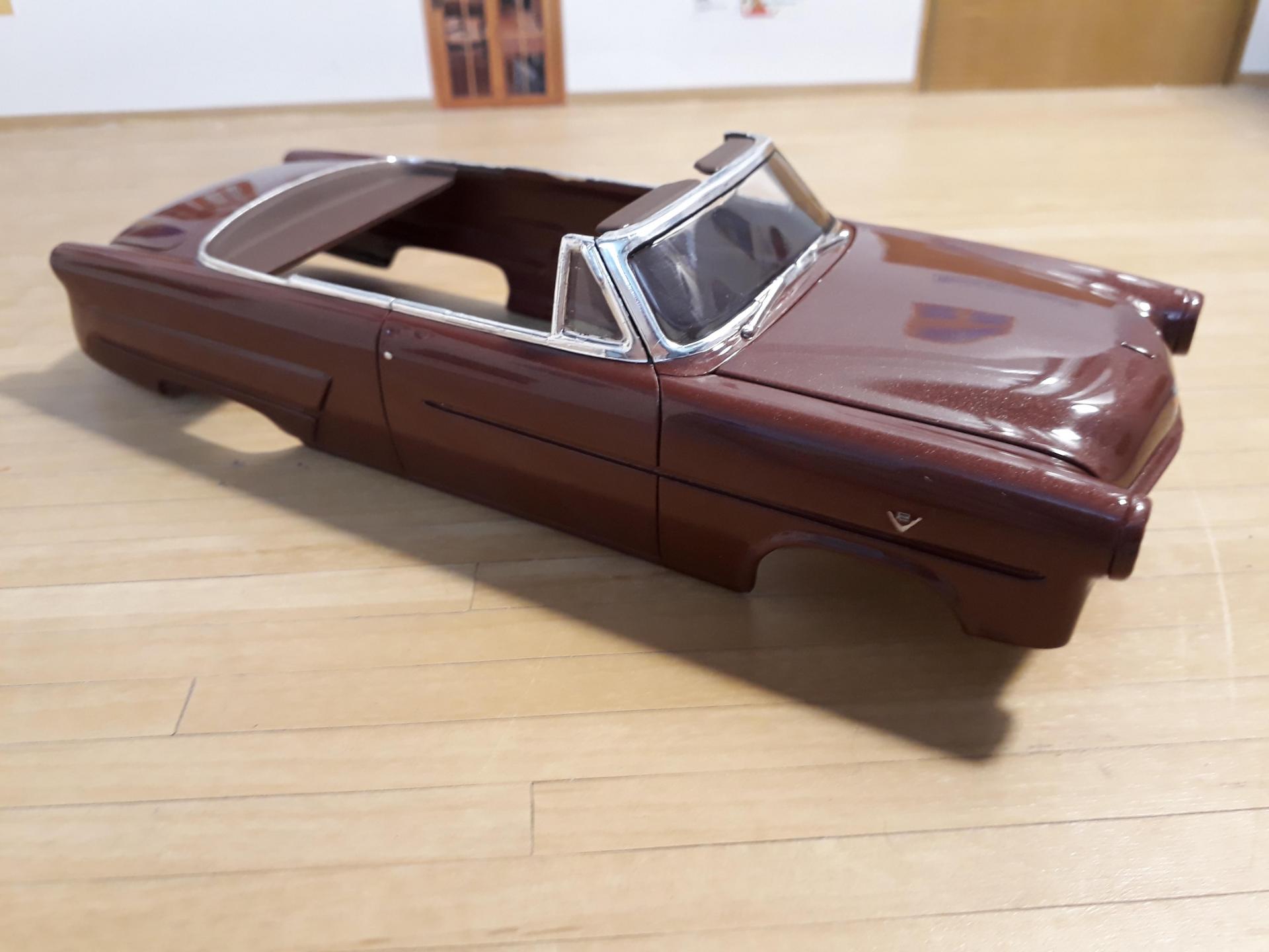

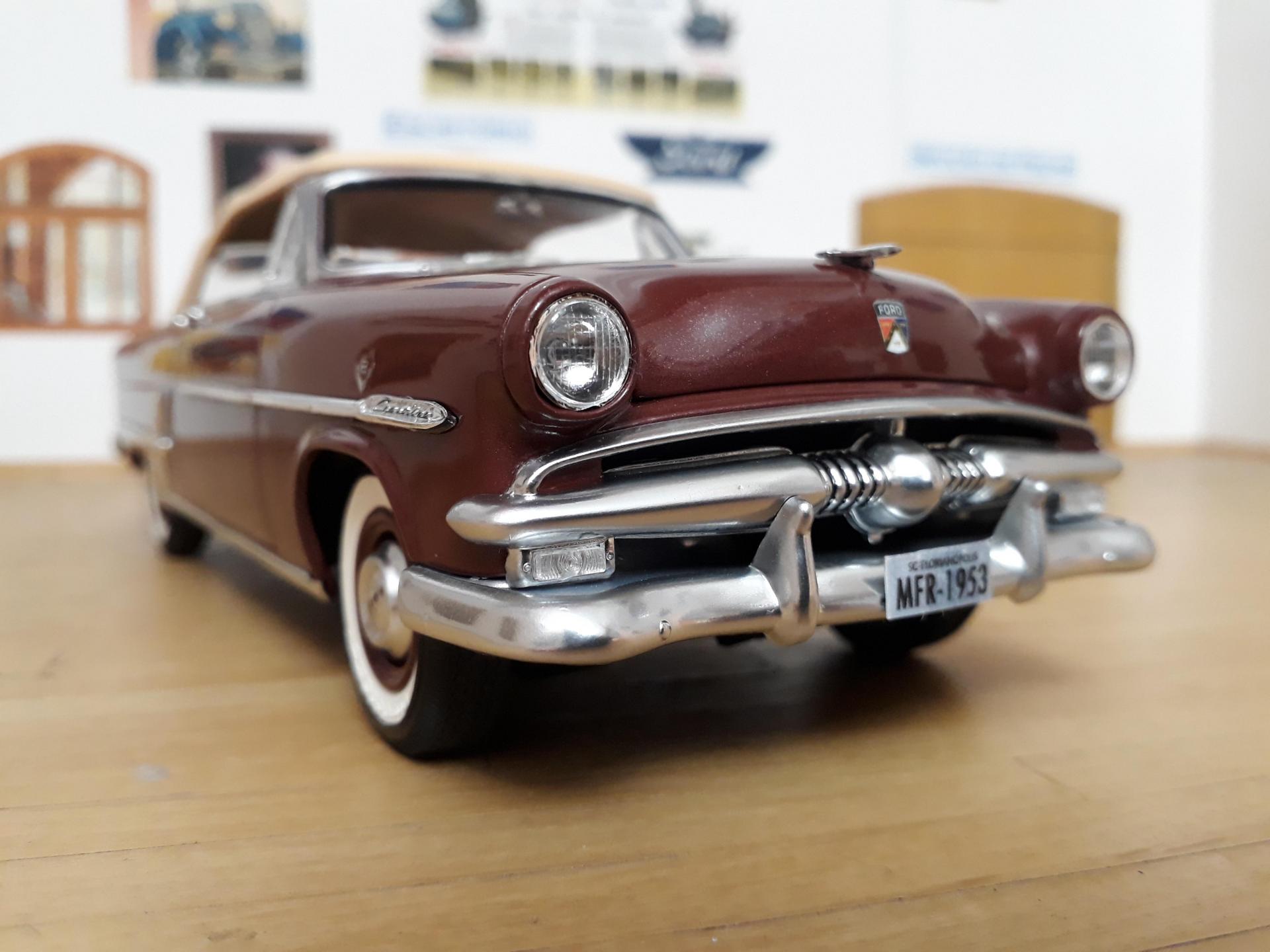

Started building this one (yes, another one of those) on Tuesday.
The only thing done is the body paint.
decided for Majestic Maroon metallic, a Lincoln color.
One could get a Ford like this, but the car had to be special ordered ($$$).

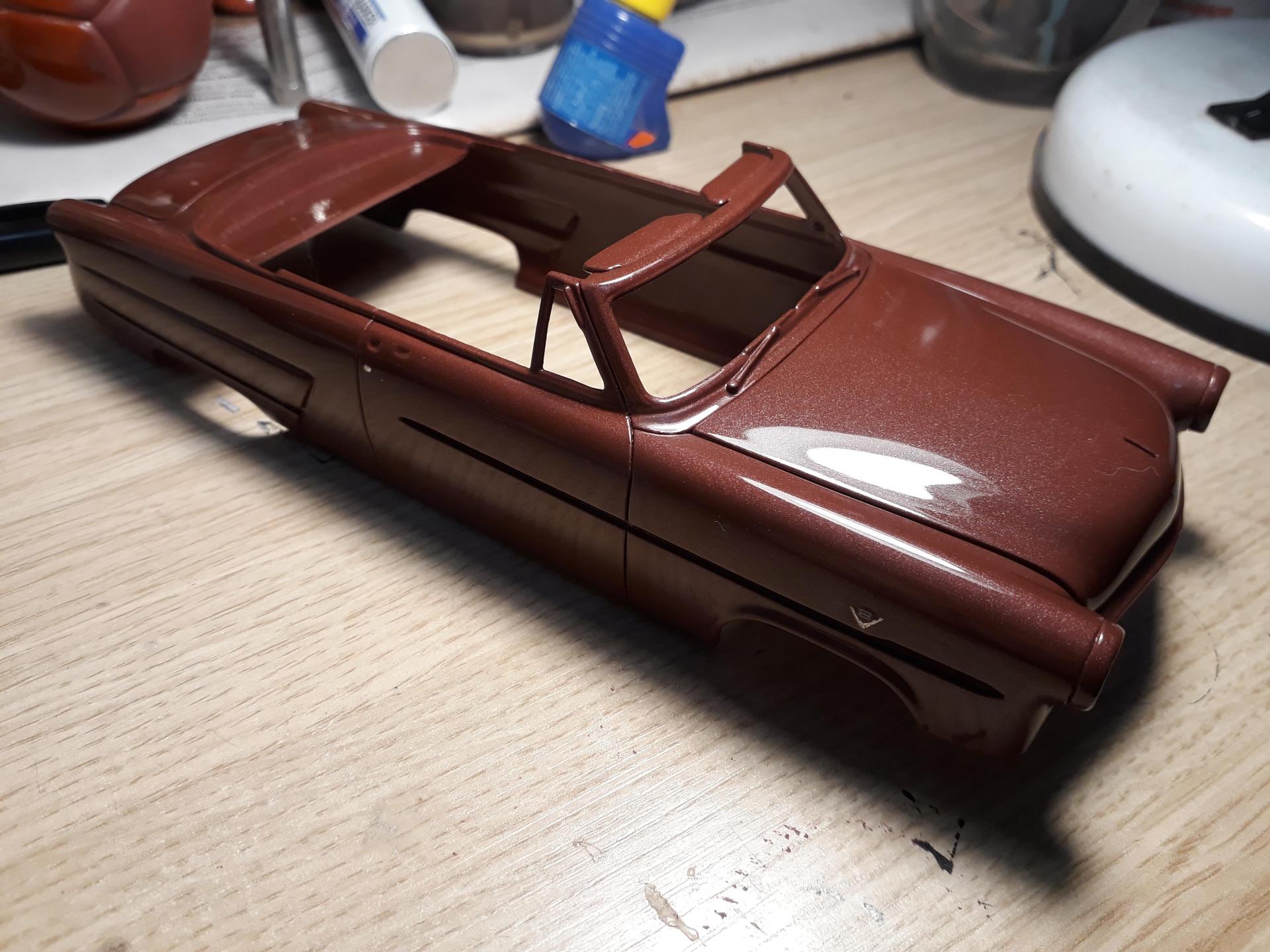

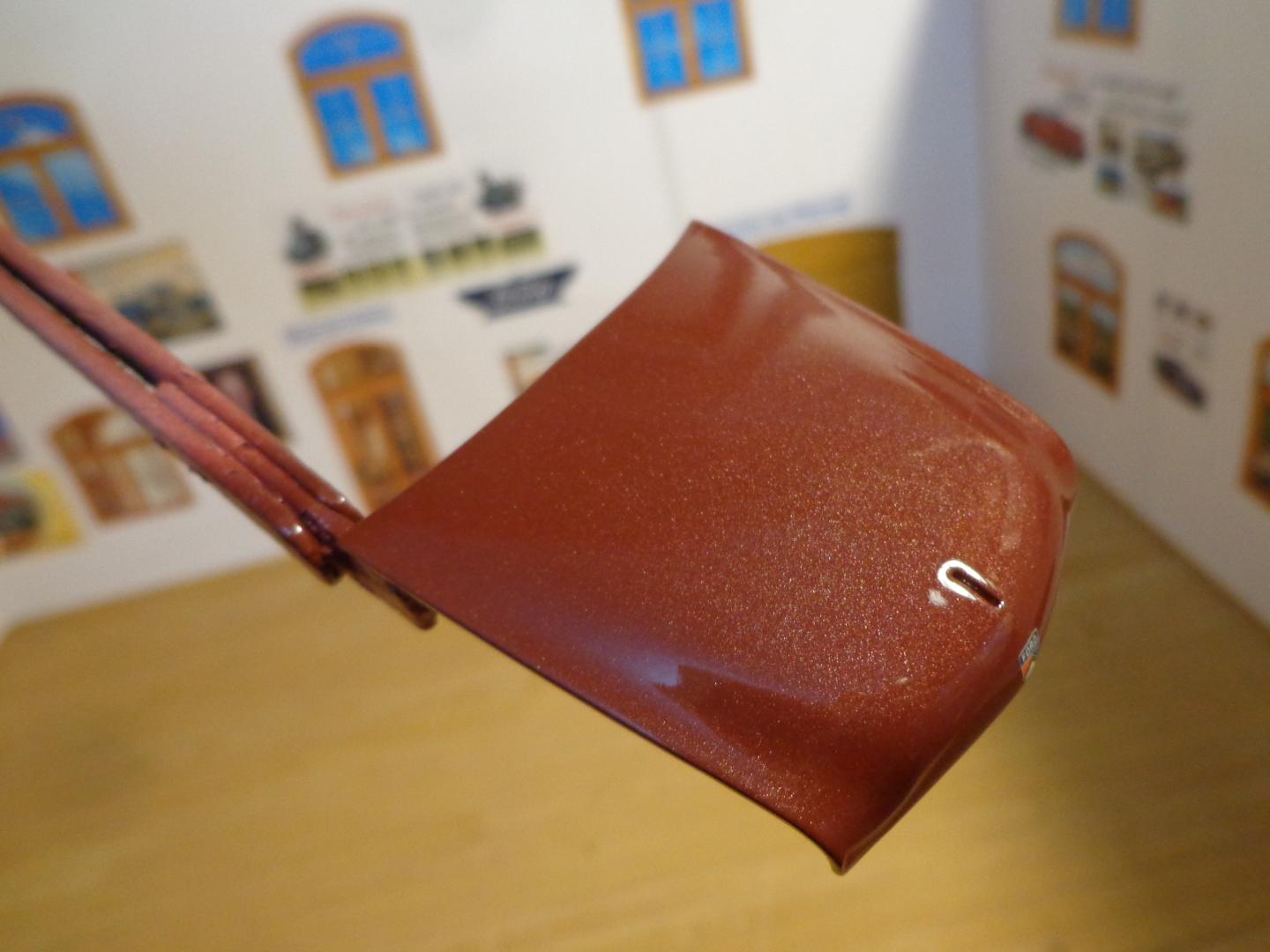

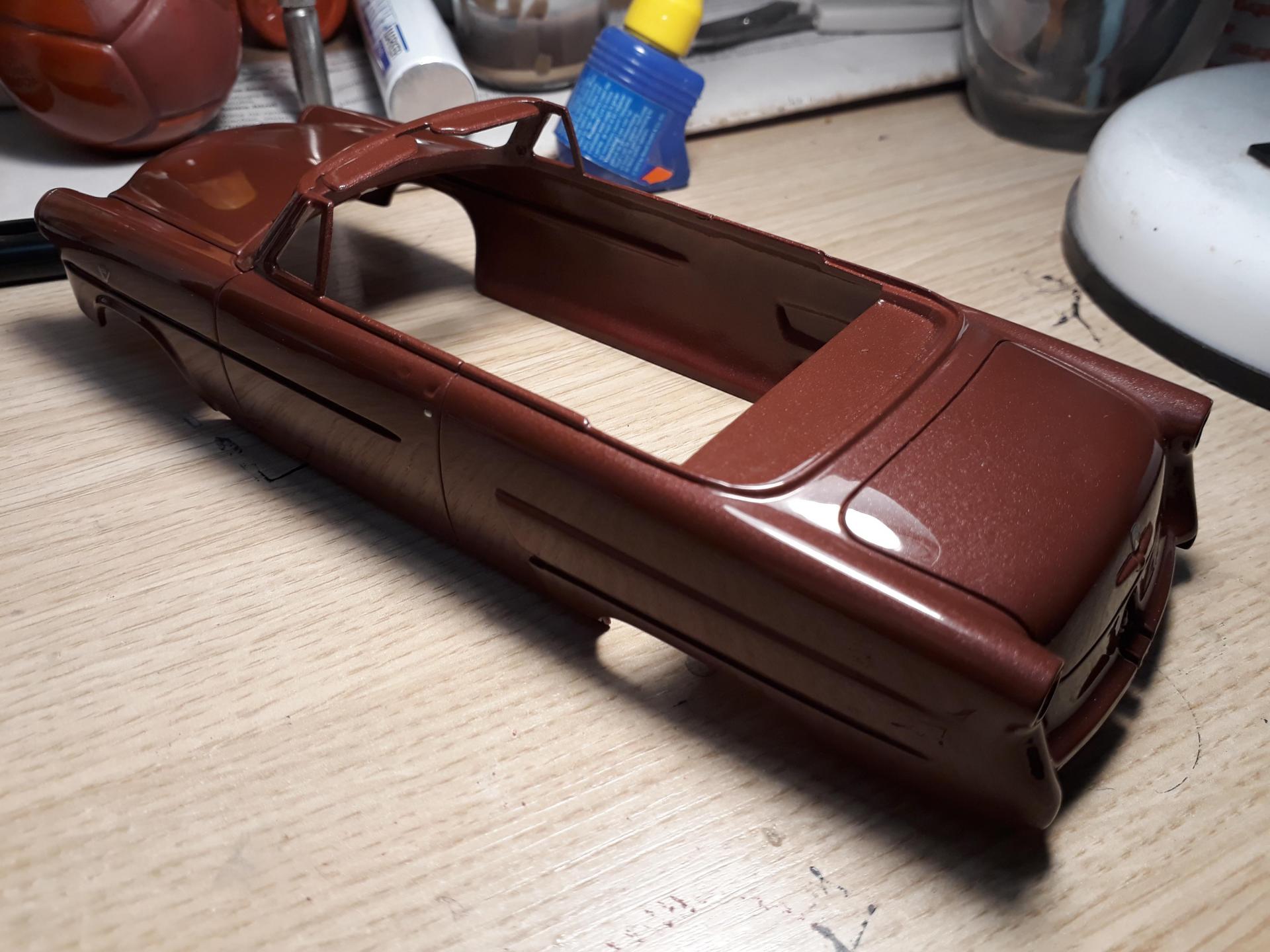

Had the color mixed with the original code, but as a base coat clear coat.
On the pictures I took today, the body was just clear coated.
Some polishing is going to be required.
Now to start working on the interior.
I'm divided between the brown/tan and gold option, and the red, white and black option.

That is a really great colour for a Sunliner- if they would have thrown some in the showrooms, it would have probably generated several special orders back then.
That will look really nice with the brown, tan & gold option.

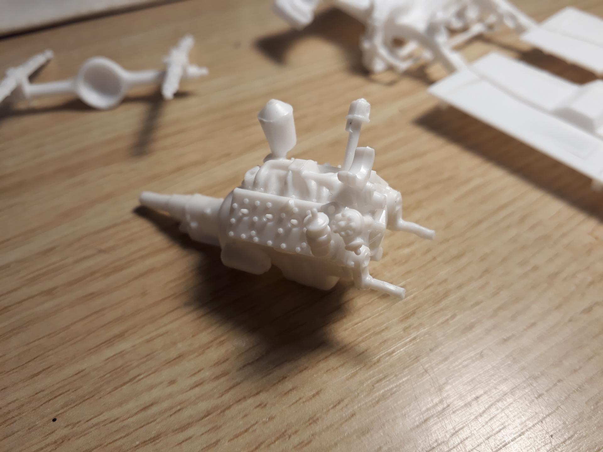

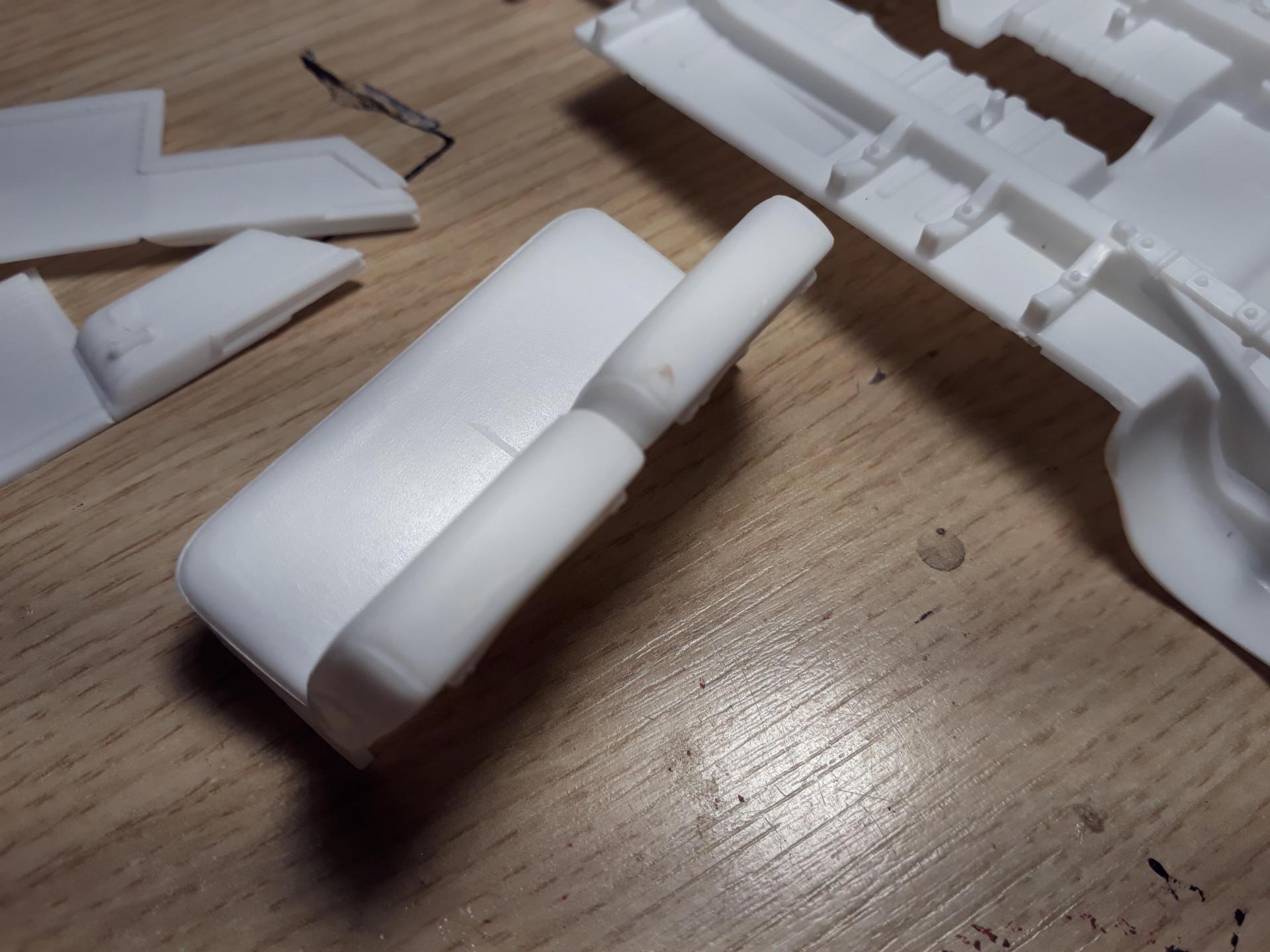

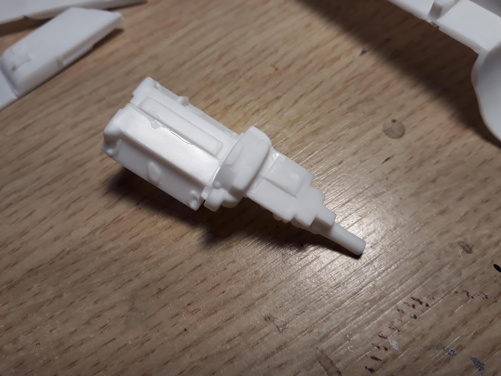

I just finished gluing the the front seat halves, and the engine halves together.
Those are the only glue joints that will show, and now it's a waiting game for the Revell glue to dry.
All going well, I guess the clear will be hard enough for me to polish the body tomorrow.
Using automotive two part clear, so the stuff gets real hard and difficult to polish if I wait too much.
So, here we are with some more work done.
Yesterday, I gave the body a good polish, and I'm happy with the paint. No wax yet tough. The foil will go on before the wax.

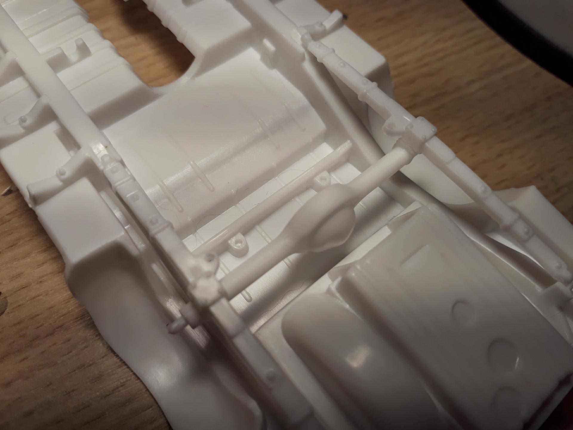

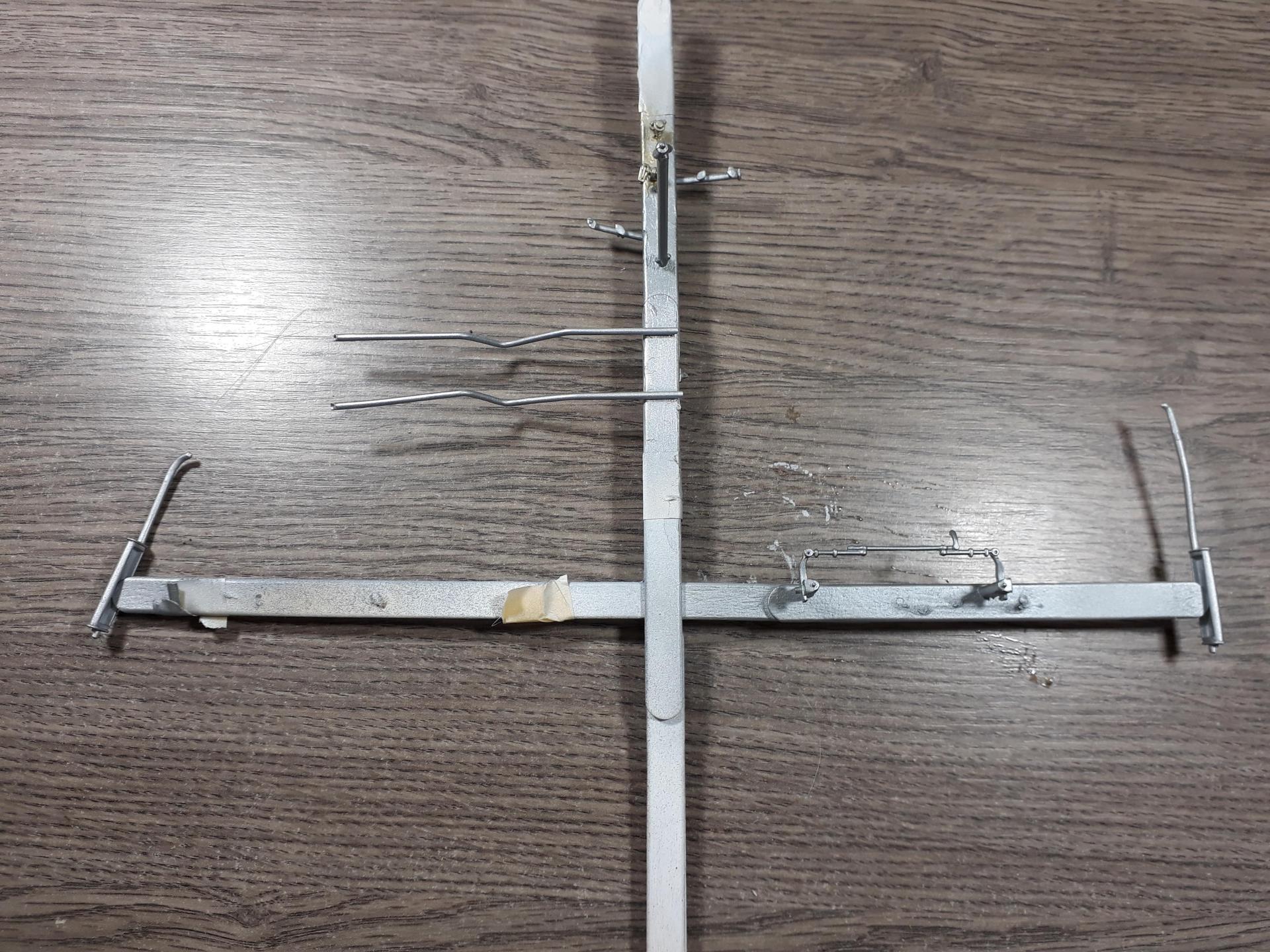

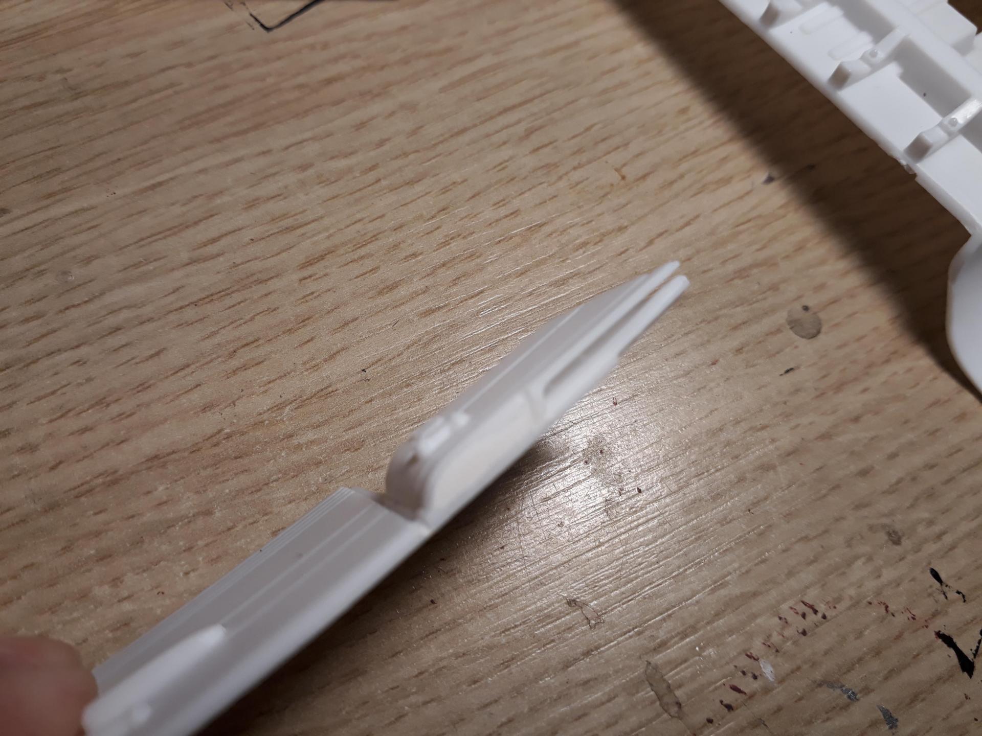

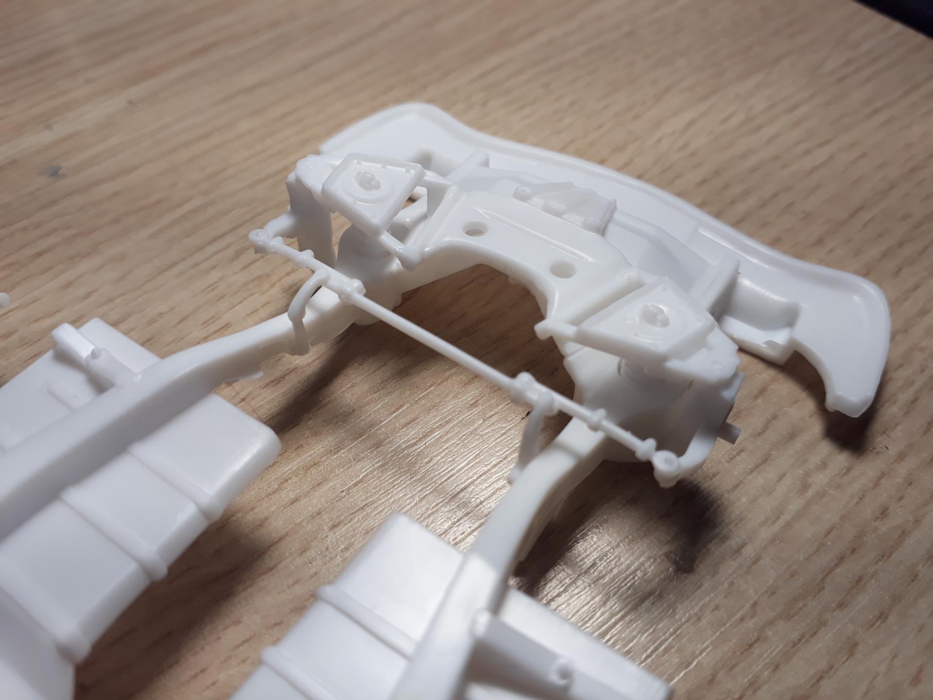

Also, started sanding away the glue joints on the front seat, on the engine, and blower motor. Also prepared the rear end sanding the mold lines, and gluing the leaf springs in place. The leaf springs have to be mounted in a way they will meet the mounts on the frame (springs converge to a imaginary point ahead of the car), and I'll still have to putty some sink marks on the top of the springs.

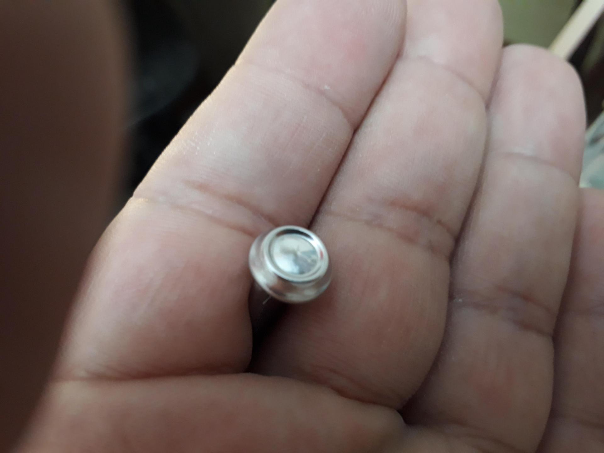

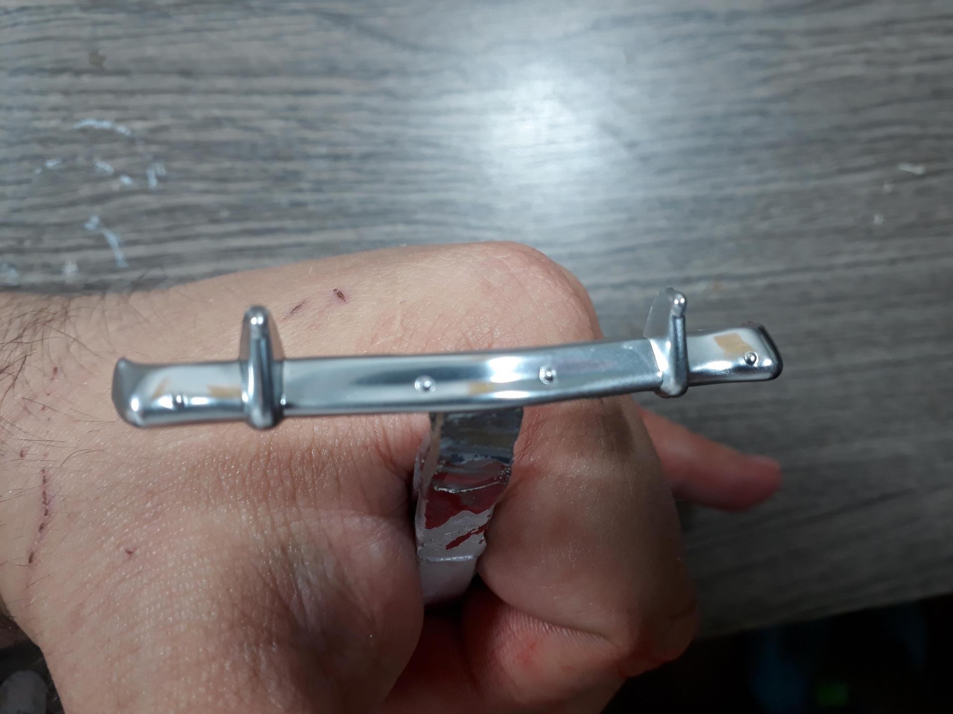

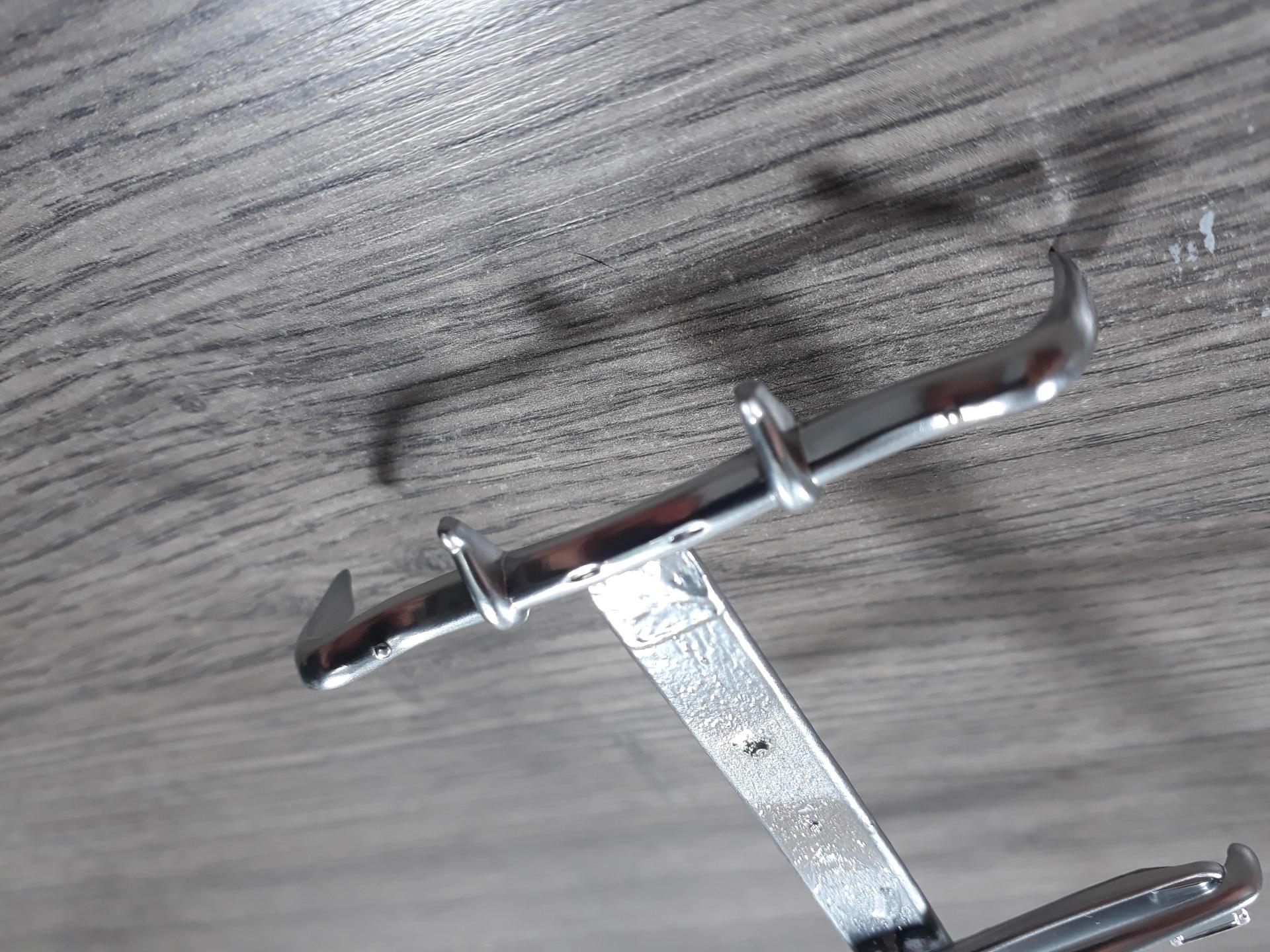

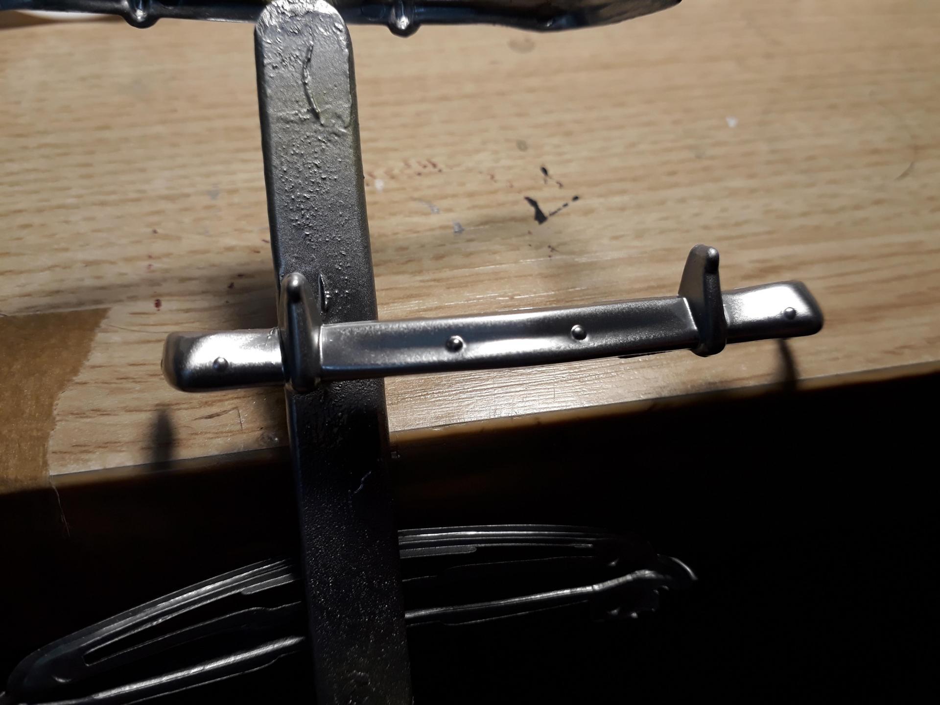

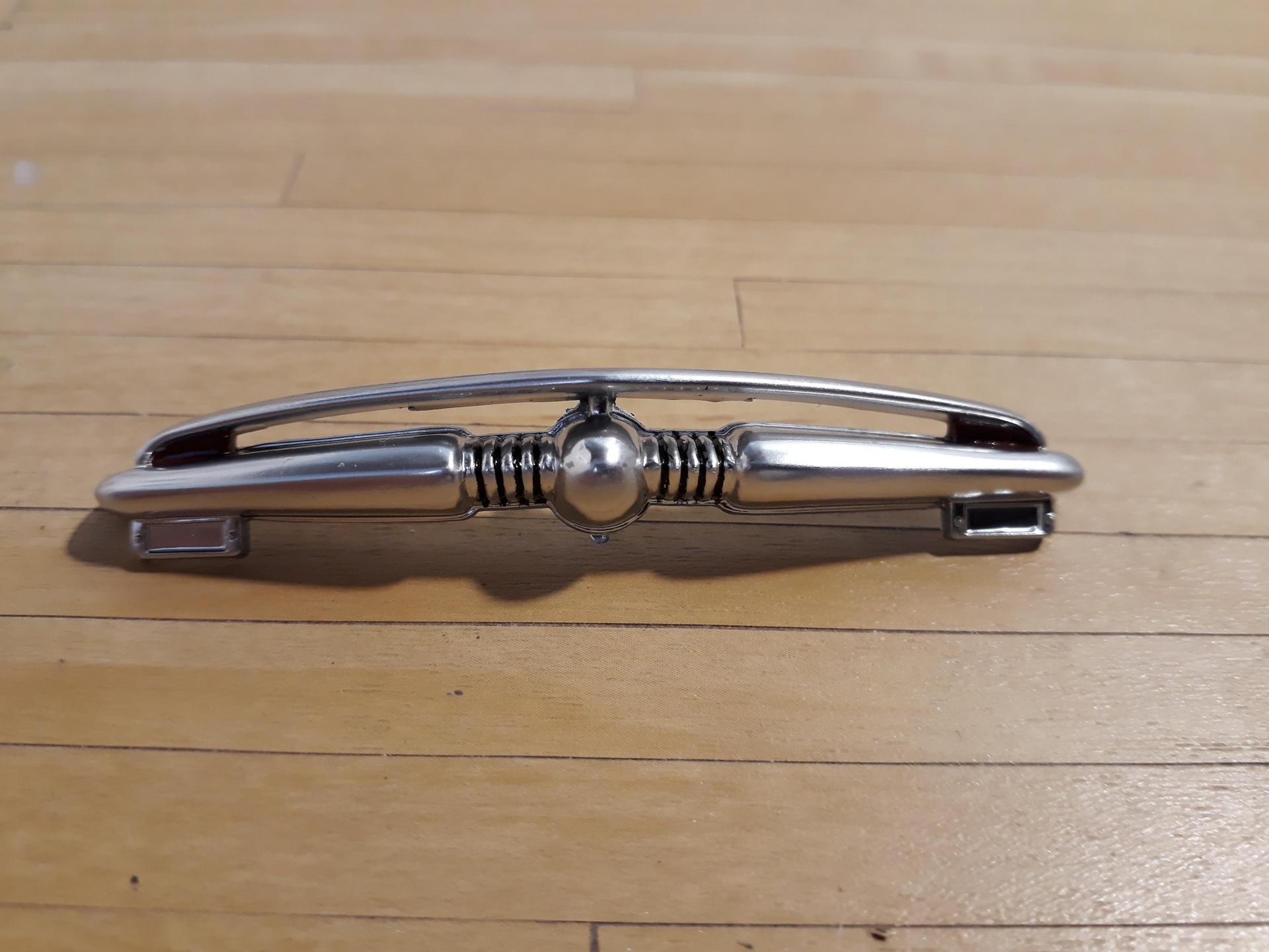

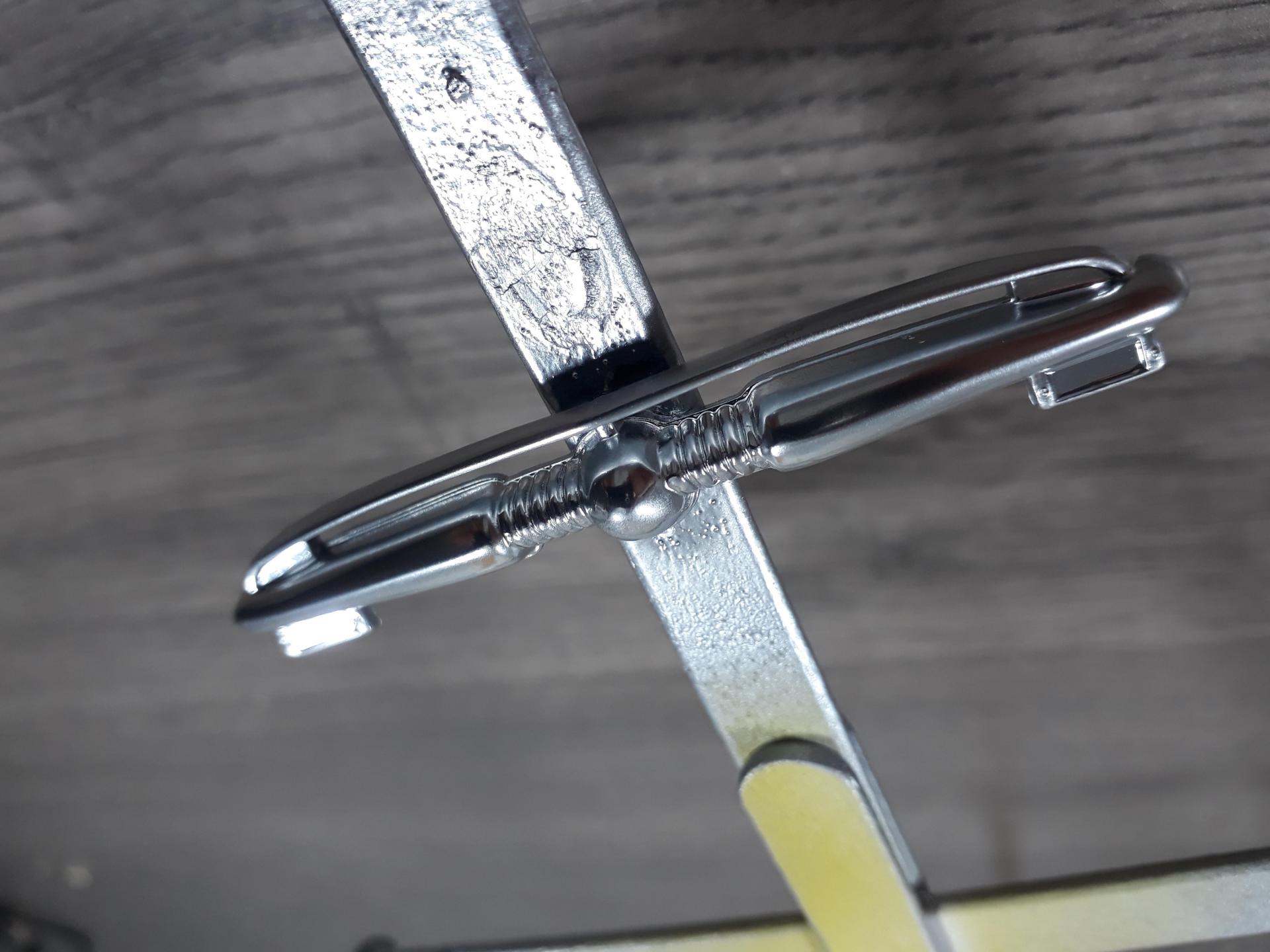

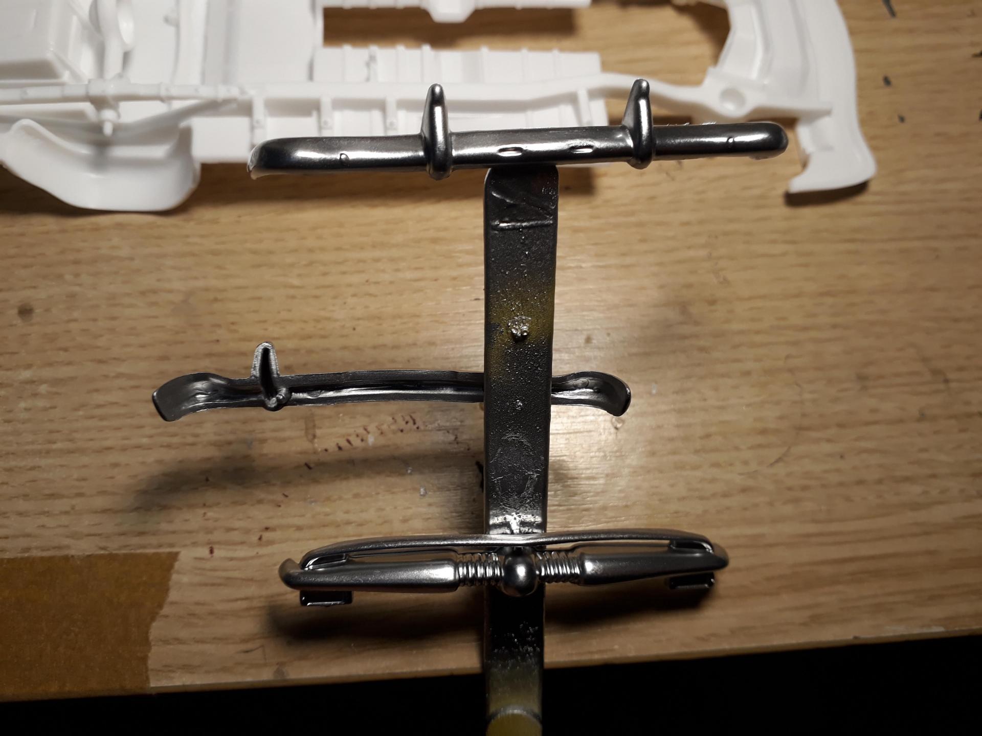

The bumpers had some ugly scratches on the chrome, so I stripped them, sanded the mold lines, and airbrushed some Molotow chrome on them, and also on the dog dish hubcaps. Also gave the chrome a clear coat to protect the fragile Molotow paint. Not 100% happy about the chrome tough.

The color, and of course the finish on it, are beautiful. Always enjoy watching your builds.

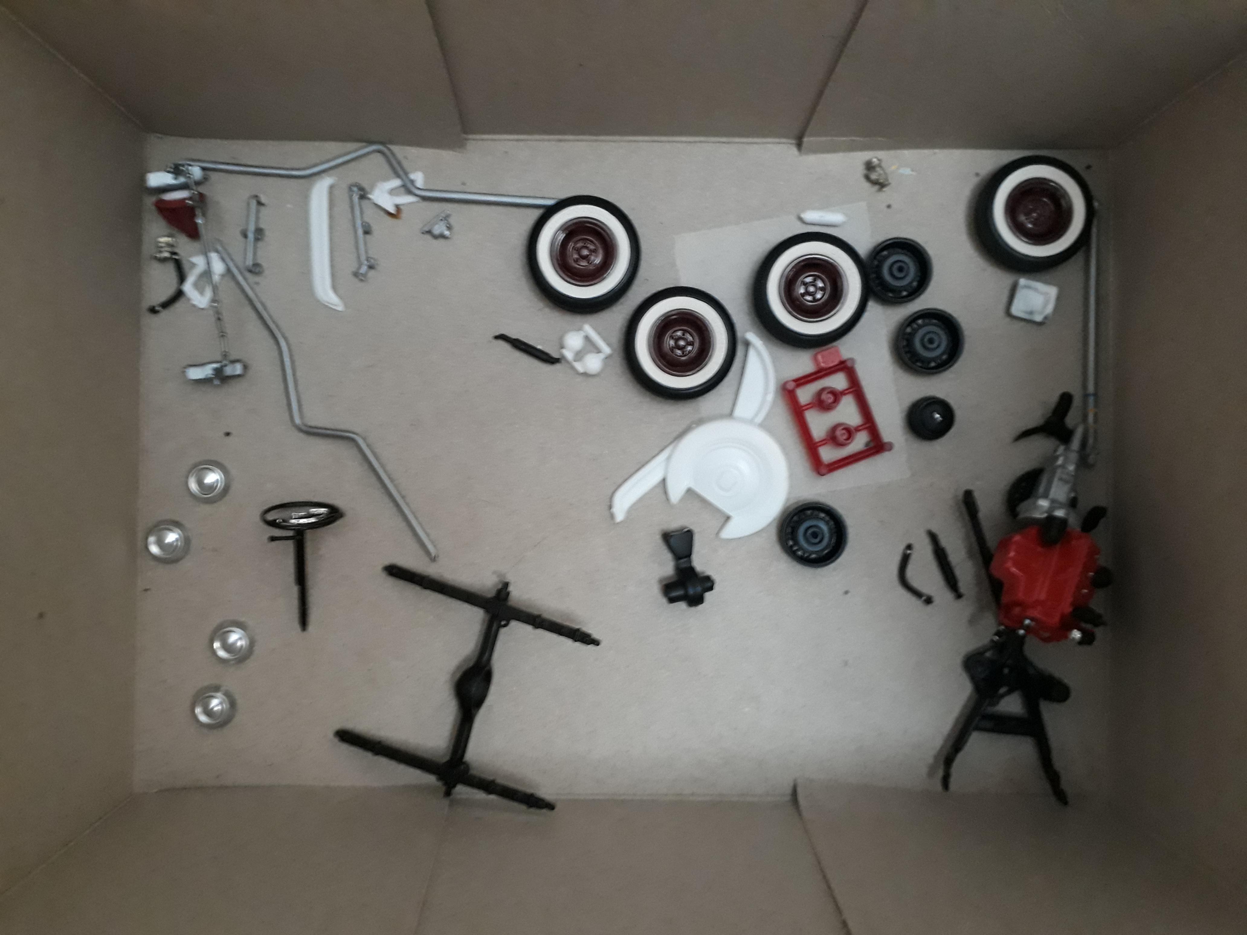

Did a little more to the car.
Built the front suspension, the engine, and fixed some sink marks on the leaf springs.

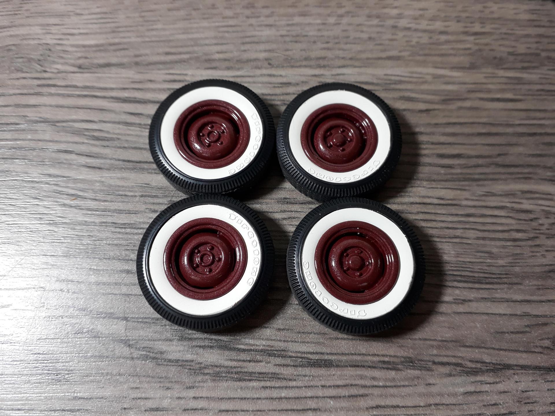

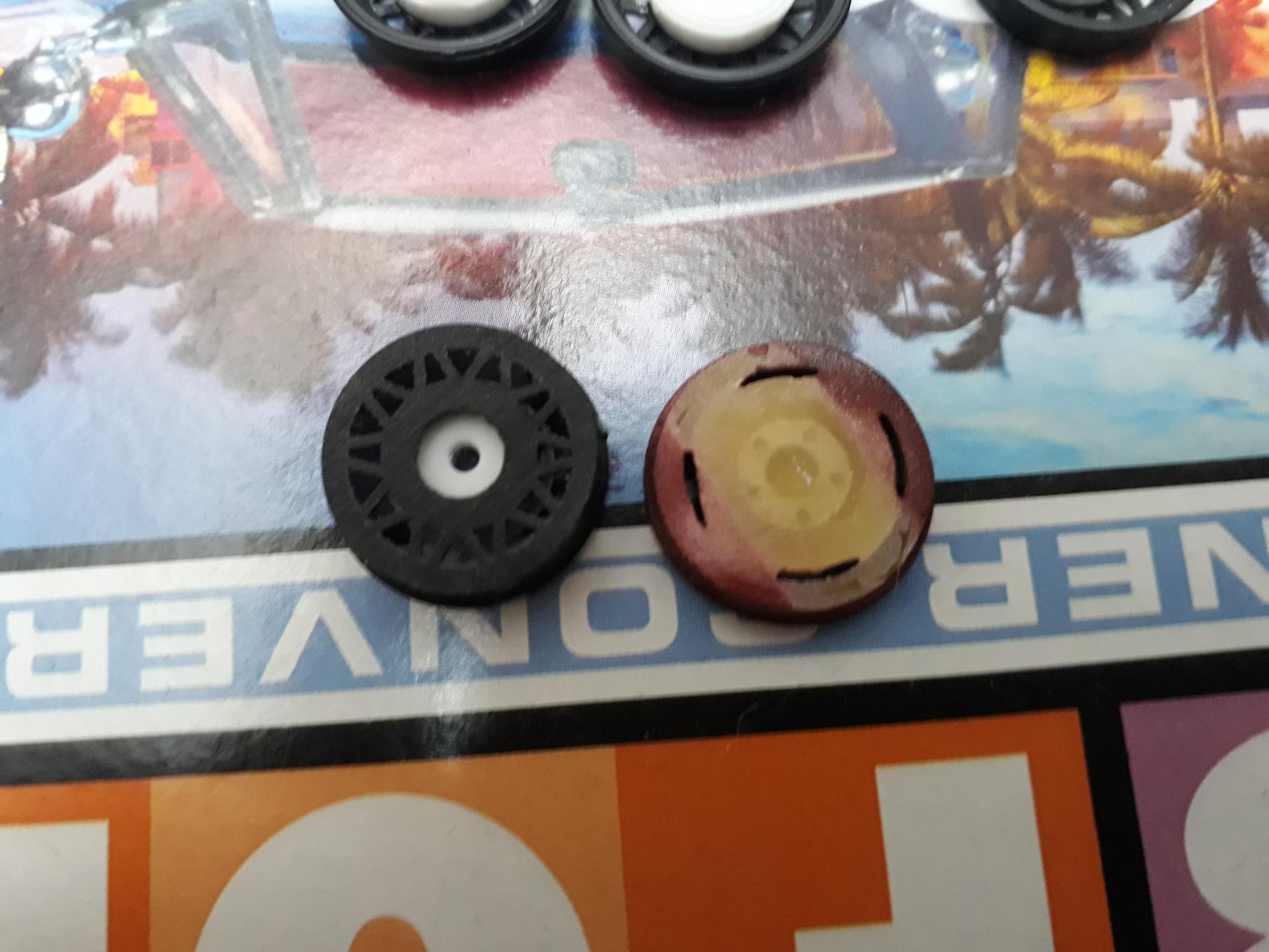

Also adapted the kits wheel backings to work with my resin "steel wheels" this way the wheels and tires will mount on the frame like they are supposed to, and I'll still have spinage action!! Lol.

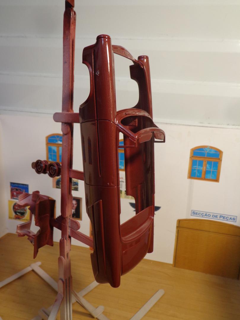

Next step is to prime and paint all the parts...

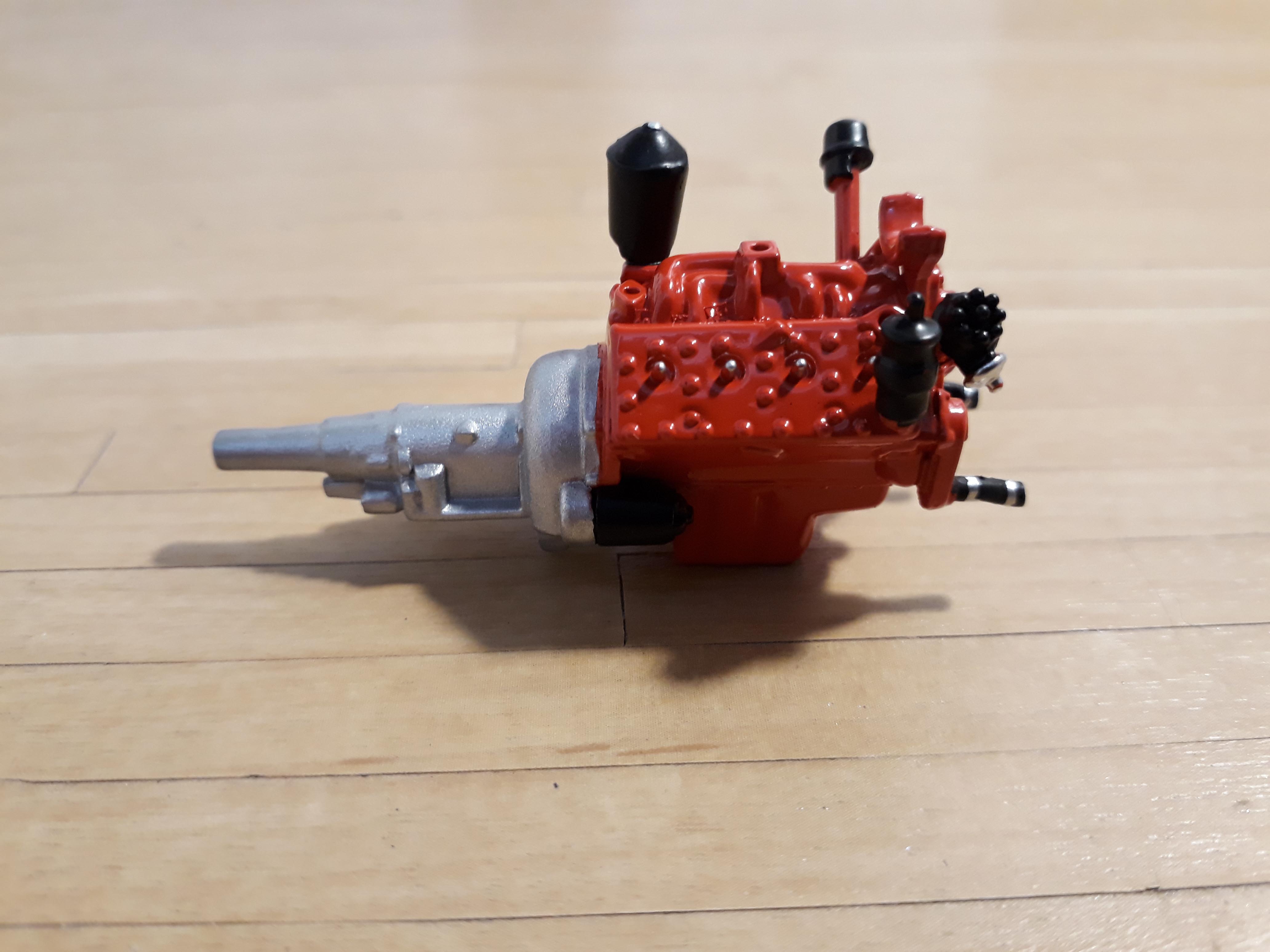

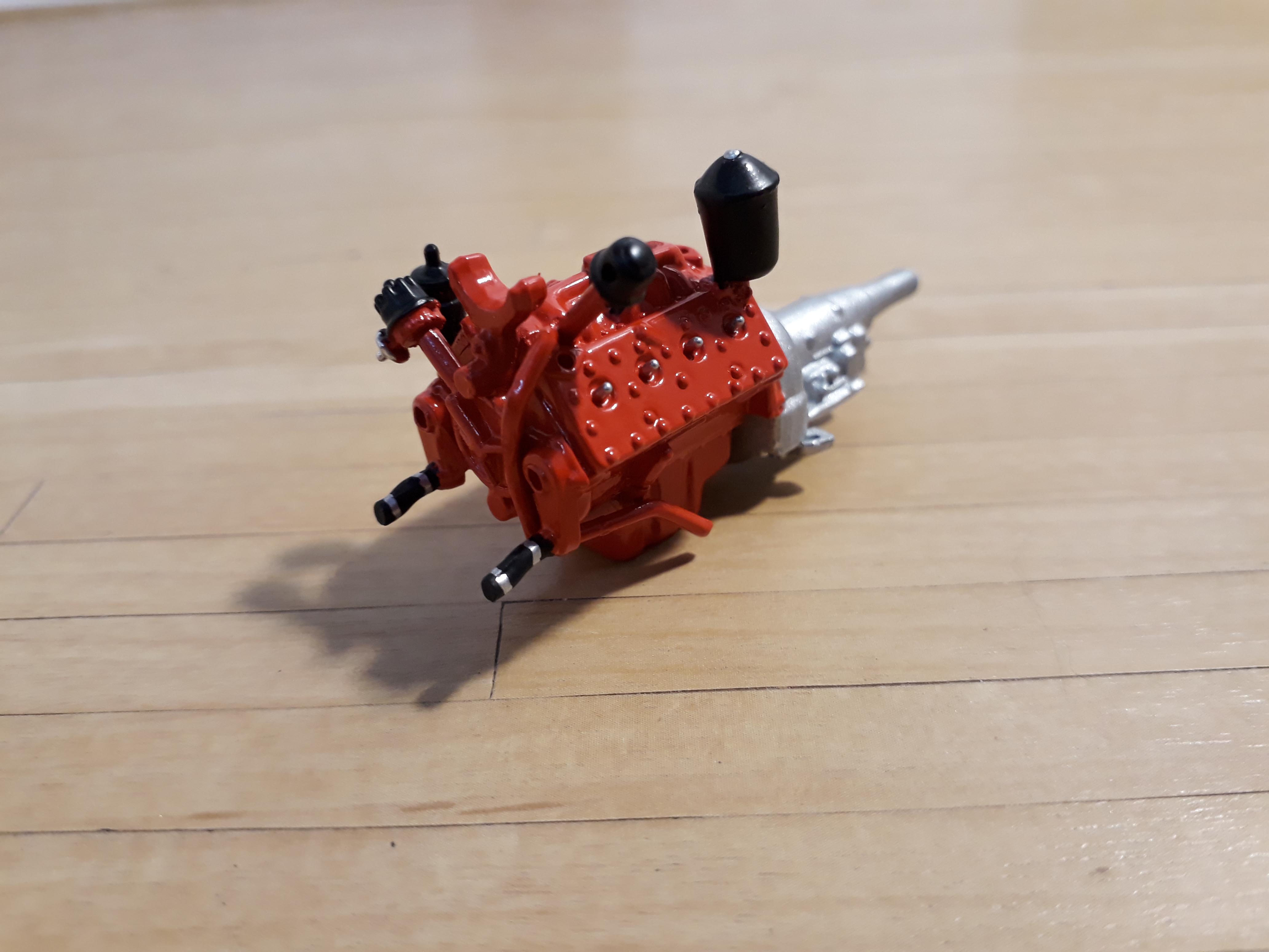

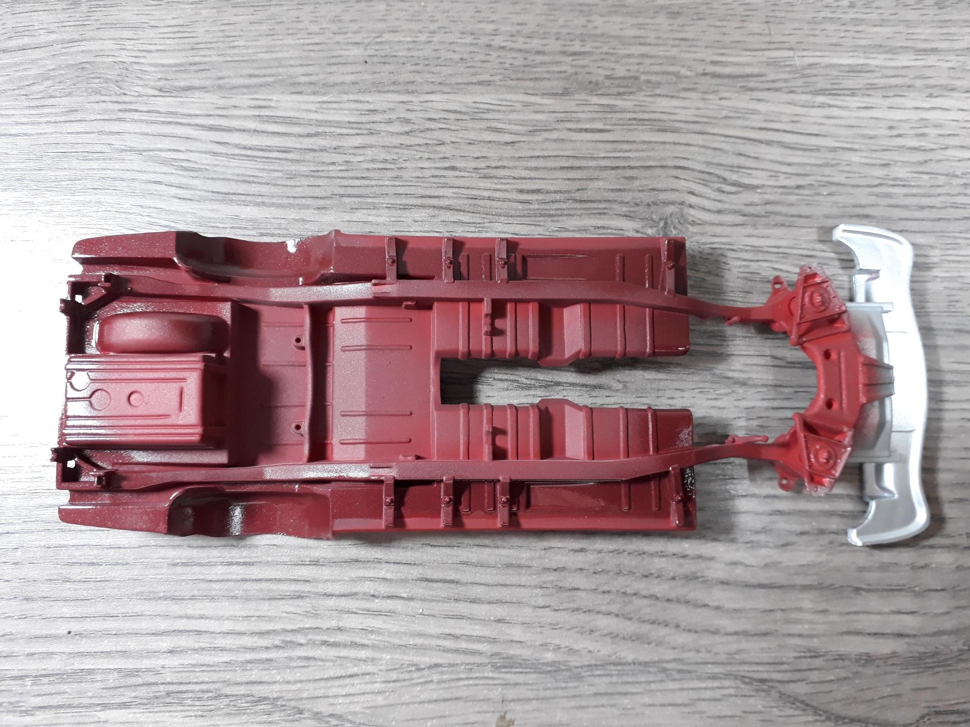

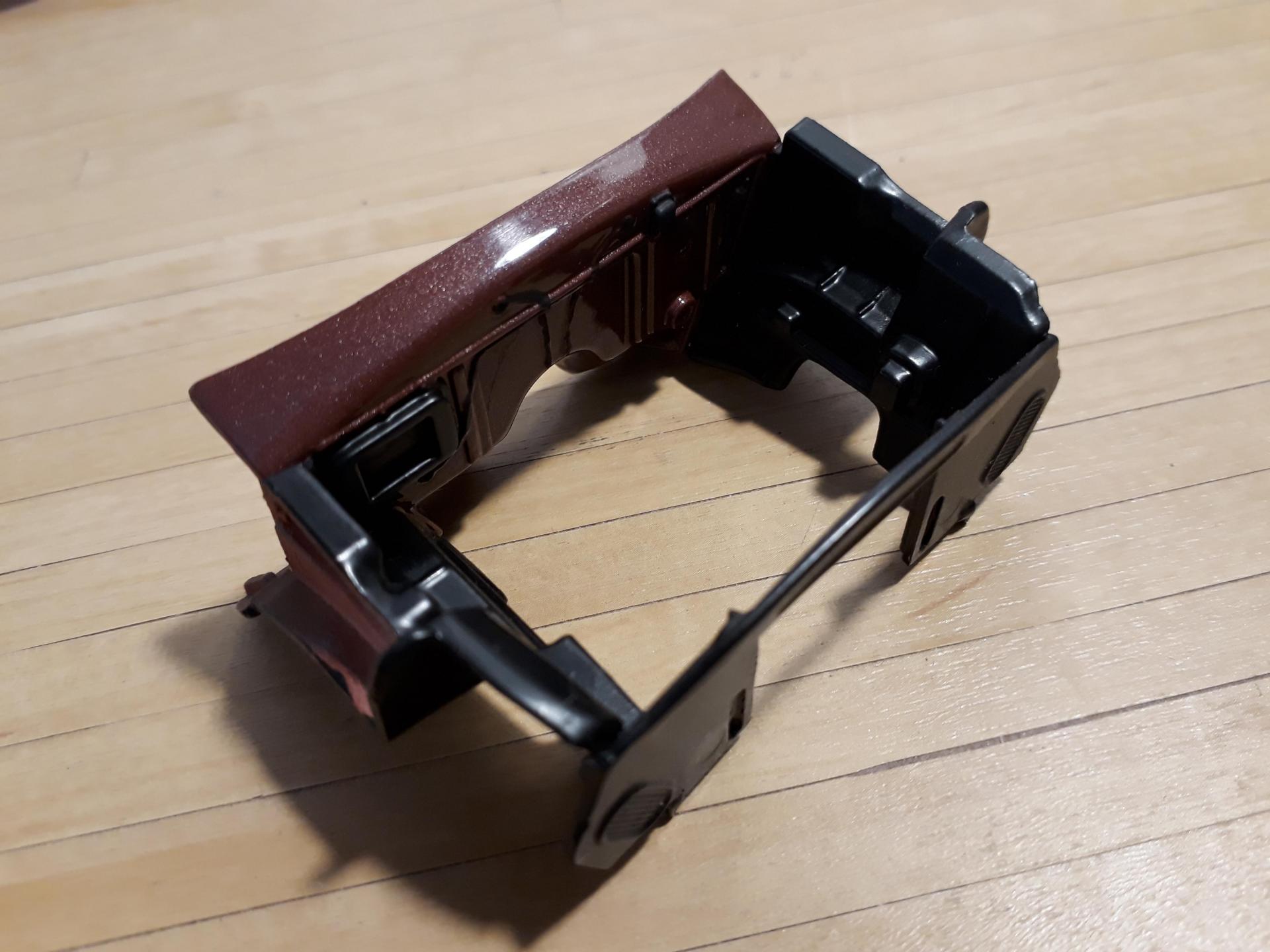

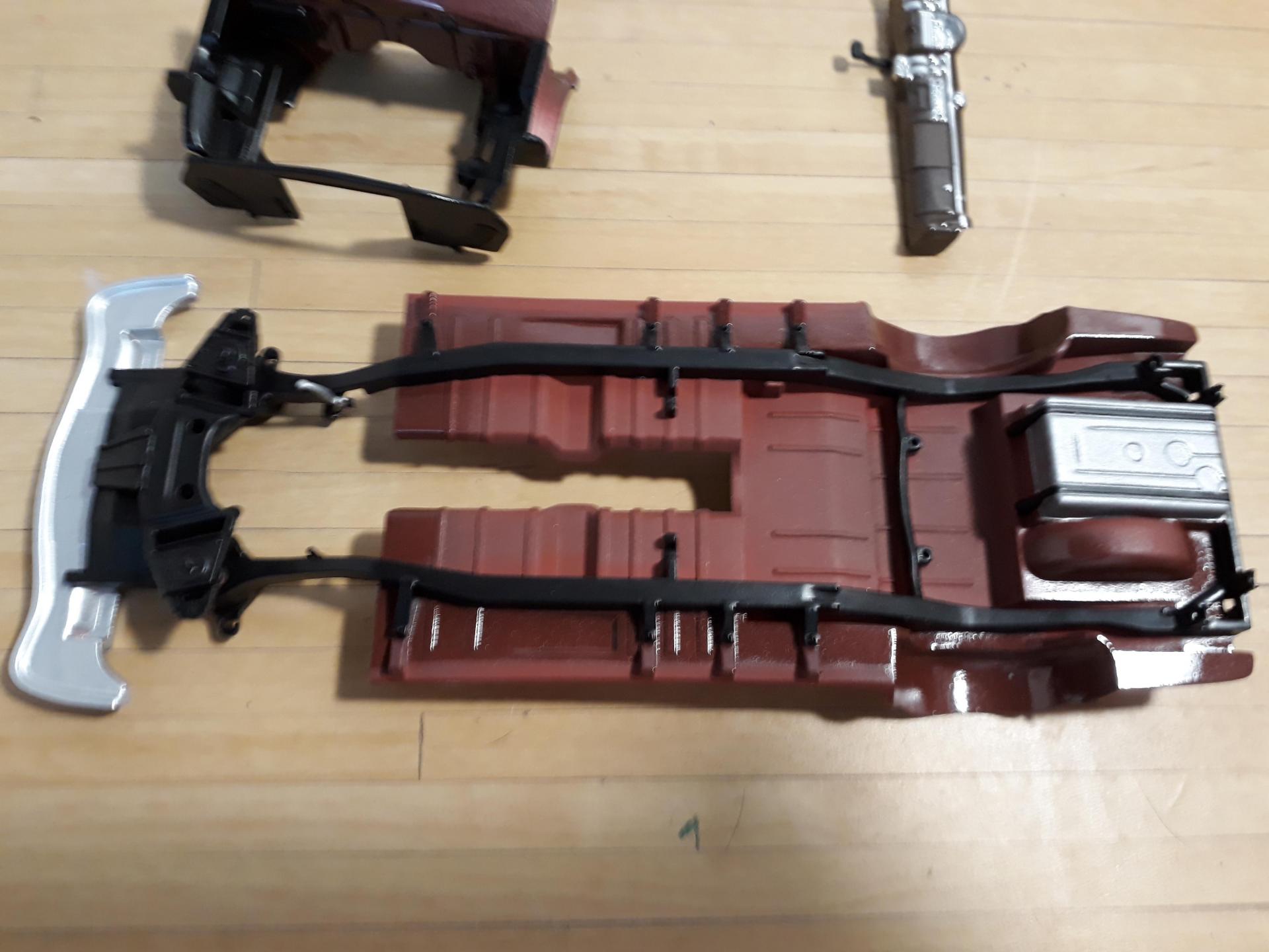

Painted the argent on the splash pan. Also, painted the body color overspray over the primer on the floor pans. 20181015_011504.thumb.jpg.588b6a0d93ebf9638821ddc2ff8a9241.jpg

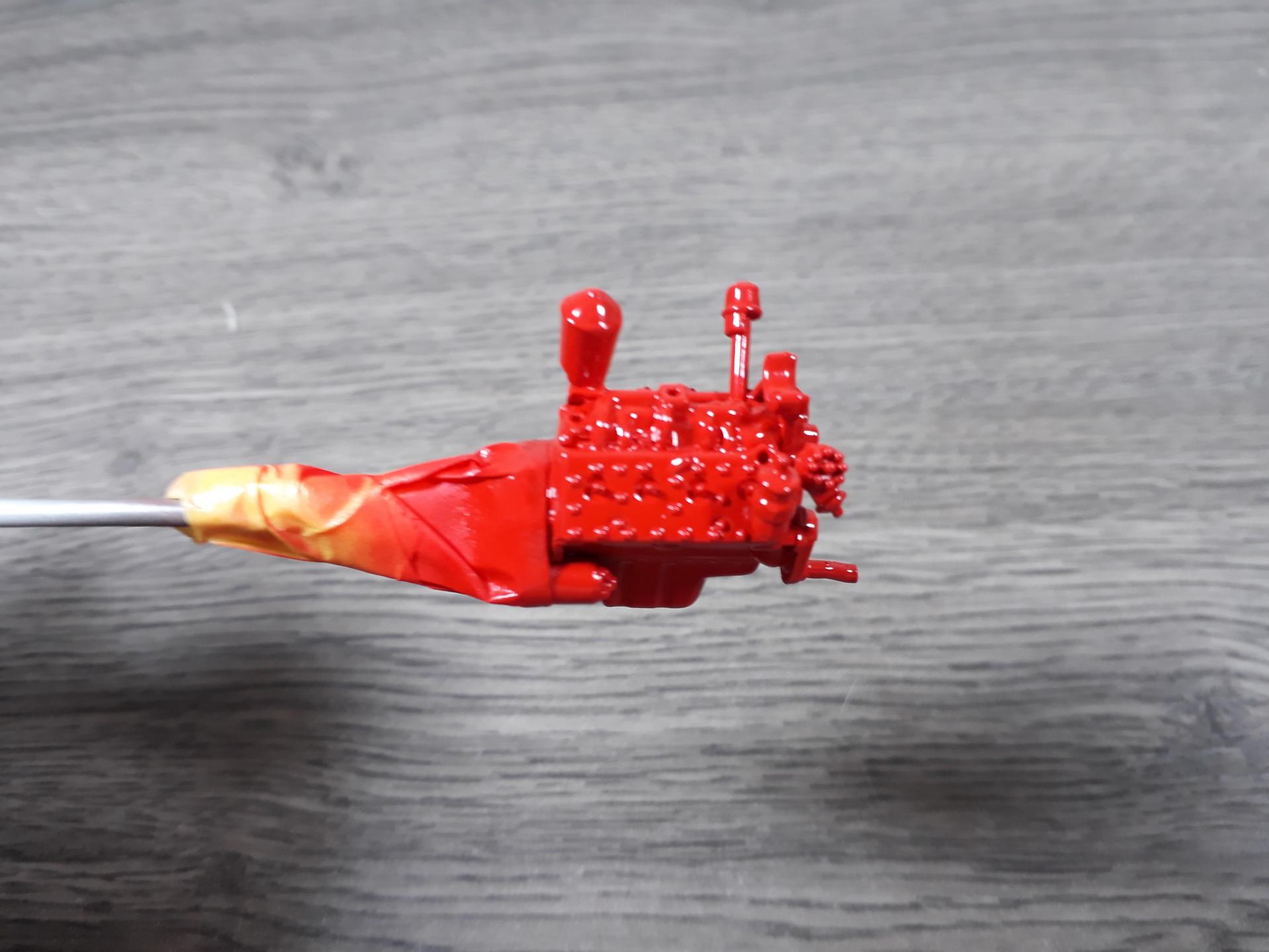

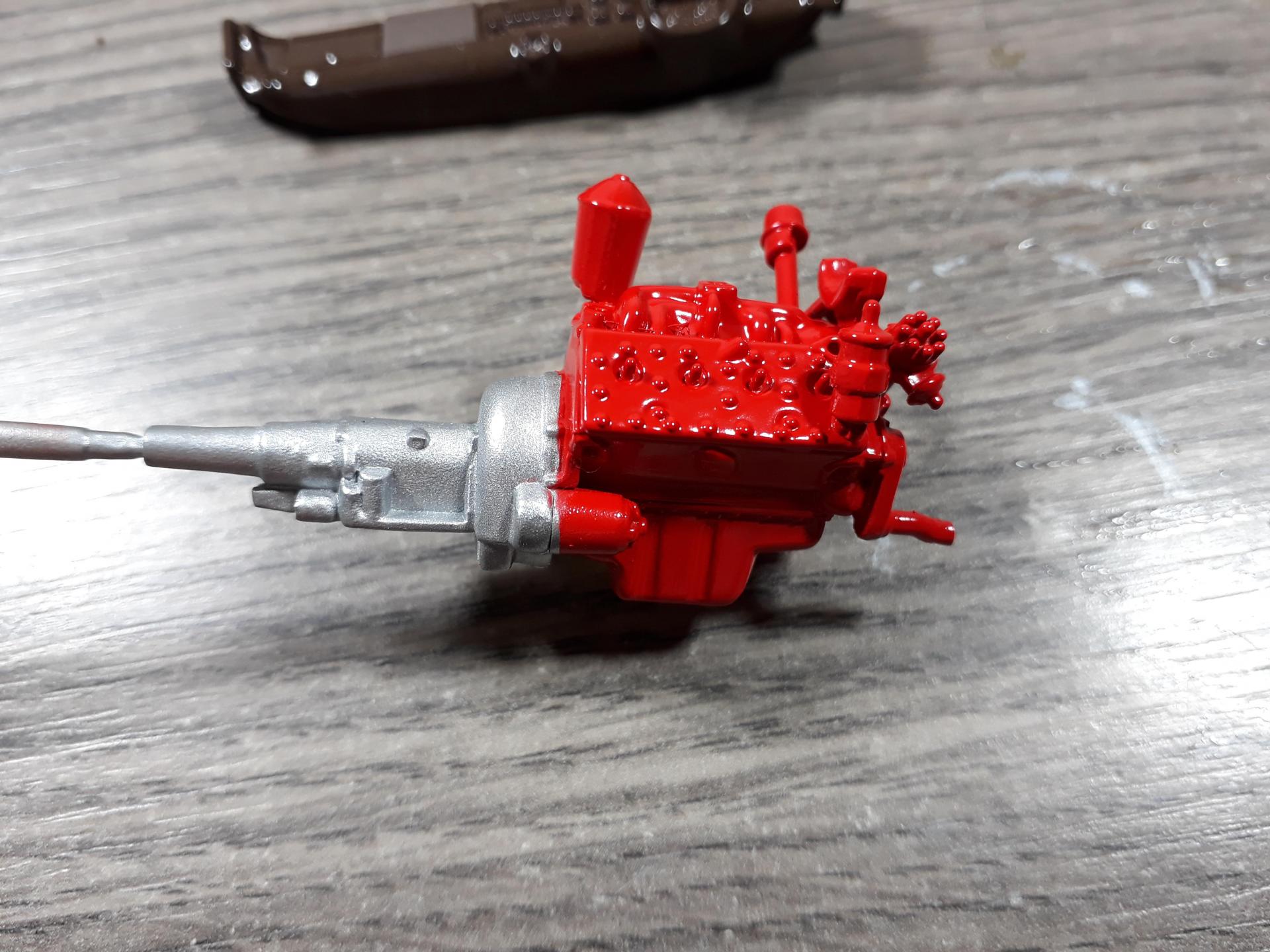

Engine now painted "reddish orange", even tough it looks red on pictures. Some touch up necessary on the transmission.

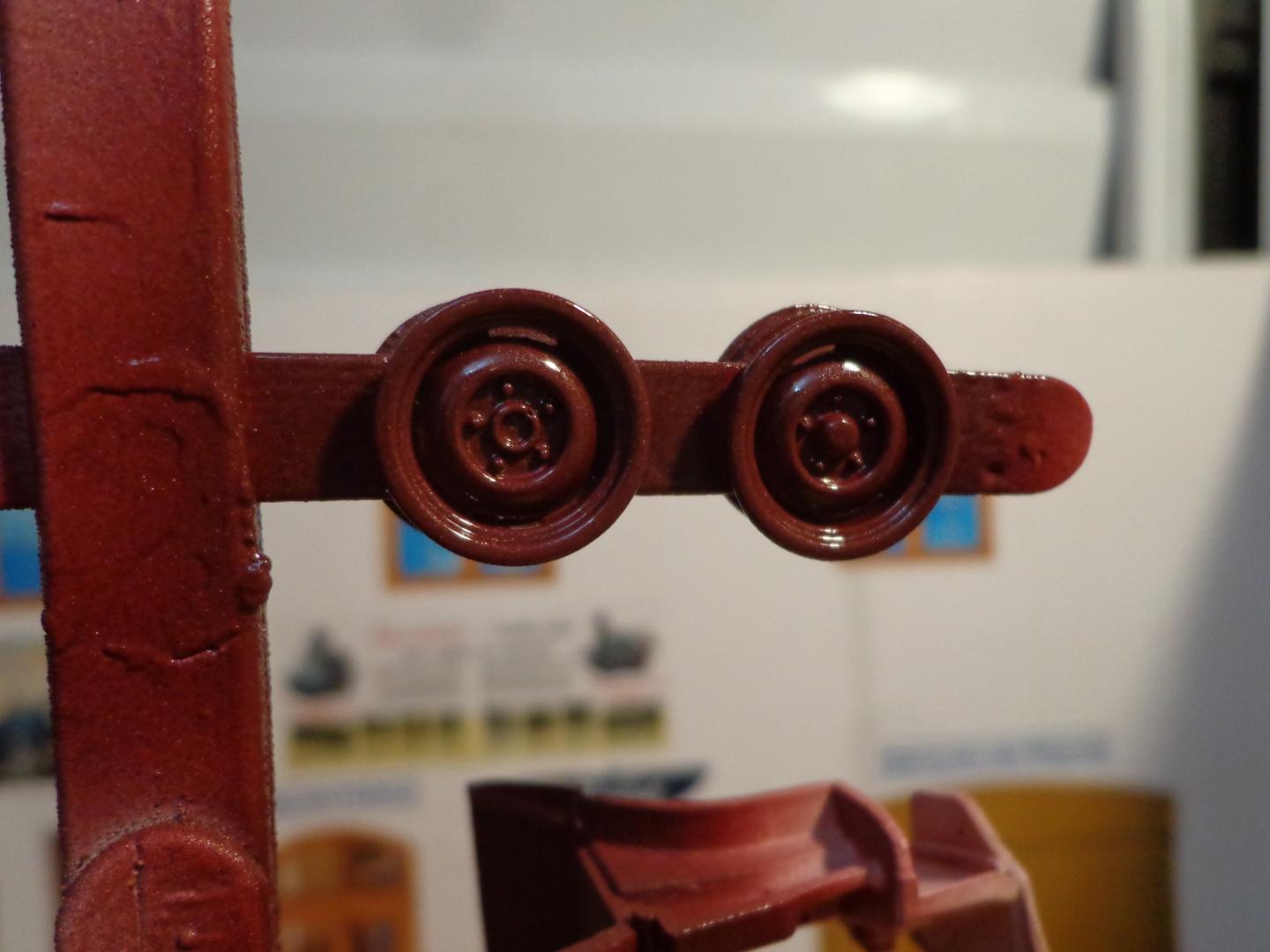

Wheels and tires ready.

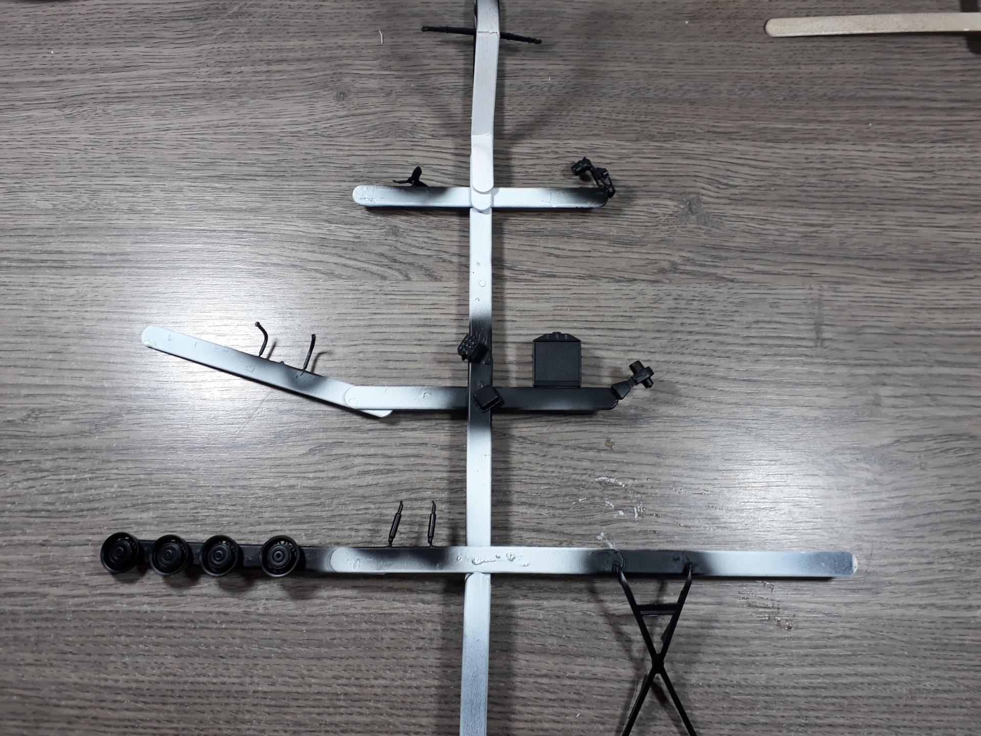

Black parts painted. All black now will be brush painted on (frame rails, inner fenders, radiator support, and small details).

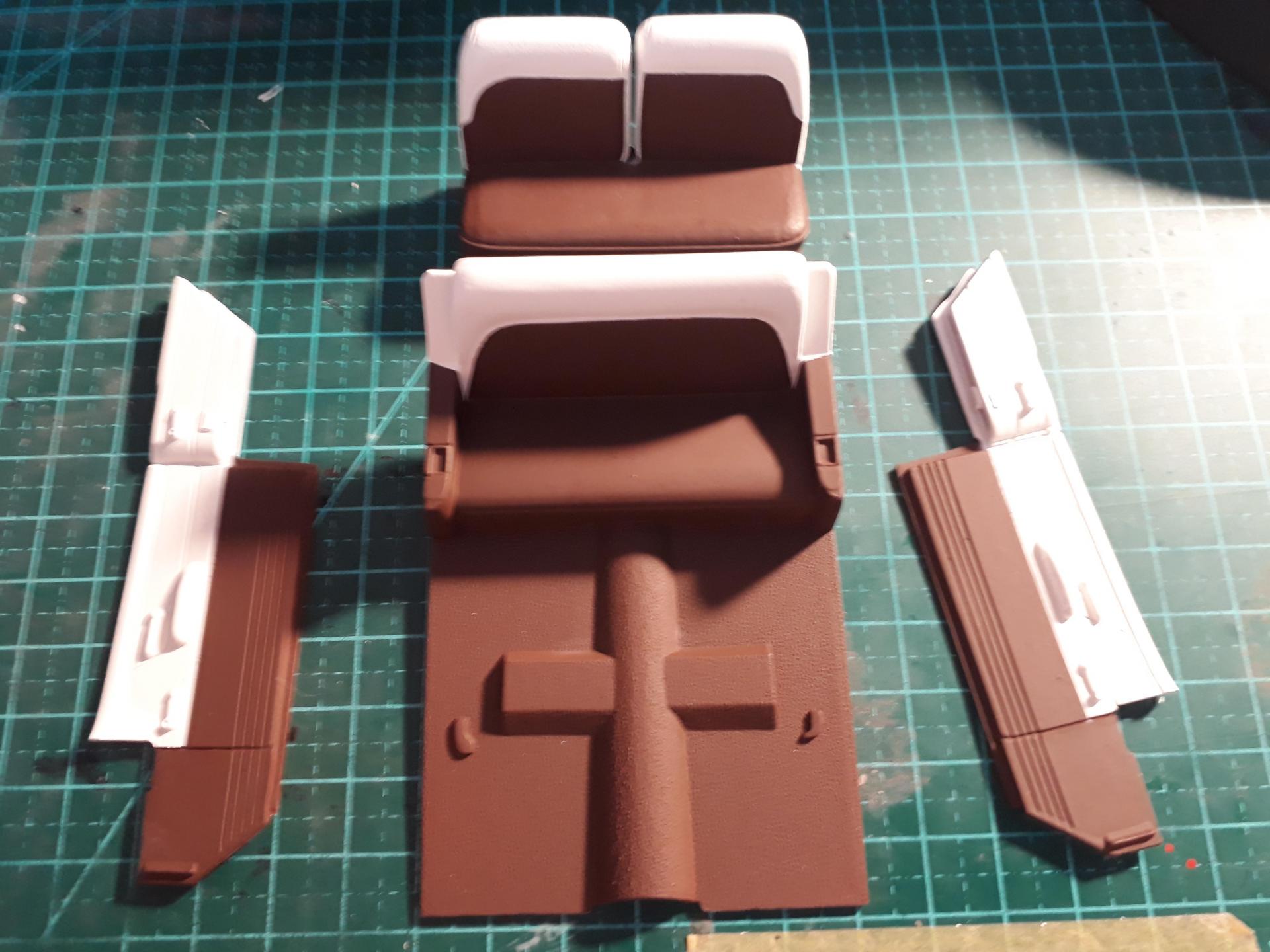

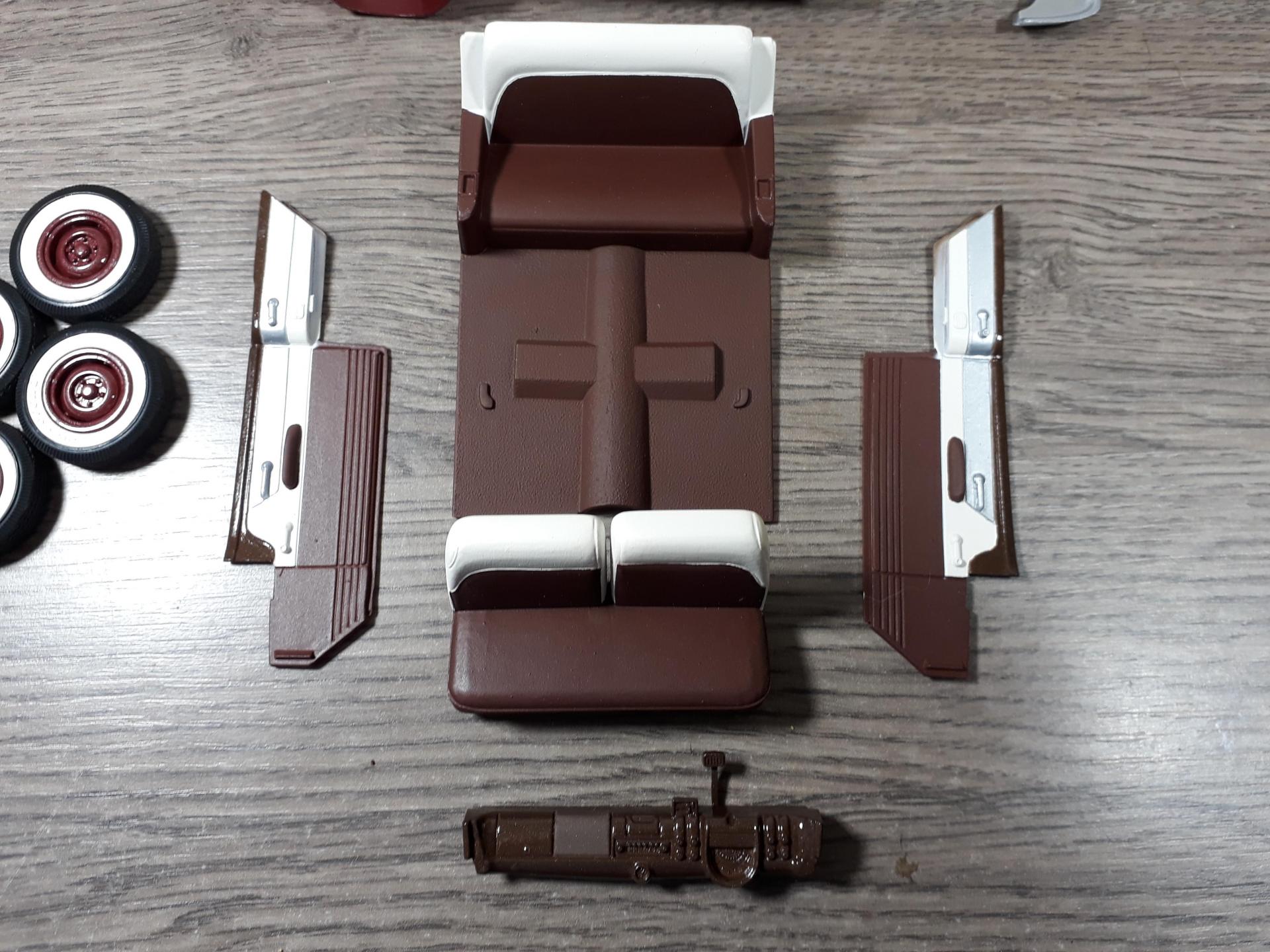

Interior is almost done, still missing the detail paint and foil.
Steel, aluminum, and zink plated parts painted:
Carburetor and fuel pump:

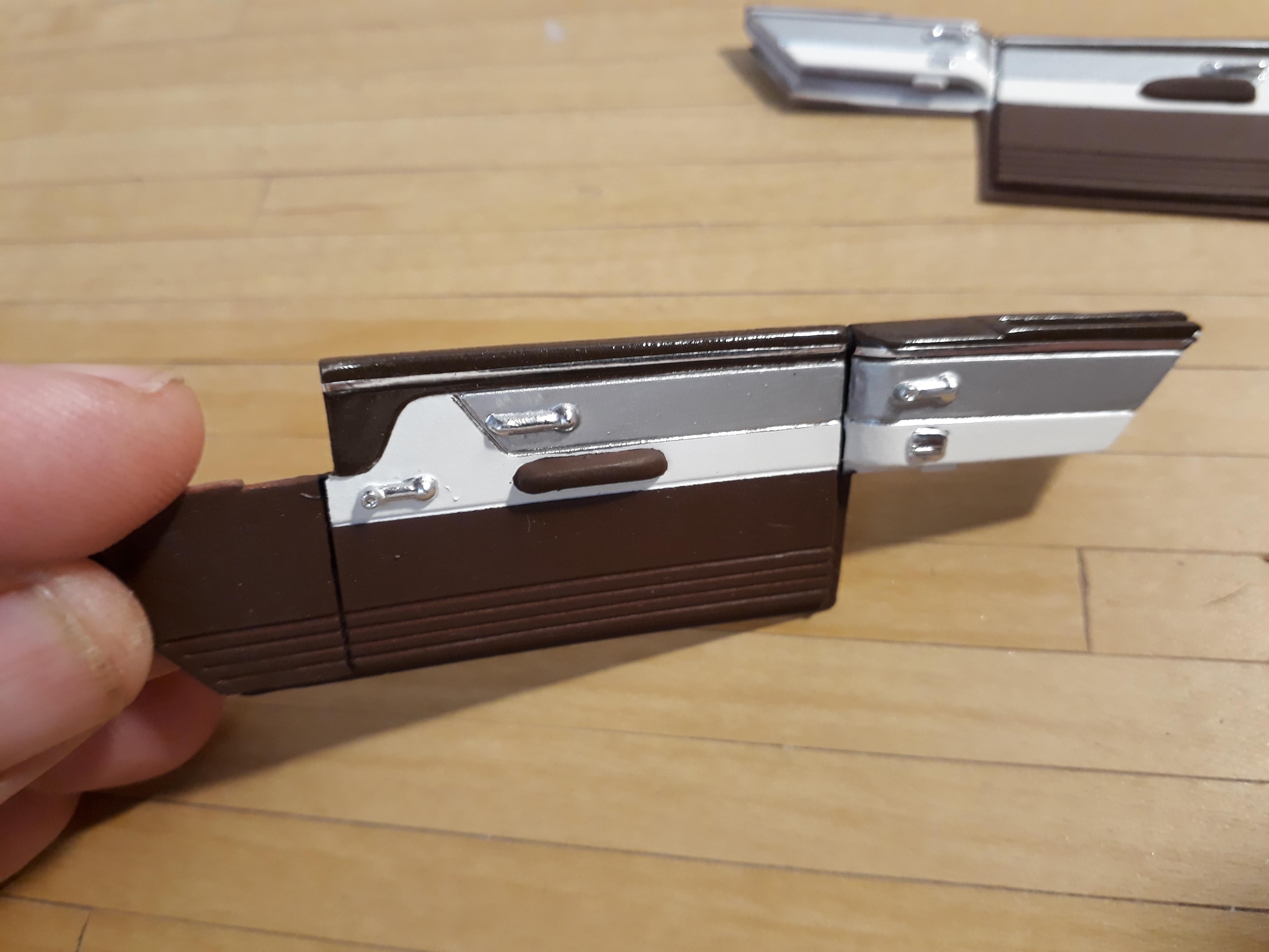

Finished the detail paint on the chassis. 20181017_002054.thumb.jpg.bfe77cf7a22068d88d8e694371662287.jpg

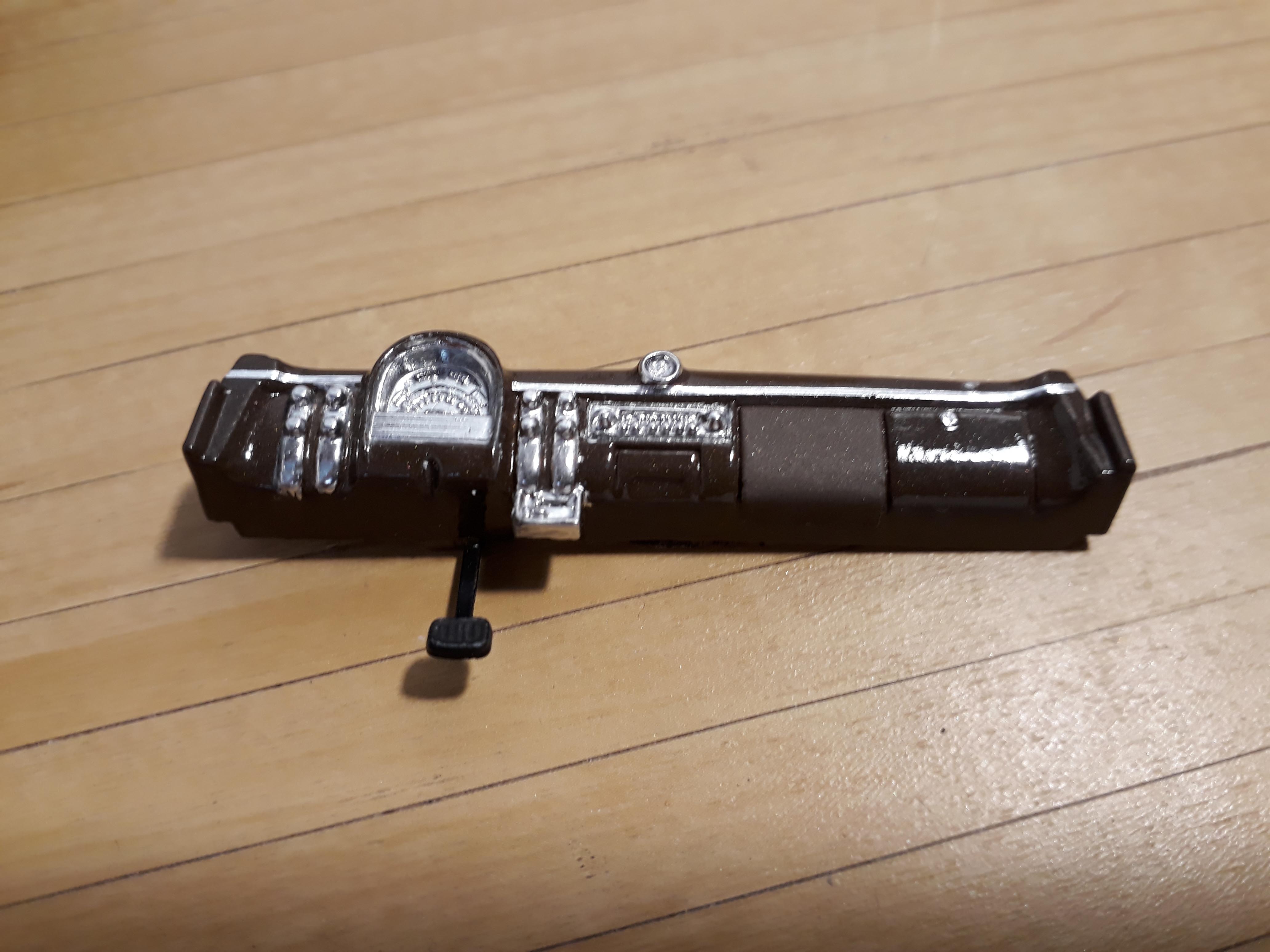

Almost finished detailing the dash.

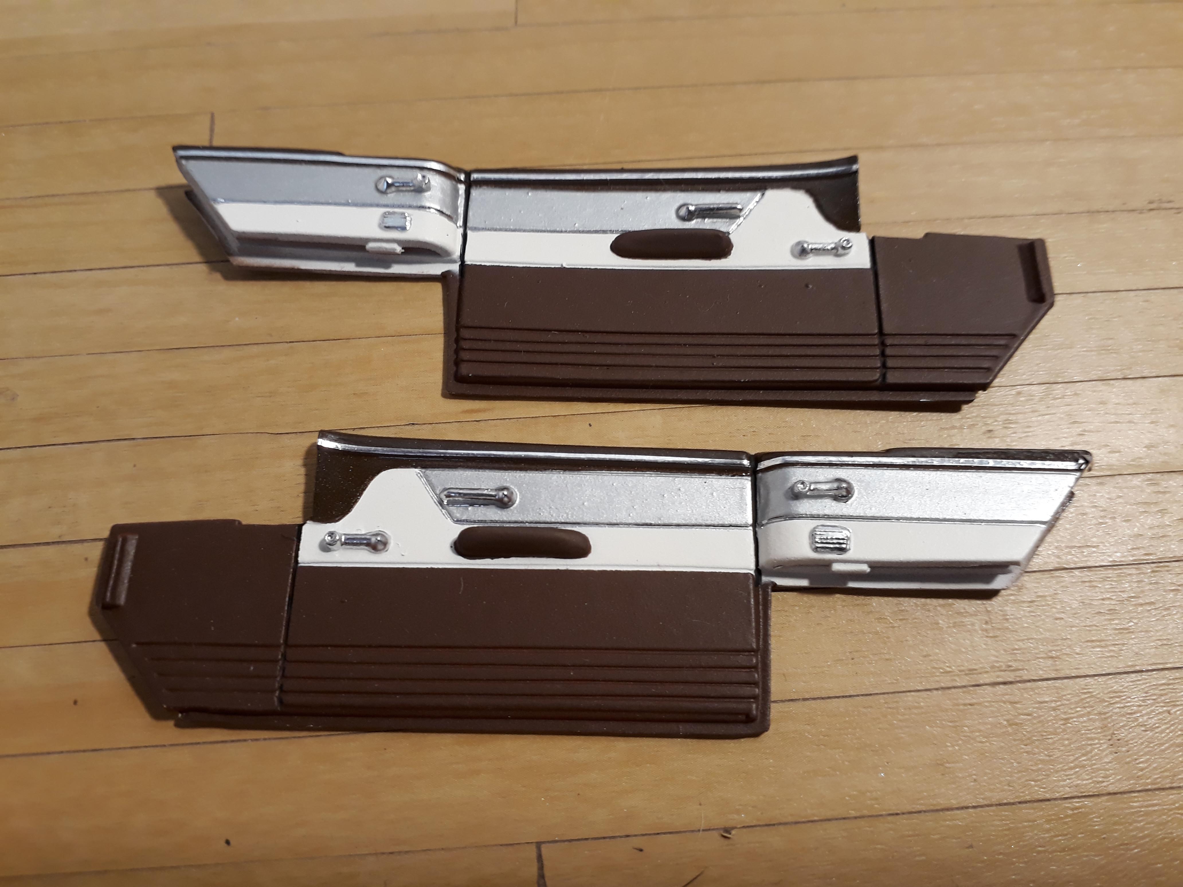

Finished detailing the engine bay, the door panels, and basic engine detail.
