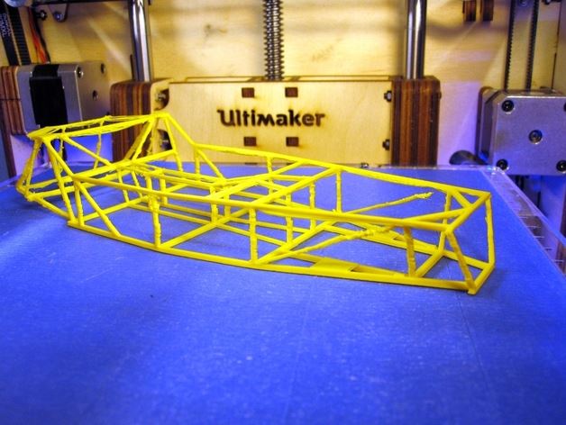

da Speedinger Posted October 20, 2018 Author Posted October 20, 2018 Thank you for your interest guys. Here is my next post: 2018-06-26 I want to scratch build a tubular frame from 2 mm round evergreen. My approach is to print out the blueprints in scale and use them as my guideline. 3D print the chassis is an option, especially cause there are already existing .stl files on the web. But the quality of the result is questionable so i want to build it from styrene.

da Speedinger Posted October 22, 2018 Author Posted October 22, 2018 (edited) On 10/22/2018 at 9:47 AM, Anglia105E said: Michi...... I am very interested in your idea to begin this project. I will follow your work in progress and waiting to see how it goes. The plan drawings and the 3D option are of particular interest to me. David Expand David, i have withdrawn the 3D option rather soon, as the result was not usable for me: The blueprints (printed out in scale 1/25, so 1:1 for my build) were very helpful indeed. Not only for the frame but also later in the build to get proportions of the car right. Michi Edited October 22, 2018 by da Speedinger

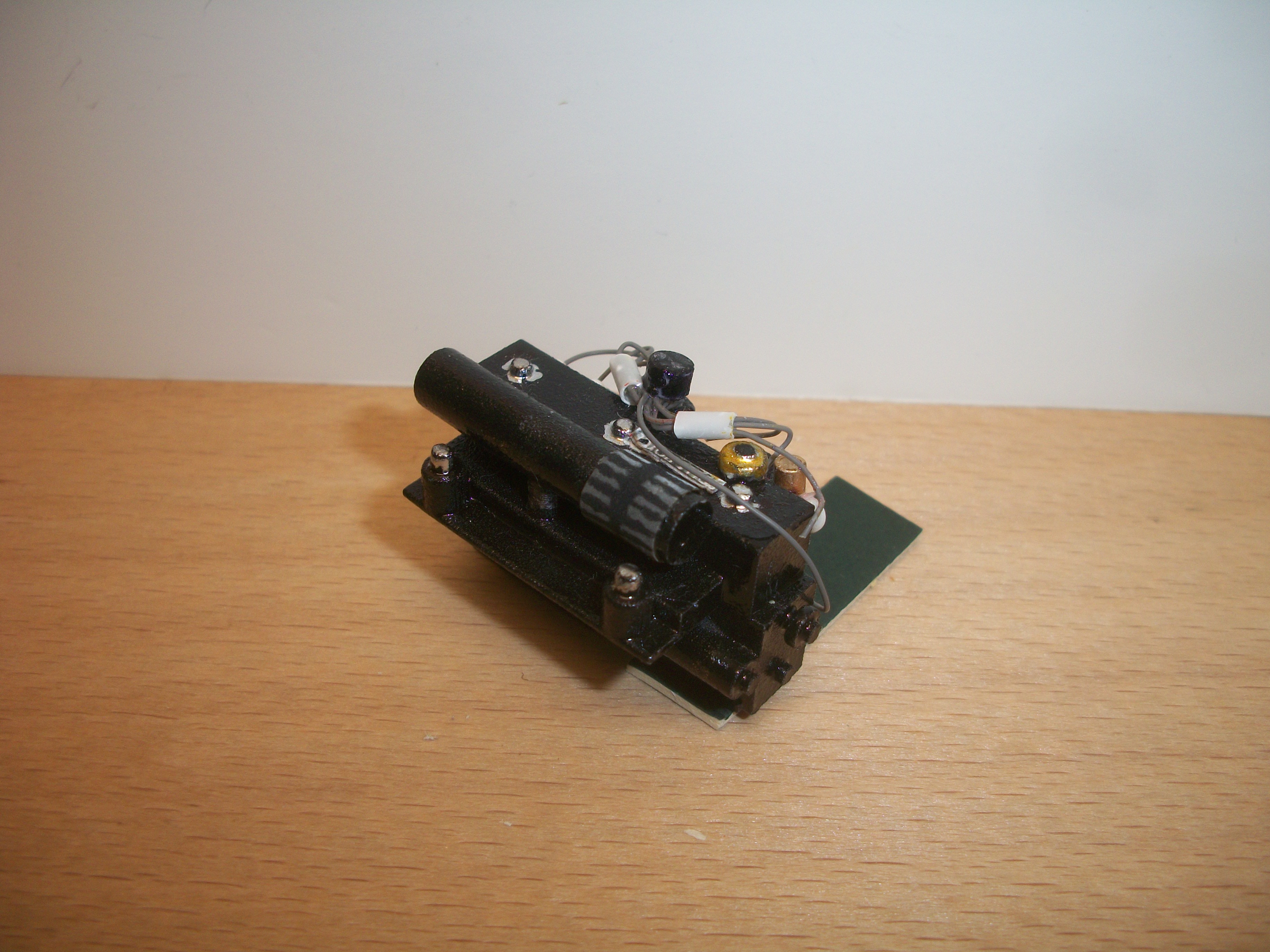

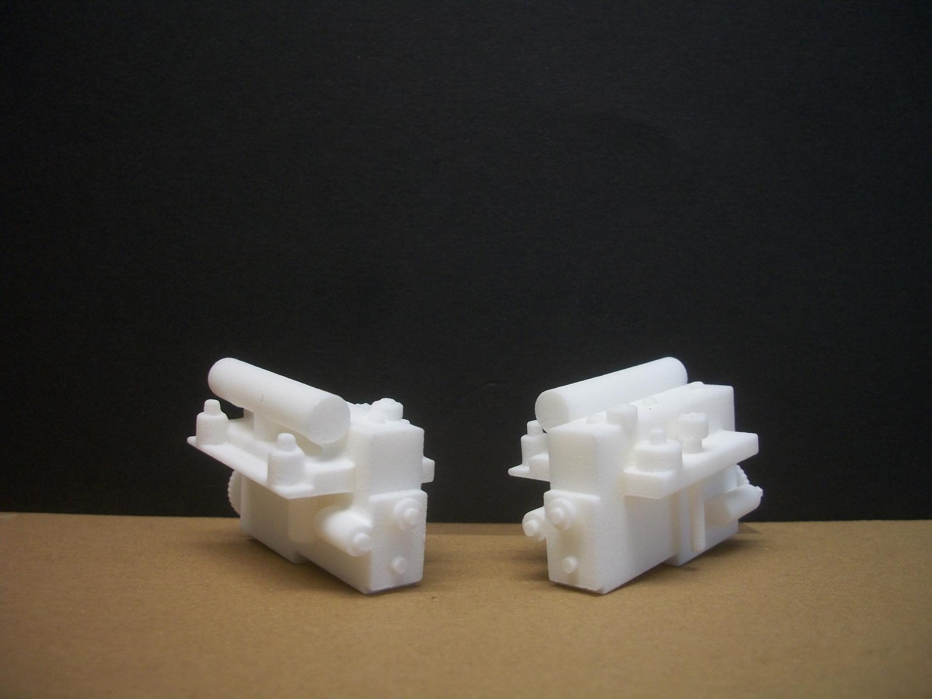

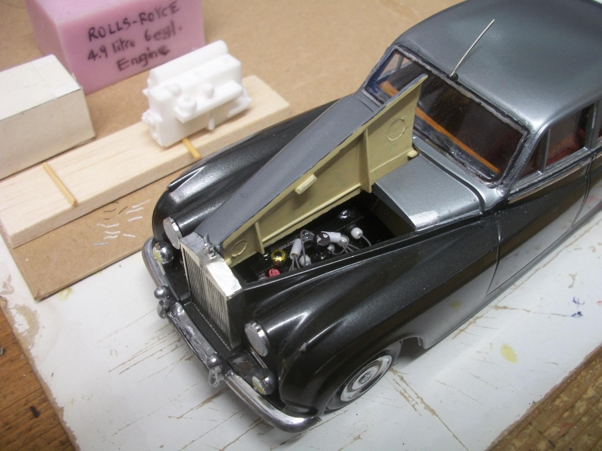

Anglia105E Posted October 22, 2018 Posted October 22, 2018 Some things do not work so well in 3D printed material, but as you say, your 1:25 scale blueprints will be very useful. I have designed a 1:24 scale Rolls-Royce 6 cylinder inline engine in 3D, using FreeCAD software and this has been 3D printed by Shapeways. Two of the engines have been used for two of my 1950's Rolls-Royce Silver Cloud models in 1:24 scale. Few photos for you. David
da Speedinger Posted October 22, 2018 Author Posted October 22, 2018 On 10/22/2018 at 4:07 PM, Anglia105E said: Some things do not work so well in 3D printed material, but as you say, your 1:25 scale blueprints will be very useful. I have designed a 1:24 scale Rolls-Royce 6 cylinder inline engine in 3D, using FreeCAD software and this has been 3D printed by Shapeways. Two of the engines have been used for two of my 1950's Rolls-Royce Silver Cloud models in 1:24 scale. Few photos for you. David I also tried a 3d printed engine - maybe you have seen it here:Mini 1000 K7 Expand
Anglia105E Posted October 22, 2018 Posted October 22, 2018 Just had a look at the Suzuki GSX-R 1000 engine, which has printed really well, and also your Mini project is very interesting Michi, as well as unusual. The Tamiya Mini kit is a good kit and I used one as a donor kit for a Morris Minor Traveller I was building. You did well to change the data of the 3D printed engine and the whole build looks great. David
