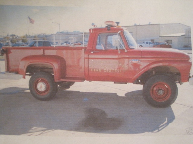

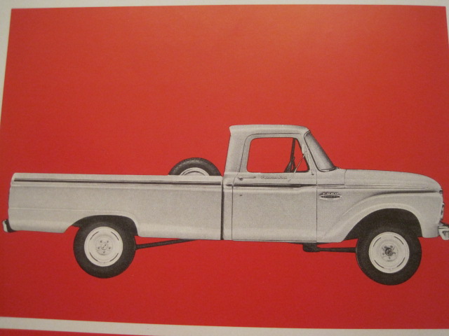

On ‎11‎/‎3‎/‎2018 at 4:17 PM, Atmobil said:
Would the chassis parts from the 4x4 kit and the Fireball Modelworks F250 conversion parts be accurate parts to make this in to a F250 4x4?
Or did they use the older style of bed/box on the 4x4 trucks?
The '61-'66 F 250 4x4 as well as the '61-'65 F 100 4x4 used the older style box's, 8' Flareside ( not available ) or the older 8' Styleside ( not available, unless you purchase the old AMT '60 Ford pickup kit and hacksaw the bed off).  These were high floor cabs, not low floors cabs used on '65 and '66 F 100 and F 250 2wd  twin I beam trucks.  The only conversion possible would be building a '66 F 100 4x4 ( these had low floor cabs, same as '65 and '66 F 100 and F 250 2wds) with the '70 4x4 frame as a donor.  Fireball's 8 lug wheels are post '67 bump style wheels used in '67 and newer F 250's, pre '67 F 250's used the old style inner bump 8 lug wheels ( these wheels have never been done by anyone). Hopefully Fireball can offer these inner bump style 8 lug wheels too ( 16" 17.5" or 19.5").  First photo '66 F 100 4x4. Second and third photos are '65-'66 F 250 4x4's ( same body styles as '61-'64 F100 F 250 4x4's) . 4th photo 19.5" 8 lug inner bump wheel  ( done in 1/16, never done in 1/25)

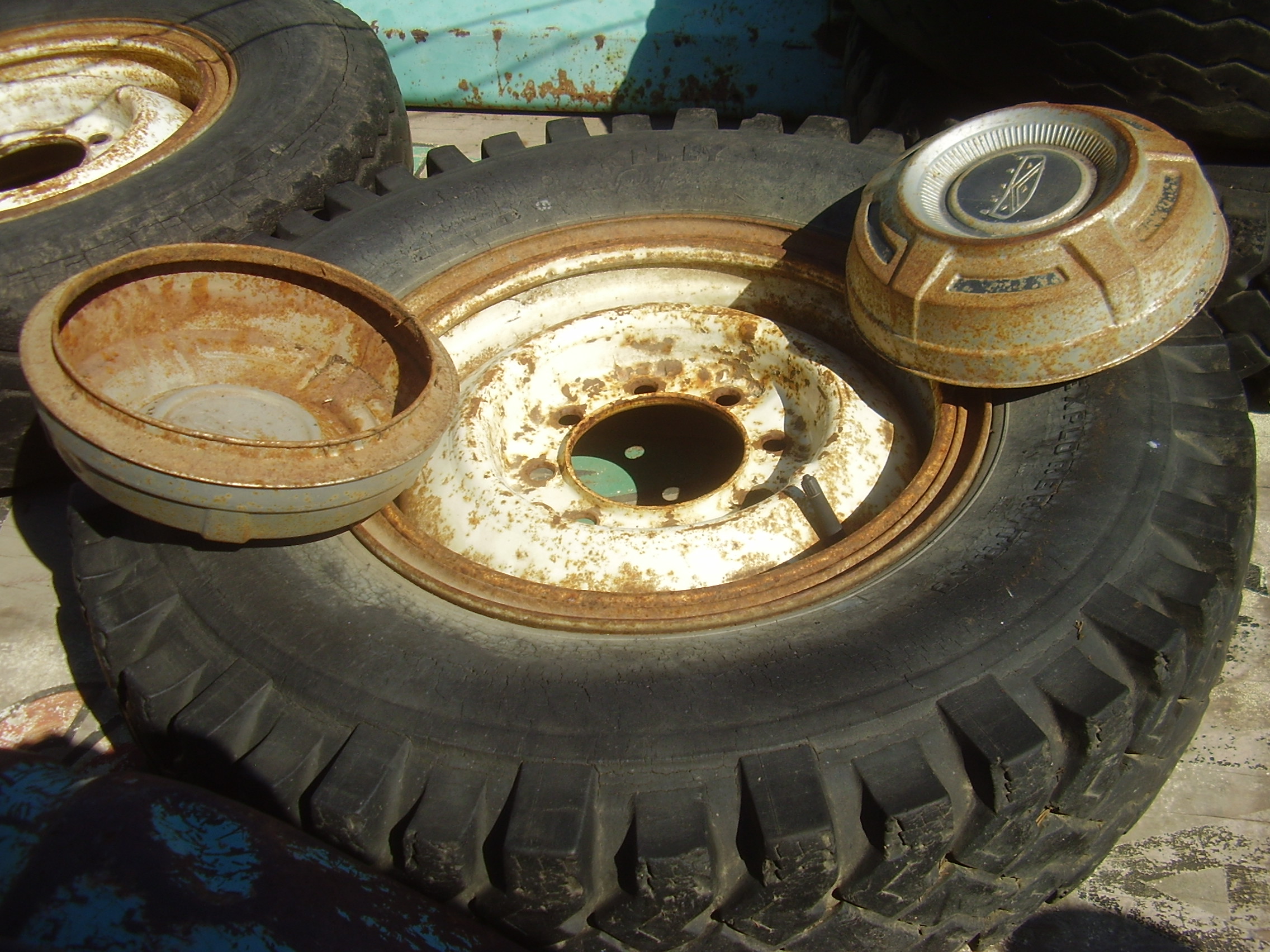

The F250 caps actually do exist with the earlier mounting flange but are pretty rare.
Yes,  one year only hubcaps: 1967 . There were two sizes of '67 F 250 hubcaps, one fit the early style carry over 16"  rims in your photo, the other had the same styling but larger, and fit the new 16.5" wheels. The new larger version was used from '67 thru '77.  '61-'66 F 250's used only one style of hubcap, the hubcap shown in the above blue '66 Camper Special F 250 Ford ad.  I guess my Camper Special build will have to wait a little longer till the 8' styleside becomes available. Those are the early style 8 lug 2 piece rims that would be correct for '61-'66 F 250's, hopefully these become available in the future!
Edited by leafsprings
Wasn't sure about availability but that fits the scenario; they were in the box of a pretty fair, well used '67 Merc 250 with a bale picker in the back. Got bid up to 3k ^_^
The '67 was kind of an odd duck, with the new outer style but a number of carry-over parts from the '66. I've found about a dozen details unique to it as opposed to the '68-'72s.
