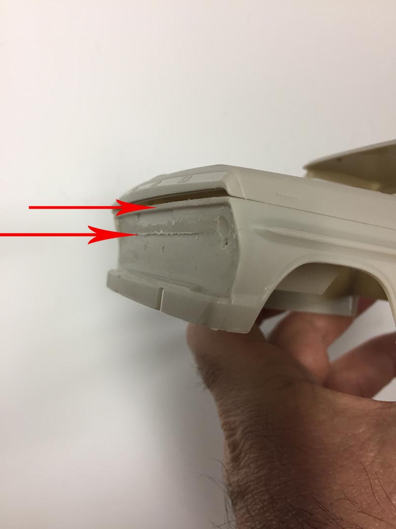

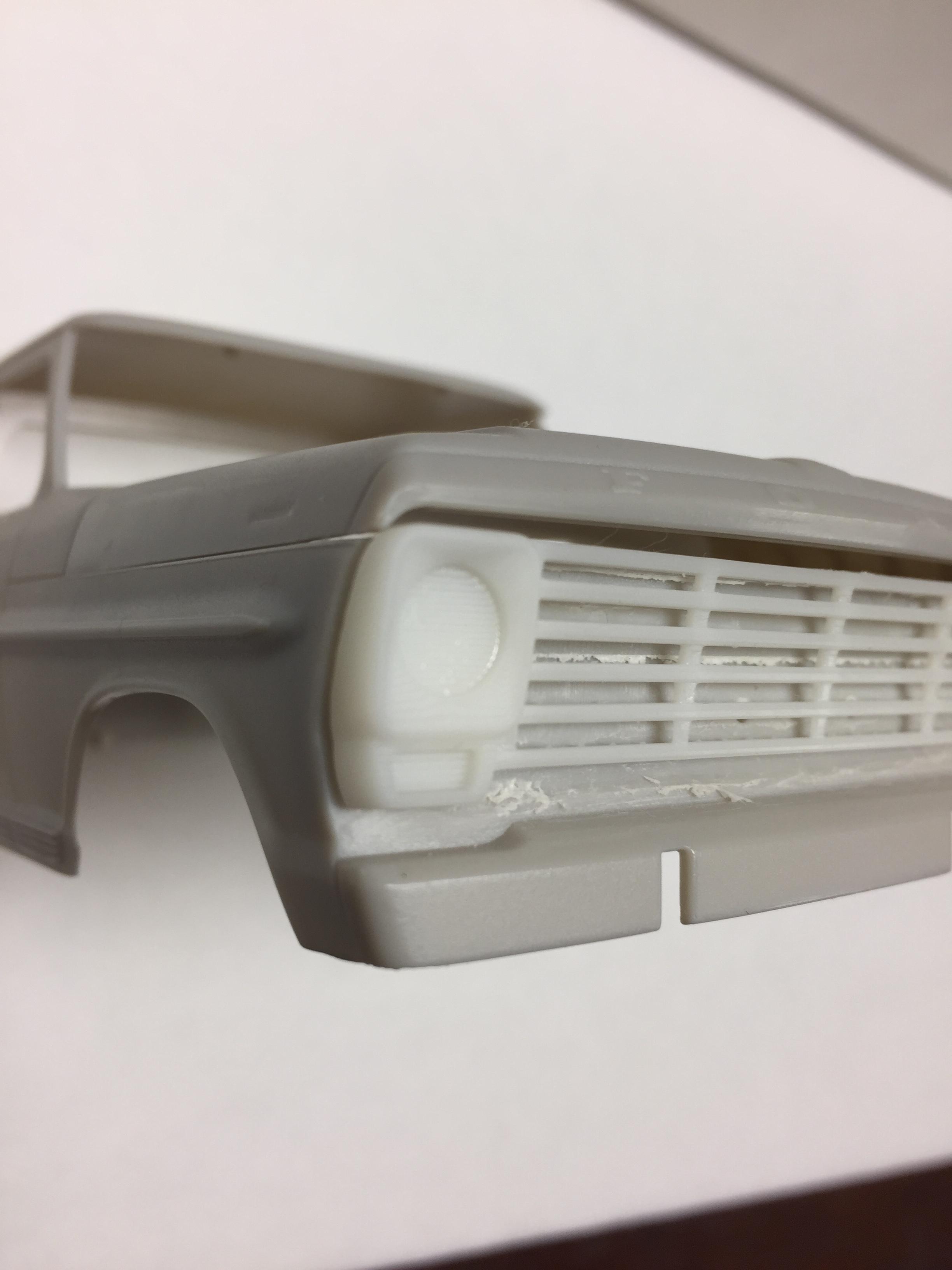

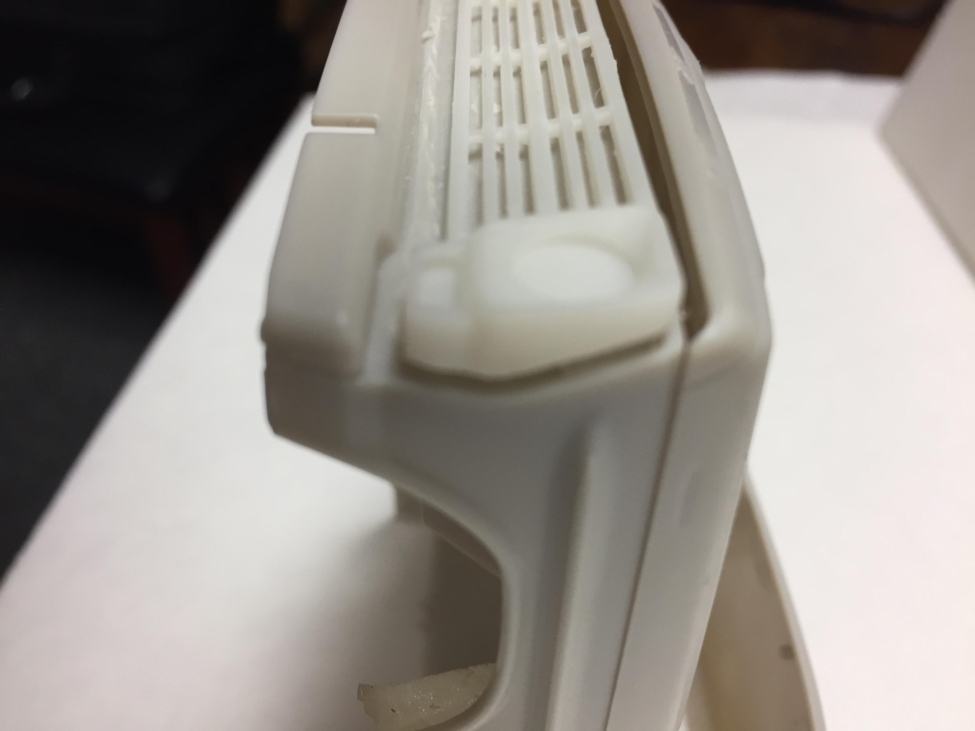

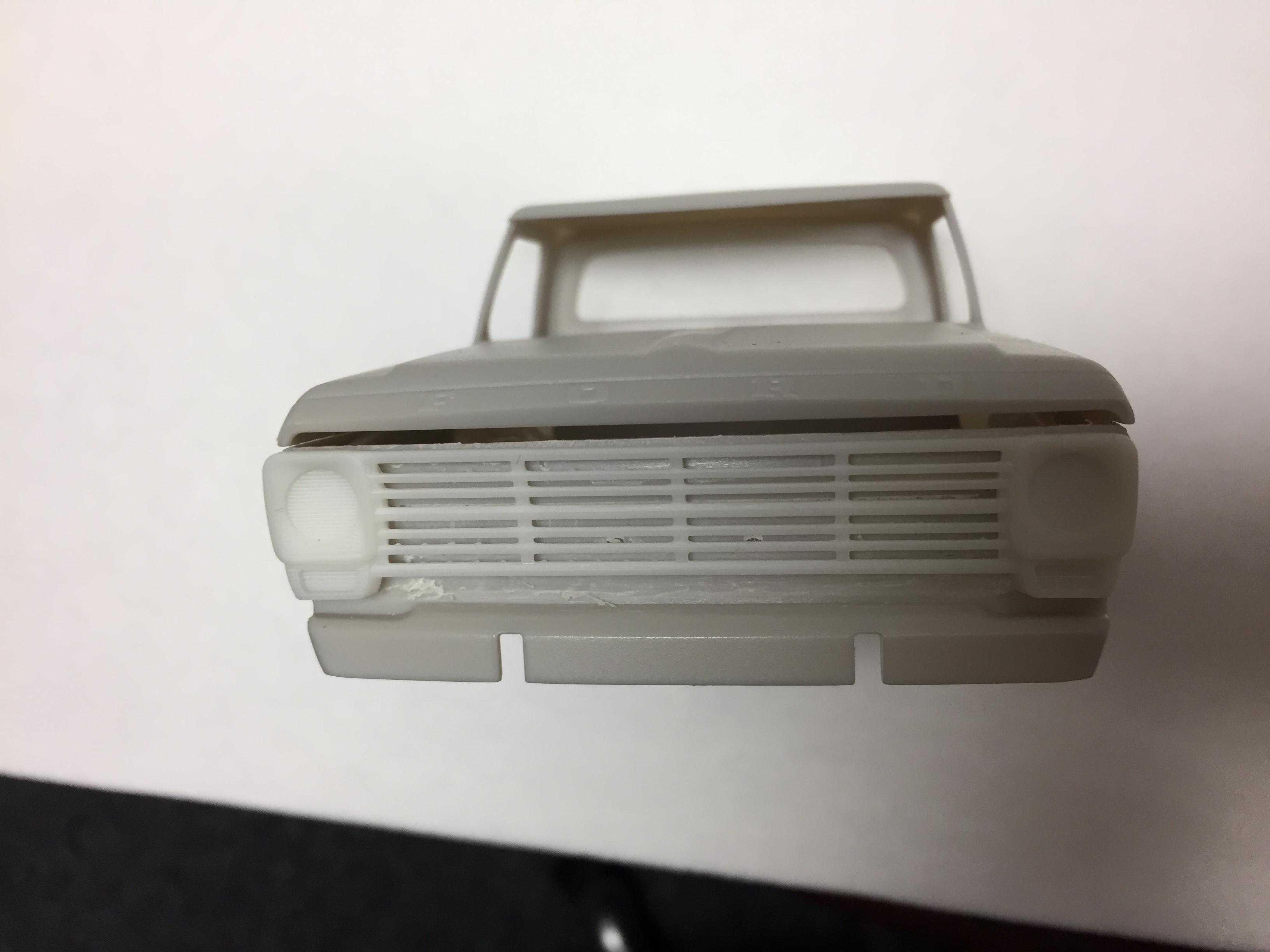

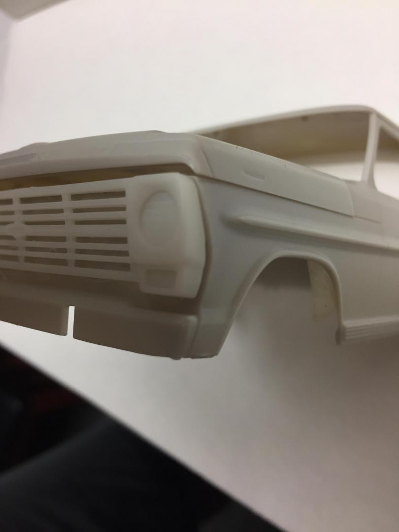

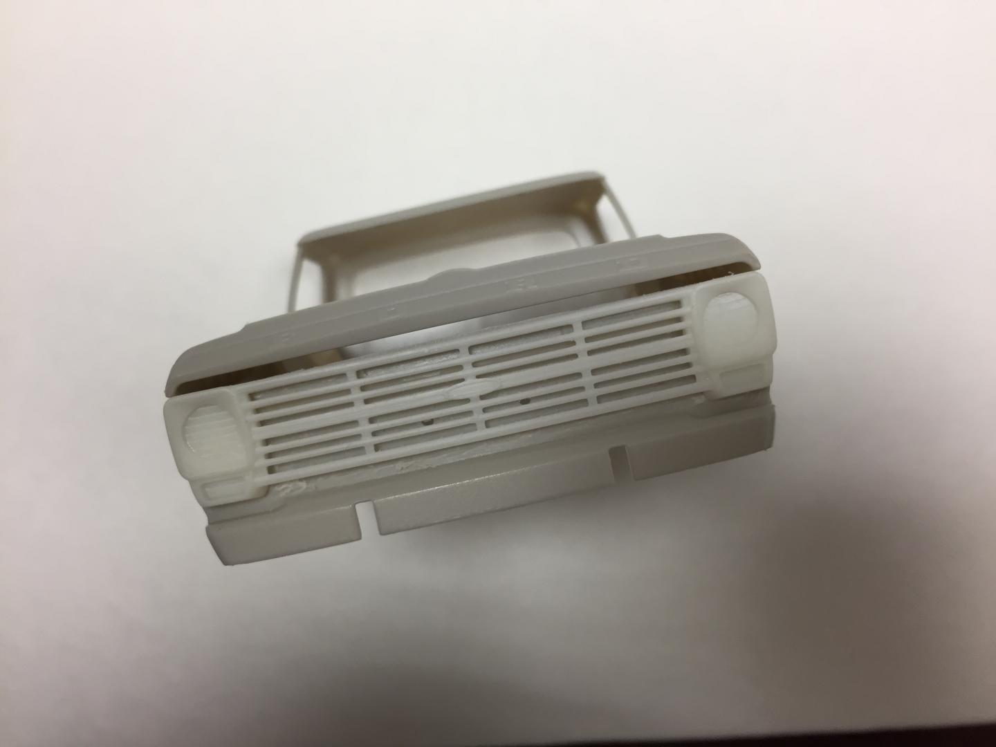

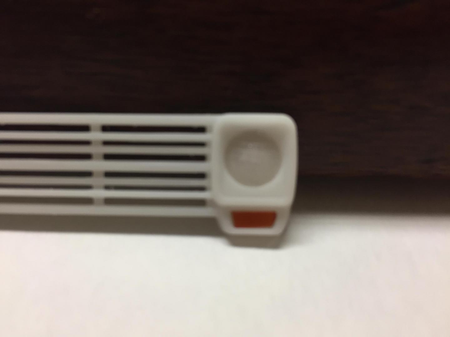

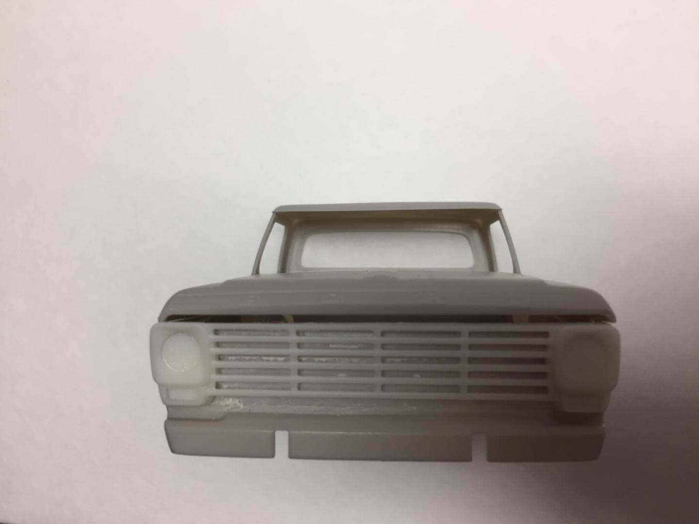

Hey Matt,  I have them pretty much ready to go except I am still having fit issues. I corresponded with MK11 and hopefully got the bezels corrected. There is a little work involved in getting a good fit as the cab has an excessive curvature and the grills are printed flat.  They flex a little to rap to some curve but its tricky to not get a "smiley face" appearance without removing some of the curve. That is what has been delaying these things.  I pretty much ground off most of the lip right under the hood and shaved some from the radiator area on the cab and its so close its not even funny.  You can see the comparison in the pictures of the cab I modified to the untouched cab.  Its very doable at this point but I have been trying to get them to work with minimal mods to the cab and will continue to work on them.  In the next few weeks I will be able to work more on them as I am off work for the next 3 months.  If you need some right now, I can send some...just send me a PM and we can work out a deal.  Keep in mind these are 3d printed and will require some fine sanding around the bezels, especially if you are going to chrome them. The pics are all non sanded pieces...straight out of the printer after they hardened a little.
Test fitted the kit headlight to see if it works.
mods to cab and cab comparisons
IMG_0113small.jpg.22d1fbd5188dc2b99188a2a41989ec19.jpgIMG_0116small.jpg.be9777420f5112feea44e2137d4fe74e.jpgIMG_0115small.jpg.4bc358ba97ef074d8772636af8e48e47.jpg
You can see they are close but not quite fitting smooth...a little push and they are there. These pics show them just resting in place and are not glued in!
69 Ranger
67 grill
68-69 plain
I think the headlight area still needs some attention as the headlight lens itself seems a tad bit small. The bezels were measured from a 1:1 so I know they are good.  Let me know what you want to do and thanks for your patience.
69 Ranger
67 grill
68-69 plain

I think the latest versions are closer to the grill in the photo of the real truck further up the page.  There is a significant taper from the outside of the headlight enclosure to the lamp itself.  Perhaps a bit more in that area.  Other than that it looks pretty good!
That looks 1000 times better than the kit part.   I'll be a customer when it's ready.  I'd love to see a correct '72 grille as well, if anyone feels like doing one.
Thanks,   I worked on the taper you mentioned last night as I agree and think that is why the headlight seems small...we will see when I print one out if that cures it.
