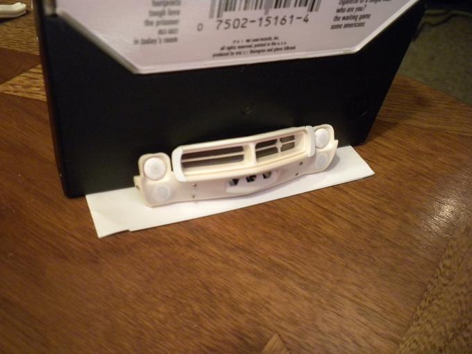

Although better and finer grade metal files will be required to ensure greater quality, an attempt to open up the front license plate area consistent with allowing a supply of scale air to reach the oil cooler using a spare '69 AMX bumper/grille/headlamp casting largely worked.   I hope that sourcing better than average jeweler's files proves possible before working on the '69 Javelin SST bumper which is really no different than the  '69 AMX; i.e. what differences exist between the two are restricted to the grill surround and related parts.
I'm pondering cutting off the grill entire, although as can be seen nothing wears chrome plate but for the headlamp surrounds and maybe the inset and offset Javelin bull's-eye discreetly made out to the right.  Should I do the headlamps and trim separately, or should I simply employ a Molotow pen and let matters be? Cutting everything apart might result in a cleaner build, although the effort may not translate into a tangibly better result.
Notice too the three upraised areas denoting mounting hardware dimples along the edge of each headlamp fill cover.  A pin vise and some plastic rod should make such possible.   The smaller diagonal radiator support to fender braces just made out will be sourced from a Revell '69 Camaro via parts bundles that litter eBay.
As seen from the cropped reference photo, the corners of each of the three openings don't seem especially sharp, although the cuts are clean enough.  Oh - and although quite dark, a single high quality reference photo suggests the center vent on the air dam comes to a very discreet point akin to a shallow vee across the base of such.  Here it looks almost flat across, hence I think I'll leave it alone...
...and just a fairly quick go of it with the aforementioned AMX spare; i.e. it's almost good enough.  Thanks...

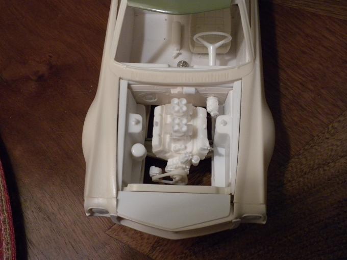

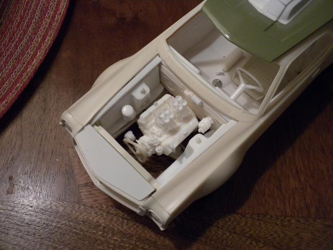

Wishing to start in with regards to under hood braces and such, I decided to cut out the SC/Rambler hood hinge pockets and patched in new material to blend back to the firewall to better allow me to do so.  Discreetly made out will be the inclusion of a subtly shaped solid plastic rod atop the Jo-Han firewall to better plug gaps between it and the body proper (it helps), while the new oil injection port may also be seen added to aluminum rod that passes through the new cast resin valve cover featuring gussets to support such.  Finallly, a CDI module has been added to the passenger's side footwell, and a lone fire extinguisher makes an appearance on the transmission tunnel - safety first, circa 1969!
Apologies in the I didn't notice the fill panel seen forward wasn't centered!  It's just resting in place, although things generally look tight.  Much still needs to be added underhood, but at least I'll not be disguising horrid limitations of the platform. Thanks...
