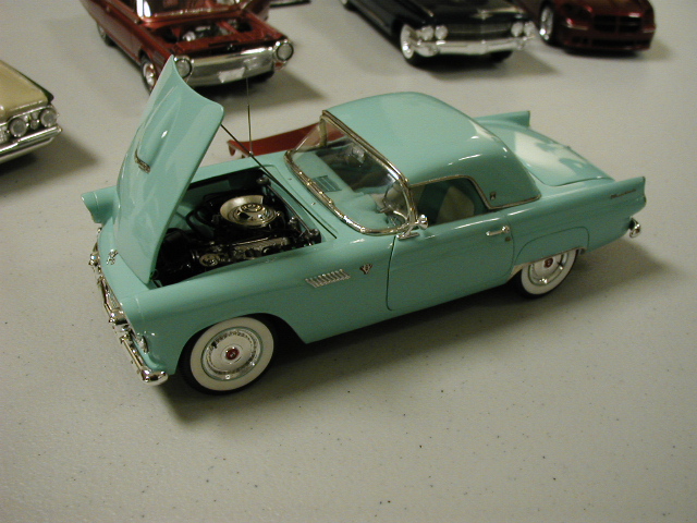

MrObsessive Posted January 8, 2019 Posted January 8, 2019 6 hours ago, Can-Con said: Since I started using this stuff over 25 years ago I don't have all those "hot paint" problems. A couple coats airbrushed over your primer after all your bodywork is done and your good to go. Yup! I HIGHLY recommend this stuff! I airbrush mine though as I'm not a big fan of their cans. 22 minutes ago, Deuces said: I read somewhere folks would spray a body with Future first before shooting the primer coats... I'm not sure if that works... Here's a car that I painted many years ago now that was undercoated with Future and then I shot primer and color coats over it. If you're familiar with this model you know that it's molded in red. Monogram's '56 T-Bird that I backdated to a '55. Their red plastic is IMO notorious for showing through gray and even white primer for instance and I wanted to avoid that as some military builders I know had recommended it at the time. As you can see, the T-Bird Blue is not showing any signs of red and with the bodywork that was done to turn this into a '55, you won't see that showing either. The main reason I don't use Future much anymore is because as I mentioned..........you need a lot of it to make sure it does the job as it shrinks incredibly. Hope this helps!

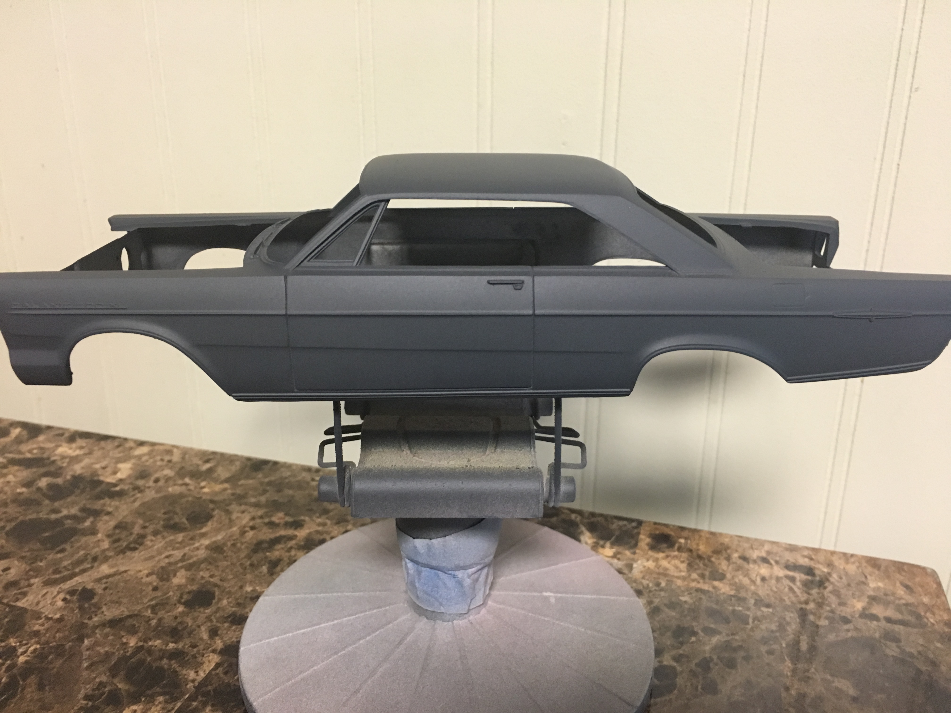

Brutalform Posted January 8, 2019 Author Posted January 8, 2019 1 hour ago, StevenGuthmiller said: Duplicolor "Perfect Match". Steve I have a full can of that. Like I said, I’ve laid down some nice paint in the past using Duplicolor. Just the last three paint jobs were not laying down for me. Just laid down four light coats on the 65 Ford Galaxie. I went right over the Tamiya primer. Looks pretty good so far.
Brutalform Posted January 8, 2019 Author Posted January 8, 2019 It’s a bit darker than the other grays I’ve used.

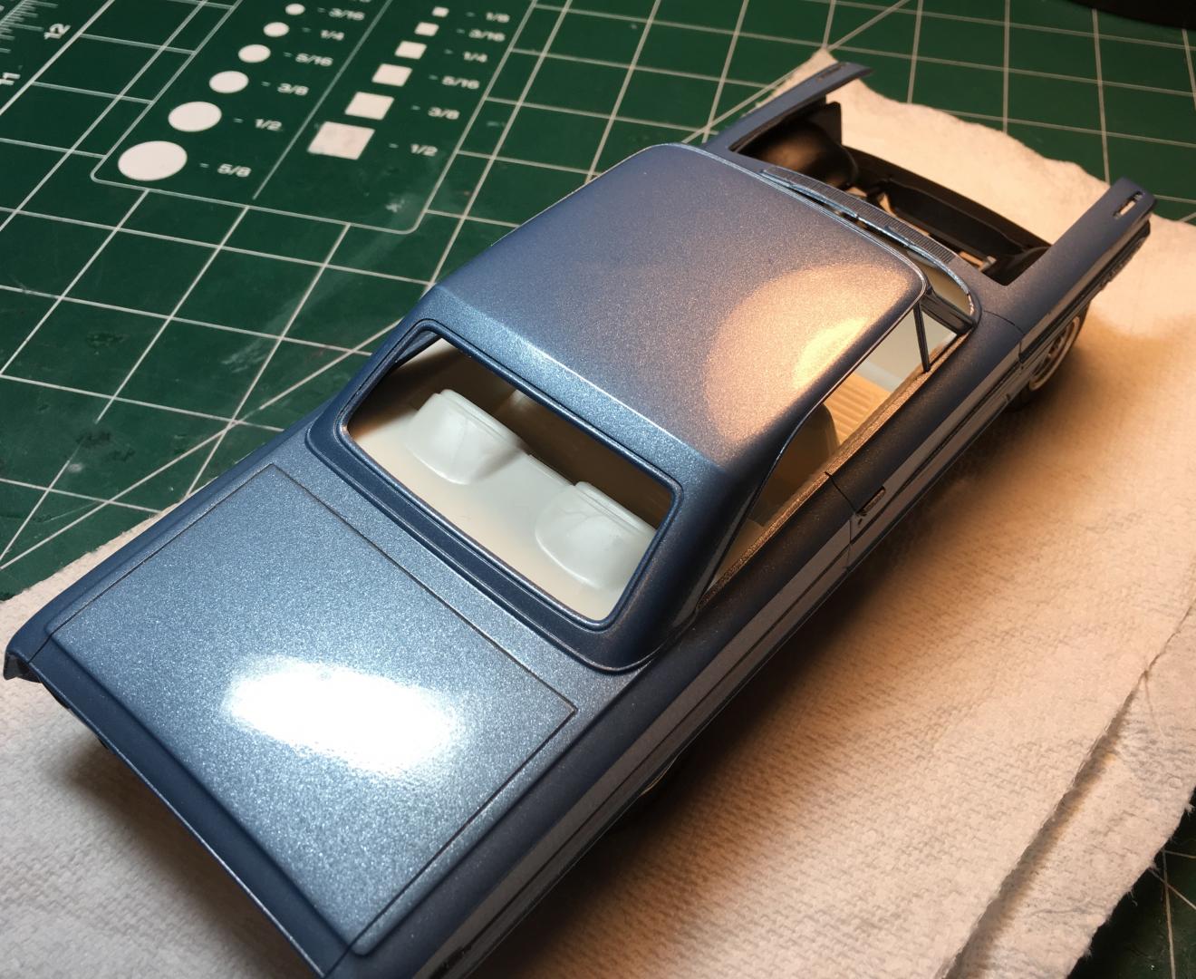

Brutalform Posted January 8, 2019 Author Posted January 8, 2019 The Galaxie and Mustang were primed with Tamiya primer, and shot with Duplicolor paint and clear. Then polished with micro mesh.

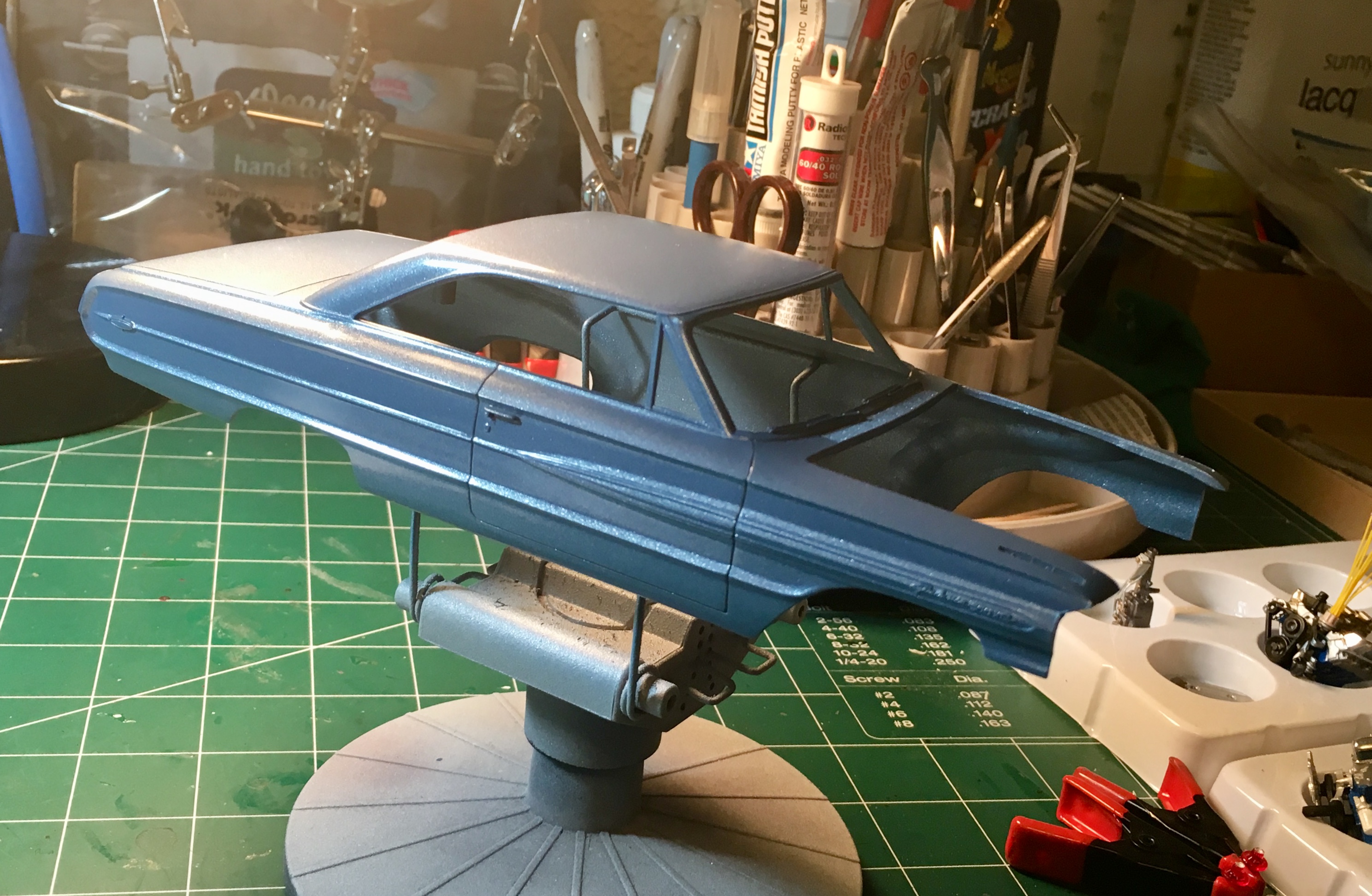

MeatMan Posted January 10, 2019 Posted January 10, 2019 Not sure about why, but I had the same issue on my Starliner with DC paint. My entire car came out like your issue, so I stripped it and then bought a new can of the same paint (True Blue). I used DC primer first, thoroughly prepped, cleaned then repainted and the same result. The last time however I went ahead and polished it with auto polish and voila, all was well. I used DC a lot, and it hadn't happened before. Dunno if I'll be using it again.
