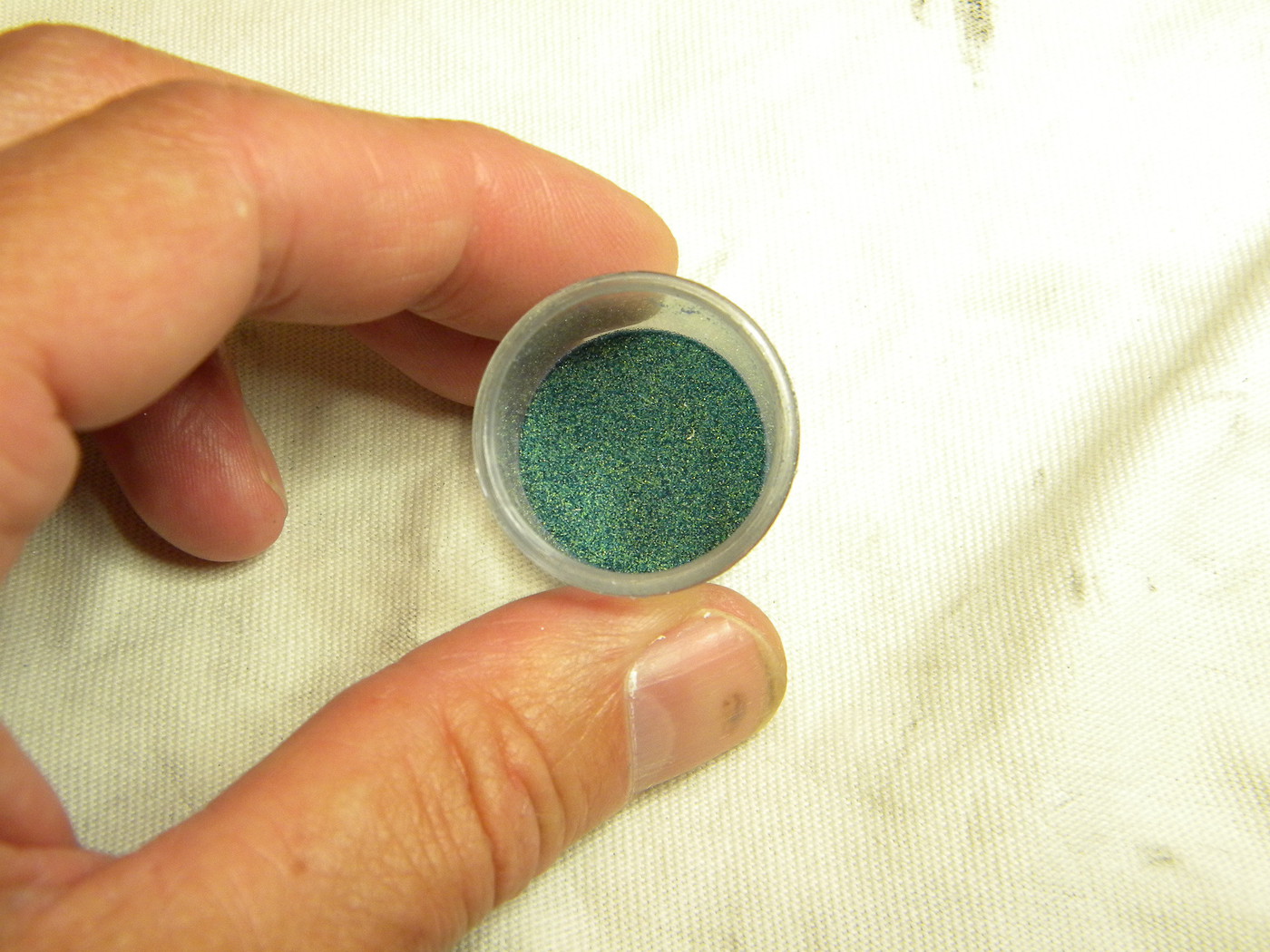

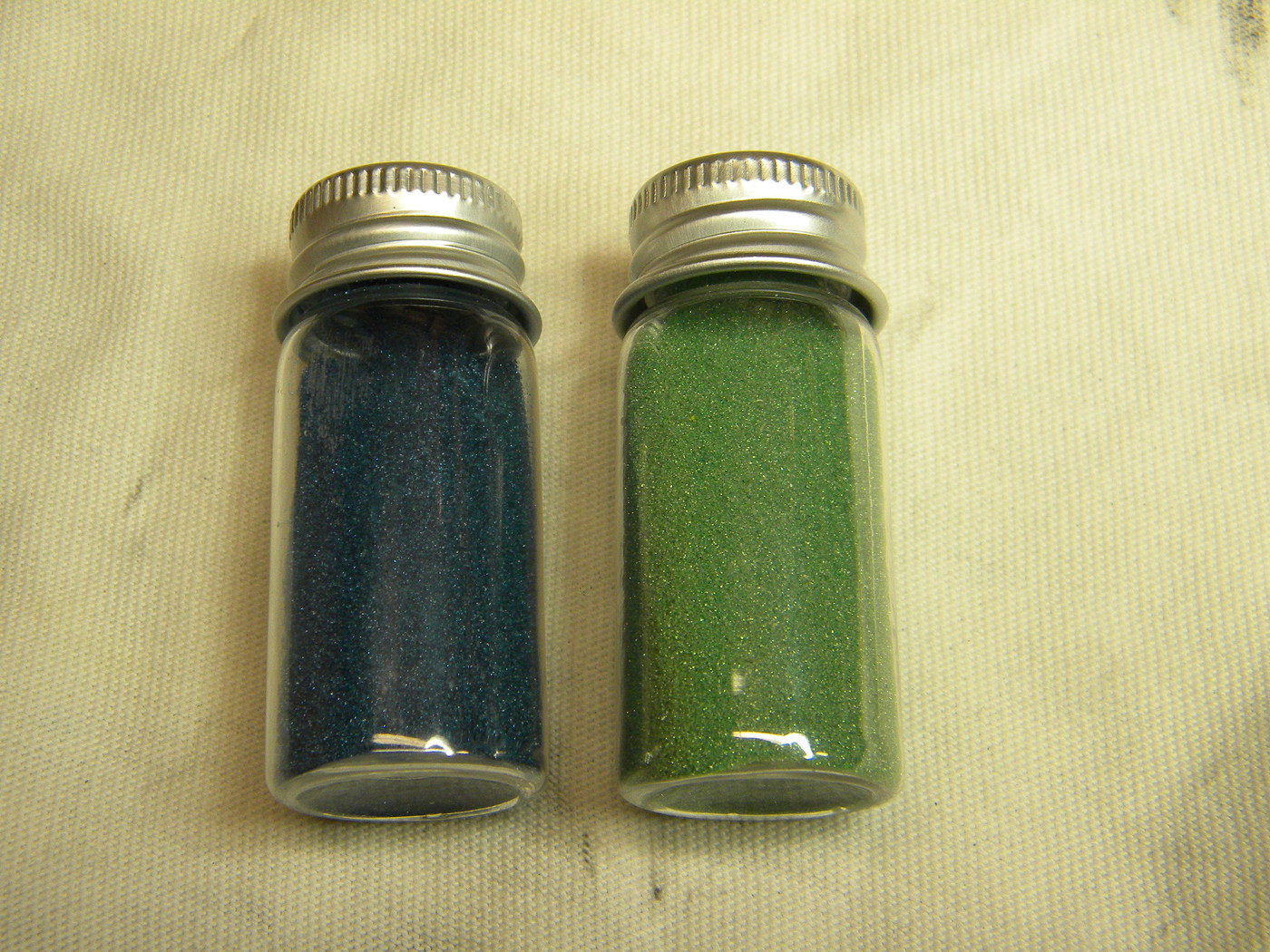

StevenGuthmiller Posted July 8, 2019 Author Posted July 8, 2019 (edited) 8 hours ago, oldrevellfan said: how hell can you do a so nice carpet? It's not as difficult as you might think. I bought a set of metallic embossing powder a few years ago that included 16 different colors of powder. This project required a turquoise color which my set did not contain, but luckily, it is mixable to some extent. The first step was to try to mix a couple of the colors that I did have to try to replicate something close to the interior color. This is actually the toughest part! After that, it's just a matter of slightly thinning some Elmer's glue with a few drops of water, masking any areas where you don't want carpet, brushing on the glue and then just dumping the embossing powder over it, shaking it around and then dumping off the excess. Be sure to do this over a piece of newspaper or the like so that you can save the excess and dump it back in the container to be re-used. Also, remember to remove your masking material within a few minutes of finishing the area. As the glue dries, the tape can lift parts of the carpet off with it when removed. Removing the tape while the glue is still wet eliminates this possibility. It's really not difficult at all. This is one of the few parts of building that has no learning curve. I got pretty much perfect results the very first time that I tried it. Steve Edited July 8, 2019 by StevenGuthmiller

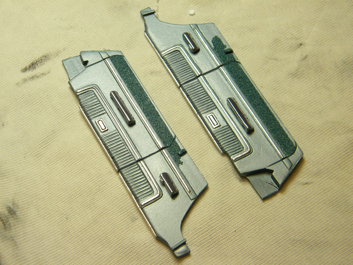

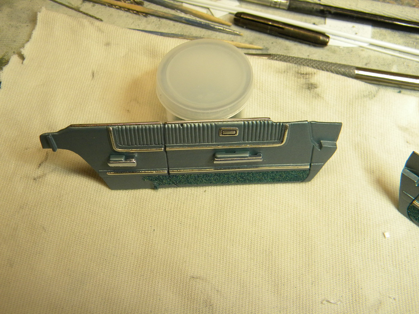

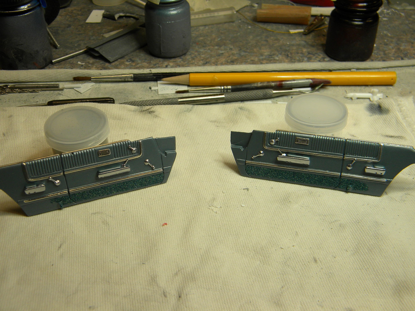

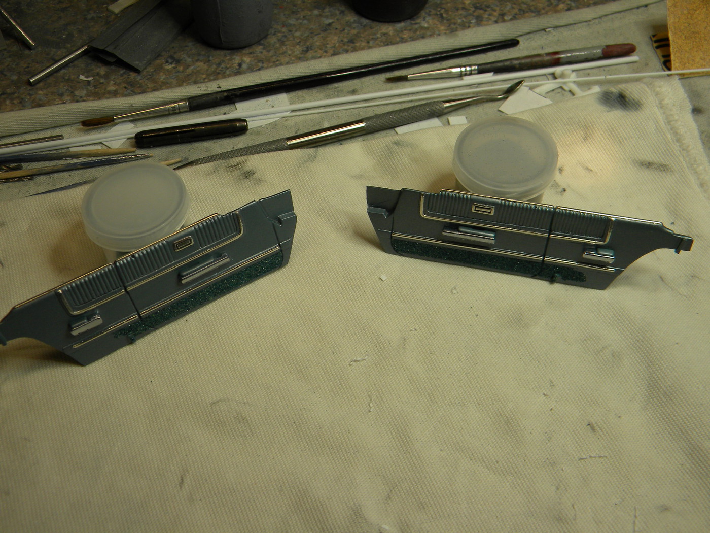

StevenGuthmiller Posted July 9, 2019 Author Posted July 9, 2019 A bit more interior work finished. The arm rests are scratch built and finished in Alclad chrome. I added ash tray detail to the rear ones as well. The pads were just fashioned from plastic sheet and painted the interior color. I hope to get the window cranks installed shortly. When that is done, the door panels should be complete except for some minor paint detail and a set of door lock buttons. Steve

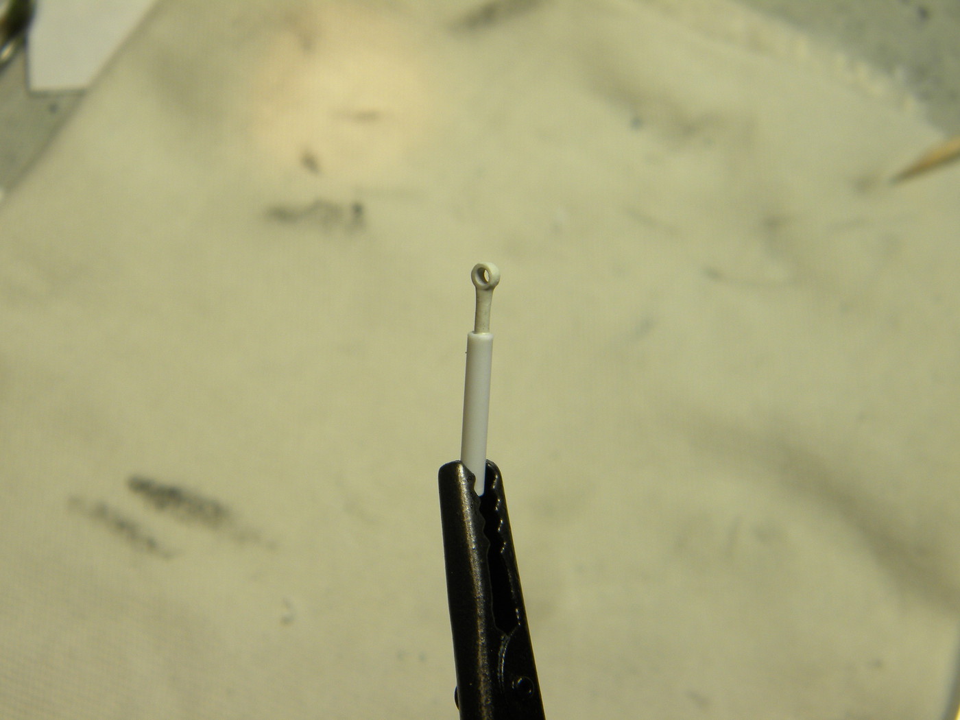

StevenGuthmiller Posted July 9, 2019 Author Posted July 9, 2019 I also needed to correct the rear shocks which were too short now that the rear suspension had been raised. I simply cut the heads off of the existing shocks and glued them into longer tubes created from plastic rod. Steve
Bucky Posted July 9, 2019 Posted July 9, 2019 Very nice details on this interior! The completed interior pics should be fabulous!
Brutalform Posted July 10, 2019 Posted July 10, 2019 Those door panels are a work of art, Steve. That flocking sets them off nice. I do that rod trick on way too many shocks... Lol

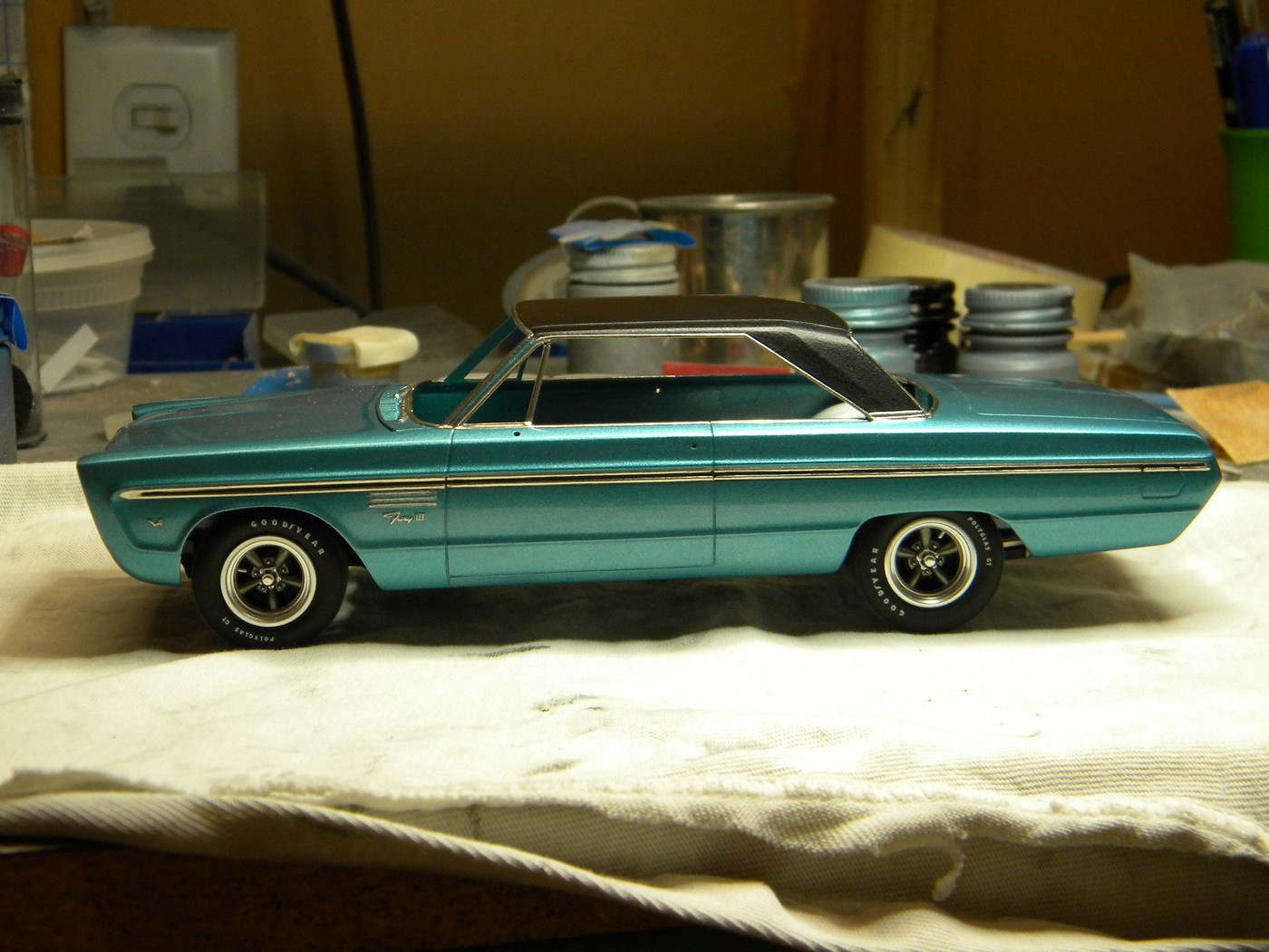

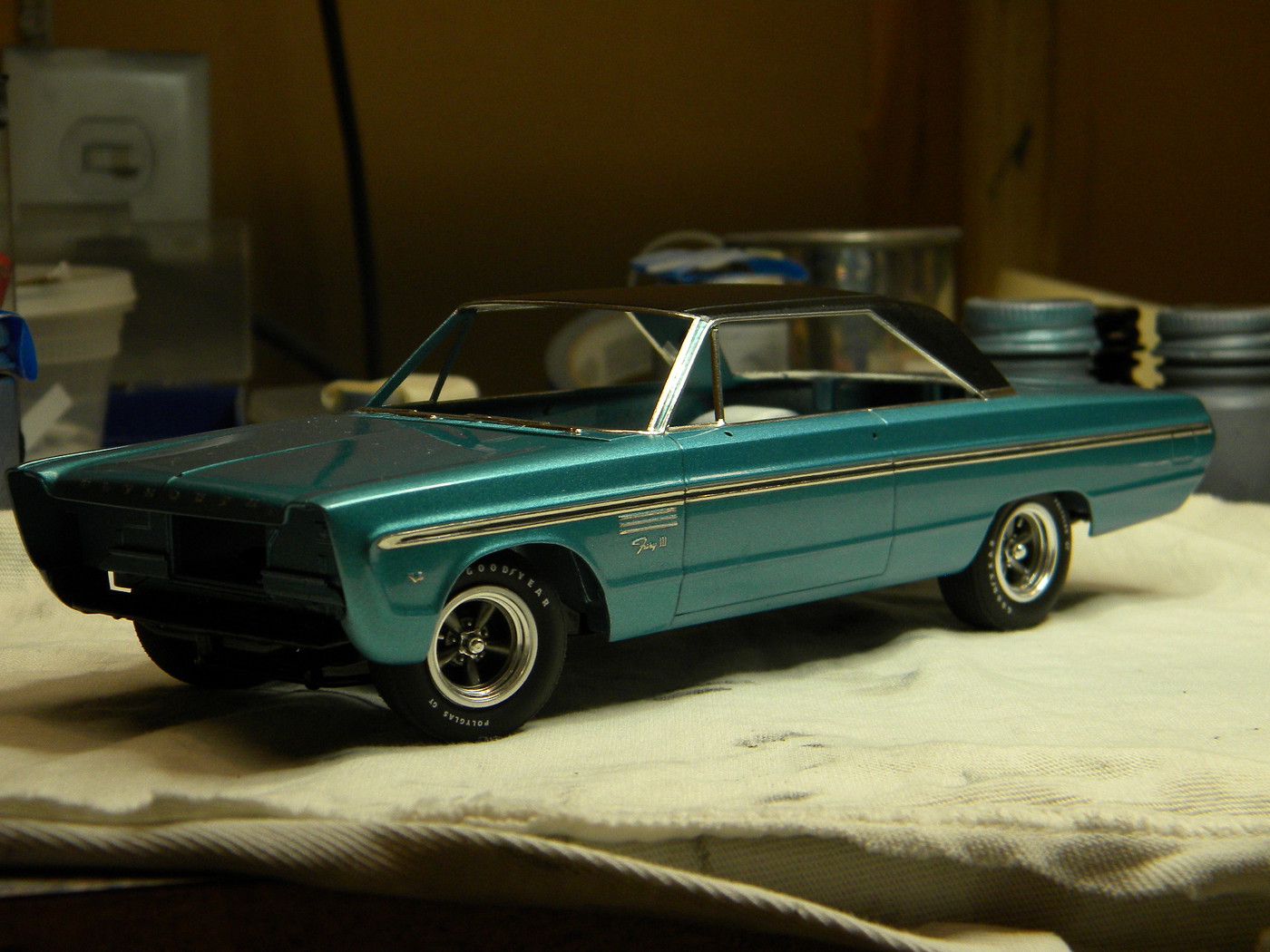

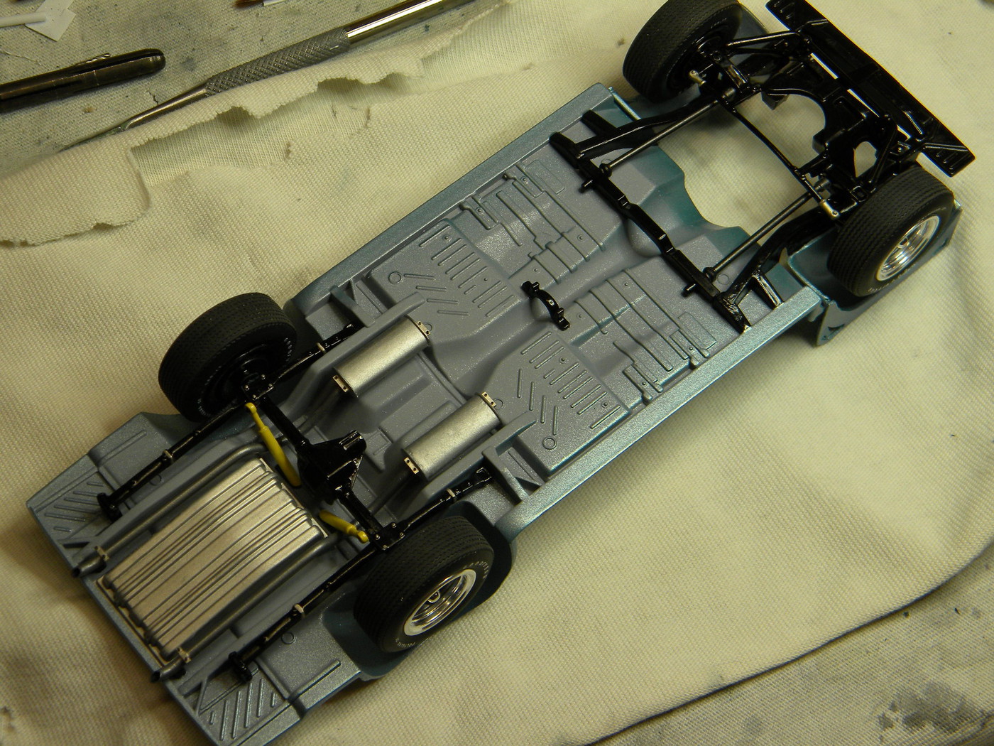

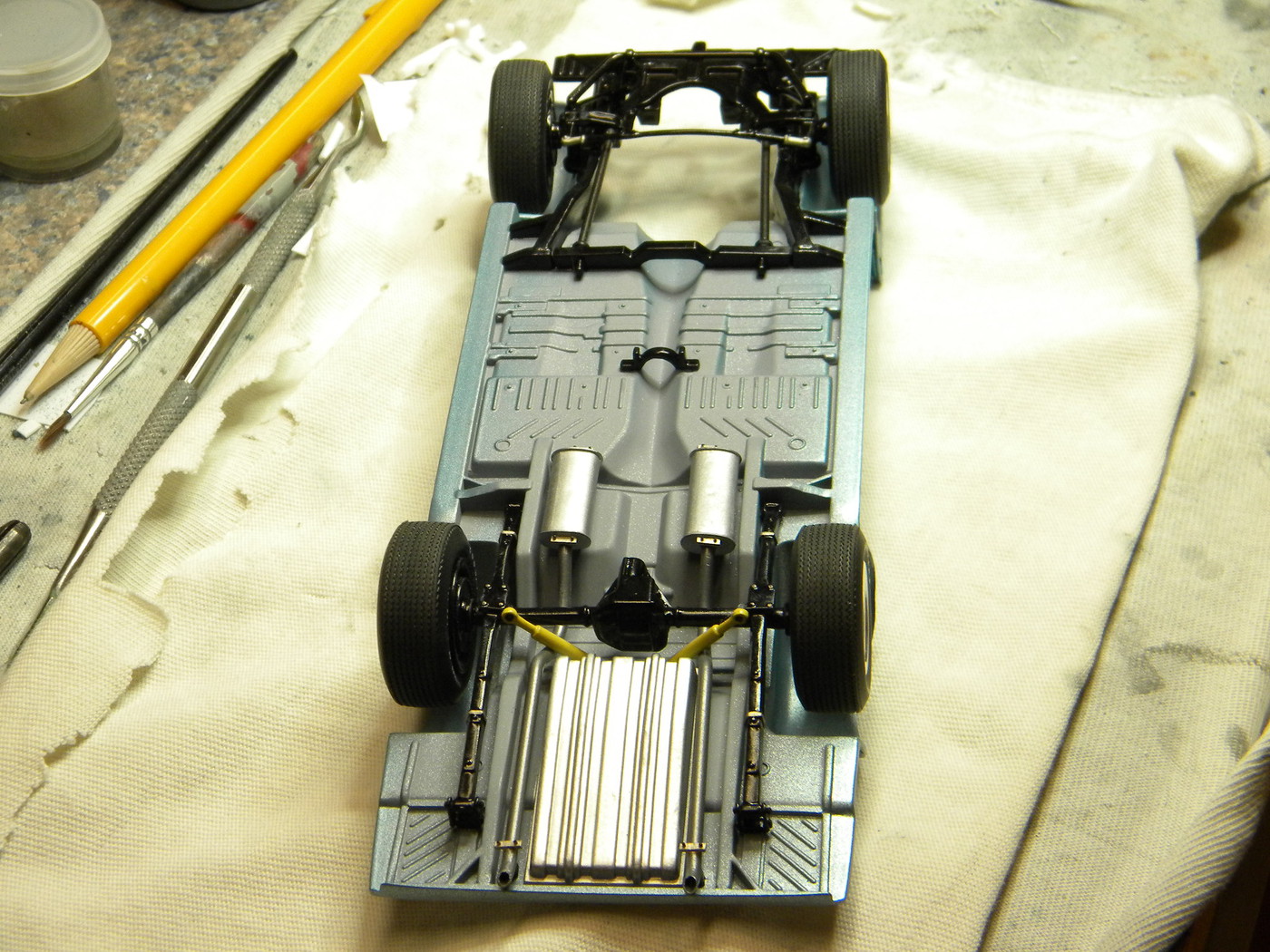

StevenGuthmiller Posted July 10, 2019 Author Posted July 10, 2019 1 minute ago, Brutalform said: Those door panels are a work of art, Steve. That flocking sets them off nice. I do that rod trick on way too many shocks... Lol Thanks Tom! I believe the bottom side of the chassis is more or less finished. After a lot of trial and error, I think that I finally have the stance exactly where I wanted it. Steve
Bucky Posted July 10, 2019 Posted July 10, 2019 Great stance! Aggressive, without looking like a top fuel dragster!!
