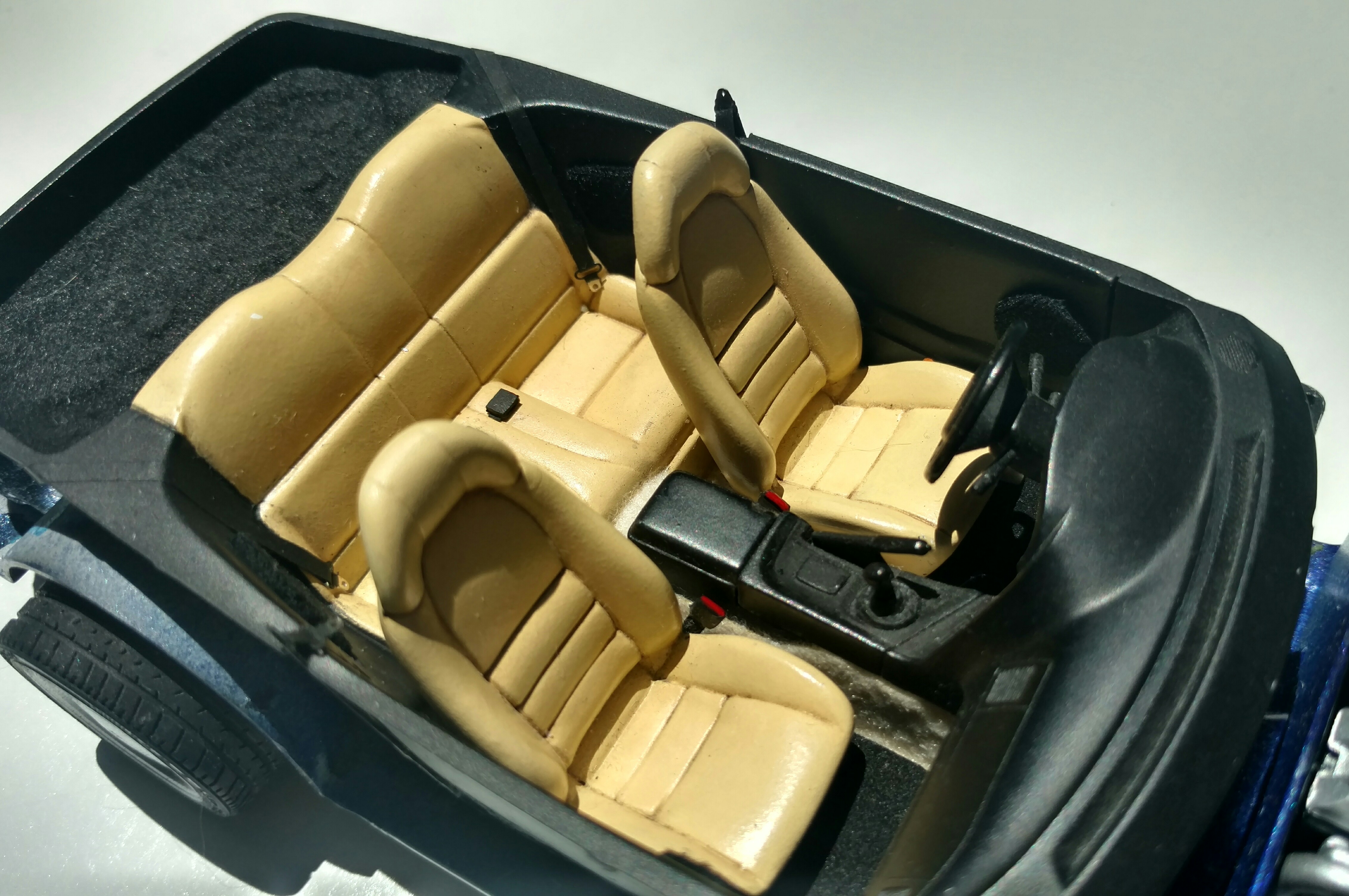

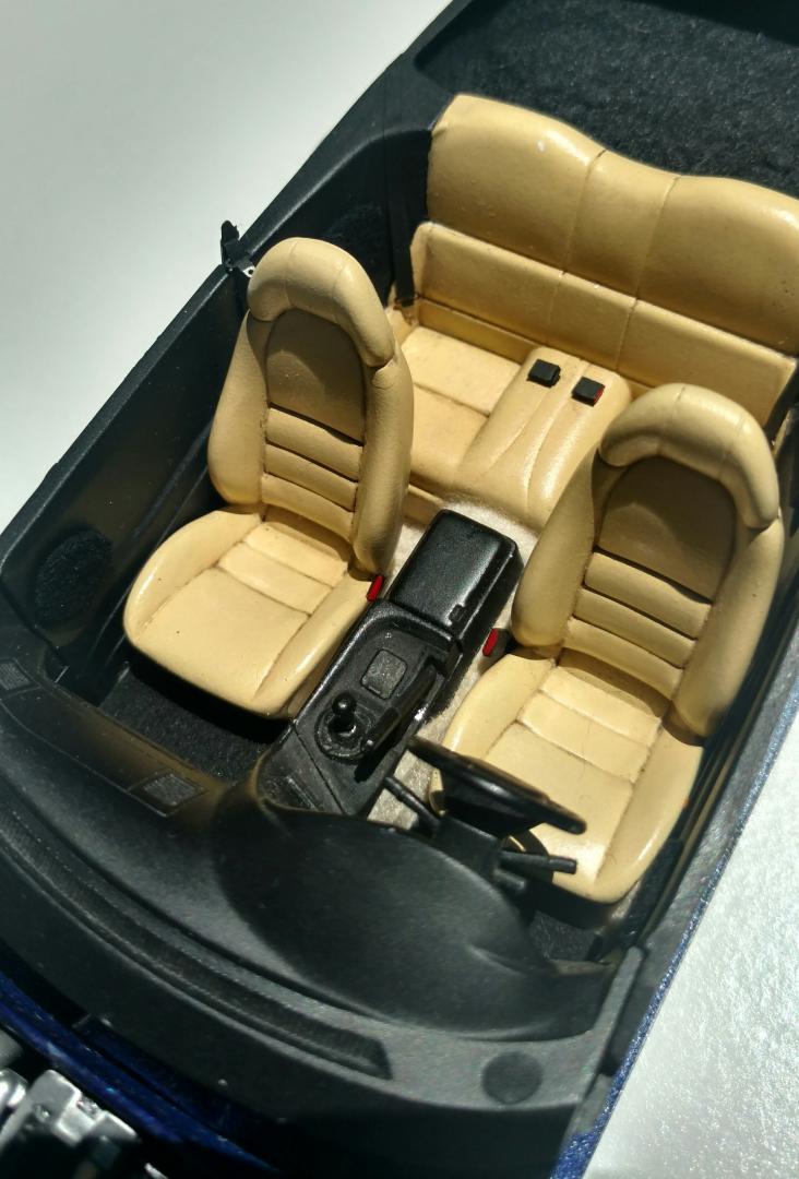

fiatboy Posted April 1, 2019 Posted April 1, 2019 Has anyone tried this method? And if so, what brand do you recommend, the adhesive that is? Thanks
stitchdup Posted April 1, 2019 Posted April 1, 2019 Spray glue is kinda hard to get to lay smooth, I tried it and it looked lumpy when the flocking went on, and wasn't easy to remove. I stick with enamel paint in a colour close to the flock colour
Daddy Mack Posted April 1, 2019 Posted April 1, 2019 3M Super 77 Multipurpose Spray Adhesive is the bomb. It'll go on thin if you just do 1 pass. Shake it up first and invert & clear the nozzle when done. https://multimedia.3m.com/mws/media/682505O/3mtm-sprayable-adhesives.pdf
DiscoRover007 Posted April 1, 2019 Posted April 1, 2019 Yes I use this method. It usually takes two coats. Spray, then flock, empty the tub and inspect, then spray again and flock once more. Any errors after that can be patched with the white glue method. The spray adhesive works really well to pack as much of the material as possible. It looks pretty realistic. Granted you need to make sure you mask the areas you don't want sprayed well.
