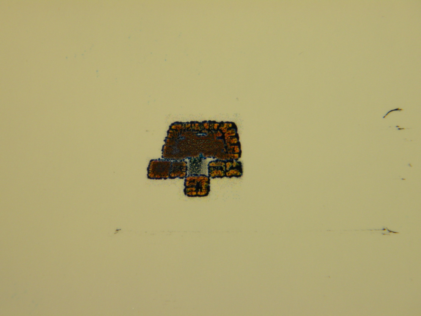

StevenGuthmiller Posted April 7, 2019 Author Posted April 7, 2019 On 4/7/2019 at 9:07 PM, Dave Van said: Use graphics software that has sizing tools........otherwise it's hit and miss until you get the size you want. Expand Actually, I played around with it and got it to about the right size, but my printer sucks!!!! I set the printer for the best quality that was possible, and all I got was a multicolored smudge! Any ideas? Is there anyone out there that can print it for me? Steve

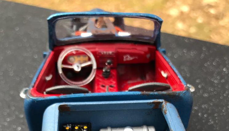

Tom Geiger Posted April 8, 2019 Posted April 8, 2019 (edited) First, you are better off finding the image of what you need already assembled. I have found pictures in car brochures and instruments for sale on eBay Motors. This is an instrument panel for a 1950 Ford pickup from eBay Tested on a spare dashboard I bring the image into Word, and then scale it down in 5% increments across the sheet. Then I print it on plain paper and compare the size of my images against what I need on the model dashboard. Sometimes it takes a few tries. Once I get the image the right size I will print a dozen of them across the sheet. Again print on plain paper, you do not need decal paper for this. Cut it out, and install with white glue. And a final copy on the model. Edited April 8, 2019 by Tom Geiger

Kit Basher Posted April 8, 2019 Posted April 8, 2019 (edited) As Tom and Earl mentioned, I get the best results resizing images in Word. I also have an Epson XP 400 series and as Dale said, it will not print on Papillio paper. It makes exactly the mess you showed in your picture. I have not tried it with other decal paper, since Papillio is all I have. It is definitely the printer because I can print the same file on my ALPS printer and it comes out perfectly. If Tom's suggestion of not using decal paper will work for you, it's worth a try. My Epson will print nicely on photo paper, and make a mess on decal paper. Edited April 8, 2019 by Kit Basher

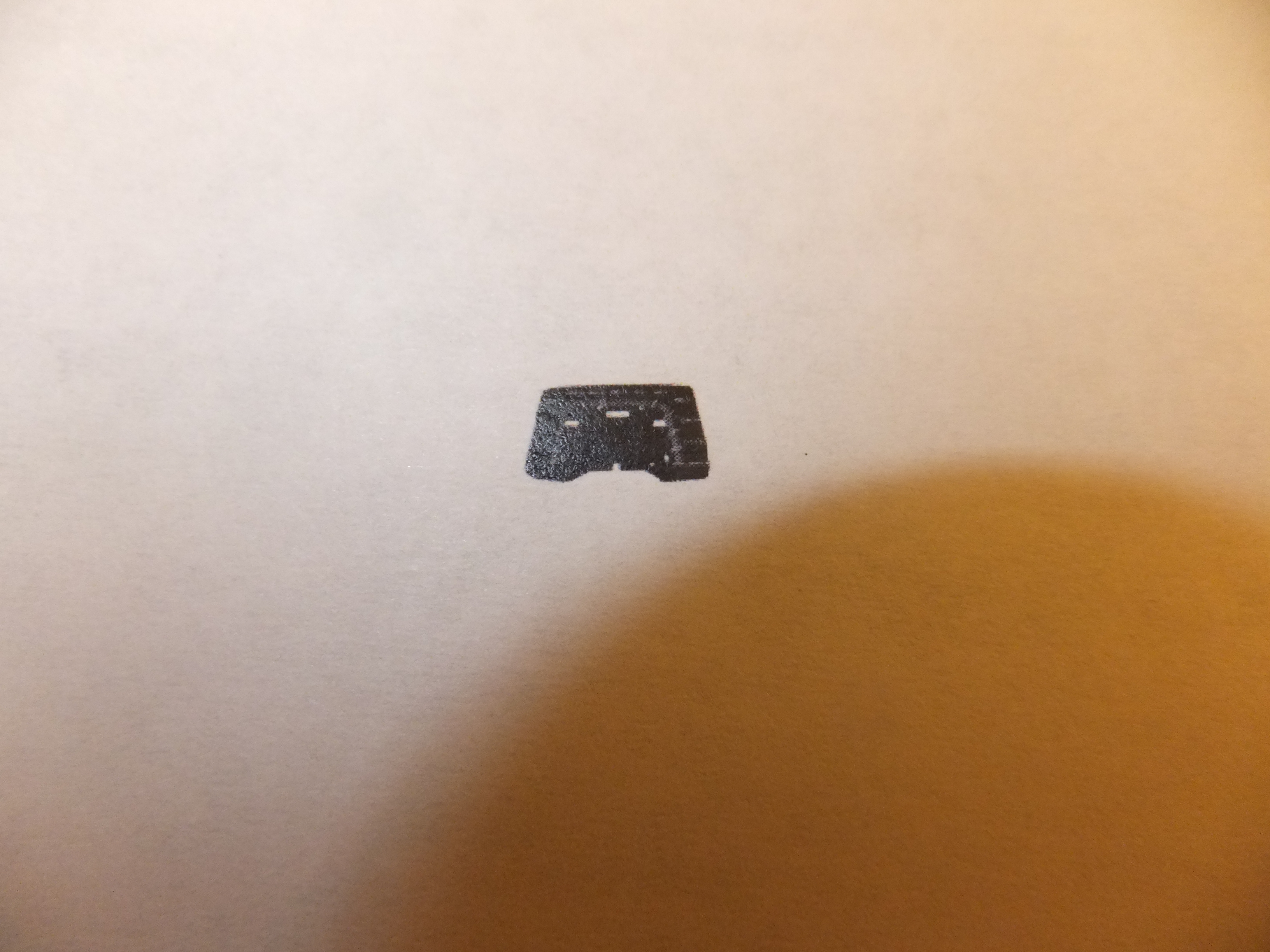

Exotics_Builder Posted April 8, 2019 Posted April 8, 2019 (edited) I copied your image and reduced it to 3% (rough sizing, not accurate) and printed as gray scale on the old Laserjet and got this. CorelDraw is on the home computer in WA state. Did this test in 5 minutes. Not the best paper (also at home) and draft mode Edited April 8, 2019 by Exotics_Builder

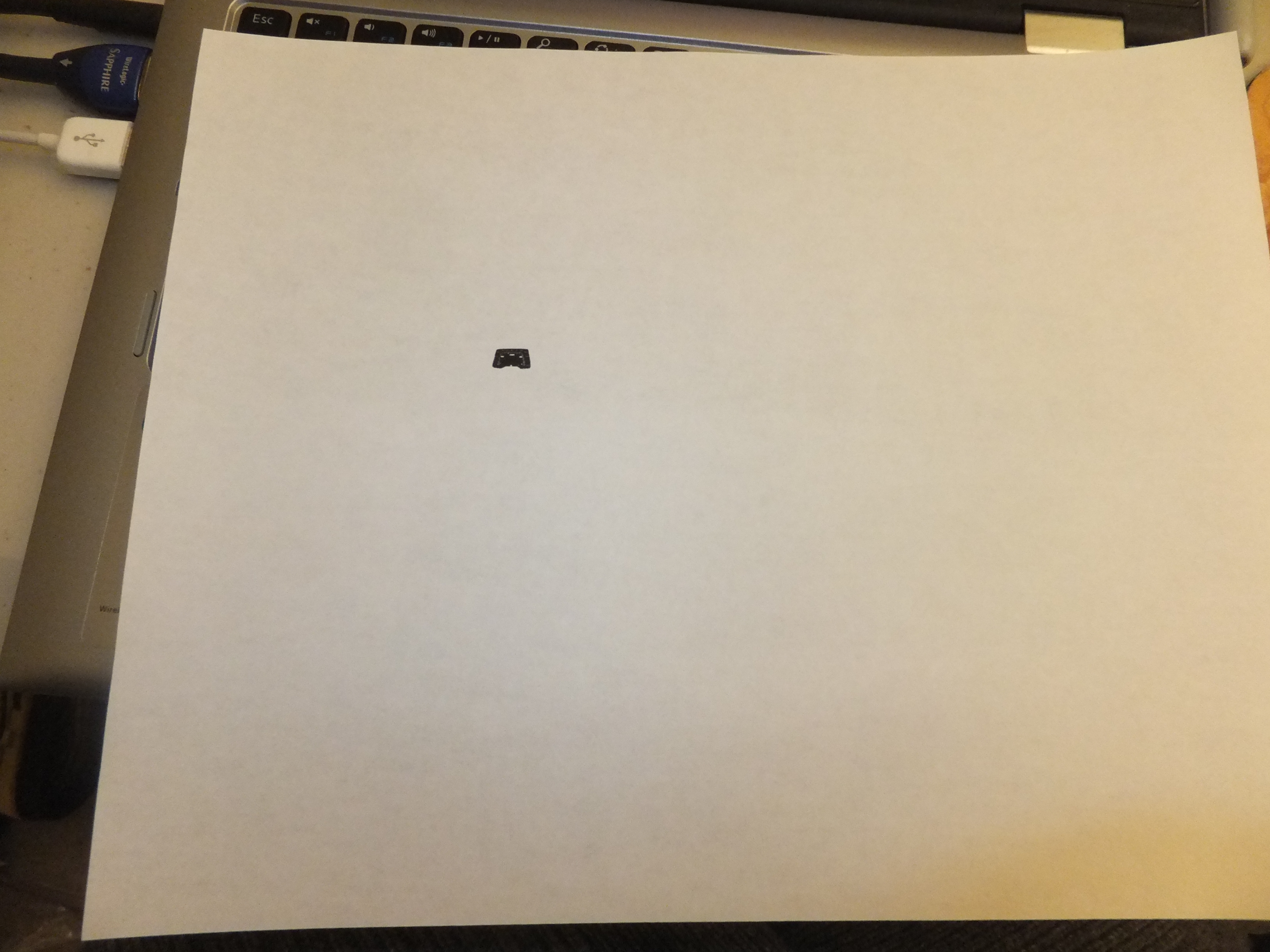

Exotics_Builder Posted April 8, 2019 Posted April 8, 2019 (edited) I then copied your reduced image (which appears a bit blurred) and printed on same paper at high quality and got this. Photo quality paper would be better, but the bitmap image, on reduction, is also an impact. If I were doing this, I would likely consider a trace in CorelDraw to a Vector image. Edited April 8, 2019 by Exotics_Builder
