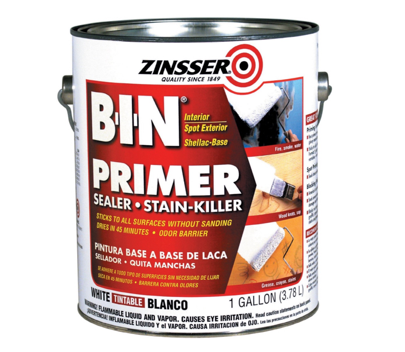

Rider Posted May 2, 2019 Posted May 2, 2019 Mr. Obsessive (Bill) recently addressed that exact concern about newer styrene crazing. His solution to this is he has been spraying a base coat of BINZ stain blocker, specifically their line that is schallac based. Bill also pointed out the spray can is too heavy and prefers to thin out and you the air brush.

Can-Con Posted May 6, 2019 Posted May 6, 2019 (edited) On 5/2/2019 at 9:50 AM, Rider said: Mr. Obsessive (Bill) recently addressed that exact concern about newer styrene crazing. His solution to this is he has been spraying a base coat of BINZ stain blocker, specifically their line that is schallac based. Bill also pointed out the spray can is too heavy and prefers to thin out and you the air brush. A couple things about using BIN. First lay down a thin coat of primer , or any flat paint on the plastic that hasn't been sanded. BIN will not stick to smooth, shiny plastic and needs something to grip to or it will chip and flake easily. Also use cheap rubbing alcohol to thin it and for cleanup. Lacquer thinner , turpentine, mineral spirits etc. have no affect on it. Get a spray can and decant it to use in your airbrush. It's kinda thick sprayed strait from the can. You'll never use even a quart can before the inside of the lid starts to rust and then it's no good for what we use it for. Use multiple thin coats. Its blocked even the hottest HOK lacquer I've sprayed on it , even strait lacquer thinner. I've also used it as a "high build" primer to smooth out lacquer crazing on models. It wet sands beautifully. I've been using it for almost 30 years now. Probably the first person to use it for models and all the above comes from trial and error, first hand experience experimenting with it. Edited May 6, 2019 by Can-Con
peteski Posted May 6, 2019 Posted May 6, 2019 1 hour ago, Can-Con said: A couple things about using BIN. . . . I've been using it for almost 30 years now. Probably the first person to use it for models and all the above comes from trial and error, first hand experience experimenting with it. I have used Floqil Barrier (made for the same purpose) for decades, when it was still available. It was basically another alcohol based shellac-type product similar to BIN. I still have few bottles of it (I stocked up when RPM discontinued Floquil paints.
